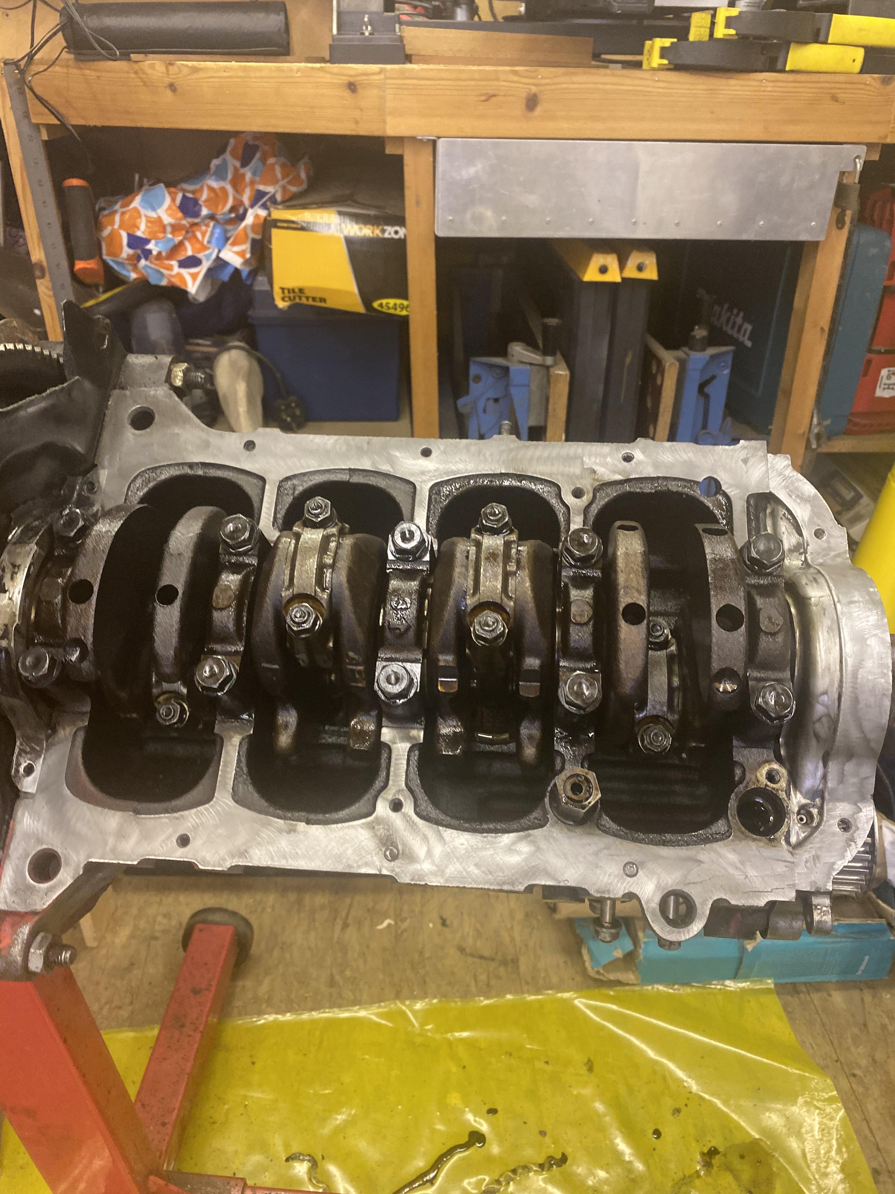

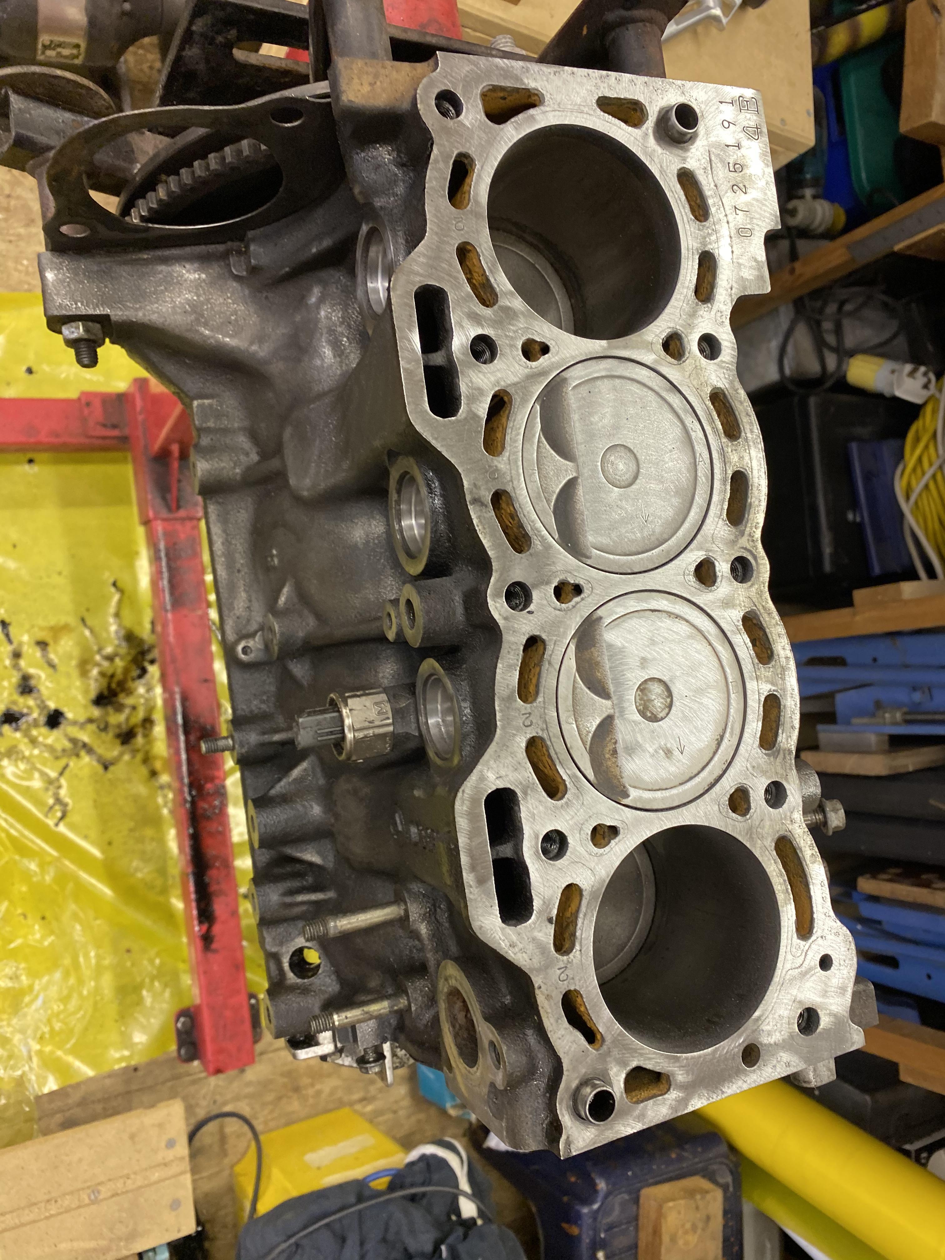

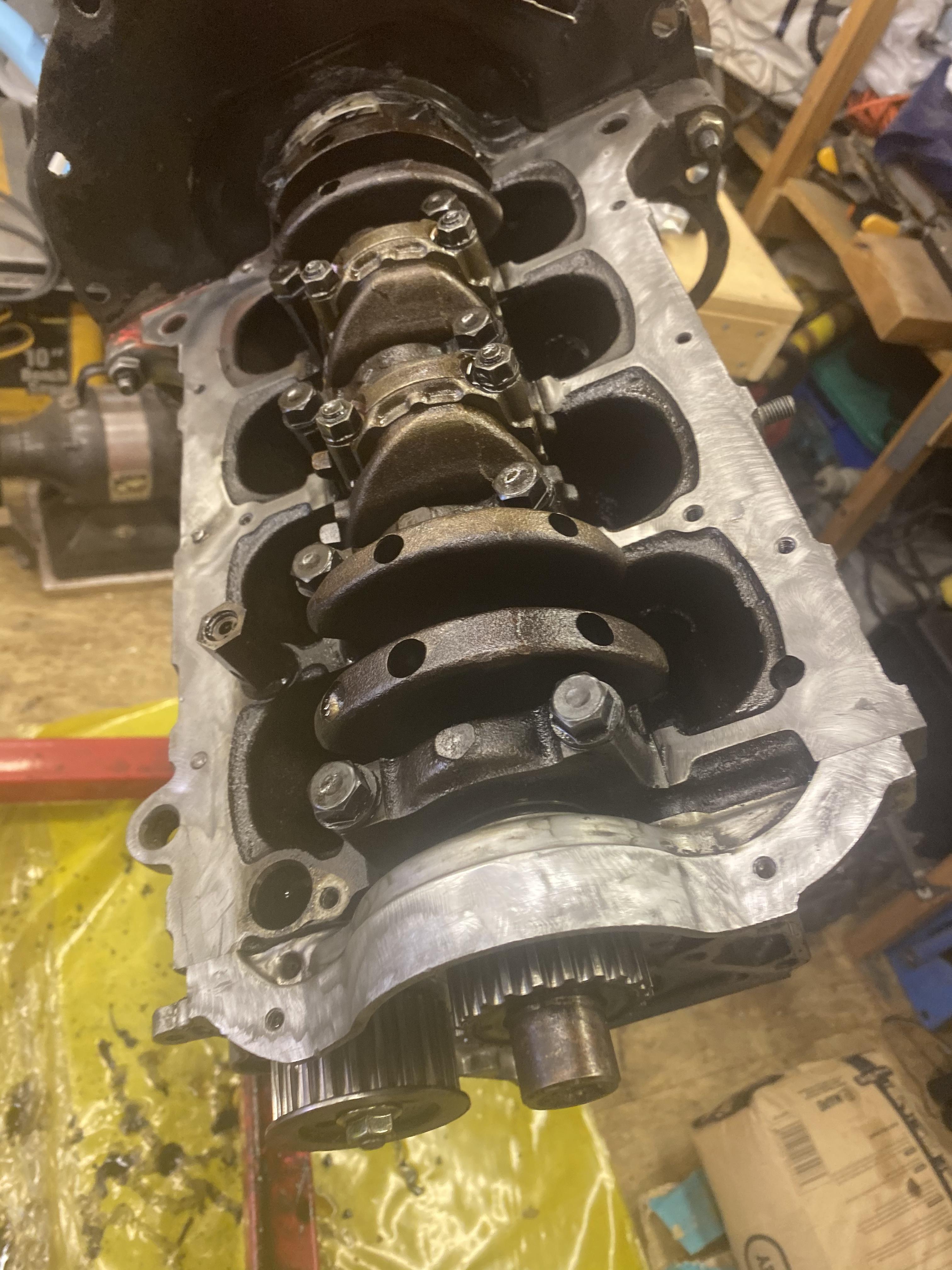

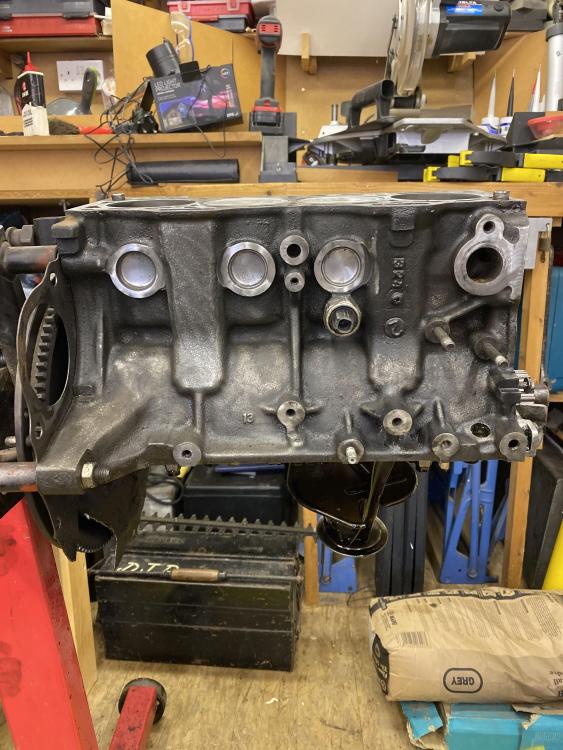

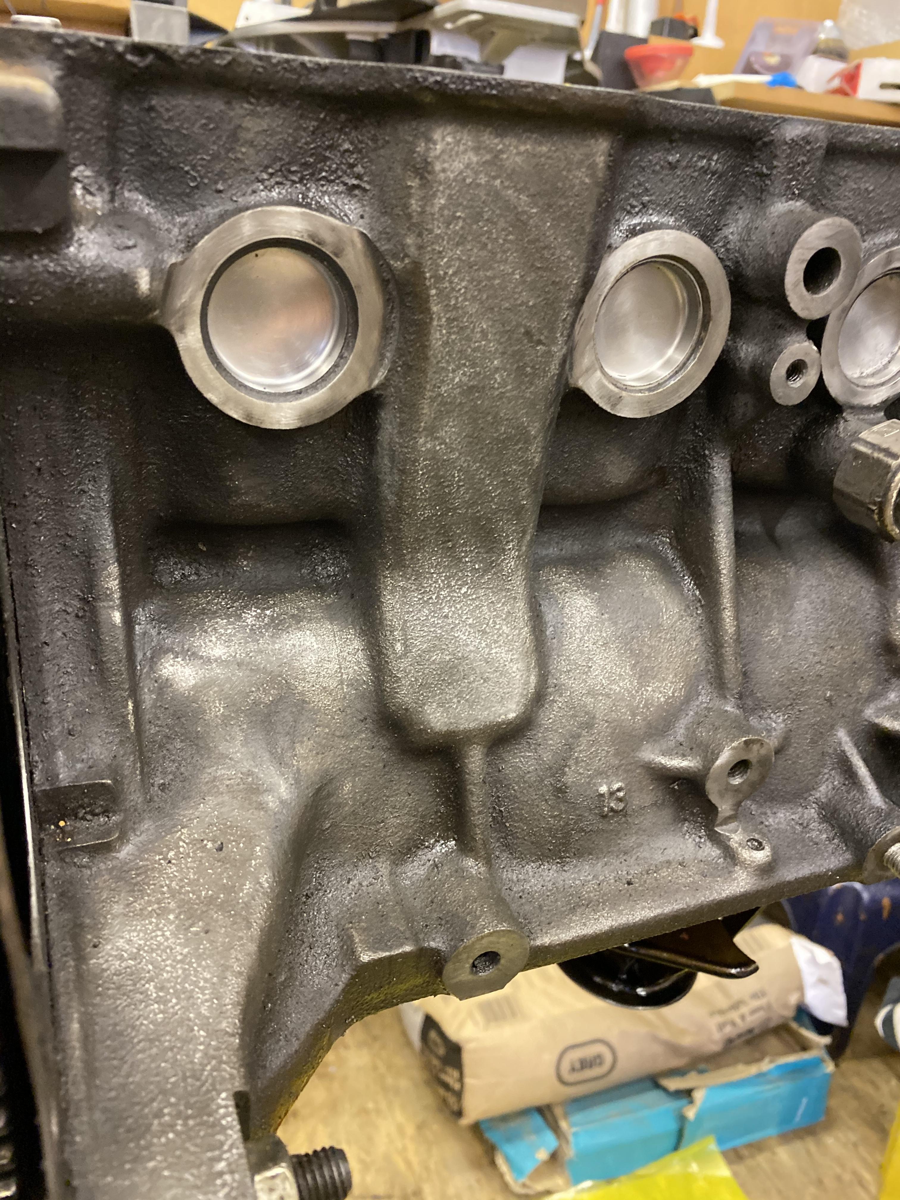

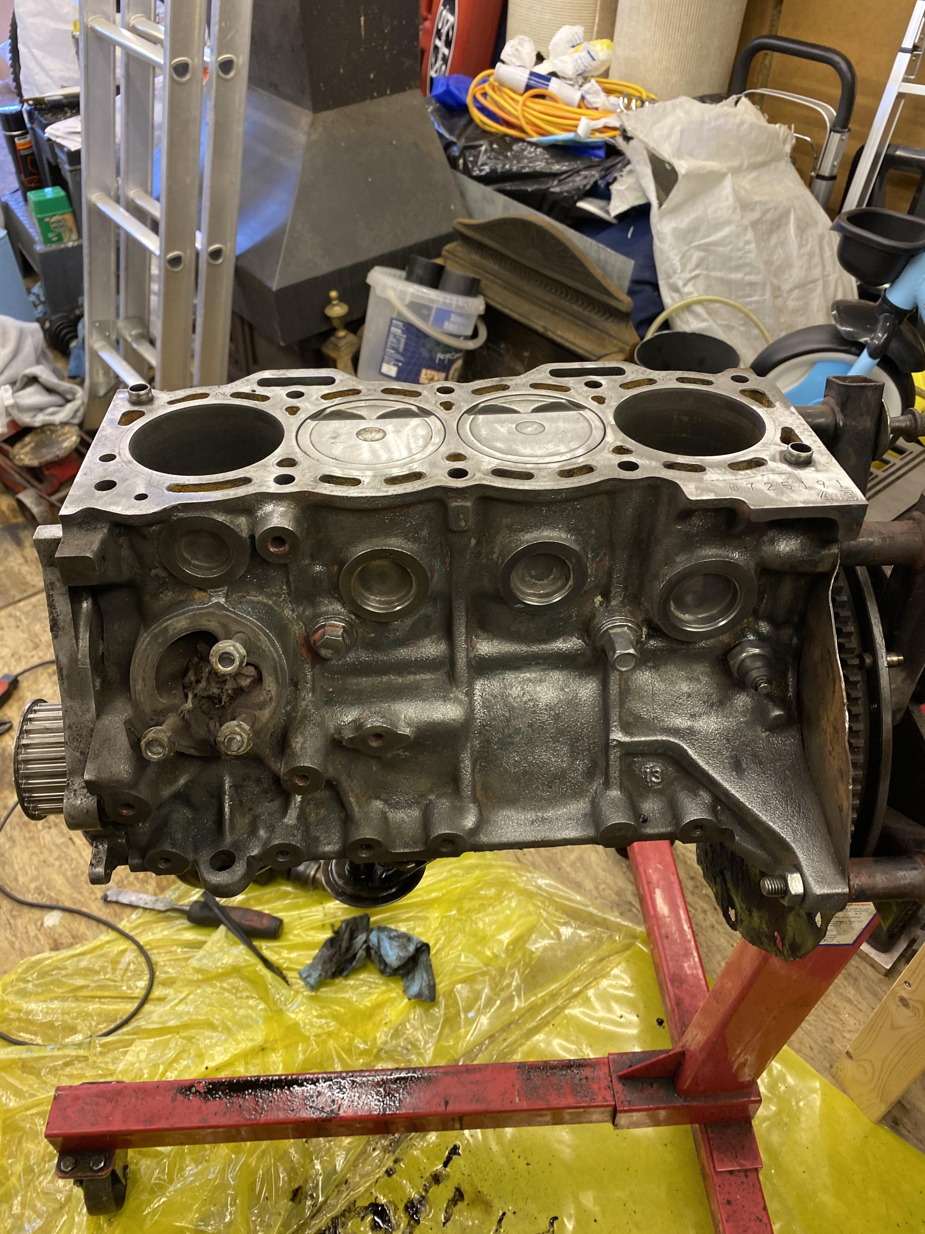

Small progress tonight as was working late moved back on to cleaning the block up as there was still bits I wasn’t happy with it’s coming up alright now still need to take the flywheel and cover off to get behind there but the rest is coming up ok!
also thanks for everyone’s help so far really appreciate it!04C70D6D-7E1C-4D42-8CA2-E9D1769FA288.thumb.jpeg.566dfb31e7d0f031ce87a1f5d090d919.jpeg3F7F4BC8-D567-4DE1-BFD7-84769F471C28.thumb.jpeg.0c41ade05f28708b43ee736db7fc4047.jpeg087E5A2E-A3E8-4F7C-A771-409C35DFF393.thumb.jpeg.bc8c319cbdb2bc39e53593c9f4d34ebf.jpeg130F2581-ED48-42E6-A4D5-3147F394FEE7.thumb.jpeg.b6a1fe9f0b34ff0d5233ab16e6c0acef.jpegE427676E-A66C-4CDA-B773-32E707872FEB.thumb.jpeg.61f93df095b3f417ed8f9edb00b78428.jpeg734DEF0D-EBDD-4966-AB28-80DFA3EE3A05.thumb.jpeg.caedd28061e450008e9b3765c4819028.jpeg
