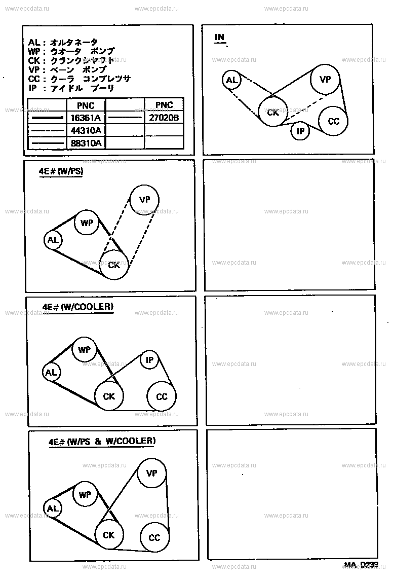

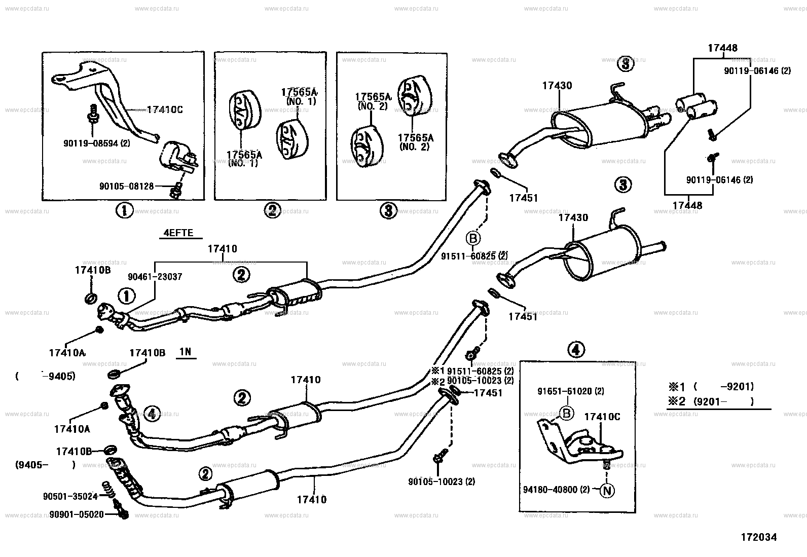

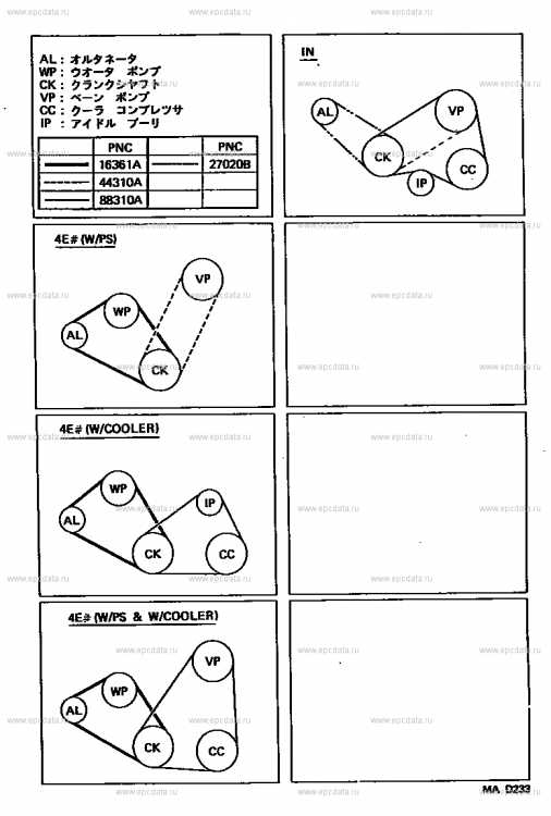

Frankieflowers Posted December 8, 2020 Author Posted December 8, 2020 I got two questions. One is about the exhaust picture regarding Glanza V. Why are there two types of attach to the engine? I thought there was only one type of engine. Probably is because of the difference between the two transmissions? Second question regarding the picture with the belt sets. As my Corolla mount the air conditioning compressor, I should probably get the Glenn’s of the belt set with the belt for the air conditioning that I will adapt on my Corolla compressor. Is that correct? Quote

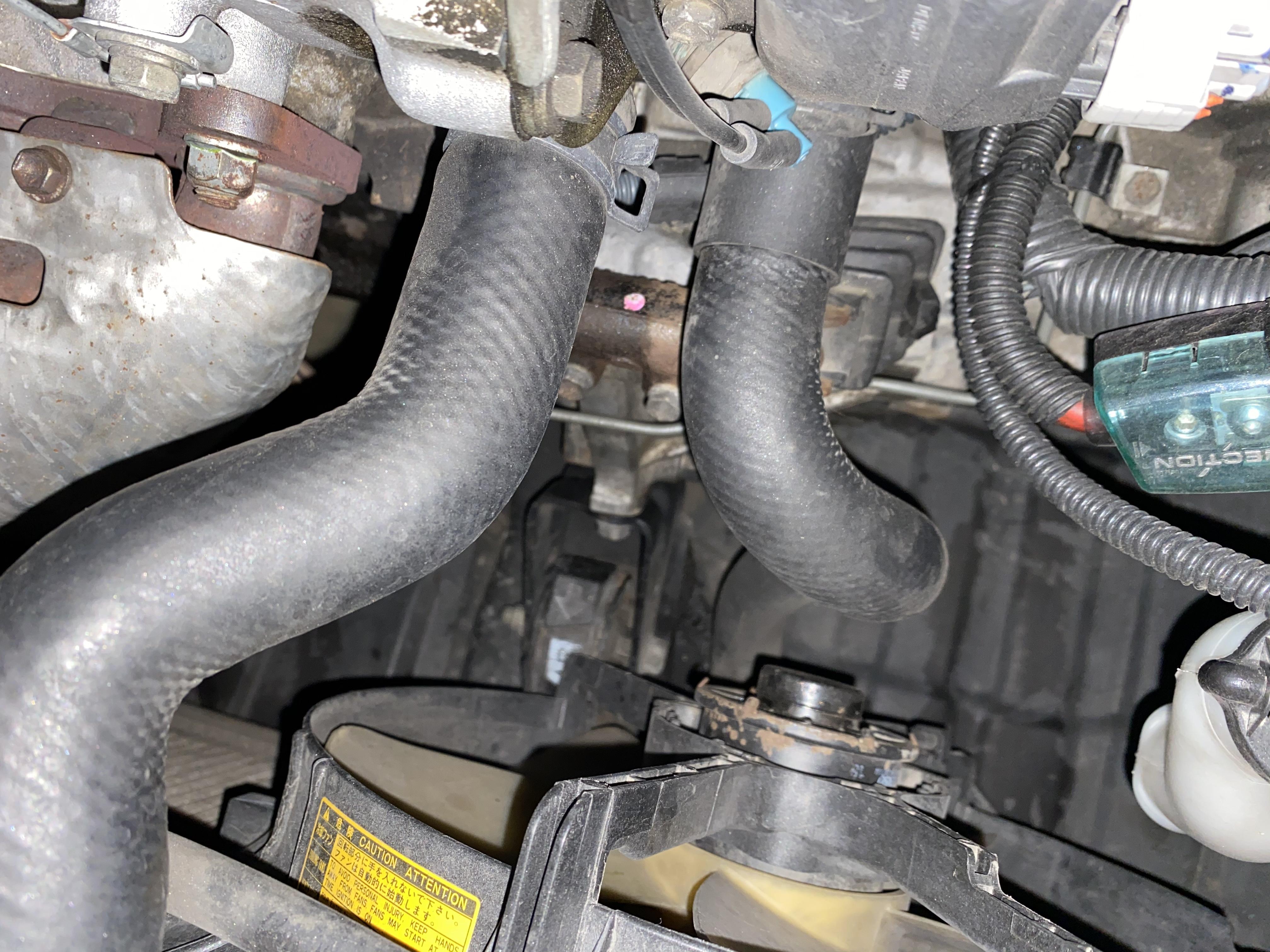

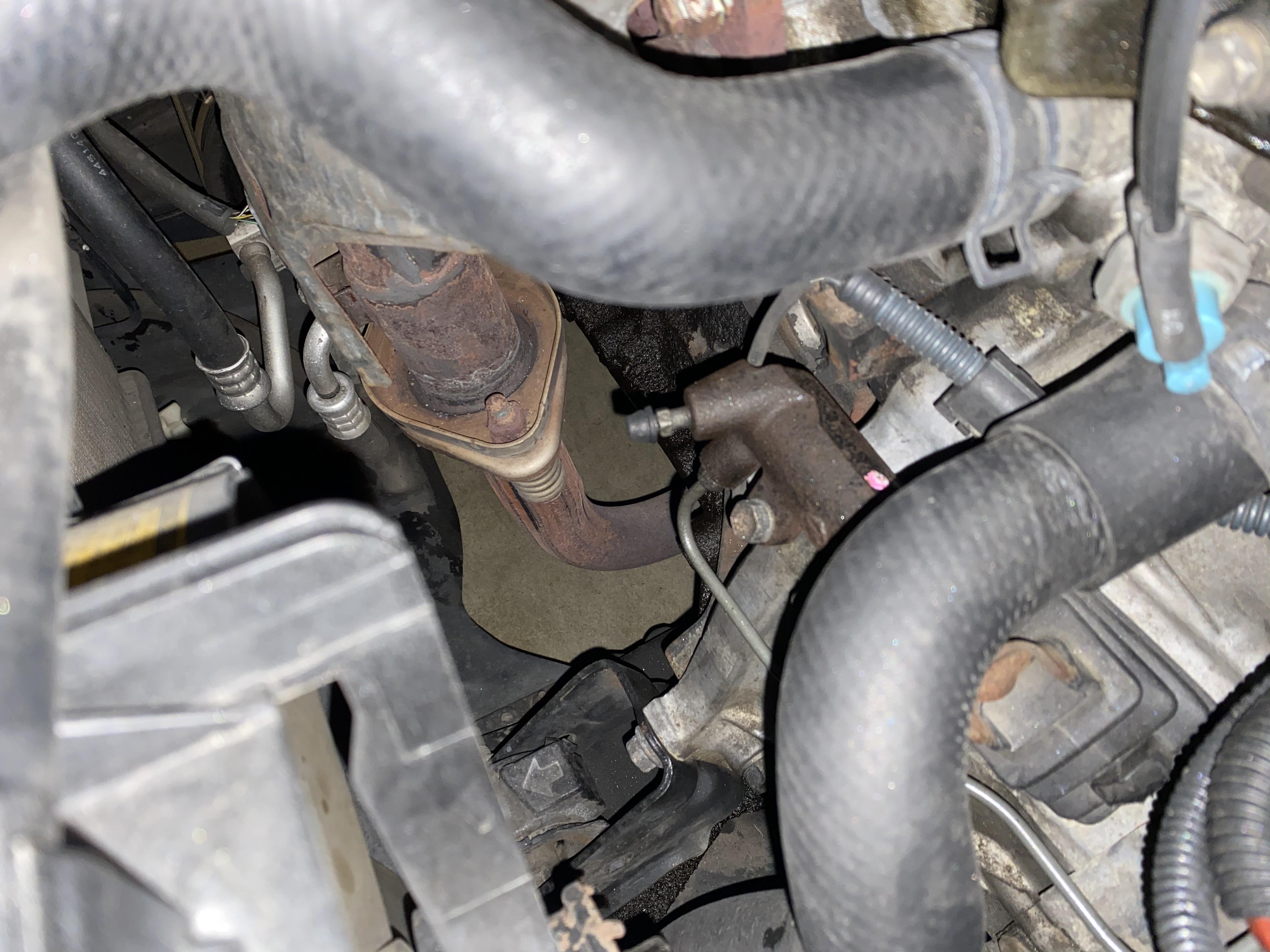

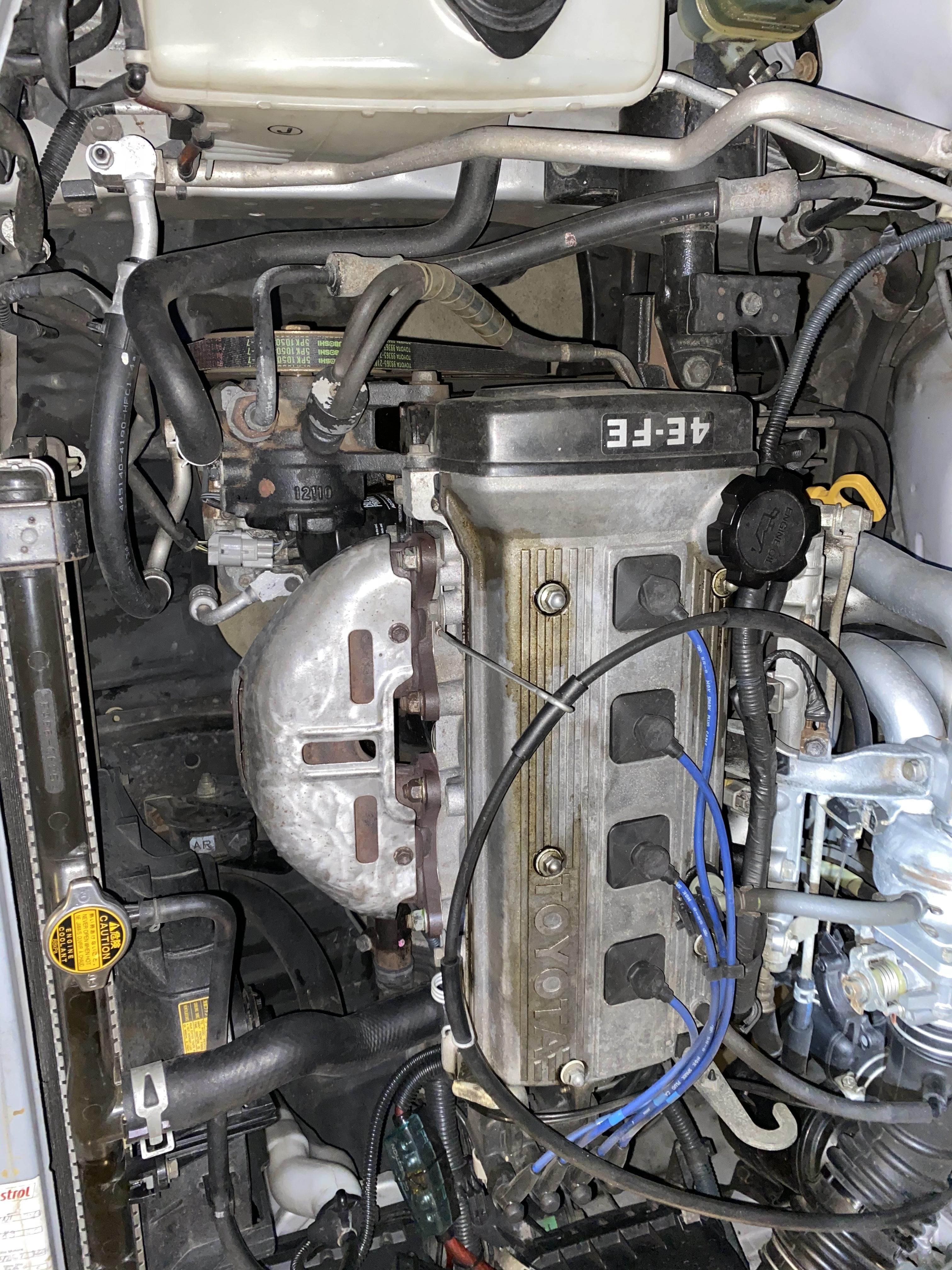

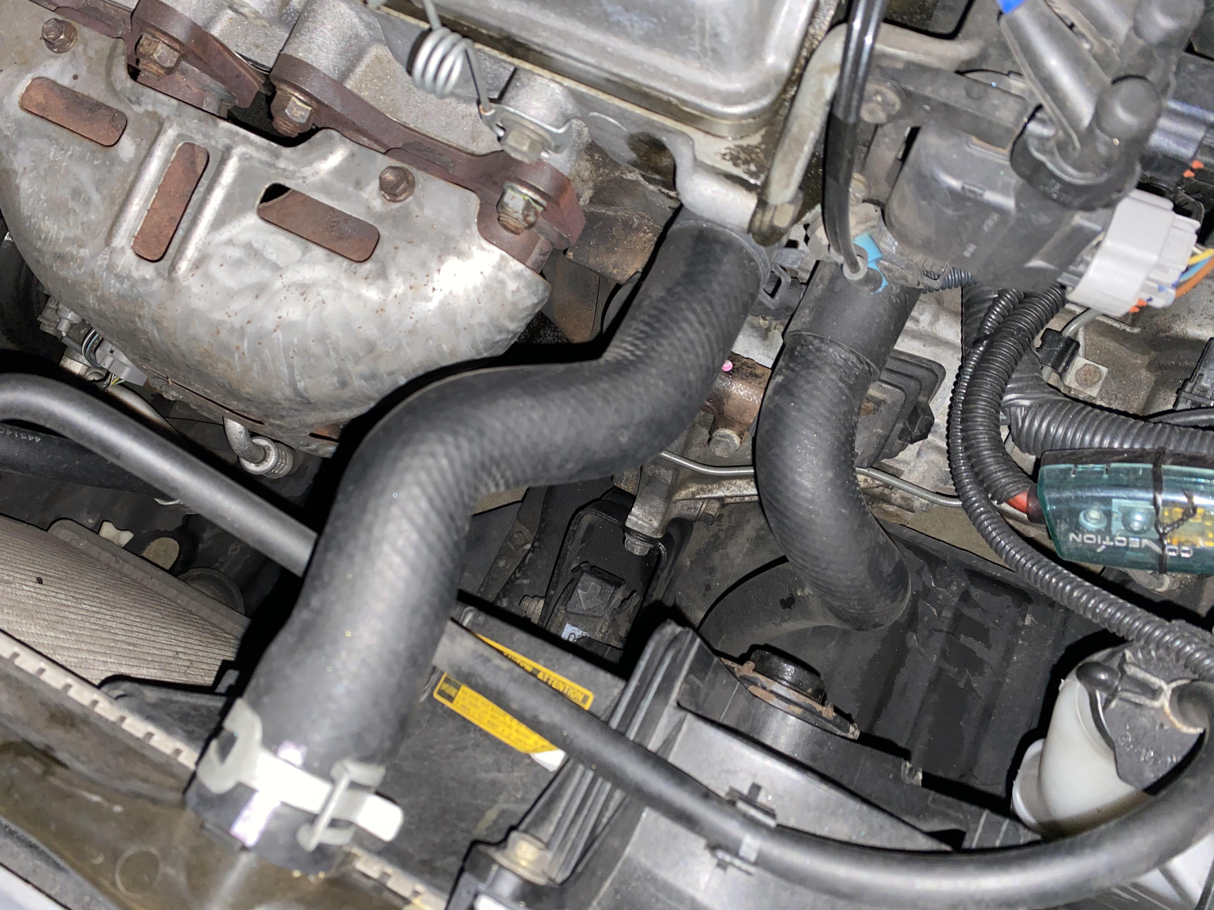

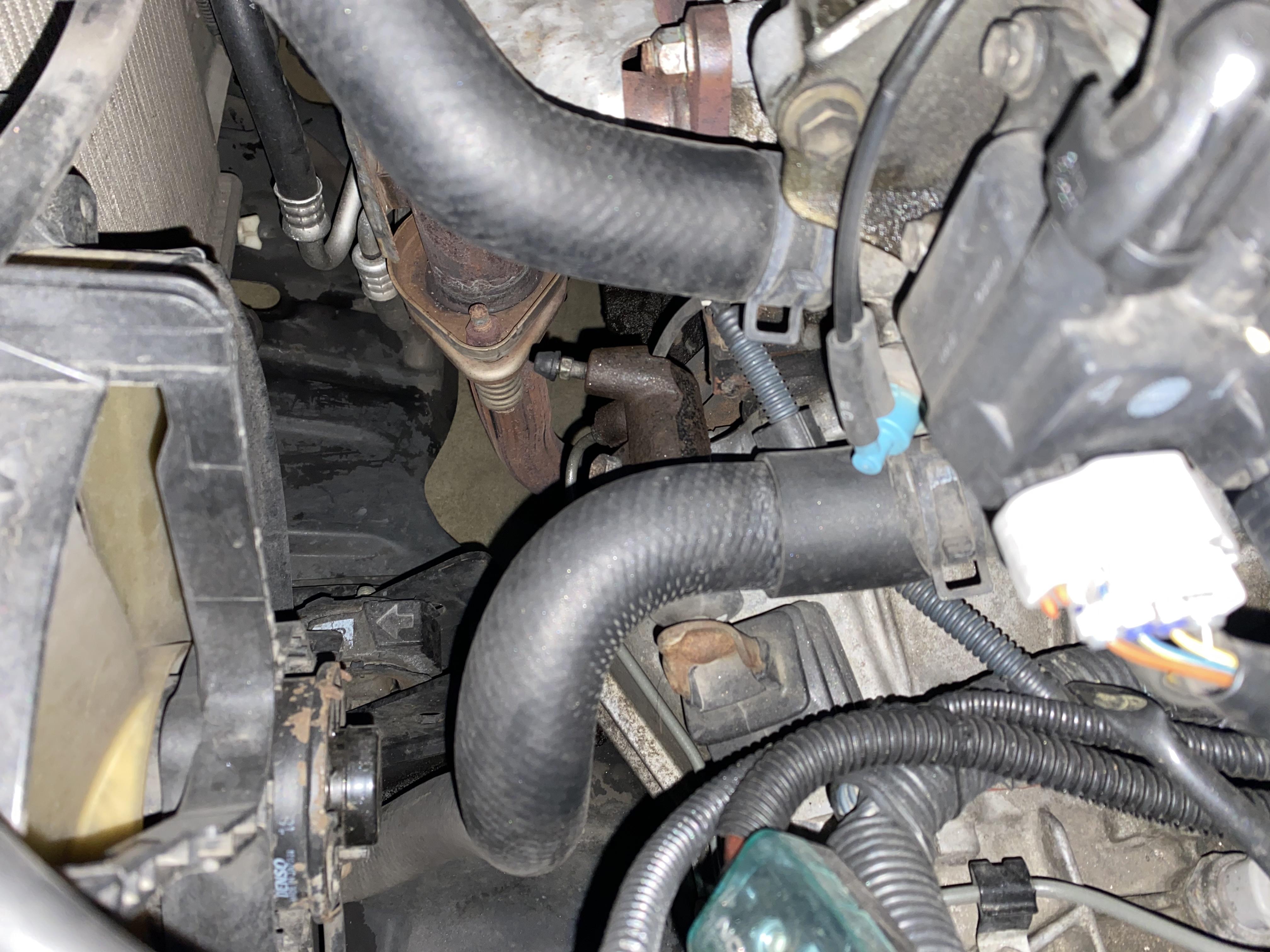

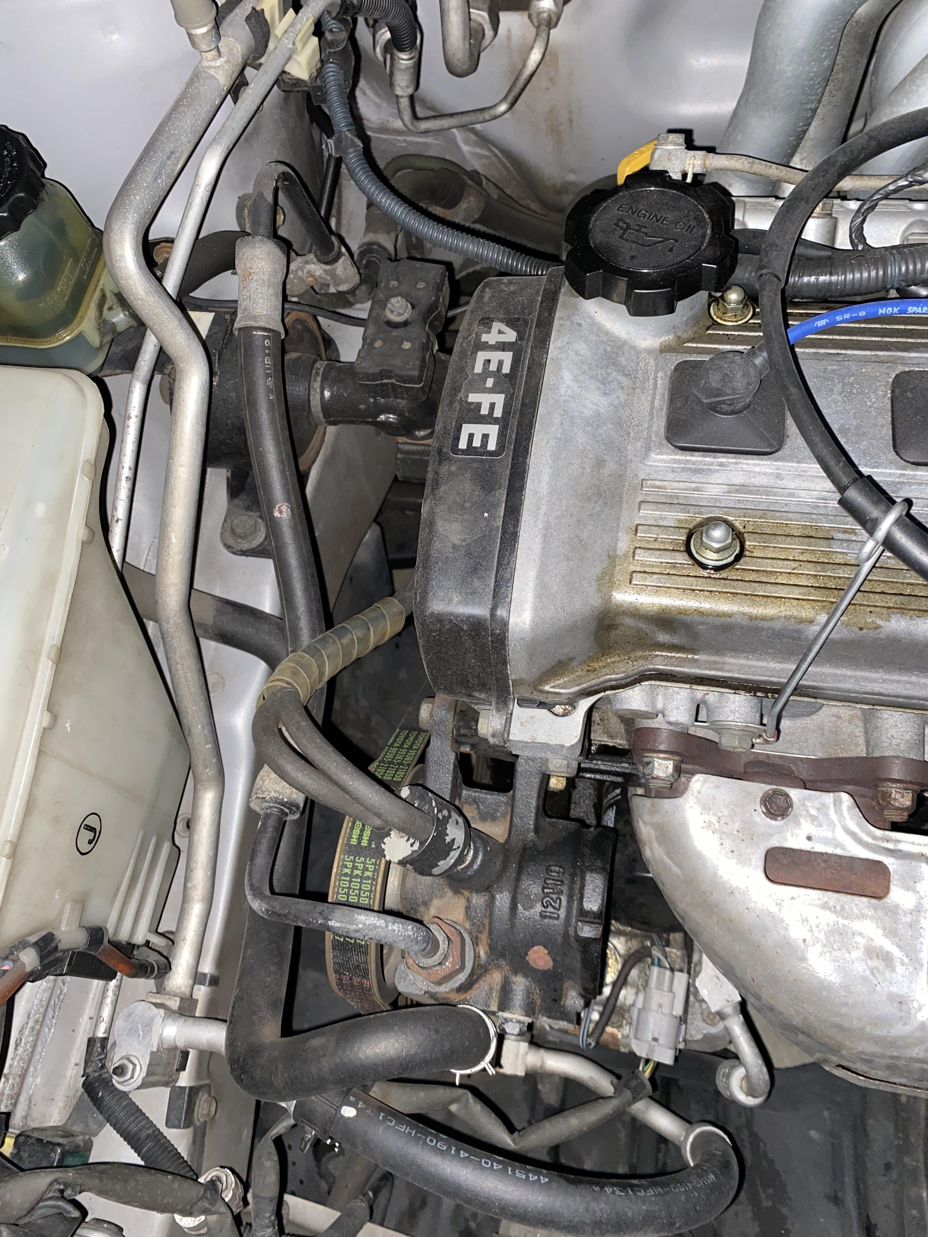

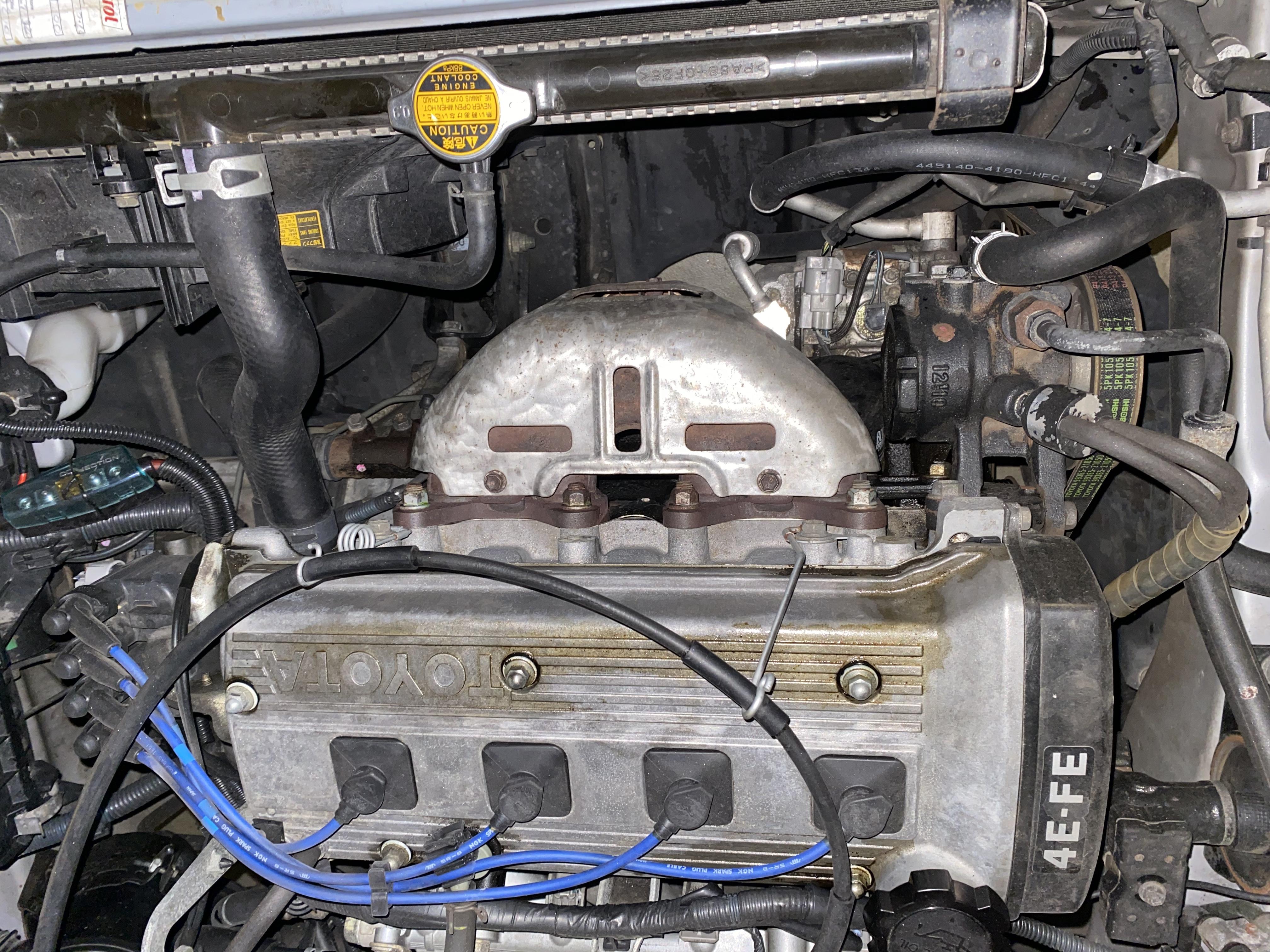

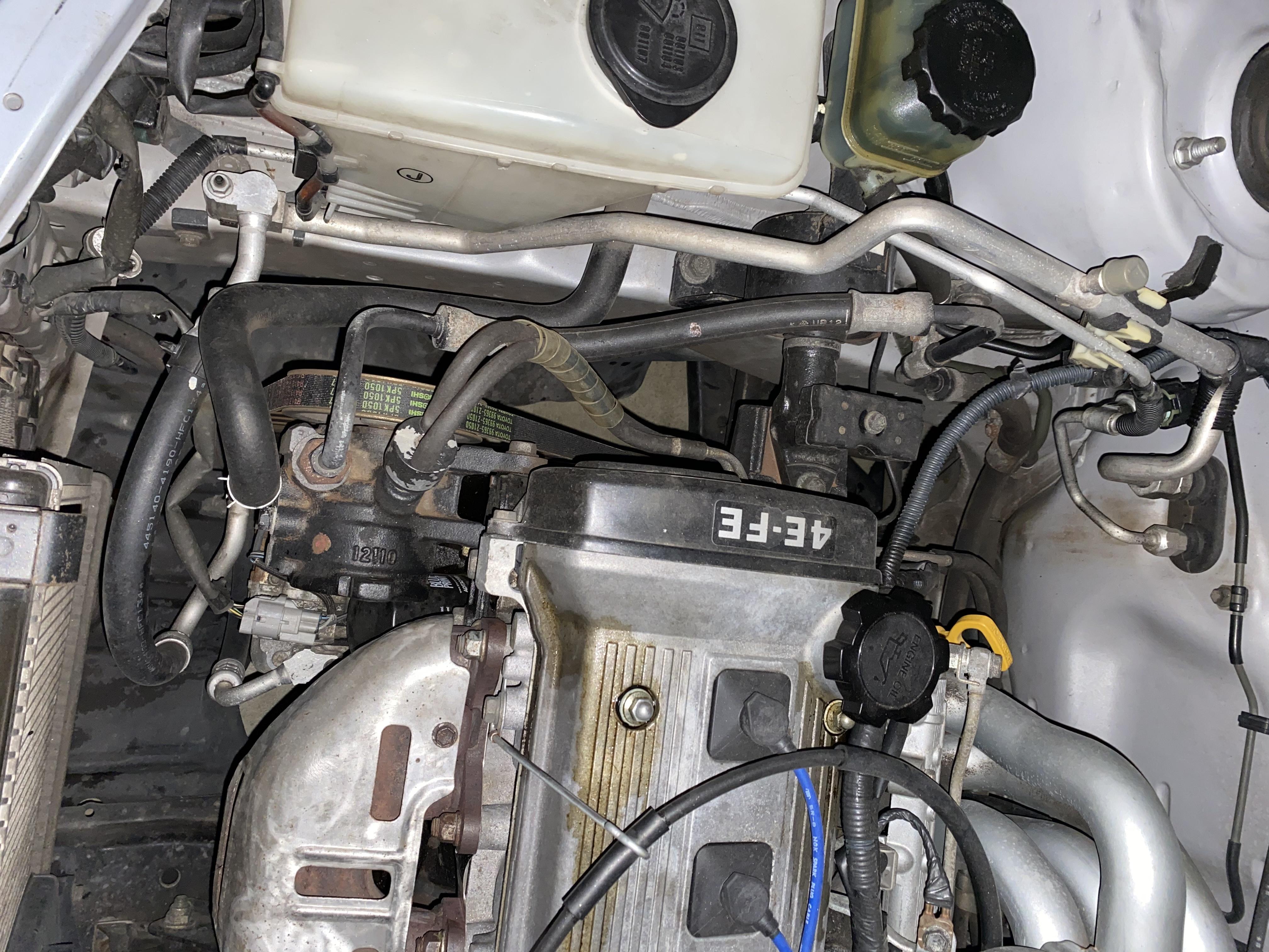

Frankieflowers Posted December 8, 2020 Author Posted December 8, 2020 (edited) I need to figure out which water pipes to buy or if I will have to customize them for my radiator. I checked the code and starlet and corolla radiators are the same. The only difference might be the distance from the radiator to the engine because my car is different. What do you suggest? Should I buy the starlet original pipes or are there pipes that I can adopt? i’m going to post some pictures that show my front right and left engine to show the water pipes and the manifold area. On the left side you can see the AC pump. I would like to keep my pump on the 4EFTE but need to make sure the bolts distance is the same so that Glanza belts can fit. Edited December 8, 2020 by Frankieflowers Quote

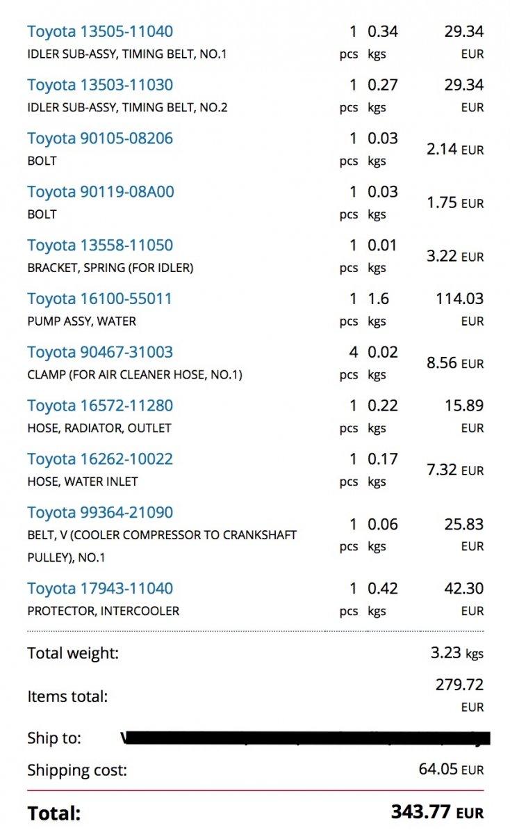

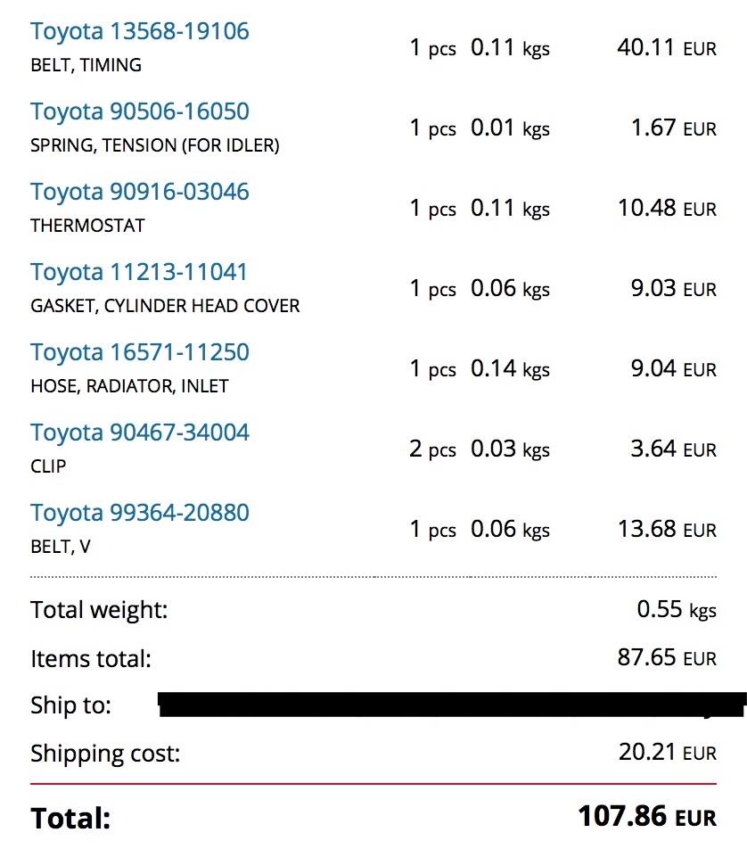

Frankieflowers Posted December 10, 2020 Author Posted December 10, 2020 On 12/7/2020 at 10:06 PM, Claymore said: have used them in the past and they are very good, genuine parts. It’s cool that you get the parts from Europe or those you don’t find here come straight from Japan. Apparently taxes are included. I don’t think I have to pay anything. I bought parts before from the US and taxes were included and managed by the company. check out my list of parts that should complete and engine refreshment. The fuel pump was too expensive. I will buy it from The websites you pointed out. Quote
Claymore Posted December 10, 2020 Posted December 10, 2020 7 minutes ago, Frankieflowers said: It’s cool that you get the parts from Europe or those you don’t find here come straight from Japan. Apparently taxes are included. I don’t think I have to pay anything. I bought parts before from the US and taxes were included and managed by the company. check out my list of parts that should complete and engine refreshment. The fuel pump was too expensive. I will buy it from The websites you pointed out. Hi Frankie, Good list of parts there I don't know how it works in Italy, but in England when we buy from countries outside the E.U. we have to pay Import VAT (20% tax to the UK government), and also the courier in England who will deliver the parcel also charges a clearance fee to arrange the customs paperwork. Hope Italy has less charges! Quote

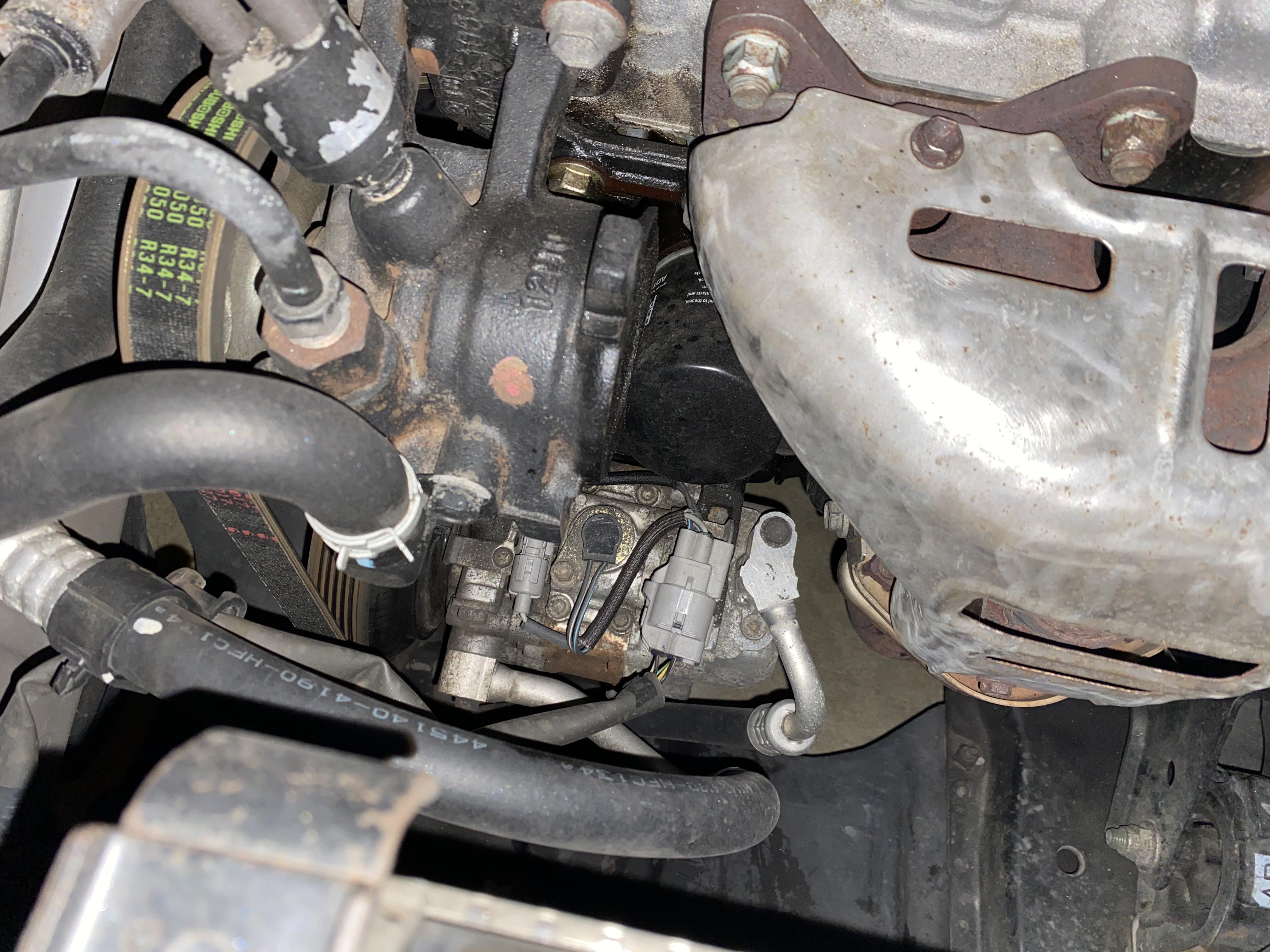

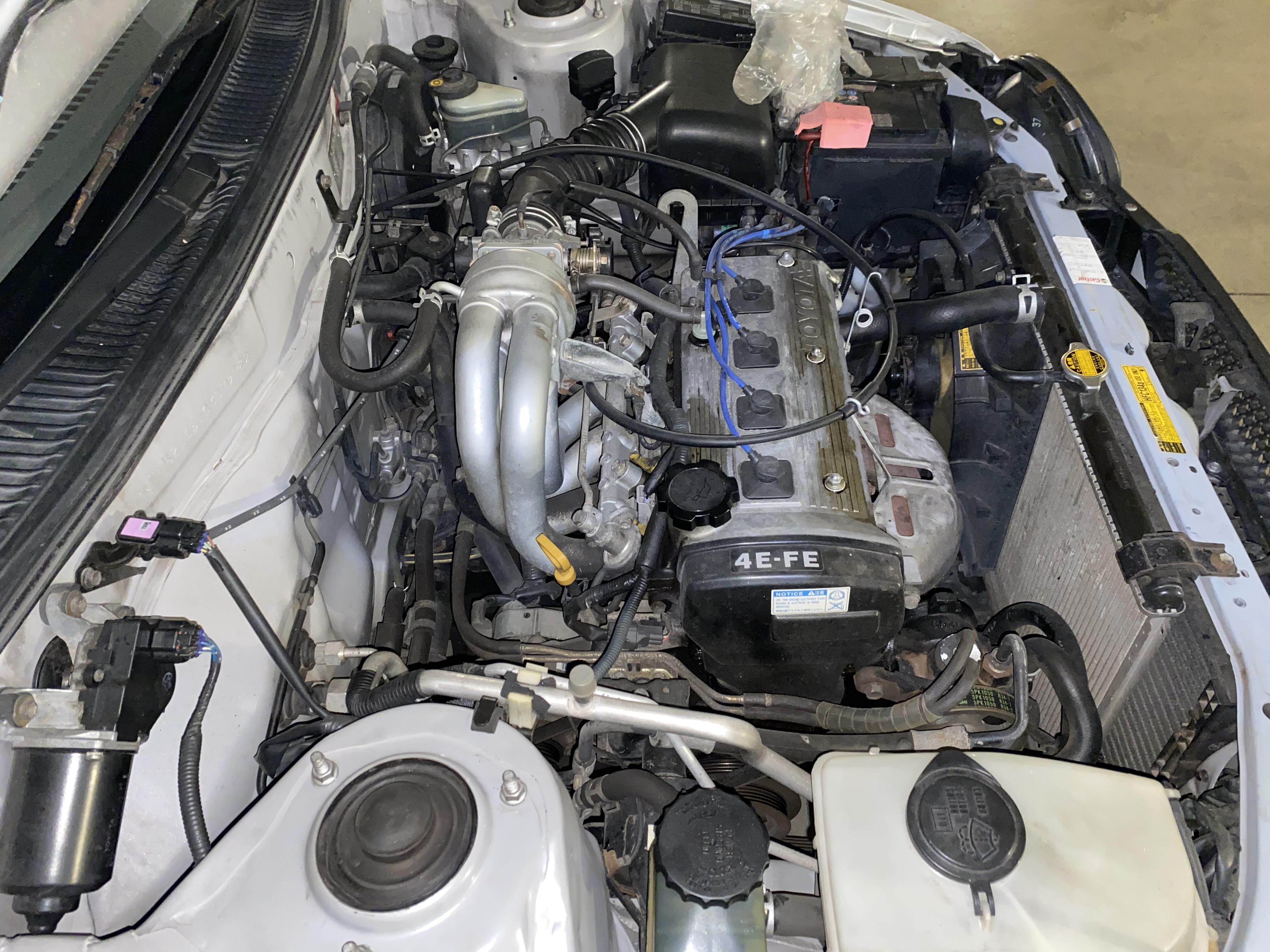

Sam44 Posted December 12, 2020 Posted December 12, 2020 Here now frankie. It's been crazy at work, I'm loving Canada at Christmas. Great place and people. Everyone is gearing up for the holidays. Great pictures of the front engine mount. Nice list of parts. I'll get looking at wiring diagrams now. Quote

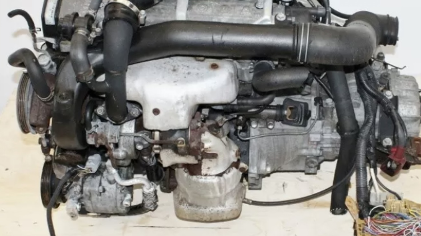

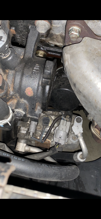

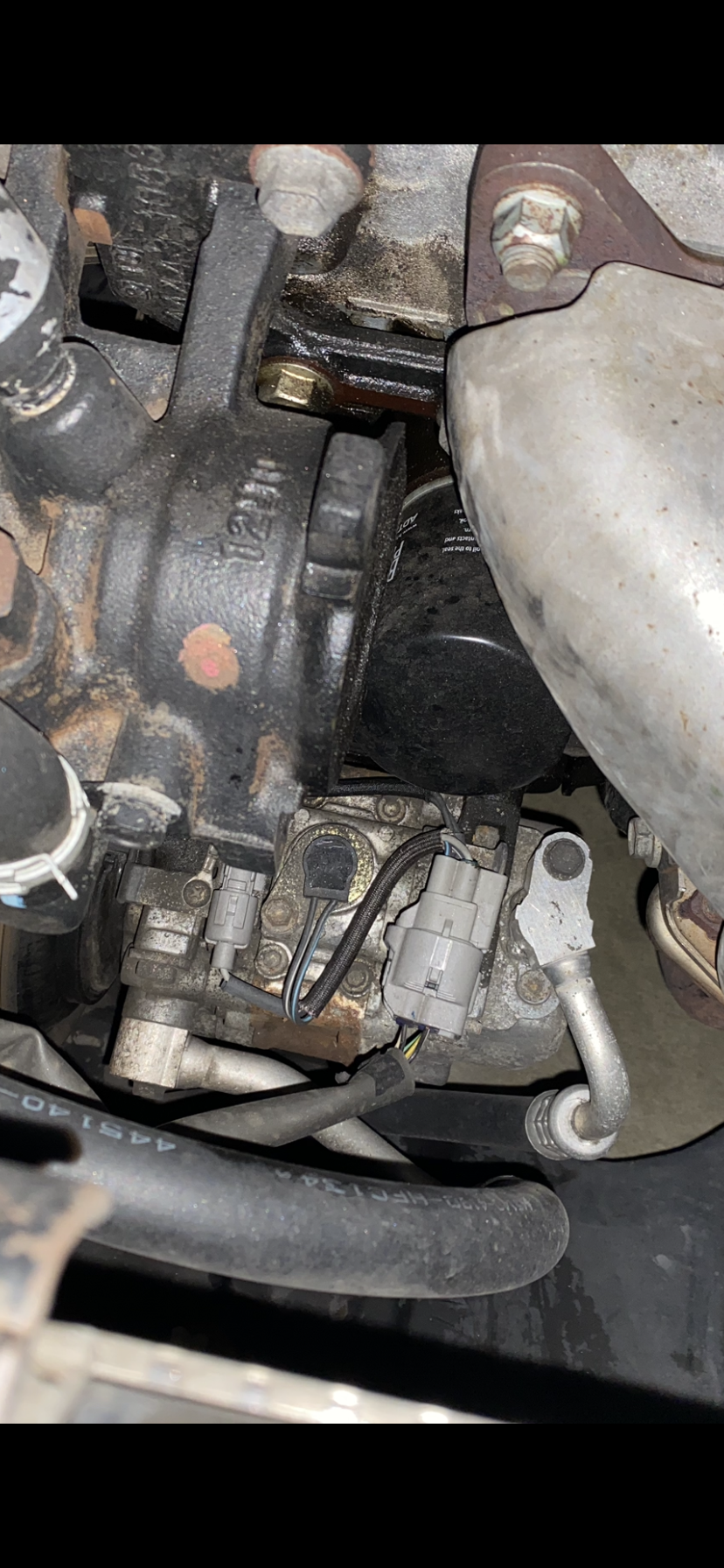

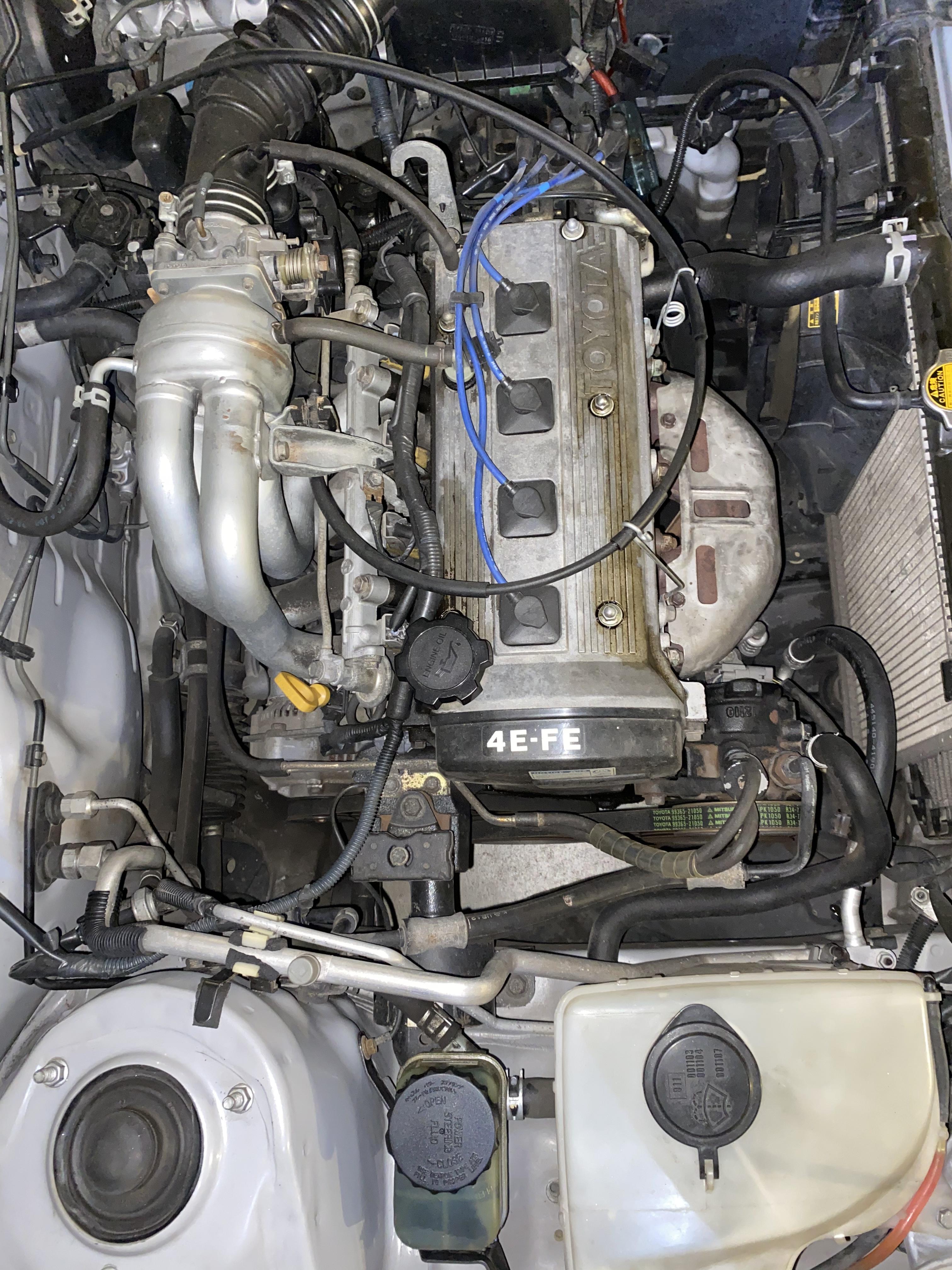

Frankieflowers Posted December 13, 2020 Author Posted December 13, 2020 (edited) 18 hours ago, Sam44 said: I'll get looking at wiring diagrams now. Canada is nice. I’ve played in Toronto once. looking at the last details before I purchase the engine. Should arrive from Japan soon. I took the pictures to check distances between the Corolla gearbox front mount and the 4efte cat to understand spaces. Was also figuring out the Corolla AC pump encumbrance. I never seen the 4efte engine with the AC pump. The 4efe AC compressor main liquid pipe exit is very close to the 4in one exhaust. If you look at the 4efte you’ll see the same pipe almost touching the turbo. Does this mean that my AC compressor will properly fit the 4efte? The AC comps are identical. Apparently 76E7D86B-C889-49CE-8E5D-9E1A7428A08B.webp Edited December 13, 2020 by Frankieflowers Quote
Sam44 Posted December 13, 2020 Posted December 13, 2020 great picture this. you can see that the cat pipe on the 4efte will foul the front gearbox mount and the front to rear cross member. loving all your research so far keep it up ill get into the wiring as soon as i can. hope you and the family are well and are getting ready christmas. Quote

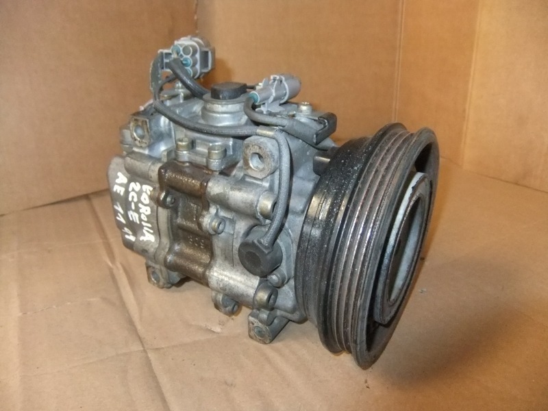

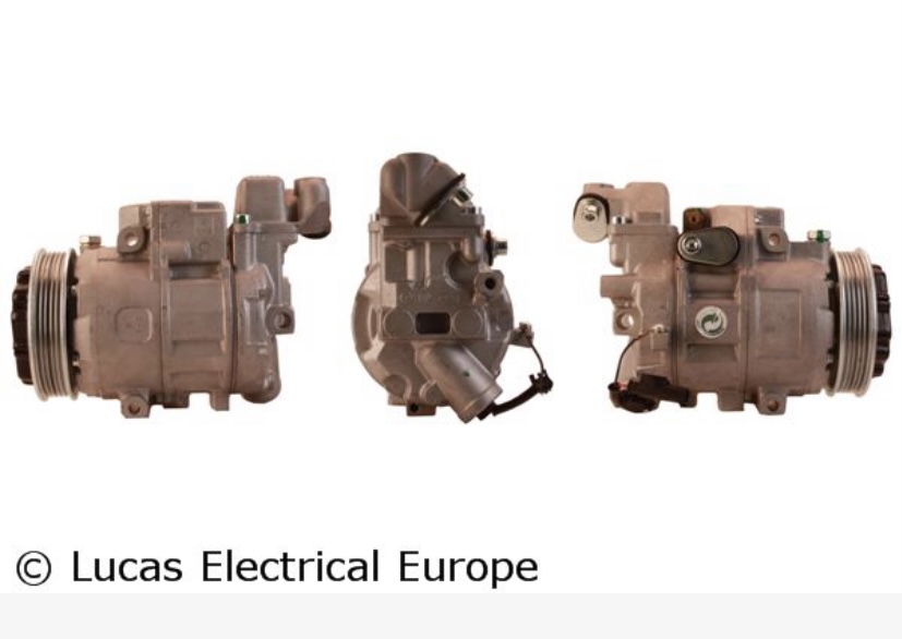

Frankieflowers Posted December 13, 2020 Author Posted December 13, 2020 (edited) 4 hours ago, Sam44 said: I'm not sure on the AC fitment we don't see AC in the UK on the pre 2000 vehicles alot. There is no Starlet Glanza V with AC? i read on an Australian forum that the AC mount holes between 4efe and fte on the Starlet are the same. The compressors look different but hopefully the share 2 holes. Size should be fine as both have the exit pipe right next to the manifold. Fte pump 4efe pump Edited December 13, 2020 by Frankieflowers Quote
Sam44 Posted December 15, 2020 Posted December 15, 2020 not many. they come over with it the ac then gets removed. this area is abit of a gray area for me on these. keep us posted with what you find. Quote
