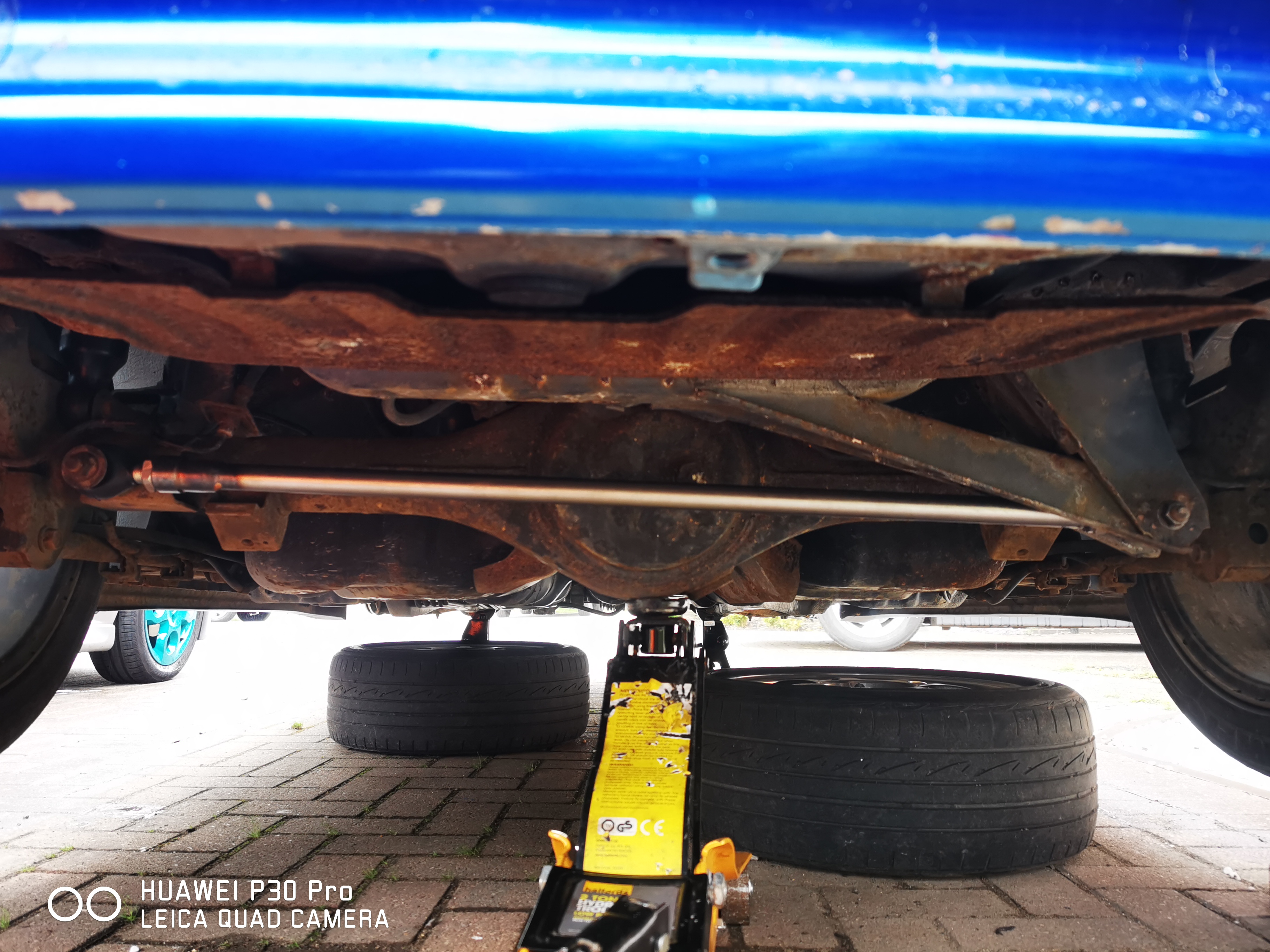

Great car mate. Thanks for those great under car photos of the awd system. I have been looking around for some. I really want to awd my EP71 at this point 😁.
Cant afford a Yaris GR so i will build a lighter version of a Starlet GR 😆
Cheers mate, not sure how easy it would be to awd convert a chassis that wasn't designed for it. Nothing is impossible with enough cutting and welding though.

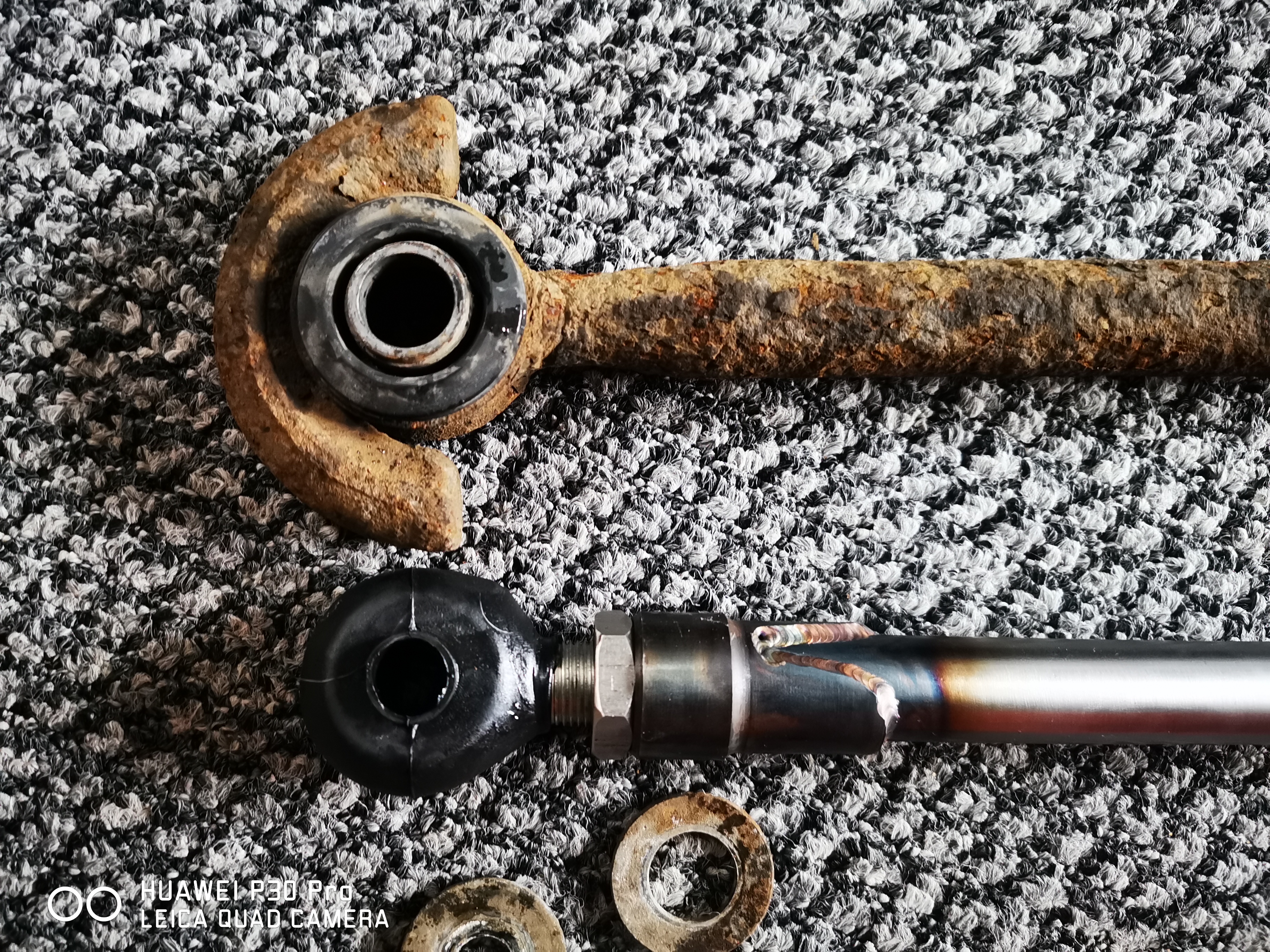

Not much to report, I have been waiting till the new month to tax the car as I didn't want to pay for a whole month and only use it for the last few days, will be off for it's exhaust this week.

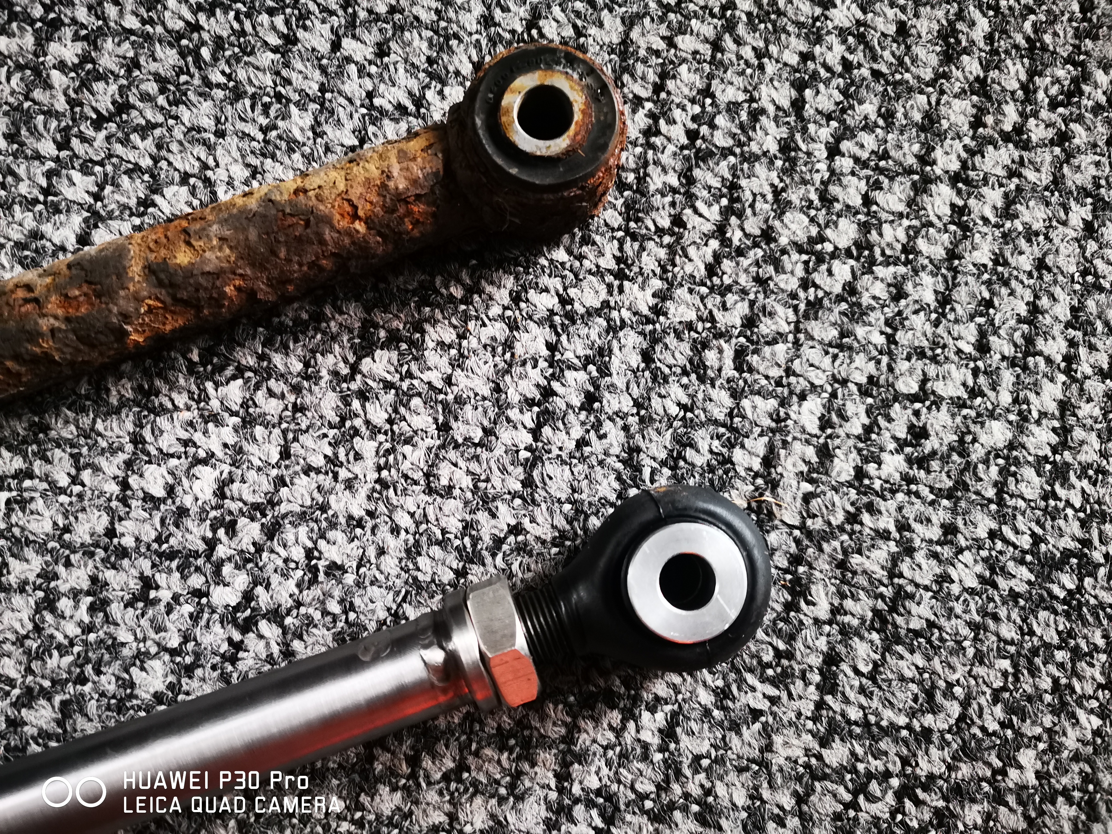

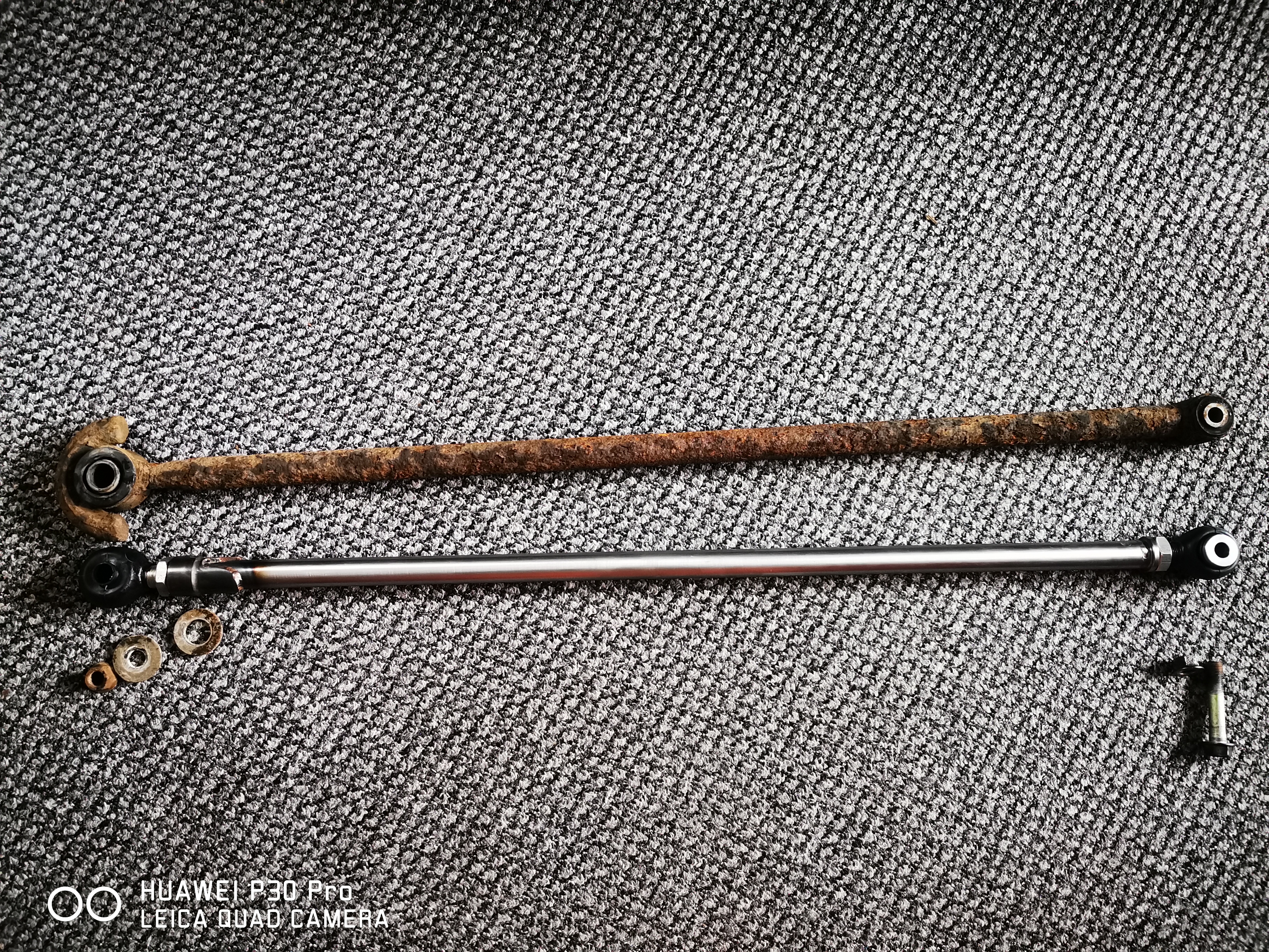

I did manage to get my panhard rod though so that's good.

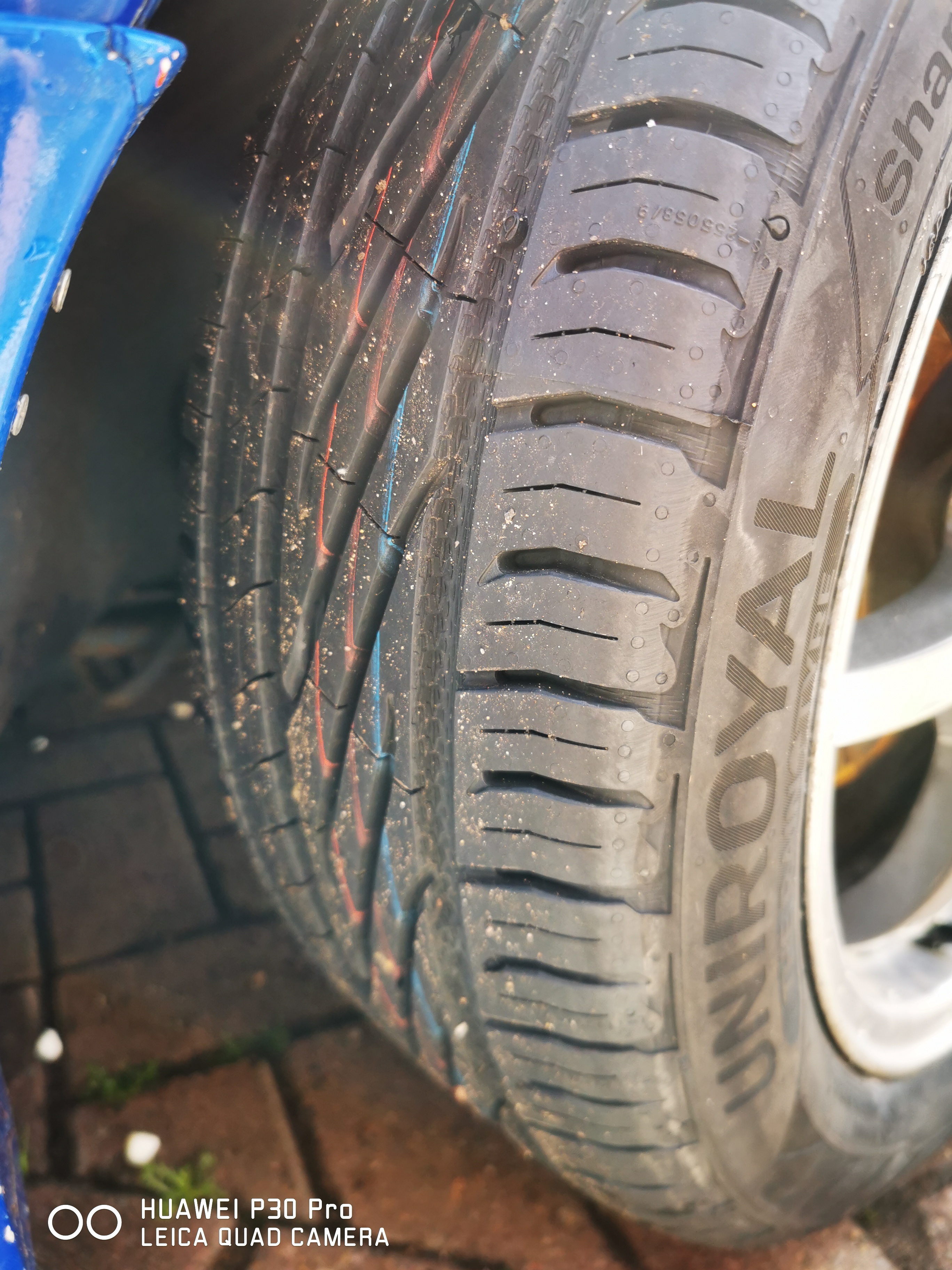

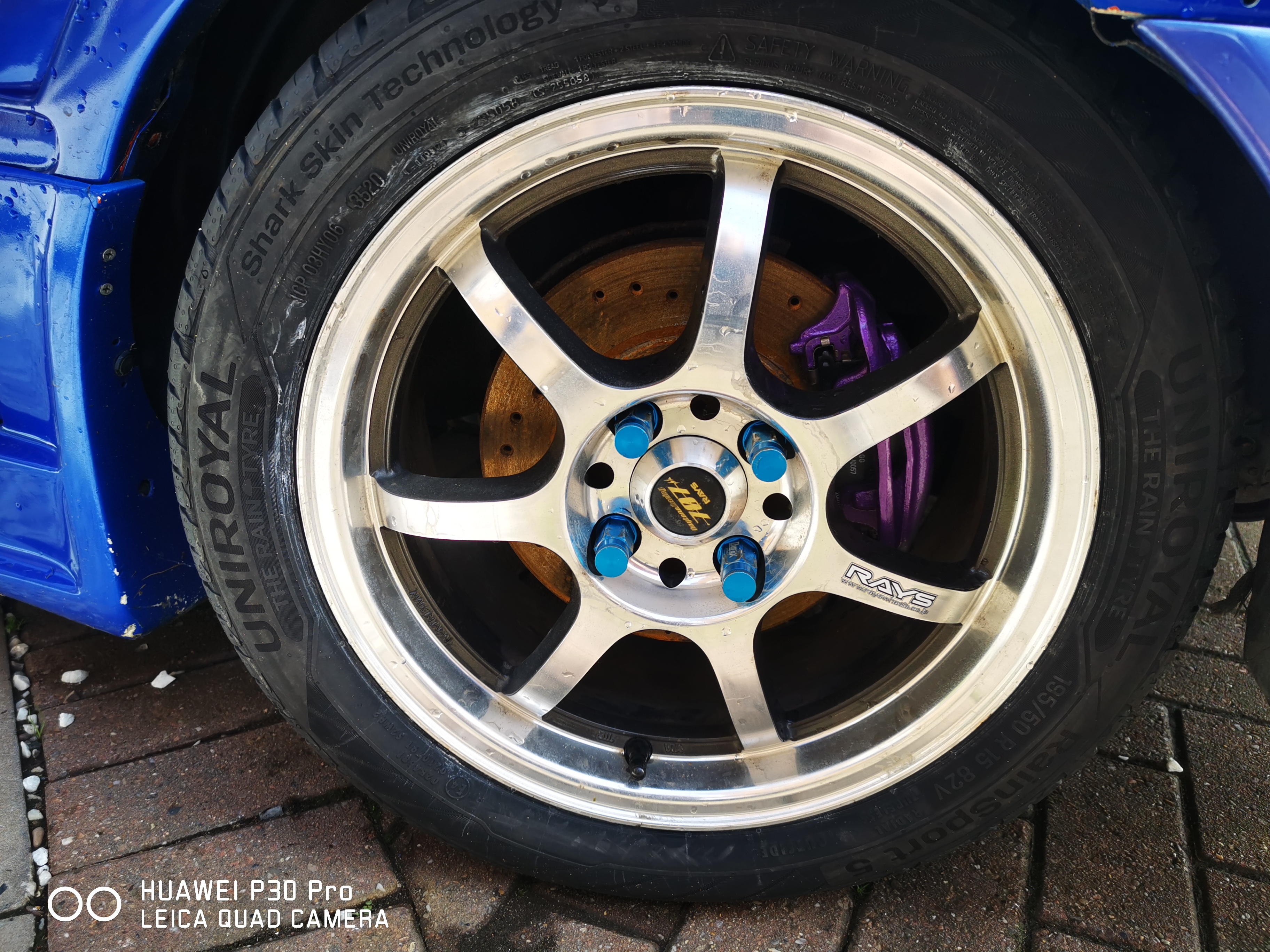

So today's update is, full set of rainsport 5's and more importantly full alignment, the first since fitting the coilovers. The drive has been absolutely transformed, it was scary to drive although I knew it was due to alignment and wasn't using the car for more than 5-6 miles a week. Now it handles beautifully and I can really appreciate how good these coilovers actually are. 😁

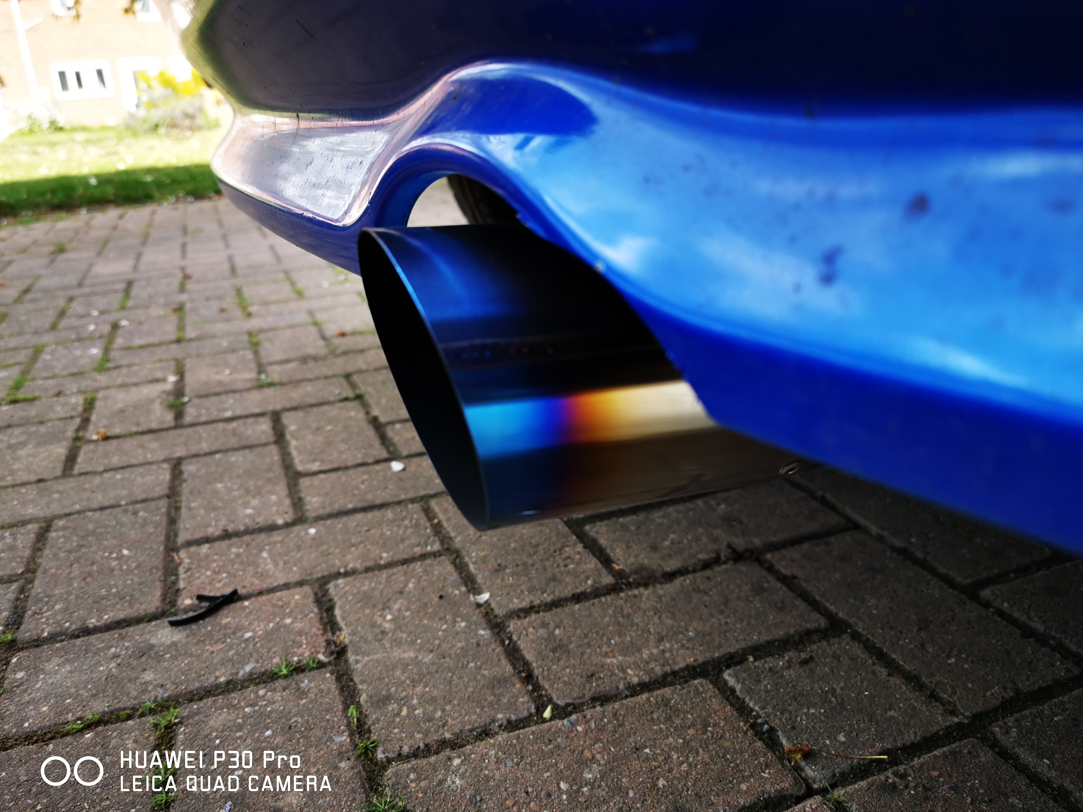

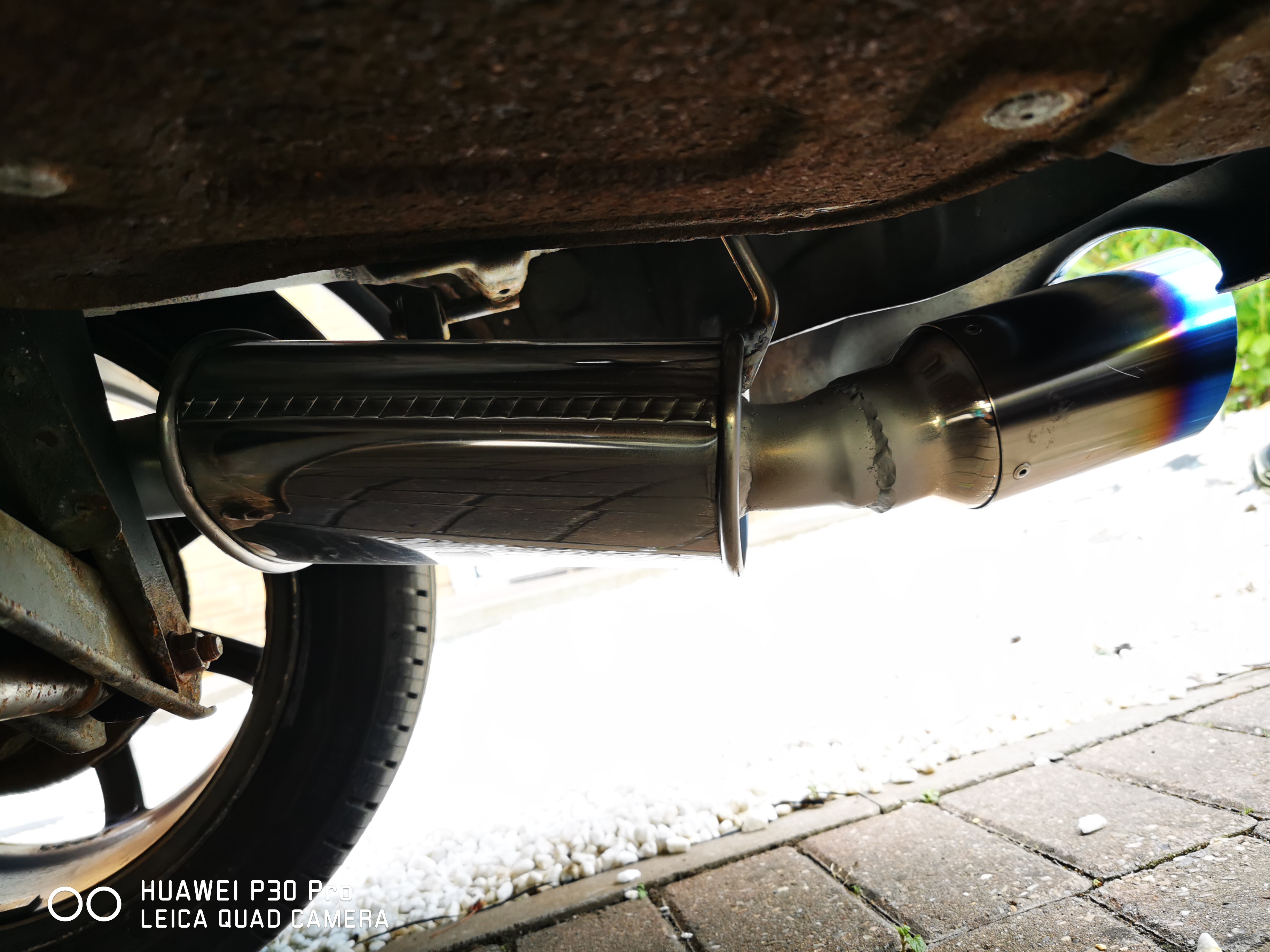

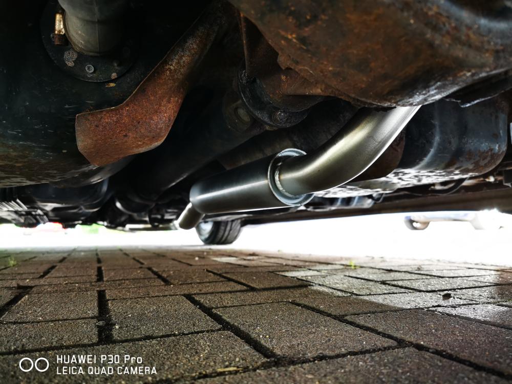

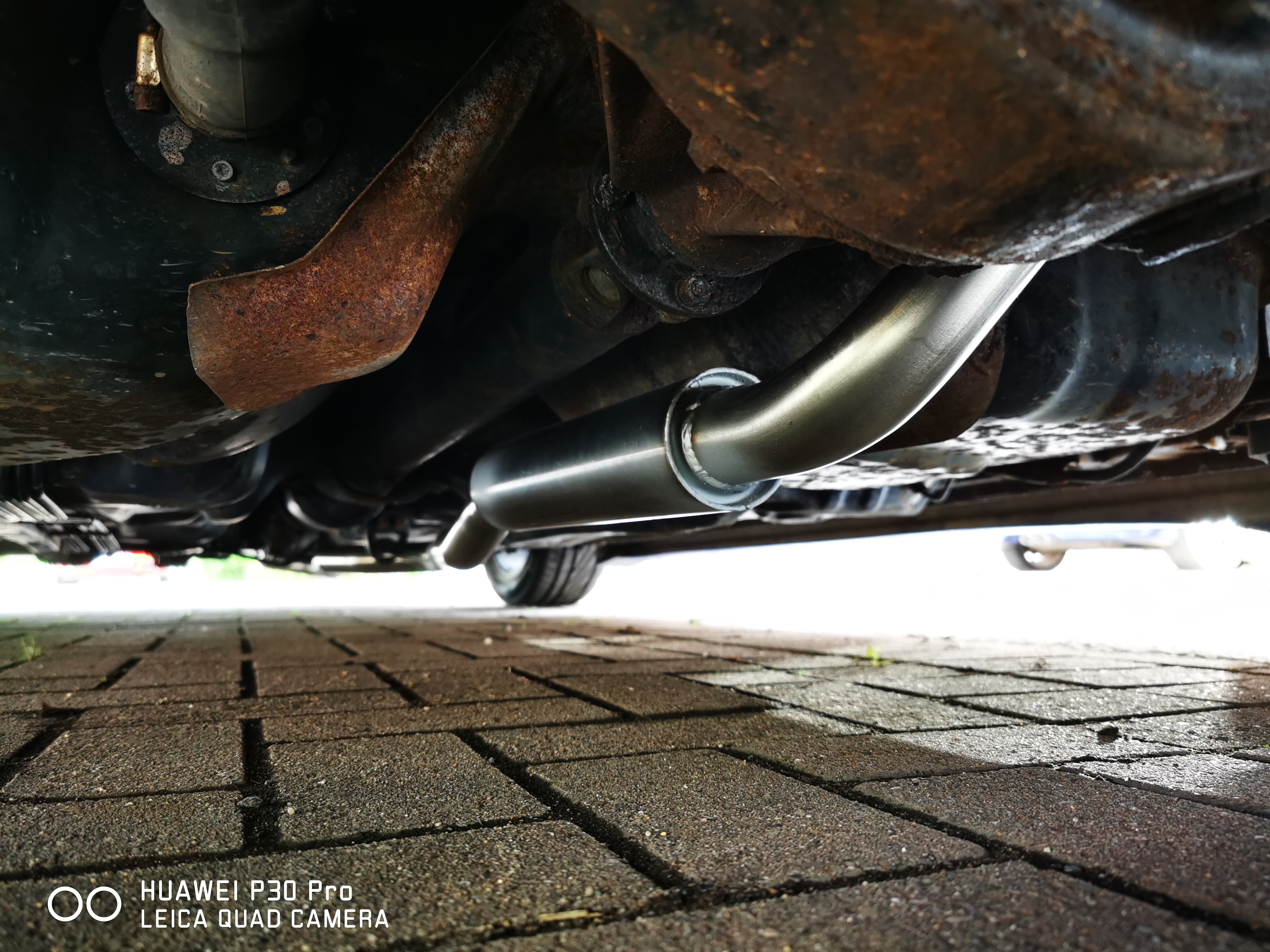

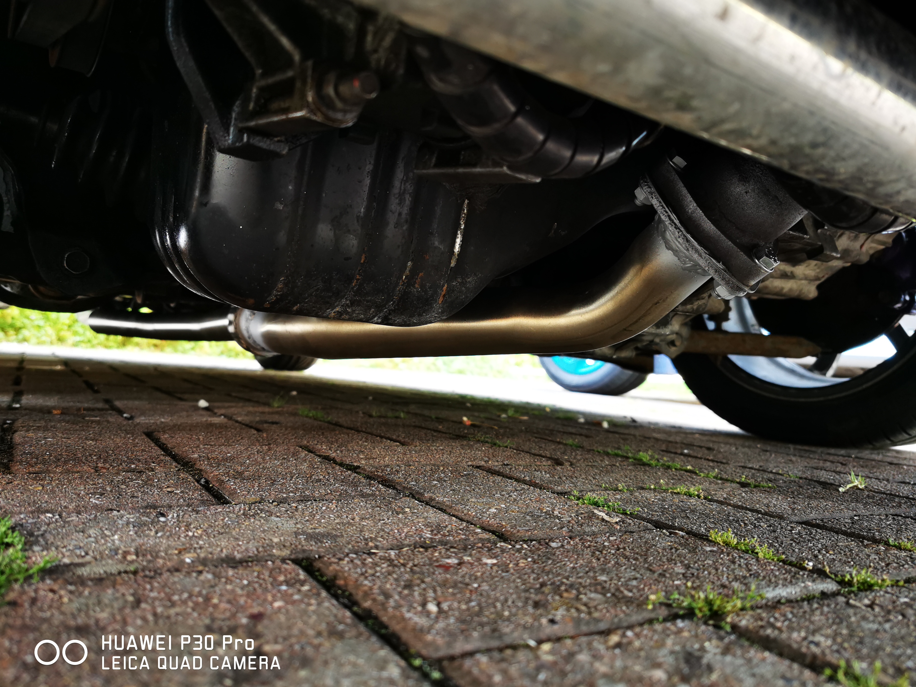

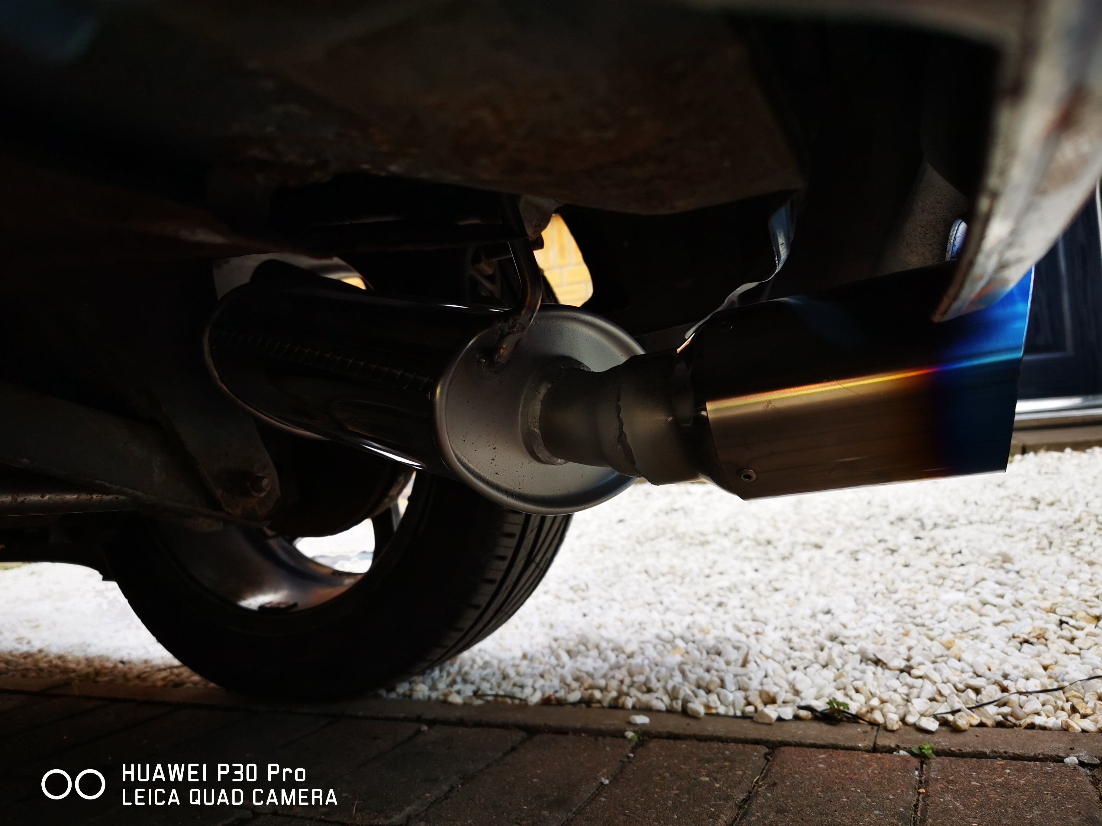

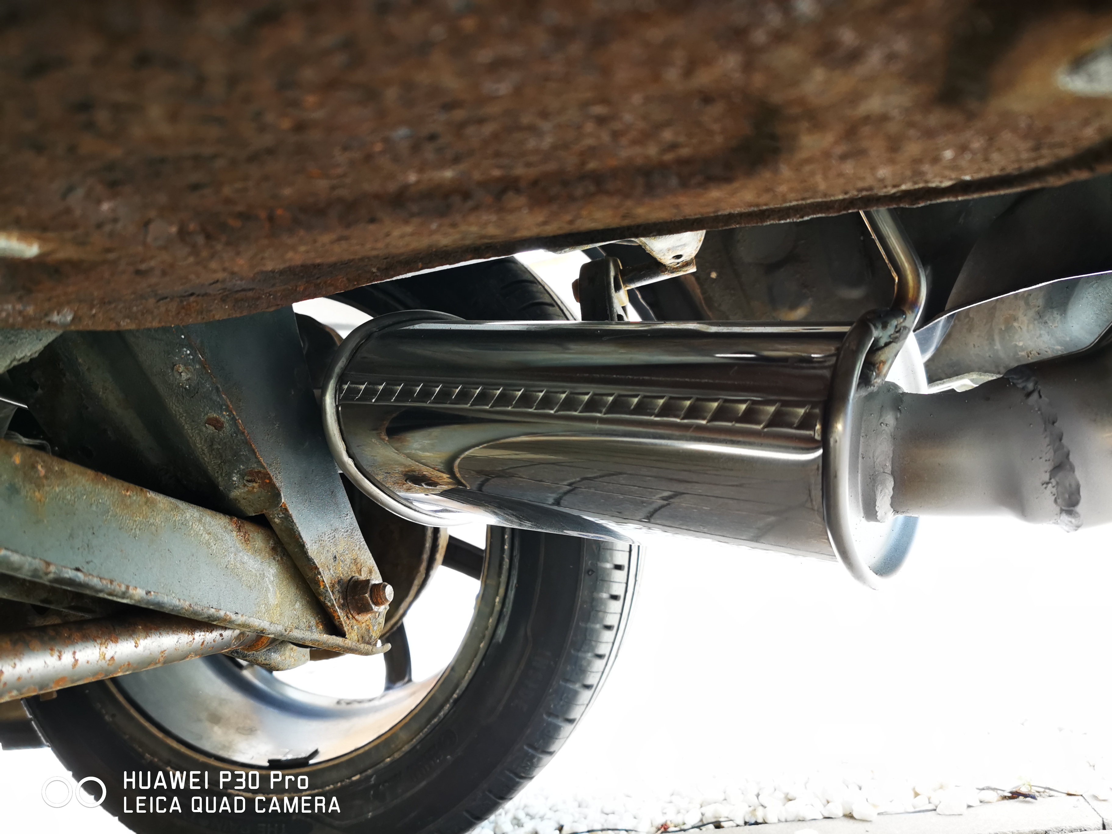

Powerflow exhaust was fitted today, the sound is beautiful. Nice deep sound, not raspy like some even at high rpm. A bit quieter than the abomination that was on there but so much better sounding and as the last system was mostly the original Ep95 pipe it was strangling the hell out of the poor engine. Now that it's got a more appropriately sized pipe it revs better and faster and even seems like its boosting a little higher on the boost guage, only about 1psi higher but still.

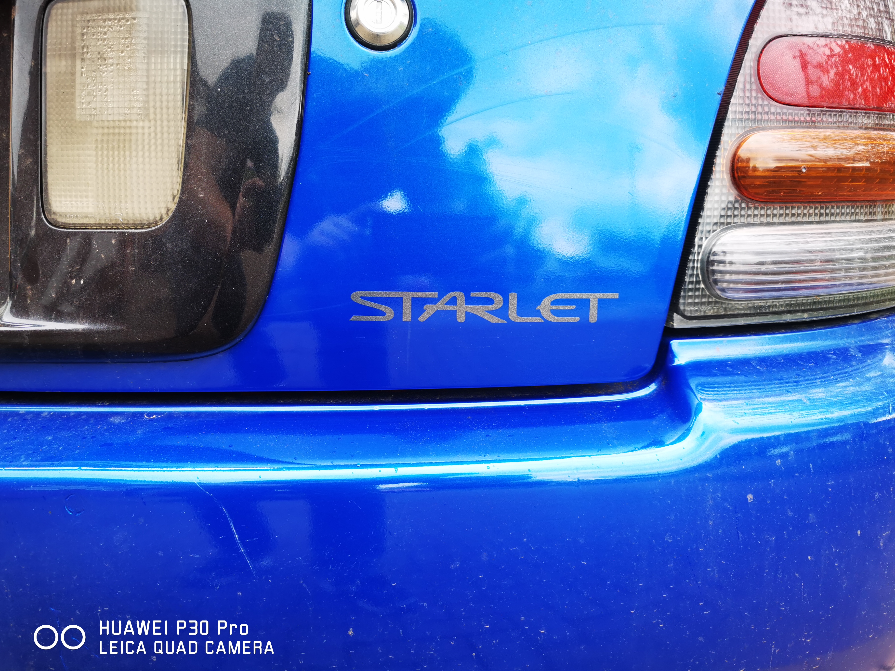

Also got some stickers on to cover at least some of the bad paint.
