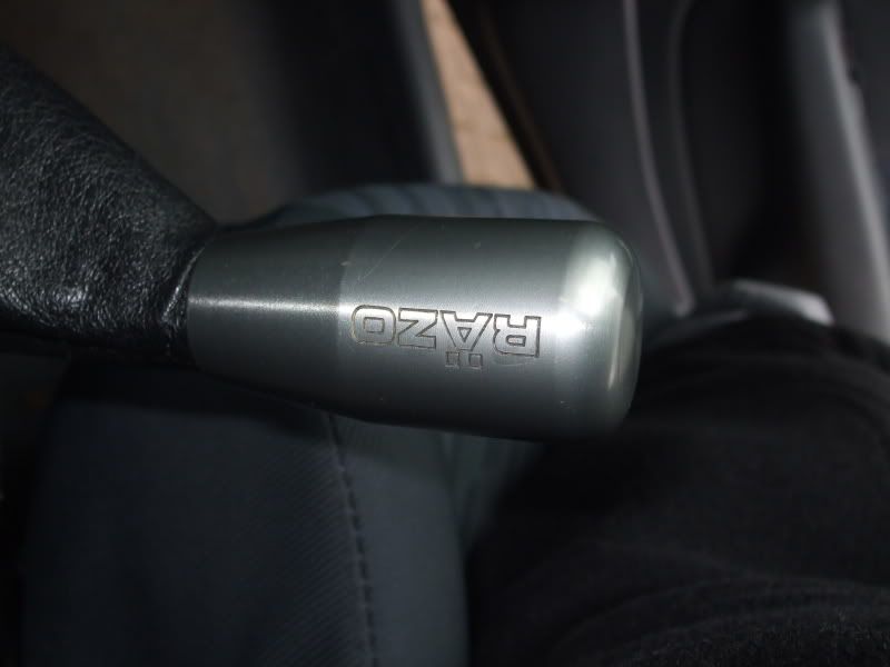

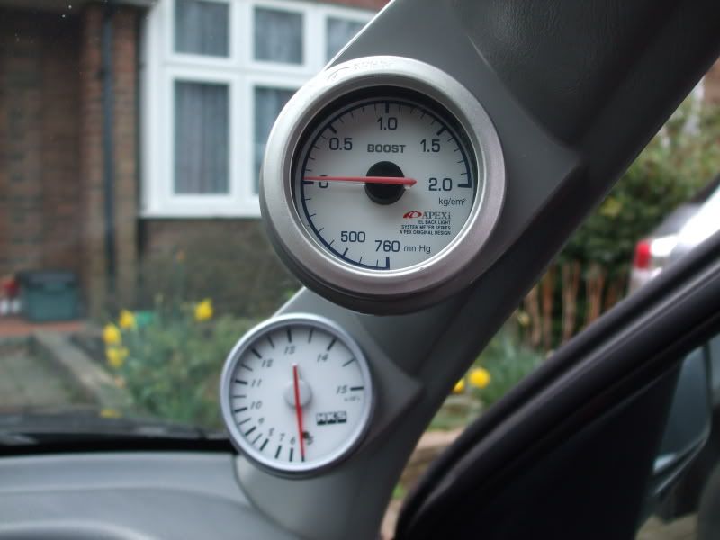

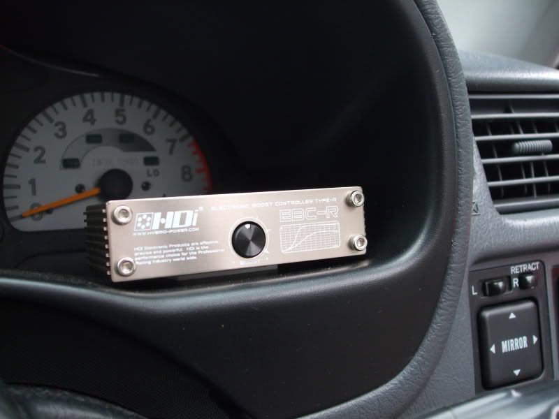

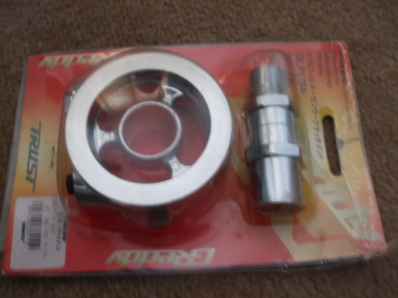

Glanza_cl Posted March 14, 2009 Author Posted March 14, 2009 update time again timing is now sorted, and car is running so much better!...but didn't get time to sort the boost leak out or the over fueling, but it's booked in and all will be sorted soon...turned the boost to stock 0.6 and it still shifts lolas my mani is mild steal when warm it expands so fills the gap...so no boost leak lol so when it's all warmed up it's a good'n but cold she's a bitch to drive LOLhere are some piccy for you all to have a gander:Danes (sps) manifoldfitted (with hybrid)my lovely new gauges and pillar podHDI boost controllerRARBRazo shifter lol- love this thing!Greddy sandwich plate and fse rrfprthink that's about it, will update soon when i sort my car out 100% will then get it back on the RR just to check fueling and hope to see around 160-170 at 0.8bar Quote

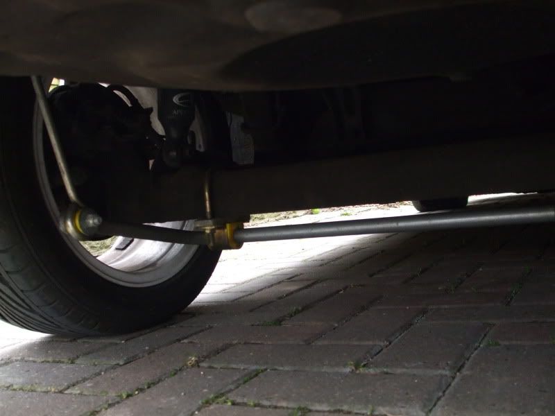

Idrees Posted March 14, 2009 Posted March 14, 2009 Looking good Chris, your ARB looks a bit too high from the back though. I think it needs to be flat but I'm not too sure if its necessary! I see you also got a Razo nob in the end then! I look forward to more progress!! Ps - Where did you get the sandwich plate from and how much? PM me Quote
Glanza_cl Posted March 14, 2009 Author Posted March 14, 2009 cheers buddy,i'm not sure on the arb? it's a fixed one if that makes any difference? and yeah mark(glanza.co.uk) came through with the perfect one at a bargain price! couldn't say no lolpm'd bout sandwich plate Quote

RicoW Posted March 22, 2009 Posted March 22, 2009 i'm not sure on the arb? it's a fixed one if that makes any difference?It should make a difference in theory...I had one modified for my ep71 and wasn't even near to flat but I didn't noticed any difference on a mates ep81...so it would be fine Quote
Glanza_cl Posted March 30, 2009 Author Posted March 30, 2009 Very nice car you got there matey!cheers dude It should make a difference in theory...I had one modified for my ep71 and wasn't even near to flat but I didn't noticed any difference on a mates ep81...so it would be fine i'm not sure if it is suposed to be flat but either way i have noticed a big difference...my car used to allways understear but now i go round in one lol still havnt pushed it to the limit yet.UPDATE while i'm here:it's back at Pacific Works being tinkered with again, manifold is off and has been measured and the face has worped a bit ;) it's out by about 1mil either side, i was hoping it wasn't as now i have to pay a bit more for it to be skimmed but at least it will be back together and running puuurfect again lolalso this is what probably has been causing the over fueling as when i come onto boost and it leaks causing a pressure drop the ecu has been sensing it and trying to compensate...but just resulting in drowning the engine.so Jules had a spare standard regulator which has gone on so i wont be needing my FSE regulator. Quote
