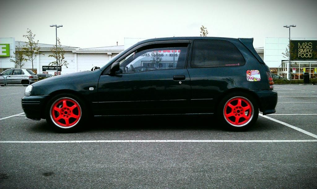

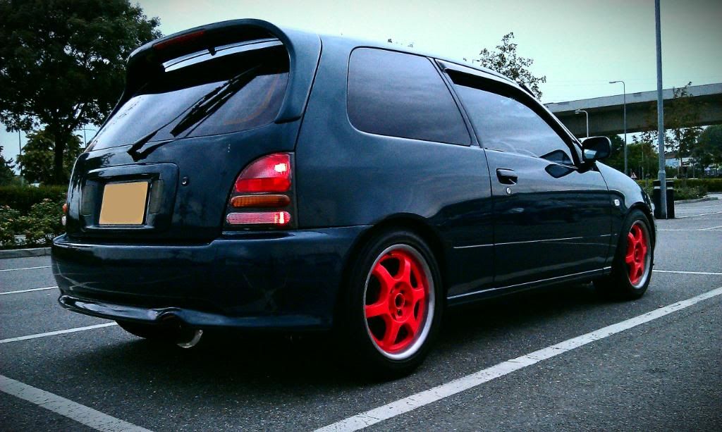

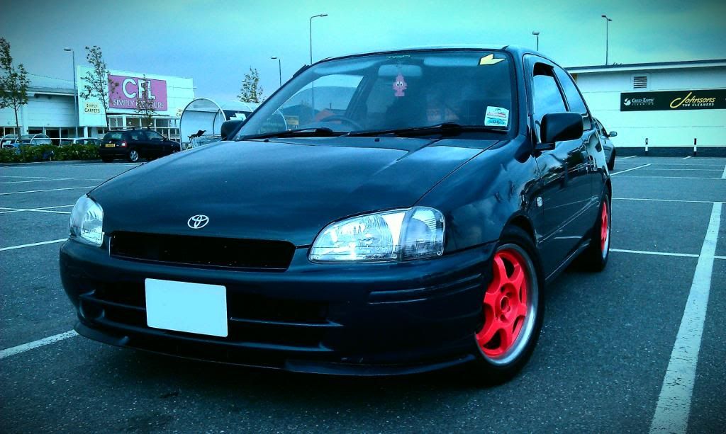

Amjad Posted July 21, 2011 Author Posted July 21, 2011 So the car has finally been taxed, insured and is on the road once again Had a very enjoyable drive last night, forgot how much fun you can actually have in a humble little NA I think the 7th image reflects the colour of the wheels the best, hard getting them to show in pics!Nothing planned now really, just enjoying the frugality and fun of this little thing once again Quote

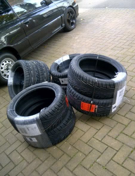

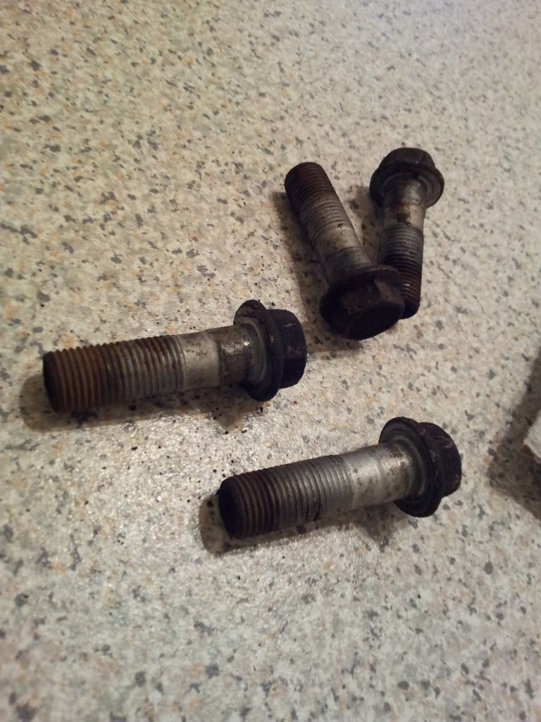

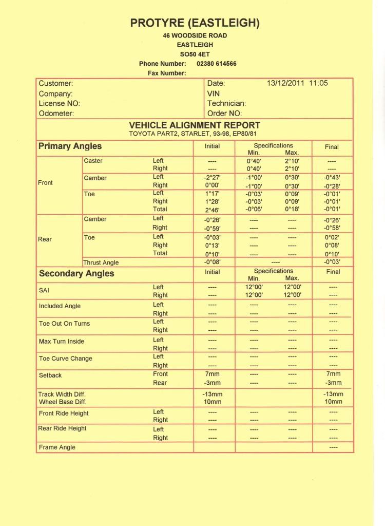

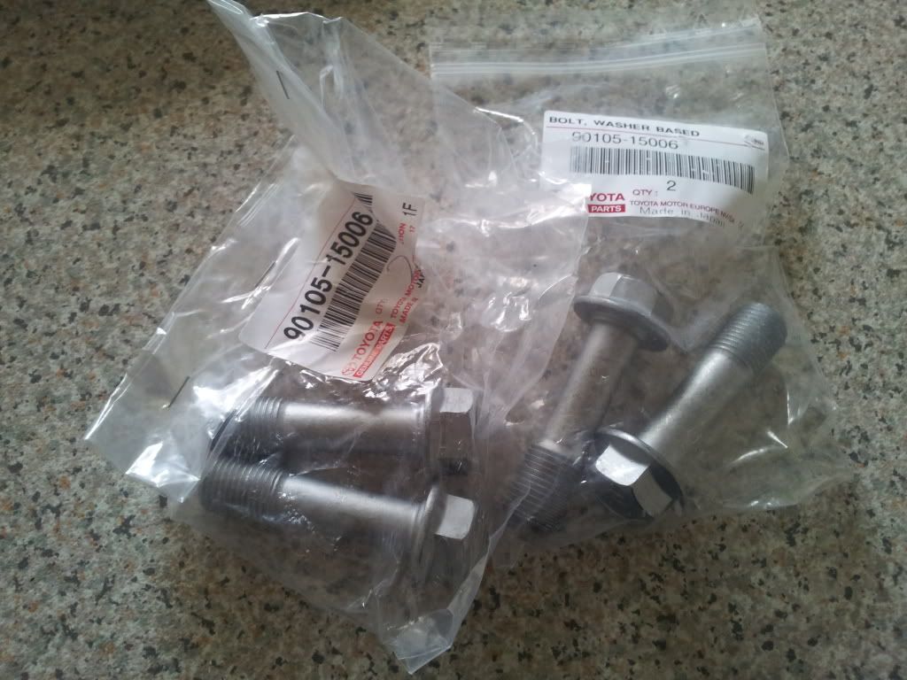

Amjad Posted December 18, 2011 Author Posted December 18, 2011 *Small update*Big thanks to Gary@GBR, Turbo Grant & Shorty, I finally got my tracking issue sorted! Here's the beforeGot new OE strut bolts that allow more adjustment from Gary@GBR (thanks again!) so out came theseAnd in went theseTo give -ive camber ;)And on went a set of Rainsport 2s (put the other set on the Leon)AtDrove back from Southampton to Cardiff on a wet night a few days ago and the tyres are awesome! Handling has improved a massive amount too now but I'm taking it easy due to the obvious dangers of winter driving!Not really much else to say but she's been a reliable runner the past few months, can't believe it hasn't been washed since August though. Anyone who knows me will be shocked reading that haha! ;)Future plans may include getting a bit of paintwork done as the bumper and bootlid paint is cracking, and maybe another surprise on the aesthetics front. Apart from that I'm needing a new clutch and will hope to fit the old GT front brake setup in a week or so! Amjad Quote

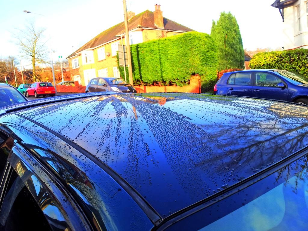

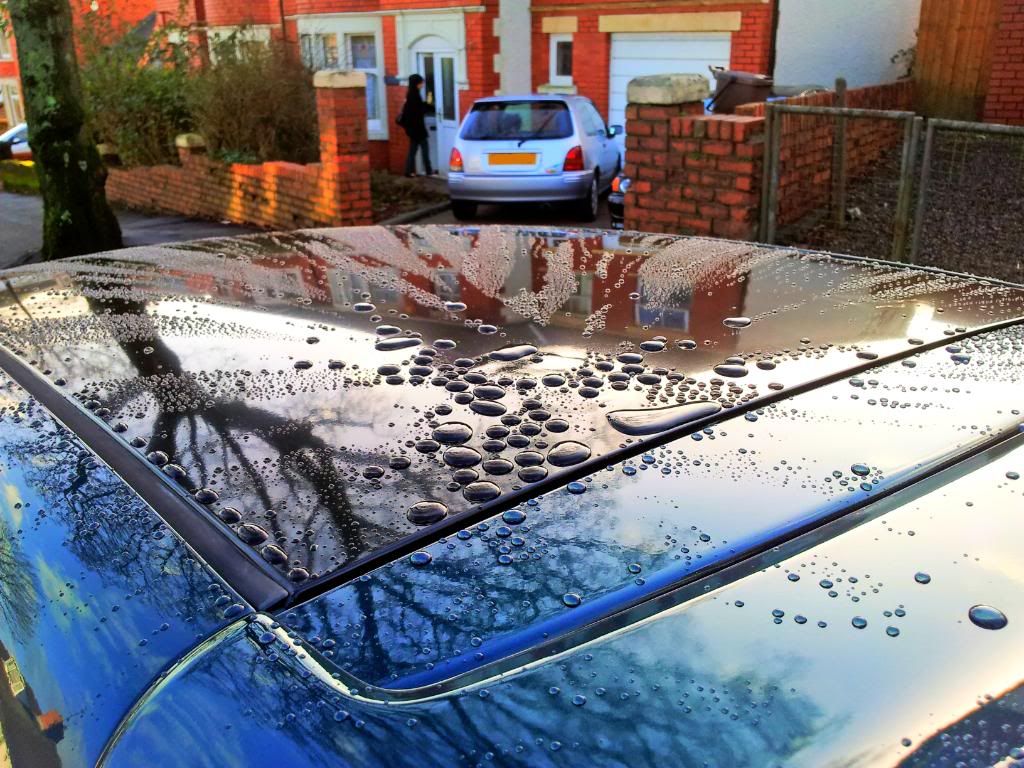

Amjad Posted January 17, 2012 Author Posted January 17, 2012 *Update 17/01/12Thanks to James @ CJ Performance who helped me with getting the old GT front brake setup on this one I used the Greenstuff pads I was using with the NA setup. The Discs are OEM off the GT but are slightly bigger and thicker than the Black Diamond ones that were on the NA so have made a considerable difference! A nice stamp on the pedal stops you well and true without you fearing for your life And it no longer feels like I'm about to rear end people all the time which is nice haha! Well worth doing! Didn't manage to get any pics but there's nothing too special to see really! When the discs and pads need replacing I think I'll get a CRN Disc and Redstuff setup!Also as I was back home I gave the car it's first wash and (kind of) detail in about 6 months -Washed 2x with Meg's Hyper Wash Shampoo-Lights polished with Meg's Compound X-1 layer of Collinite 476 wax all over-Meg's Gold Class Endurance Tyre Gloss appliedApologies the car park pictures are rubbish! Don't show the wheels colour very well either! (PS spot the nice new tyres UR2s ftw!)Check out the beading! Next job on the list is a clutch replacement and some paintwork!Hope you like!Amjad Quote
