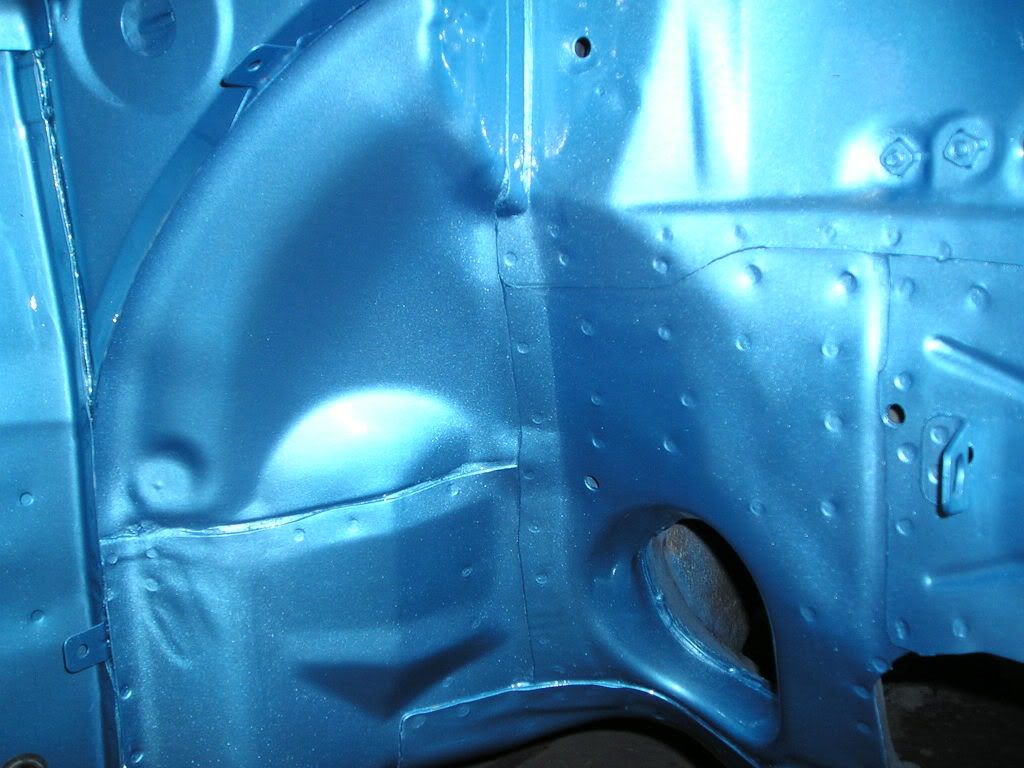

Starlet_GT3582R Posted April 2, 2008 Posted April 2, 2008 Just a quick update for those none believers who think my car will never be finishedI have made a start on removing the underseal from the drivers side arch, it'll then be bare metalled, rust treated (http://www.bilthamber.com/deoxgel.html) to get rid of the dreaded worm that has grasped a few places. Then etch prime it, seam weld it then a coat of zinc rich primer http://www.bilthamber.com/electrox.htmlThe idea is I will do this all over the floor pan as my car has had many years abuse on UK roads. But before I do that I have to manufacture a spit/turning frame to mount the shell on!!Anyway here's some picsMate i know how you feel. i have done this to my front and rear guards, and engine bay. and boy does it take a shit load of your time... but i used one of these on the end of my angle grinder to make the job alot quicker. right down to bare matal.but your reward is the finished product. here is a couple of pict of mine to inspire you. good luck in this build.Cheers Cain D Quote
Nanglebadger Posted April 2, 2008 Posted April 2, 2008 holy shat thats clean! would break my heart to get that dirty!!!nice one Nath dude, now for the love of all thats holy would u please make some decent progress man!!!!!!!!!! i feel i even have to quote YOU nathan....DO ITTTTTT!!!!Phil. Quote
SiCaln Posted April 2, 2008 Posted April 2, 2008 that is simply spotless, awesome mancool parts too man, u gna need holes resized ? Quote
