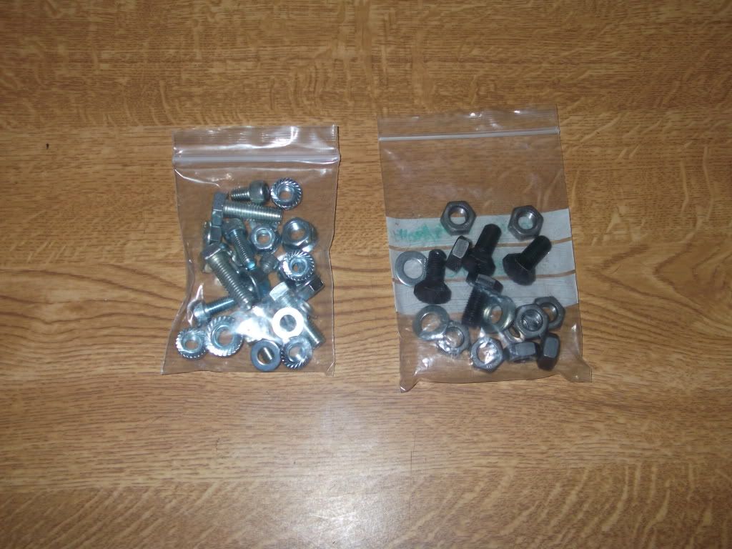

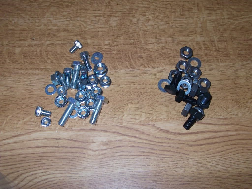

Steve GT Posted January 24, 2011 Author Posted January 24, 2011 Big thanks to Dean @ RW developments for helping me out. Wanted to put fresh nuts and bolts on all exhaust/turbo items but was unsure on sizes/threads etc so PM'd dean and asked for his helpHe very kindly put together a little nut and bolt kit for me and even sorted out an extra additional kit for me too. Big thanks to him for going out of his way and doing this for meThe Kit includes:6 manifold- head fine thread nuts 4 mani - turbo fine thread nuts ( for original studs )4 mani - turbo fine thread bolts (to replace original studs)and also additional kit:2x mate serrated nuts ---- compressor housing4x mate serrated nuts ---- decat-turbo2x m6 serrated nuts ---- water pipes flange2x m6 Allen key bolts ---- turbo blanking plate.2x mate Allen key bolts ---- turbo heat shield2x mate Allen key bolts ---- actuator bracket2x mate serrated nuts ---- oil drain + feed flange3x standard m10 bolts ---- decat- exhaust flange3x standard m10 serrated nuts ---- deacat - exhaust flangeHelps me out so muchTime to get all these put together Going to aim to get the civic Rad mounting kit on tomorrow and get the rad mounted. Plus idrees sent me a headlight mount bar down which should be here wednesday too which means i can get the quad headlights fitted too Engine should have been here yesterday but can't get hold of chris when he didnt turn up. anyone heared or seen him since yesterday? just want to check he's ok as i havnt heared anything lol Quote

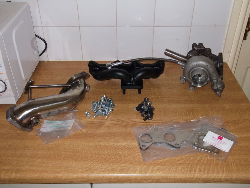

Steve GT Posted January 24, 2011 Author Posted January 24, 2011 haha you tart Just putting mani/hybrid Turbo/decat/braided oil feed etc together now Looks so lush its unreal Quote
Sparky Posted January 24, 2011 Posted January 24, 2011 Hybrid actually looks a bit of a monster Quote
Steve GT Posted January 24, 2011 Author Posted January 24, 2011 Should be will be a good thing just to get that bit more kick as well as hold boost a bit better too Quote
ryan lang Posted January 25, 2011 Posted January 25, 2011 turbo kit looks awesome dude, which turbo is it out of interest? and how much did the lot set you back?get that kit sprayed too Quote
Steve GT Posted January 25, 2011 Author Posted January 25, 2011 turbo kit looks awesome dude, which turbo is it out of interest? and how much did the lot set you back?get that kit sprayed too cheers mateythe turbo's a tongs hybrid matey. Not sure what they usually retail at but i got mine cheaper cause its supposed to be a tester turbo Kit wont be on for a while i dont think now. planning on getting the whole car and kit sprayed at once so i best start saving Quote
ryan lang Posted January 25, 2011 Posted January 25, 2011 so its a ct9 based hybrid then?im just asking around atm because i want to run between 220bhp-250bhp when my conversion is done, without the supposed 'lag' of the td04, and unsure on what turbo to go for to be honest, any ideas? Quote
Steve GT Posted January 25, 2011 Author Posted January 25, 2011 yeah its a hybrid CT9 matewill be good for pushing 220bhp with all supporting mods etc at 1.3 bar boost with no lag at all reallydeffo worth it in my opinion Quote
