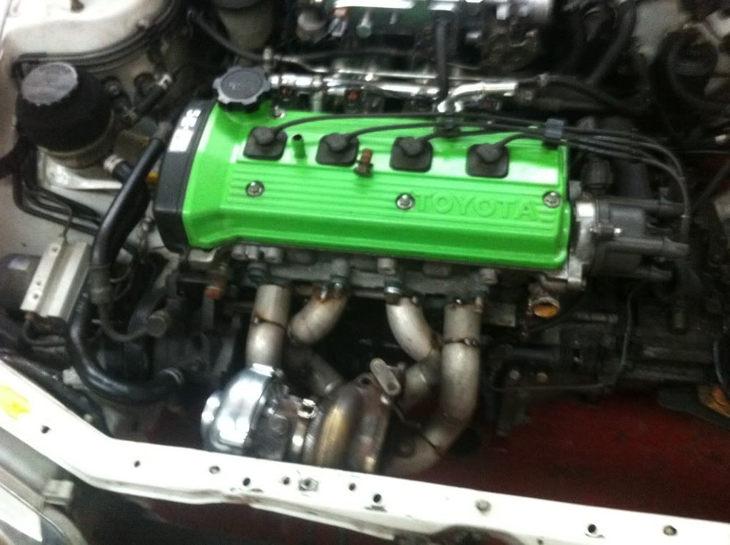

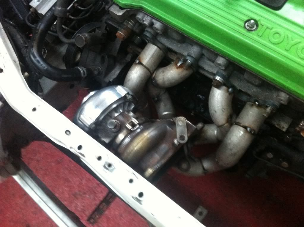

whiteglanzav Posted December 21, 2010 Author Posted December 21, 2010 just another update on this - its all in place and fits lovely just needs the external gate pipe adding to it and the downpipe making up and its good to go Quote

ro55ifumi Posted December 21, 2010 Posted December 21, 2010 Looks sweet Edd nice bit of fabrication Quote
whiteglanzav Posted December 21, 2010 Author Posted December 21, 2010 is this the one that ryan is building ed?it is indeed rob - his skills are unreal - he is still gunna fit an external wastegate pipe to that and then vent it back into the downpipe aswell - its a tight fit !Looks sweet Edd nice bit of fabrication yes john it sure is !!! Quote
Sparky Posted December 21, 2010 Posted December 21, 2010 Not sure if I like it that much tbh :/ Quote
whiteglanzav Posted December 21, 2010 Author Posted December 21, 2010 Not sure if I like it that much tbh :/i know it looks a bit odd from the length of the runners but its also gunna be very functional and will flow well and be near enough indestructible from whats it made of,i LOVE it lol but each to their own opinion Quote
Driver Posted December 21, 2010 Posted December 21, 2010 Just remember length of runnrs isnt going to make it laggy etc, scoobies manies have 2'+ Runners mani looks pretty cool but impo turbos with an internal gate dont look good top mounted :/ Quote
whiteglanzav Posted December 21, 2010 Author Posted December 21, 2010 it aint finished yet bud - its gunna have an ext wg and plumbed into the downpipe too - i know the runners dont change the spool but they do affect the flow of gasses Quote
Driver Posted December 21, 2010 Posted December 21, 2010 it aint finished yet bud - its gunna have an ext wg and plumbed into the downpipe too - i know the runners dont change the spool but they do affect the flow of gassesSorry im garbage at explaining things hahaWhat i meant about wastegate is the exhaust housing is alot bigger due to the fact its got internal gate there and even if its welded up the exhaust housing is massiveJust my peronall opinion I was going to have top mounted but decided to hid my ugly turbo haha.Looks good though pal, however the more important thing is power, best make big power 1.5 bar on stock internals (like me) or 2bar+ if forged Quote
