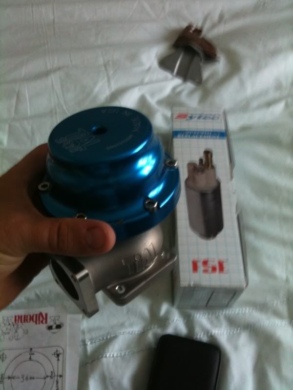

llawgoch Posted December 13, 2010 Posted December 13, 2010 hey people been on the forum a whyle naw so fort maybe it was time i started a build thread to show you all wat ive been up to!i have had a few starlets over the years white sr white ep82 gt alsou built my self a 3sgte ae111 corolla wich was imense i must say!any way naw here is my starlet sr turbo i had it on the rr today it made 226 at the wheels and 265 at the fly wheel running 1.2 barspec listEngine:4efte enginewiseco 10cc dish pistonsscat con rodsacl bearingspolished ported head port matched manifolds5efhe camshaftsrc 440 cc injectorsos giken hyper super singel clutchquaife atb diffzisco td04 kit tial 41mm waistgatemagnercore leadsiridium plugs grade 8alloy catch tank alloy header tankslimline fan custom fmicpipercross airfiltermocal oil coolerhks evc pro boost controllerstack boost gaugestack oil pressure gauge walbro 255 lbh fuel pump Handlingpower flex bushesmeister r coiloversteam dynamic 15 alloysrear disc conversion interior and icejvc head unitstarlet gt seats infinity 6x9s Quote

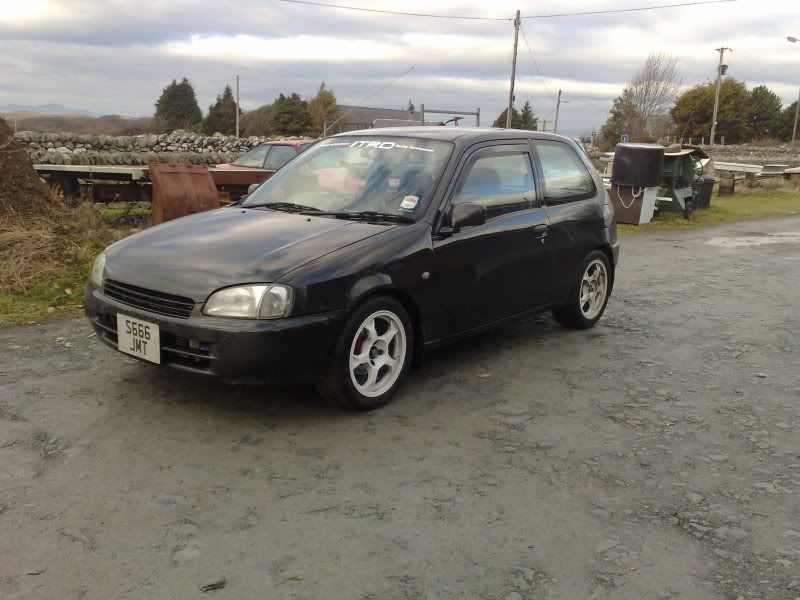

llawgoch Posted December 13, 2010 Author Posted December 13, 2010 the pictures off the sr are old ones i wil update tmorrow with pictures off every thing i wil alsou try and get pictures off my corolla for you mate Quote

Sparky Posted December 14, 2010 Posted December 14, 2010 Needs some new pics with the Meisters, epic sleeper though Quote
Liam_D Posted December 14, 2010 Posted December 14, 2010 Looks awesome!! We need some better/new pics though. Quote

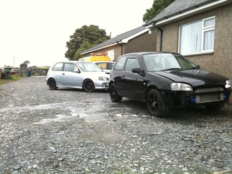

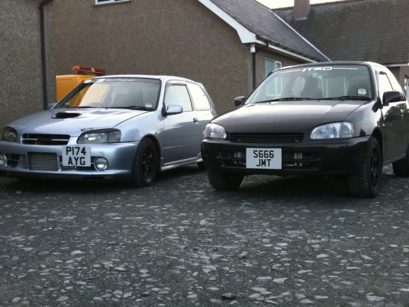

llawgoch Posted December 14, 2010 Author Posted December 14, 2010 some newer pics for you guys!wil put more up soon!! Quote
Amjad Posted December 14, 2010 Posted December 14, 2010 Beast! I bet this shocks a few cars out there Quote

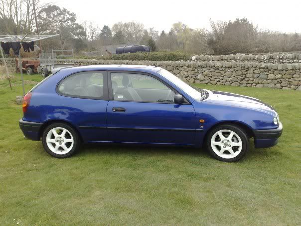

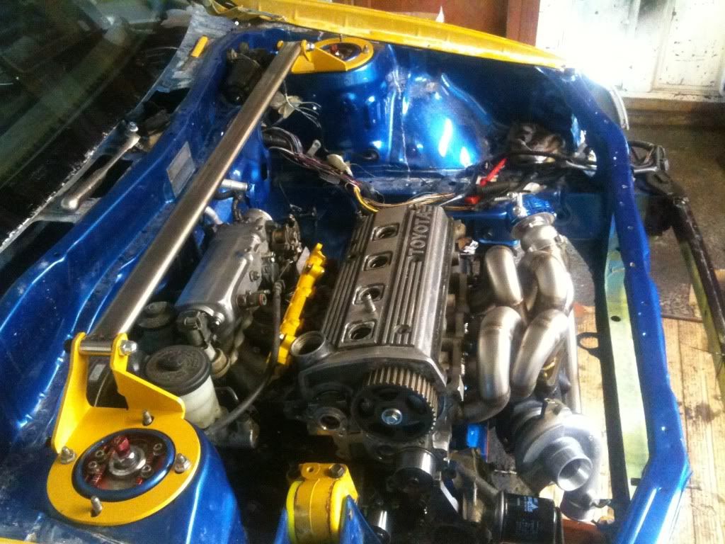

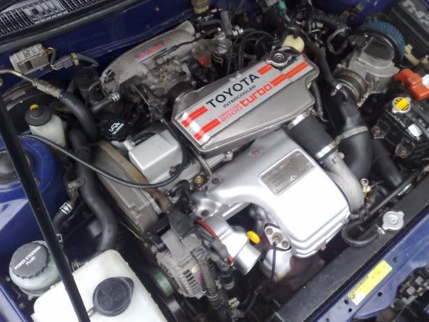

llawgoch Posted December 14, 2010 Author Posted December 14, 2010 this was my 3SGTE Corolla, jus for you miib14 Quote
micky boy Posted December 14, 2010 Posted December 14, 2010 Fucking hell mate all your engine conversions look like they have been done by the factory so clean and no wire's hanging everywhere like most conversions lol..keep up the good work mate Quote
miib14 Posted December 14, 2010 Posted December 14, 2010 thanks for the pics mate... is that 3sgte out of a st185? looks amazing and total sleeper..sleeper 3sgte corolla FTW Quote
llawgoch Posted December 14, 2010 Author Posted December 14, 2010 thanks!! little stuff like that pisses me rite off, i hate rattles, so if its fitted, its tight, and it cant rattle!! and if theres a bracket that toyota made to hold something, it gets used!! simples!! lolthe engine was a st165 version, hence it used a chargecooler system. it got rolling roaded at 220 bhp and engine was completely stock, jus rebuilt to standard specs. went rly well tho. Quote

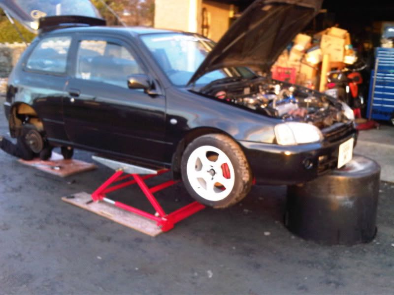

ryan lang Posted December 14, 2010 Posted December 14, 2010 looks pretty awesome tbf matewhere did you get that car lift jack thingy? Quote
rob_bower Posted December 15, 2010 Posted December 15, 2010 they were on ebay once upon a time! not sure if they stll are!nice sleeper to! Quote

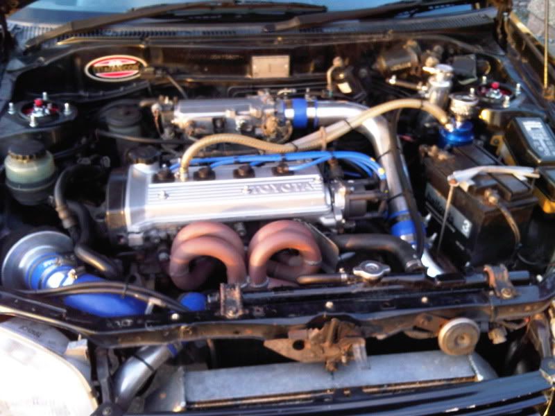

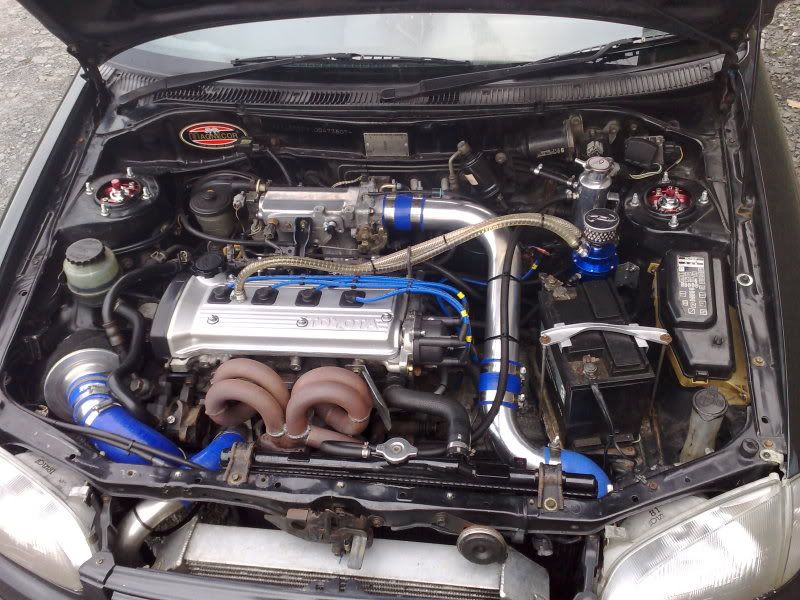

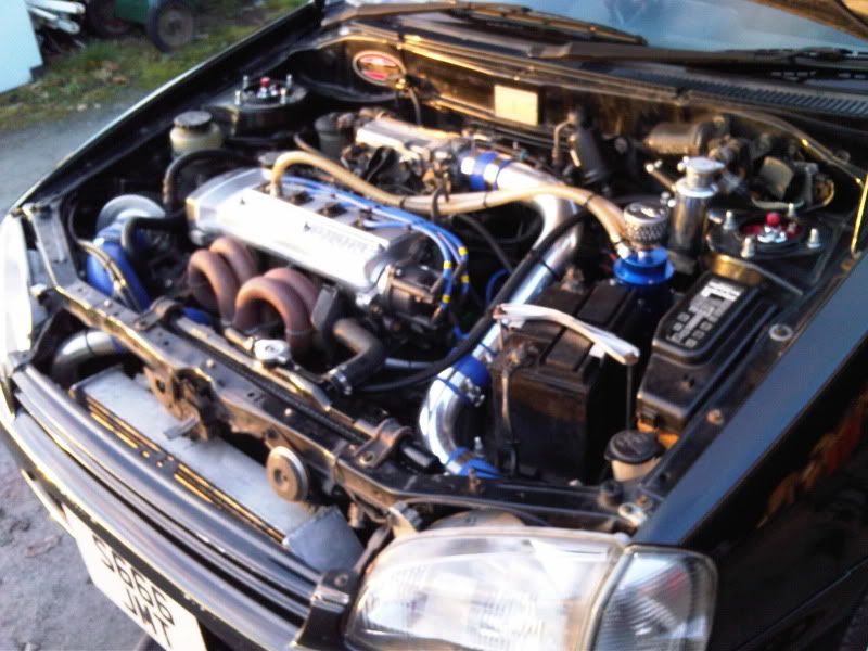

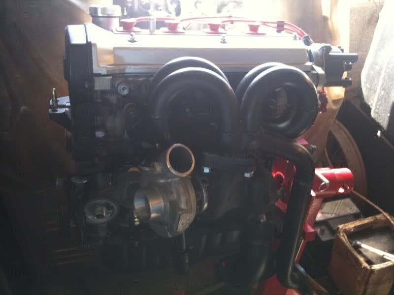

iamlegend Posted December 15, 2010 Posted December 15, 2010 how come your turbo is like that way round mate?compared to this?? (hope you do not mind me using it idrees) Quote
micky boy Posted December 15, 2010 Posted December 15, 2010 I think he might of "clocked the turbo" i.e with his set up been external wastegated he dosnt need to use an actuator, there for the cold side of turbo can be spun anywhere you want it.. in most case's people do it to shorten the lenth of the intercooler pipe route giveing much quicker spooling time also depending how your turbo is set up people also clock a turbo because the oil return might be on an angle and needs to be faceing down so the oil can drain off the turbo Quote
llawgoch Posted December 15, 2010 Author Posted December 15, 2010 i have set the turbo like that so it keeps the pipework as short as possible, have a look in the pice below to see how my pipework runs.and a pic with the meisters fitted, had to raise the fronts 10mm to get it to sit like that, was rly low!! lolyou can get the car lift jack thing from herehttp://www.cjautos.site90.net/mini.html Quote
