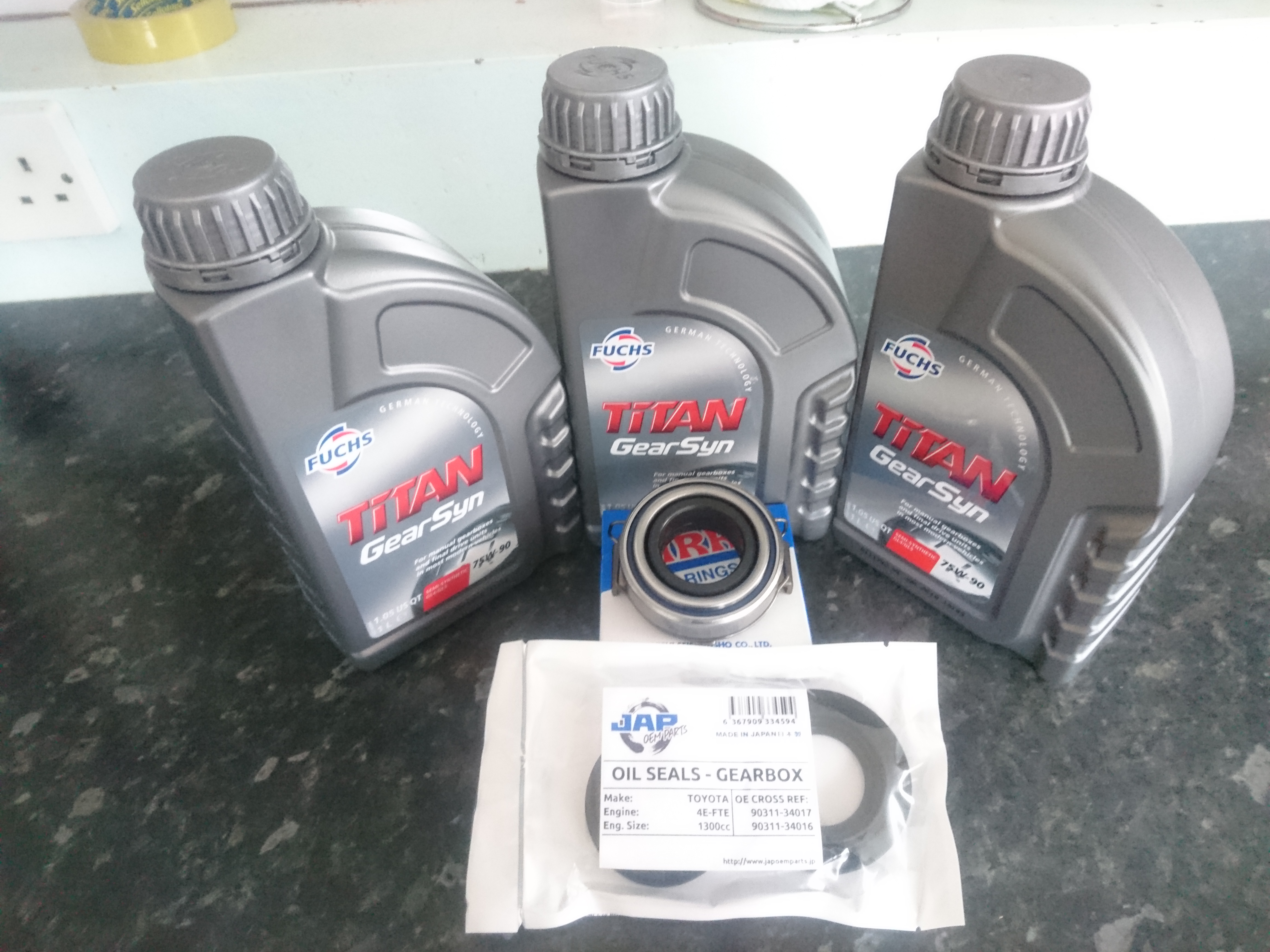

akyakapotter Posted August 1, 2018 Author Share Posted August 1, 2018 Got all the bits to put it back together that's tomorrow's job sorted hopefully everything goes smoothly. Quote Link to post Share on other sites

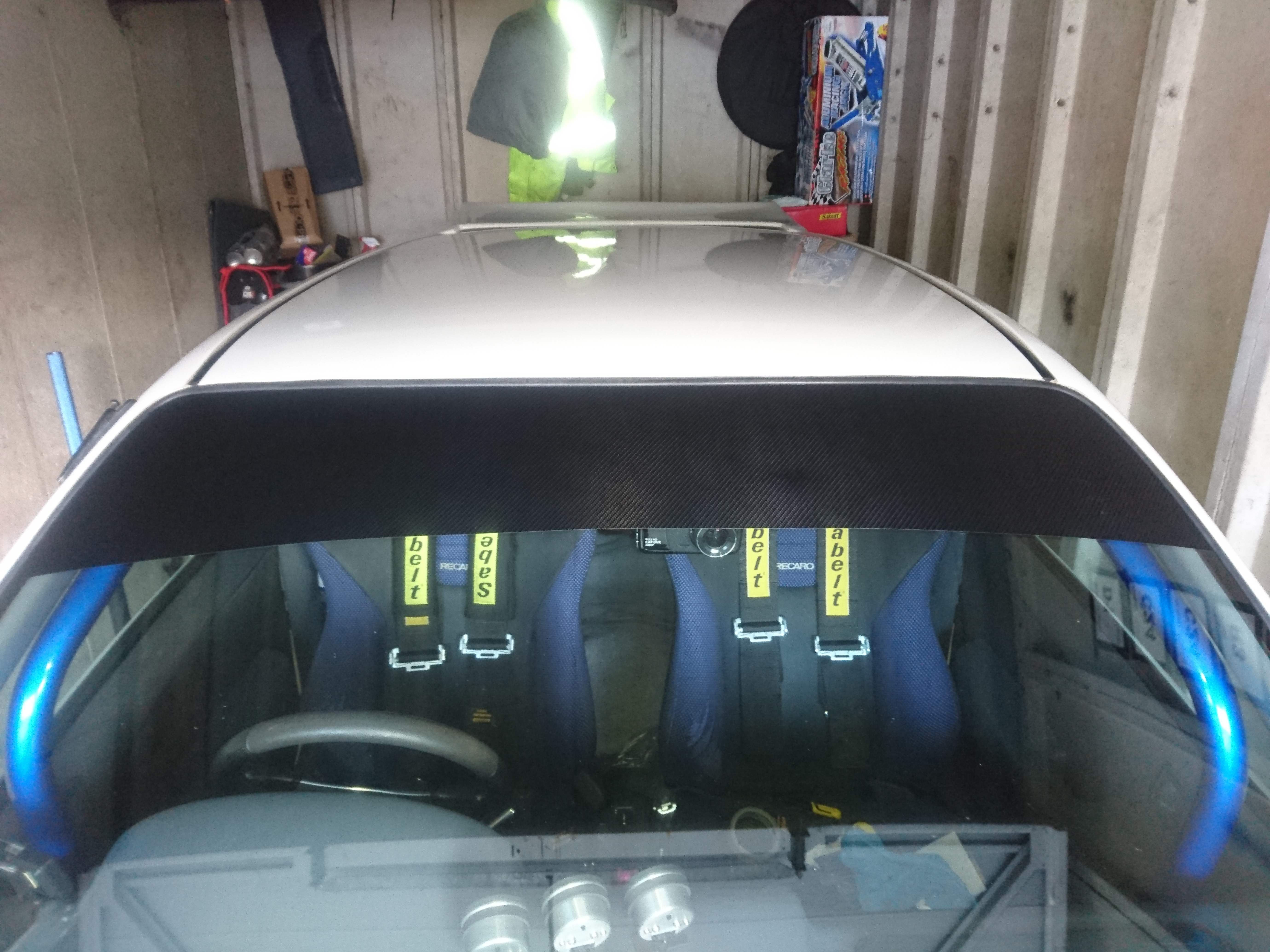

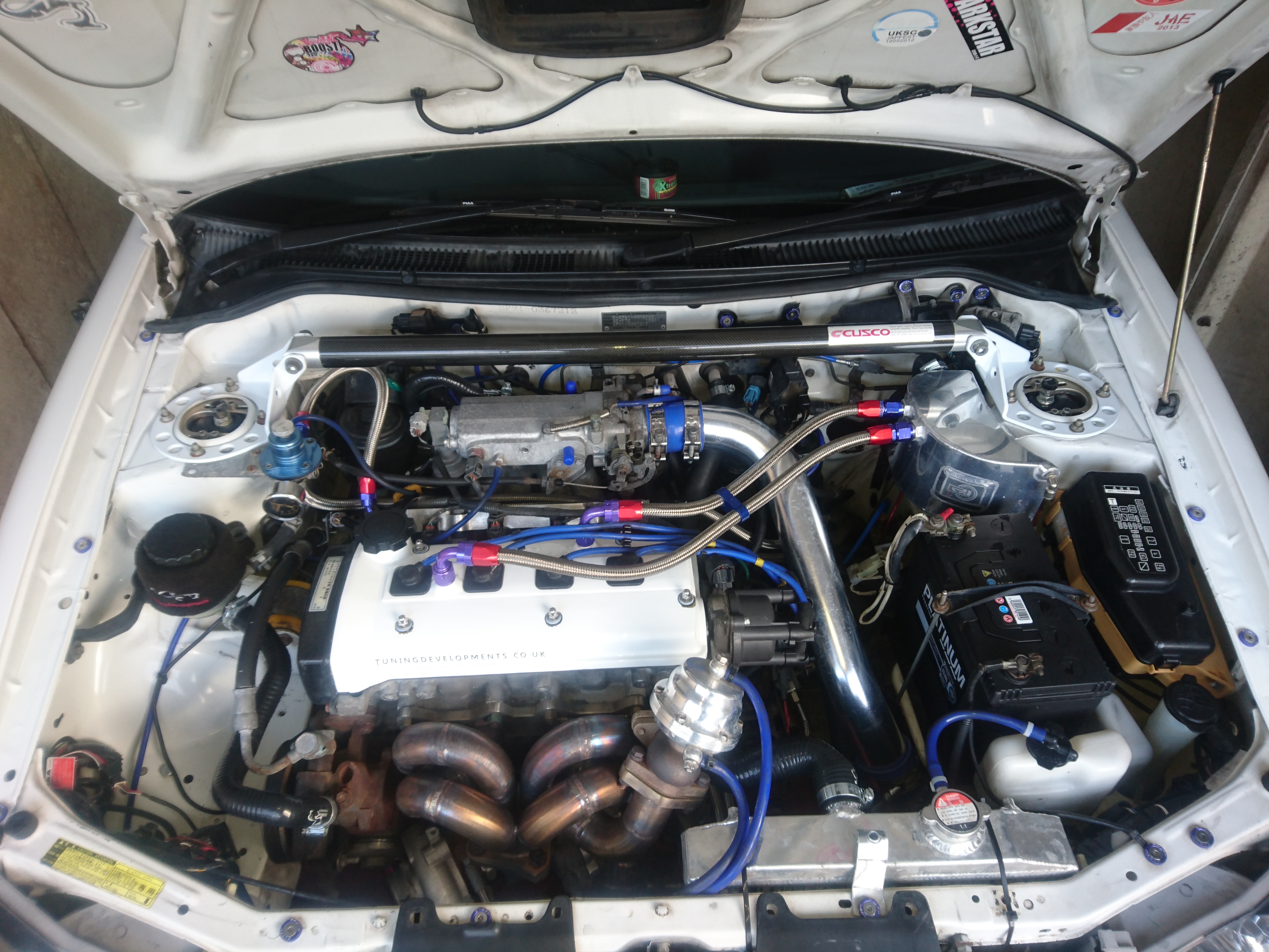

akyakapotter Posted August 7, 2018 Author Share Posted August 7, 2018 Done some jae prep today finally got my sunstrip on as I have a wink mirror I don't have survivors. Also cleaned the engine bay with some autoglym engine and machine cleaner worked wonders. Quote Link to post Share on other sites
Calum122 Posted August 7, 2018 Share Posted August 7, 2018 Yes that's rude mate. Looking lovely. Quote Link to post Share on other sites
akyakapotter Posted August 7, 2018 Author Share Posted August 7, 2018 56 minutes ago, Calum122 said: Yes that's rude mate. Looking lovely. Thanks dude got some autofiness iron out to try out at some point aswell looking forward to using that. Quote Link to post Share on other sites
Nanglebadger Posted August 13, 2018 Share Posted August 13, 2018 Wink mirror ehh?? Was curious about them a while ago for something a bit different, I shall have to have a look back through the thread for some photees! Also, that engine bay, yum! Very clean and tidy bud! Phil. Quote Link to post Share on other sites
akyakapotter Posted August 13, 2018 Author Share Posted August 13, 2018 43 minutes ago, Nanglebadger said: Wink mirror ehh?? Was curious about them a while ago for something a bit different, I shall have to have a look back through the thread for some photees! Also, that engine bay, yum! Very clean and tidy bud! Phil. the wink mirror is an awesome bit of kit takes away the blind spots just cant have sunvisors which is a pain. bay came up really well tbh more to do when im off and have the time. Quote Link to post Share on other sites

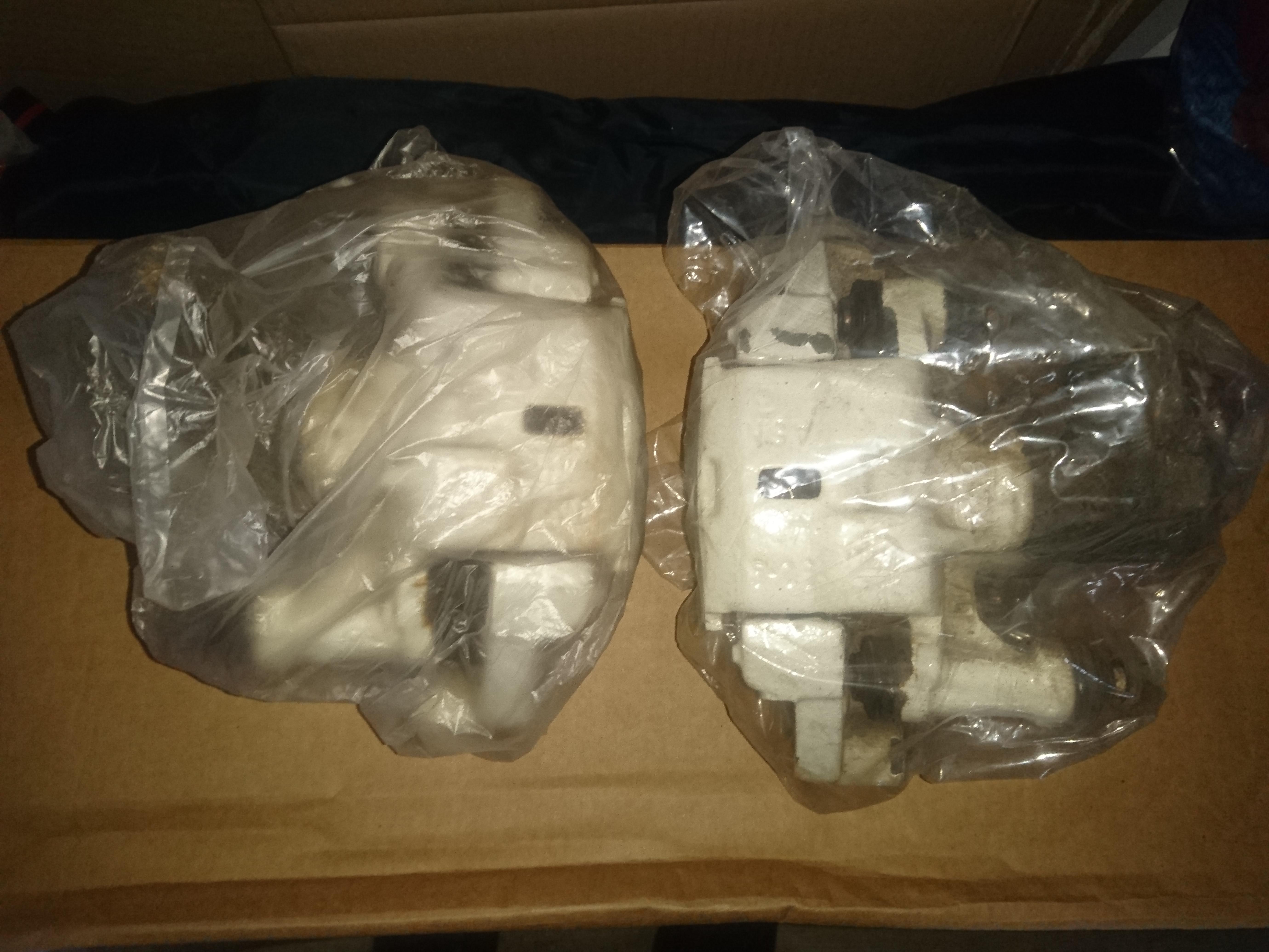

akyakapotter Posted September 16, 2018 Author Share Posted September 16, 2018 Picked up a set of rear calipers today to rebuild over winter as my ones on my glanza at the moment are rubbish lol plan on new seal kit new pistons and paint them black. Quote Link to post Share on other sites

akyakapotter Posted February 5, 2019 Author Share Posted February 5, 2019 Not much going on with now spends its life sat in my garage lost the love for it. It has a few issues I need to get sorted K-sports don't work like they should not sure whats up with them get up to speed and have to put quite a bit of force to get them to do what i want there is no air in the system it's almost like i need to press the pedal then press it again to get them to work. I have a set of rear calipers that i need to get rebuilt not confident on doing it myself so will send them off to be done. Also have an issue with the steering / power steering the steering feels heavy when it should feel light and light when it should be heavy. rear main seal is still leaking need to speedy sleeve the crank to sort that issue. will get around to it soon as i have booked a track session at japfest silverstone. need to send my gearbox with the quaife away to be rebuilt at some point. and it needs a good service suppose i should pull my finger out really. Cheers nick Quote Link to post Share on other sites
Bean Posted February 5, 2019 Share Posted February 5, 2019 Send me the calipers with the bits if you want mate I will rebuild them. Quote Link to post Share on other sites
