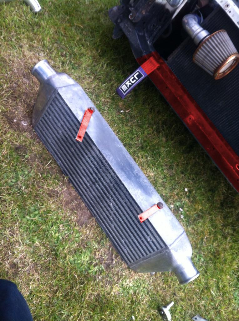

Amjad Posted April 3, 2013 Posted April 3, 2013 I used two 10mm thick metal bars on the bottom to mount my HDi and it's absolutely solid Quote
Matt1878 Posted April 3, 2013 Author Posted April 3, 2013 I used two 10mm thick metal bars on the bottom to mount my HDi and it's absolutely solid These dude? Quote
Socks Posted April 3, 2013 Posted April 3, 2013 I dont run undertray or arch lines. Both will need modifying to work tho! The red brackets go on the bottom of the red slam panel and bolt up into it... The core will sit with the top of it touching the front bar....Pics of HDI on my car: I made the top brackets myself... But the core should sit there, or at least thats where my pipe work would alloy it to sit It will also be perfect with the bumper if it sits there! Quote

Amjad Posted April 3, 2013 Posted April 3, 2013 My brackets were about 2-3 times as wide as that haha Quote
