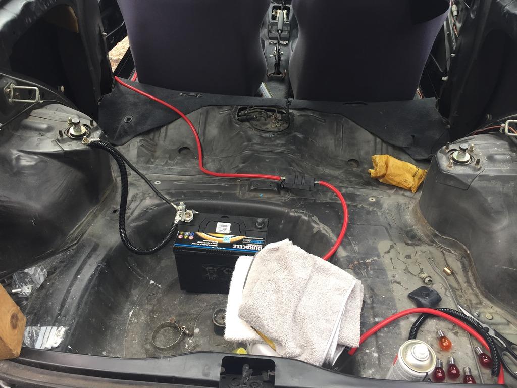

jellybaby Posted August 14, 2016 Author Share Posted August 14, 2016 Today managed to get a day on the car again re bled the clutch felt better but box feels bit notcy still could b linkage but when it goesOn to map they be looking at that for me. Fitted my front mount in place today as well as put the bat in the pos where it willBe mounted Quote Link to post Share on other sites
