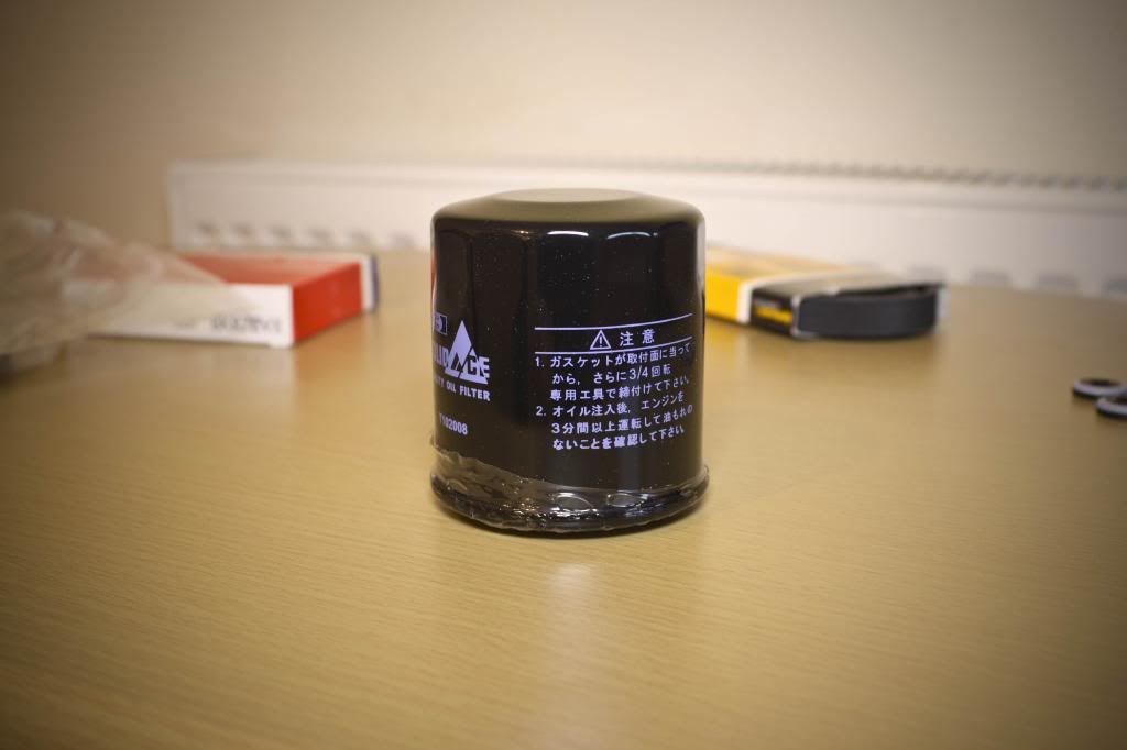

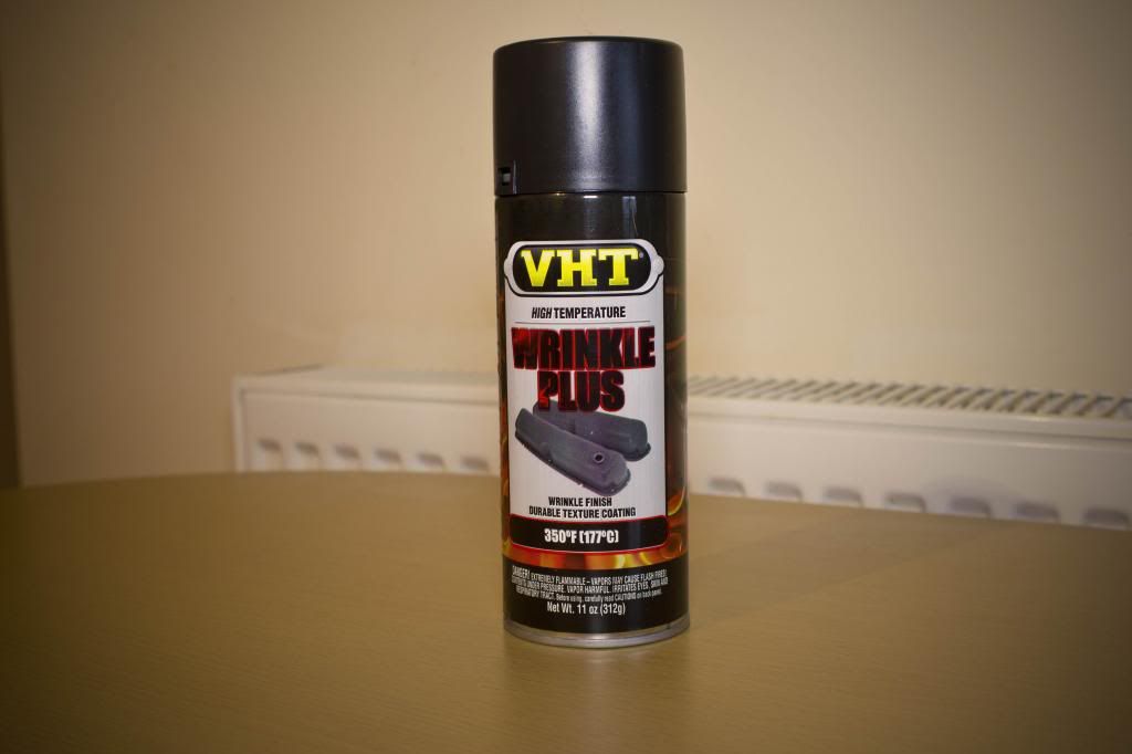

Spoon_tuned Posted March 14, 2013 Author Posted March 14, 2013 (edited) Update ************** After checking my oil the other day and realised it was lower that what it should be i thought it was time to service my car as i havent got a clue when it was last serviced so i ordered some part from ID-WORKZ and they came yesterday also ordered some oil but has'nt arrived yet and also some wrinkle paint to sort my awful looking rocker cover out. Hopefuly can sort this all out on saturday but the weathers not looking to promising Still got to set my boost controller up properly aswell just need to get some coolant and fuel filter now and i'm ready for the service Enjoy Edited March 14, 2013 by Spoon_tuned Quote

har-vey Posted March 15, 2013 Posted March 15, 2013 ive just done mine with this paint and all i can say is if you want a uniform finish, put it in the oven. i left mine at room temperature and it didn't work out very well at all. all the cracks followed the lines of the rocker and just looked rubbish. i sanded it back and then did it in the oven and it gives a much nicer smaller crackle finish. Quote
maddox710 Posted March 15, 2013 Posted March 15, 2013 I love wrinkle paint, make sure you get some pictures up when its done Quote
Spoon_tuned Posted March 15, 2013 Author Posted March 15, 2013 Thanks guys yeh ive used it before when i had my ef9 civic came out awesome but theh again i did do it in summer Quote
maddox710 Posted March 15, 2013 Posted March 15, 2013 Just make sure the metal is nice and warm when you spray onto it Quote
Spoon_tuned Posted March 15, 2013 Author Posted March 15, 2013 Just make sure the metal is nice and warm when you spray onto itTrust it will be ima professional lol ;) Quote
