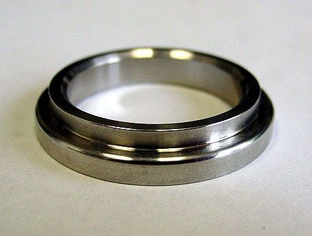

akyakapotter Posted January 18, 2014 Posted January 18, 2014 that ring there bud goes on the screamer to seal it up I think Quote
T-dog Posted January 18, 2014 Posted January 18, 2014 yeah thats the ring , i fitted mine without it when i bought it and i wondered why i couldn't get any boost lol Quote
akyakapotter Posted January 18, 2014 Posted January 18, 2014 yeah thats the ring , i fitted mine without it when i bought it and i wondered why i couldn't get any boost lol guilty as well lol Quote
daniel_g Posted January 18, 2014 Posted January 18, 2014 Theyre about 20 quid on ebay for one aswell Quote
Ollieh17 Posted January 18, 2014 Author Posted January 18, 2014 I know had to buy one. Not happy haha Quote
Ollieh17 Posted January 22, 2014 Author Posted January 22, 2014 Got the sealing ring and the wastegate appears to have stopped leaking. However can only get 0.2 bar boost flooring it in 3rd and above. I've had a look and tightened up all the intercooler pipes. Not sure if its a boost leak or leak before the turbo meaning no boost is made? Nothing seems to be blowing though? Getting a bit annoyed. Now:( Quote

Zeldoz Posted January 23, 2014 Posted January 23, 2014 8-9psi one. Yup vac hose from the turbo housing to bottom port of wastegate. Have tried it with and without the vac hose Have you got the missing ring the correct way around? Unsure if would change anything... And you have got thewastage on the right way? The ring which you bought and installed should be connecting to the manifold end.. scream end is the other Quote
Ollieh17 Posted January 23, 2014 Author Posted January 23, 2014 yup, put it on the wrong way round the first time, but swapped it. The ring is tapered, with the smaller end in the wastegate and the larger end flush with the manifold. Quote
