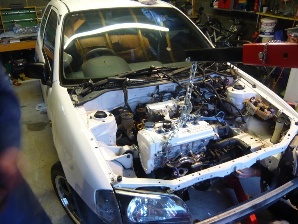

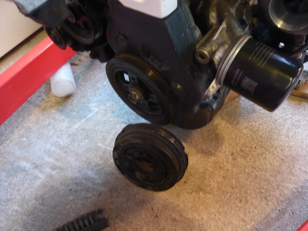

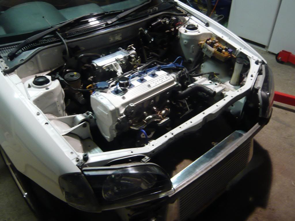

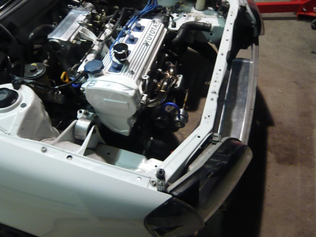

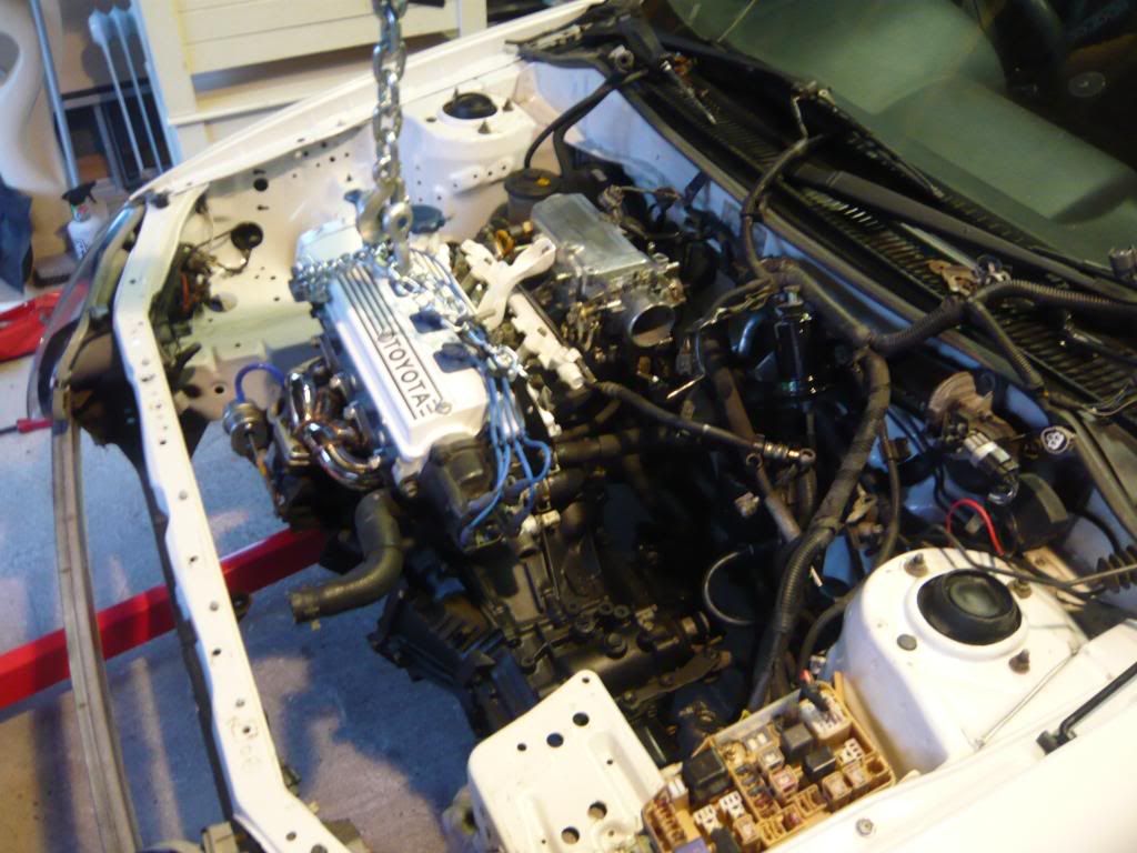

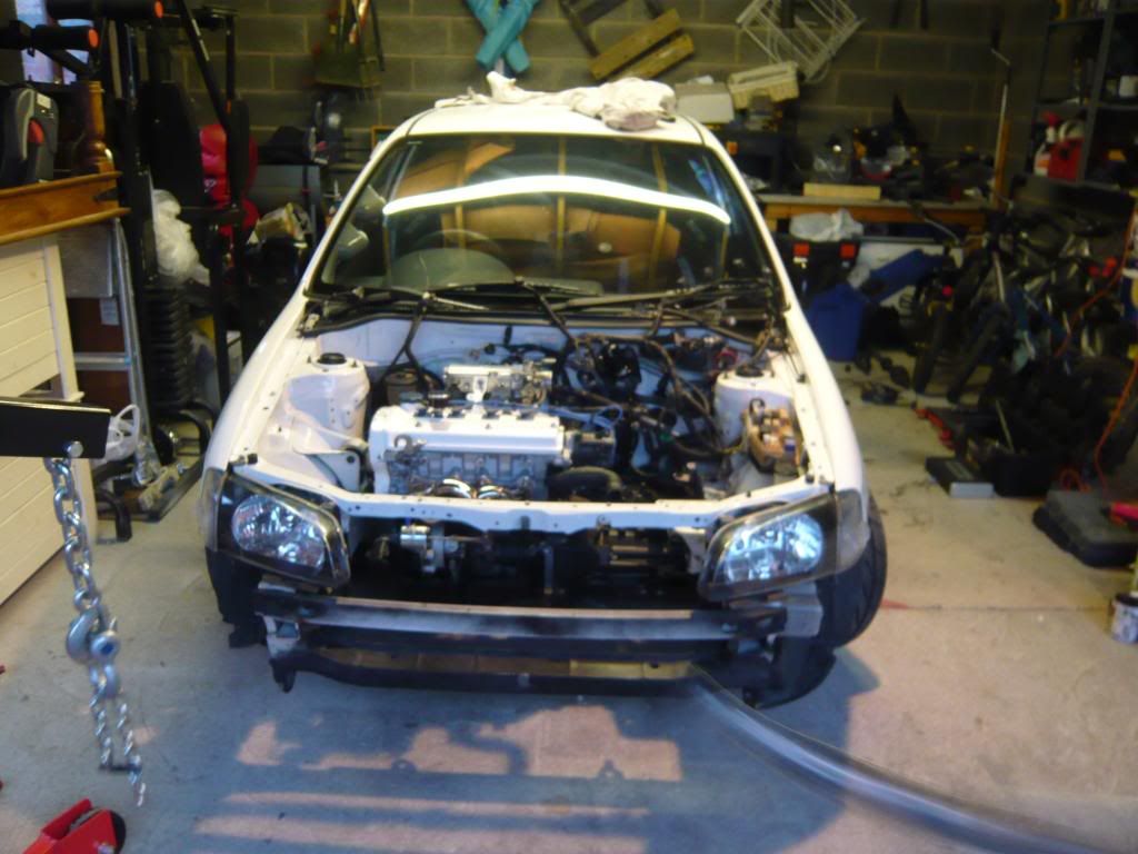

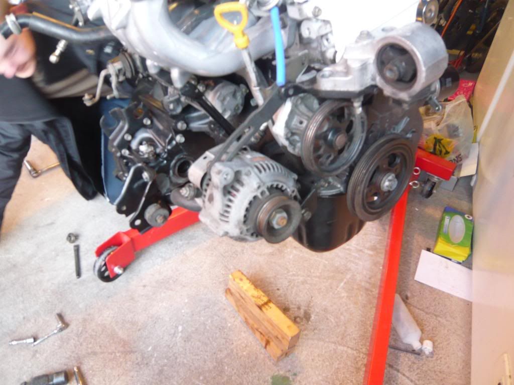

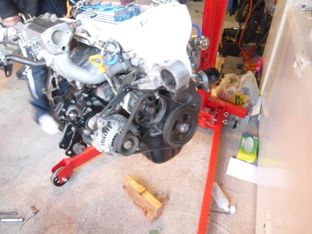

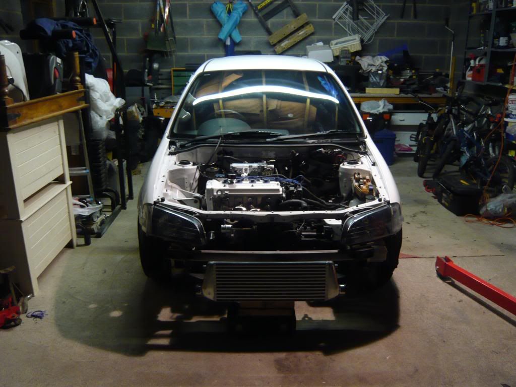

200sx-Starlet-Jay Posted April 17, 2009 Author Posted April 17, 2009 ENGINE UPDATE Andybill came over today and dropped off his glanza rad. will get it flushed tomorrow, and sort out fitting it!More importantly... ITS IN!! got it all mounted up and lookin sweet as! fuel lines are connected, and clutch/gearbox are all back to working order! clutch feels a lot stiffer than the NA one, cant wait to try it out!rite here we go with pics..first off, had to swap the NA crank pulley with the one on the gt engine, as i am not running power steering or air con, so got rid of the extra weight! its quite noticable between the two. Next, put the NA alternator onto the back of it as well..Then fitted the fan belt...and here goes the engine into the bay for the final time!! heres a few pics of it all mounted and bolted in...Just mocked the HDI frount mount on as well, starting to look like a real weapon now! getting that satisfying feeling that im building a rite little gem!So there it is!order this boost gauge yesterday....not the best, but goes with the rest of my lighting etc... so will do for now!**WIRING**right we have established that for the wiring, we will need the engine loom from the same year gt, as we need the plugs to fit the sensors on the engine. the NA has a few of them missing compared to the gt. seems annoying im going to pay a fair amount just for some plastic plugs but thats how it is i think. other than using electrical spade connectors and being a pykie!so once this has turned up shud see an end in sight for wiring issues. Quote
