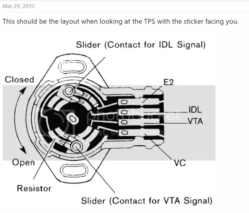

Claymore Posted February 28, 2022 Posted February 28, 2022 (edited) 15 hours ago, Frankieflowers said: I checked the voltage output of the TPS. It jumps out of scale when opening the throttle slowly. This should mean that it doesn’t work smoothly.I tried to find a new one but I cannot find it. Could you help?The new reference n. Of Denso 198500-3011 is Toyota 89452-22090 FYI never inspected an actual 4efte TPS. This info is from ECU pinouts and forum posts and my experience with the EP91 4efe TPS. As far as I know the Automatic 4efte uses a potentiometer (variable resistance) style throttle position sensor. But the ECU pinouts also mention an idle sensor (switch?). So it may have a switch to show closed throttle and variable resistance for throttle angle. 9 E2 = Sensor earth 10 VTA / PSW = Throttle angle (fte Auto) / Full throttle (switch, fte manual) 11 VCC = 5v power 12 IDL = Idle position (throttle closed) How many contact pins does the sensor have? Does the ECU show any error codes? How are you measuring the sensor? Which pins are you checking? ----------------------------------------------------------------------------------------------------- Starlet 4efe EP91 which I have checked with a multi meter= 18 VCC = 5v (power) 16 E2 = Sensor Earth (earth) 17 VTA = Throttle angle (signal) I've checked the TPS on my EP91 4efe starlet and it shows variable resistance between pins (3) VTA and (1) VCC when the throttle is turned. Hope this helps! Edited February 28, 2022 by Claymore Quote

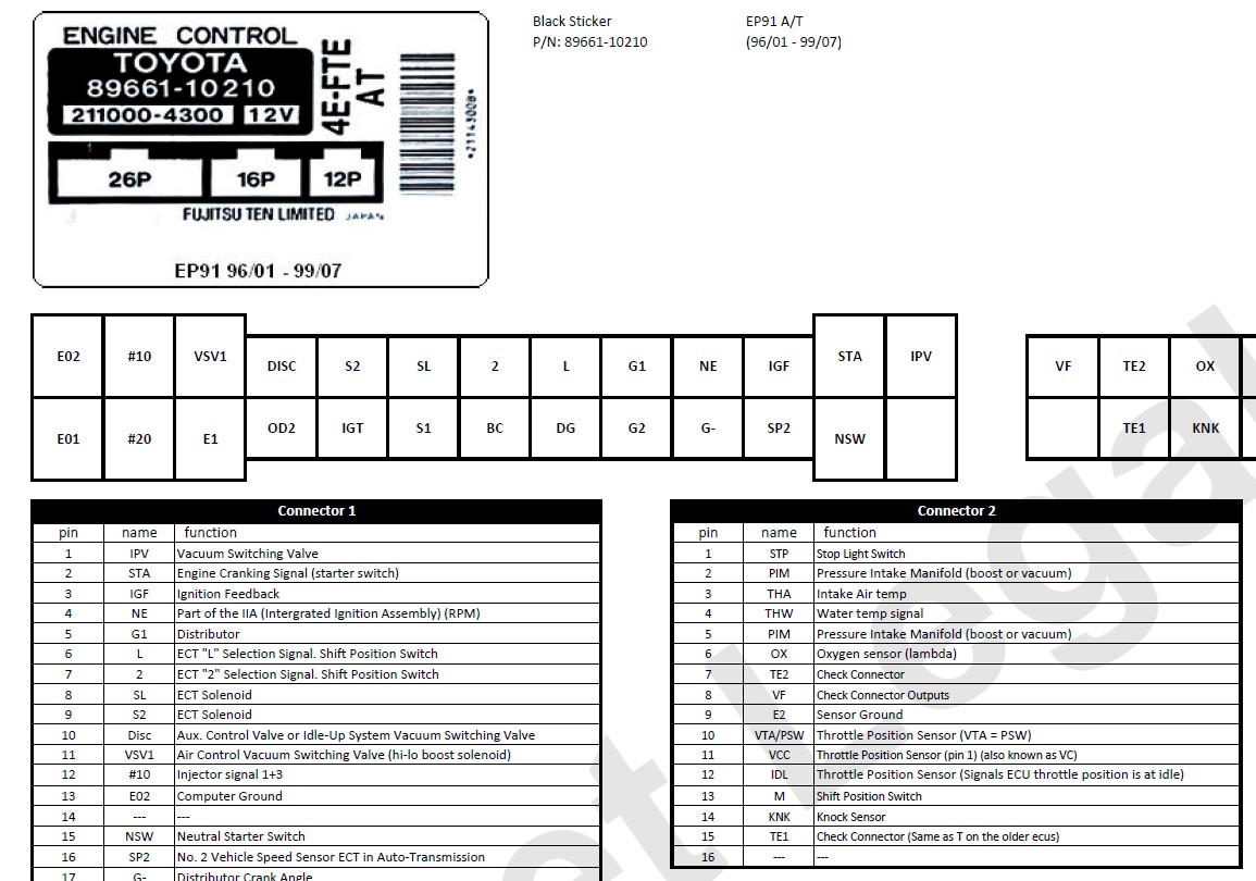

Frankieflowers Posted February 28, 2022 Posted February 28, 2022 12 hours ago, Claymore said: FYI never inspected an actual 4efte TPS. This info is from ECU pinouts and forum posts and my experience with the EP91 4efe TPS. As far as I know the Automatic 4efte uses a potentiometer (variable resistance) style throttle position sensor. But the ECU pinouts also mention an idle sensor (switch?). So it may have a switch to show closed throttle and variable resistance for throttle angle. 9 E2 = Sensor earth 10 VTA / PSW = Throttle angle (fte Auto) / Full throttle (switch, fte manual) 11 VCC = 5v power 12 IDL = Idle position (throttle closed) How many contact pins does the sensor have? Does the ECU show any error codes? How are you measuring the sensor? Which pins are you checking? ----------------------------------------------------------------------------------------------------- Starlet 4efe EP91 which I have checked with a multi meter= 18 VCC = 5v (power) 16 E2 = Sensor Earth (earth) 17 VTA = Throttle angle (signal) I've checked the TPS on my EP91 4efe starlet and it shows variable resistance between pins (3) VTA and (1) VCC when the throttle is turned. Hope this helps! Thank you. Pin one and three are the feeder. The sensor has four pins. It jumps weirdly at a certain point of the throttle opening position that is what makes the acceleration weird between 2000 and 4000 RPM. Quote
Claymore Posted March 1, 2022 Posted March 1, 2022 Found this on another forum.... From the diagram looks like the idle contact is a switch. Test between E2-IDL with continuity setting (beeeeeeeep when at idle, open circuit off idle position) Test between VTA-VC with resistance setting (resistance should change smoothly as the throttle is turned.) That's how I would test it. The EP82 4efte use 89452-14020 for 89-92 The EP82 / EP91 4efte use 89452-22090 for 92-99 Quote

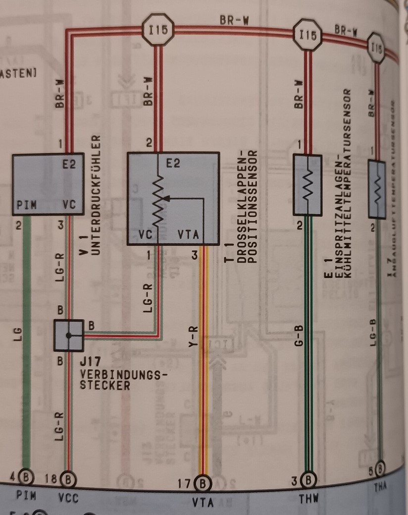

Frankieflowers Posted March 1, 2022 Posted March 1, 2022 8 hours ago, Claymore said: Found this on another forum.... From the diagram looks like the idle contact is a switch. Test between E2-IDL with continuity setting (beeeeeeeep when at idle, open circuit off idle position) Test between VTA-VC with resistance setting (resistance should change smoothly as the throttle is turned.) That's how I would test it. The EP82 4efte use 89452-14020 for 89-92 The EP82 / EP91 4efte use 89452-22090 for 92-99 This is a useful information. Thank you very much Today I set the timing from 7° back to 10° to see how it would react. The engine is running better in mid range and let’s say it’s back to normal behavior. I still have to run the test you suggested because it is obvious that it isn’t acting to its normal specifications. Quote

Frankieflowers Posted March 1, 2022 Posted March 1, 2022 8 hours ago, Claymore said: Found this on another forum.... From the diagram looks like the idle contact is a switch. Test between E2-IDL with continuity setting (beeeeeeeep when at idle, open circuit off idle position) Test between VTA-VC with resistance setting (resistance should change smoothly as the throttle is turned.) That's how I would test it. The EP82 4efte use 89452-14020 for 89-92 The EP82 / EP91 4efte use 89452-22090 for 92-99 I just spoke to my brother that the other day came by to test the TPS. We ran this test already and we discovered that with the opening of the throttle the tension was jumping in the mid range area and would then go back to lower levels of tension. This is a symptom of consumed graphite. This is why I bought a new one from Japan to see if it will solve the problem. Quote
