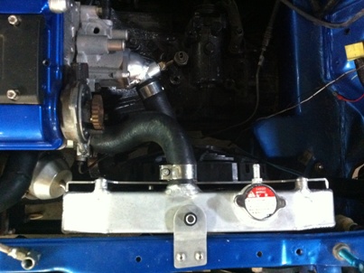

morgey Posted December 10, 2016 Author Posted December 10, 2016 Got the rad mounted eariler, needed to mod my header tank brackets as the lug was moved slightly but nothing i couldnt sort at work.Need to find some piping to fit, will maybe need to cut up the old stuff but shouldnt be too bad.Also chucked the alpha horns in to see how they looked but still need to wire them in. .New battery was bought, went for a standard yuasa battery rather than a dry cell like i had considered just due to the fact im not very likely to look after a drycell and the car will moat likely sit from time to time. Plus i could use a halfords trade card So numberplate, horns and rear lights remain to be sorted so nothing major! Quote
morgey Posted December 11, 2016 Author Posted December 11, 2016 Had a play about with my old piping and sorted out the top hose. Need to get some beads welded on the ends to stop the pipes poppig off then it can all be assembled and bled. Obviously the clamps need fitting but this was just for a mock up.Also fitted my new battery and had a quick wind of the steering to test the PS pump. Needless to say its a vast improvement but it didnt seem to power off so a bit of investigation is needed to see how it should work. Quote
