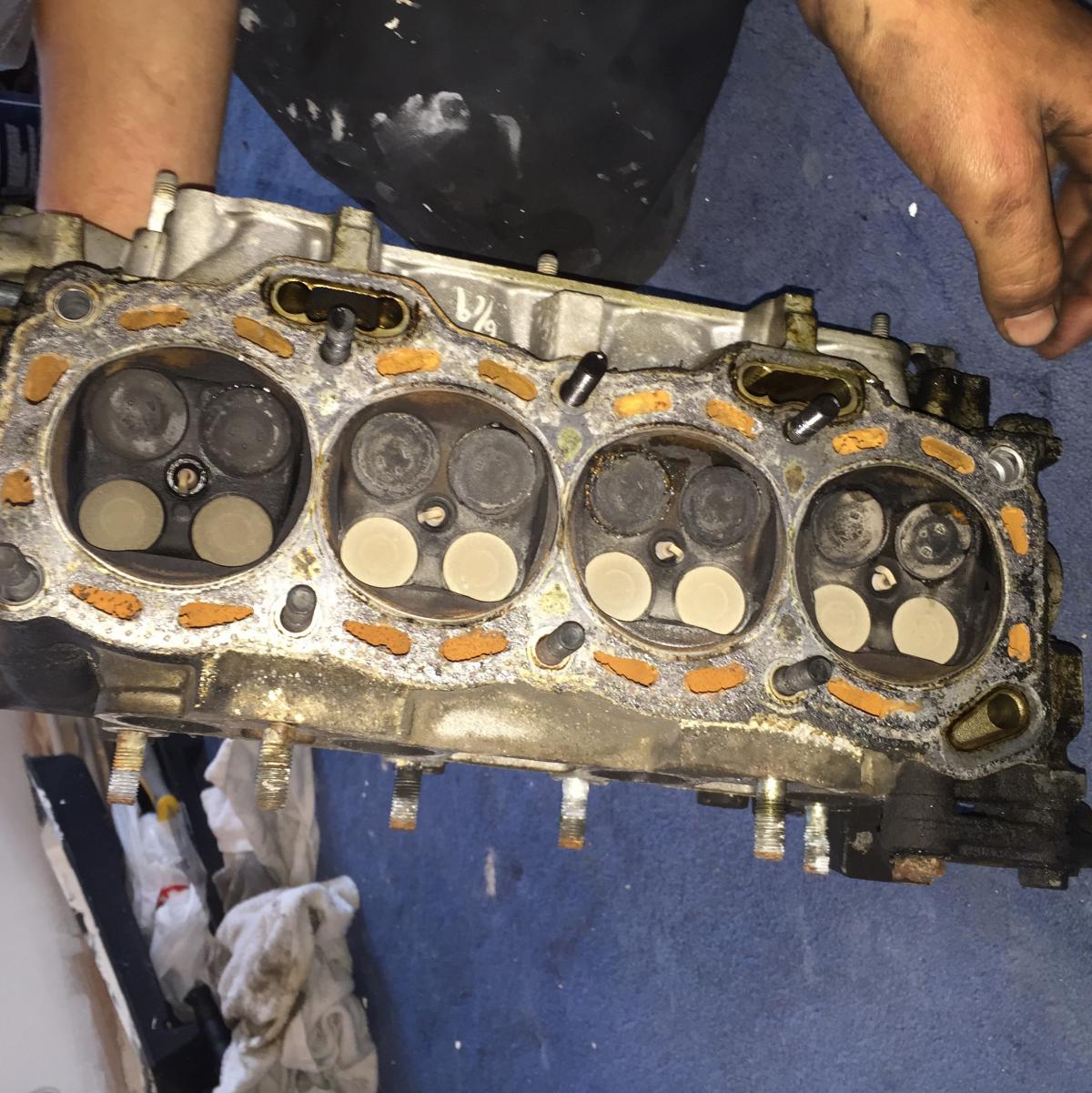

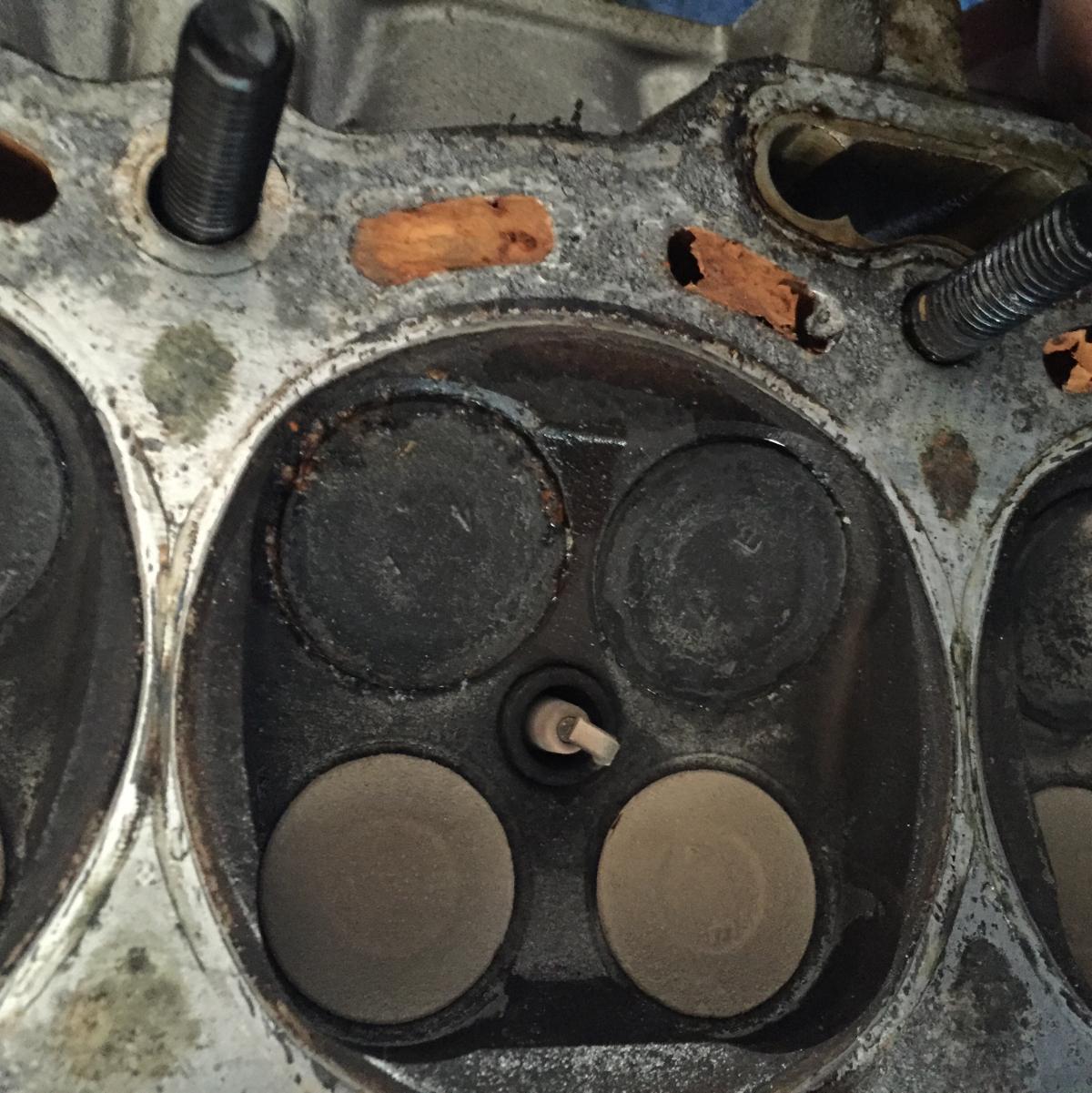

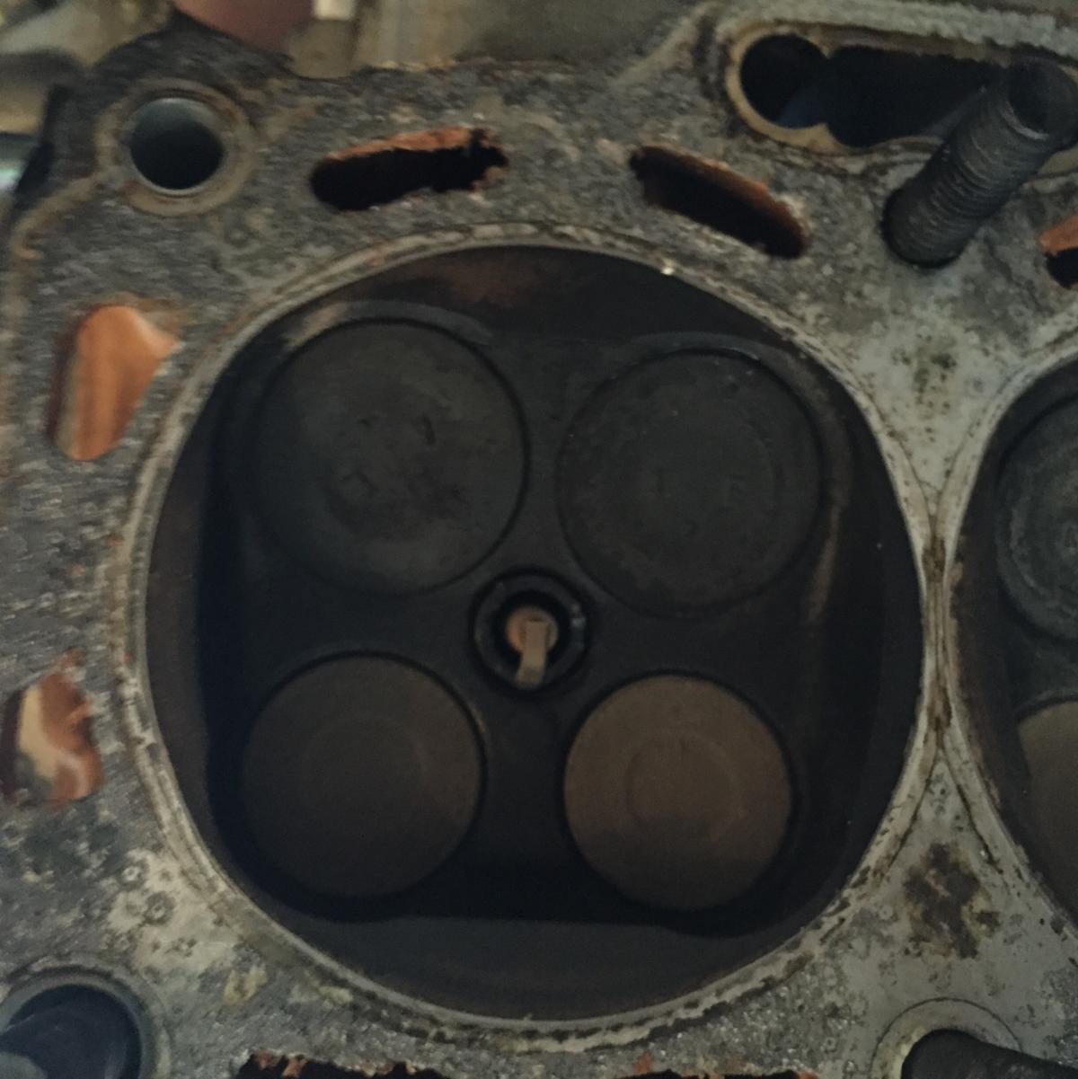

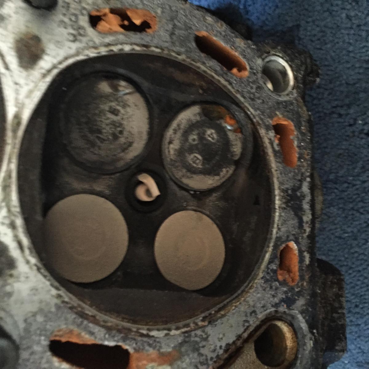

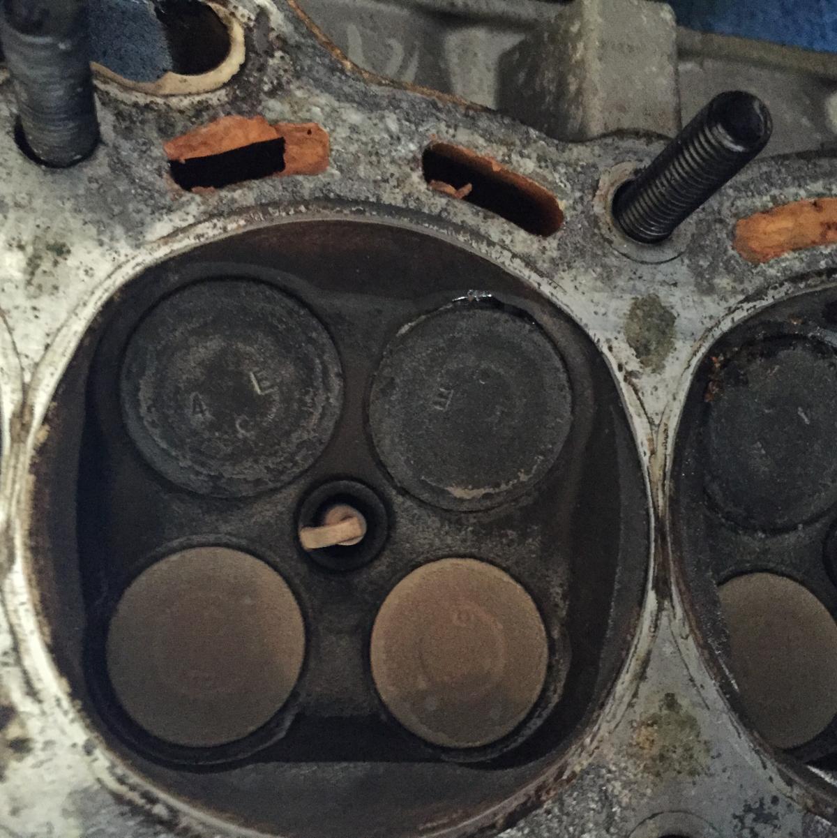

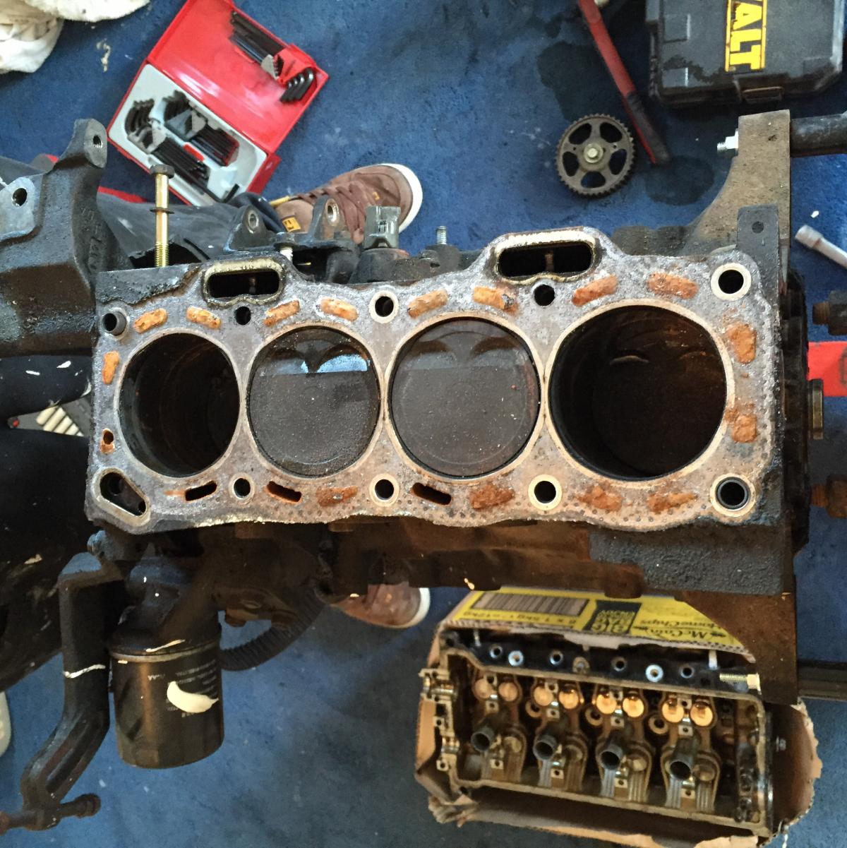

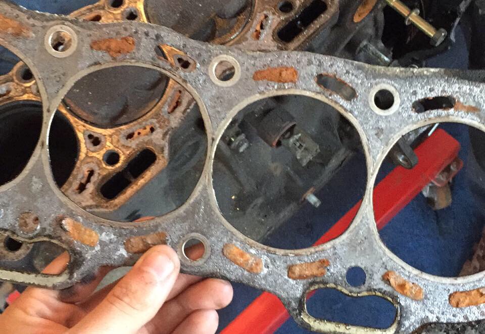

TrisK Posted July 28, 2015 Posted July 28, 2015 What do you make of this and these coloursWas kind of hoping to see a big split in hhe headgasket to explain the overheating but nothing Aside from a bit of rusty mess in the water ways I don't notice anything too obvious Quote
5e colin Posted July 28, 2015 Posted July 28, 2015 (edited) oil burning engine an lots of carbon build up on the valves you need to fully clean the head valves etc etc overheating might be crack in cilinderhead sparky 4 is wet so might be in that area better pic of cilinder wals would be great looks like it stood still for ages ?? Edited July 28, 2015 by 5e colin Quote
daniel_g Posted July 28, 2015 Posted July 28, 2015 Running very hot by the looks, what were the EGTs?That valve has burnt away Quote
TrisK Posted July 28, 2015 Author Posted July 28, 2015 It was over heating, then suffered an oil pump failure. Oil everywhereAnd then has been outside and covered up for a few weeks outside Quote
TrisK Posted July 28, 2015 Author Posted July 28, 2015 this out the gt?No from my old glanza that flint owns nowJust inspected it again. Valves are fine chip wise must just be the photos Quote

5e colin Posted July 28, 2015 Posted July 28, 2015 thats the carbon build up making it look like s chip i cant really see it wel on my shitty laptop but seems rust ring in the bore ?? Quote
morgey Posted July 28, 2015 Posted July 28, 2015 Wasnt/isnt a build up of crap restricting the water ways at all?Water pump im assuming was replaced. Dodgey sensor? Quote
