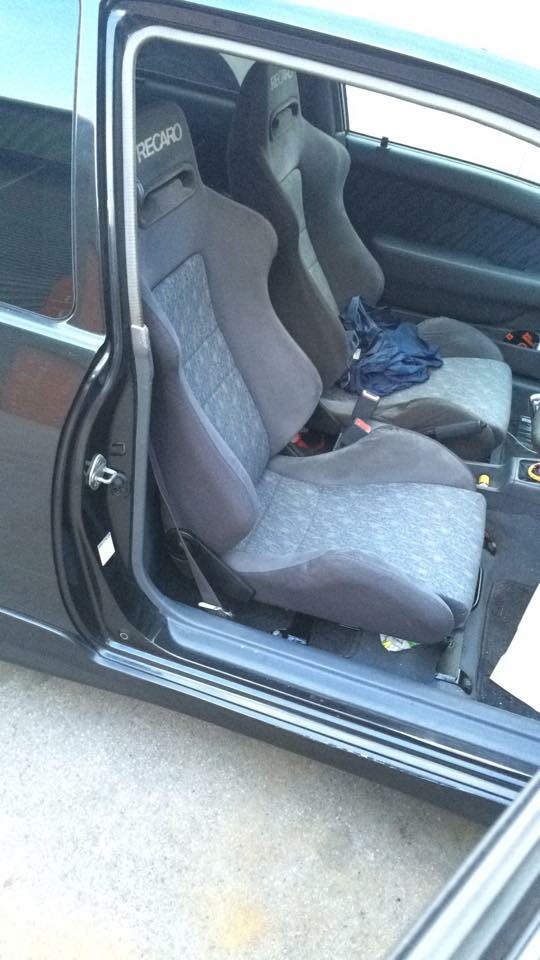

Matt1878 Posted August 31, 2015 Posted August 31, 2015 Brides / Recaro's etc.. Just get genuine EP91 rails to match and your off..I have Evo 6 recaros in my starlet and there great Quote

GlanzaV33 Posted August 31, 2015 Posted August 31, 2015 I got Evo 2 seats in my glanza on a set of epp ultra low seat rails Quote
