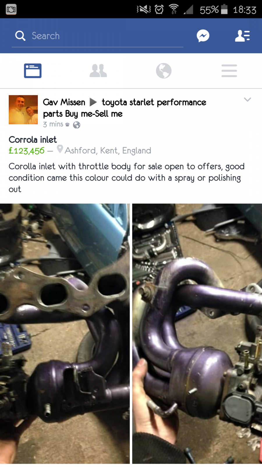

morgey Posted December 8, 2015 Share Posted December 8, 2015 Theres a rolla inlet for sale on facebook. Quote Link to post Share on other sites
4EFEJay Posted December 8, 2015 Author Share Posted December 8, 2015 Theres a rolla inlet for sale on facebook. Thanks! PM'd the guy. Waiting a reply for the price. Quote Link to post Share on other sites

4EFEJay Posted December 10, 2015 Author Share Posted December 10, 2015 Got the Manifold from the guy on Facebook! Thanks morgey for alerting me to that! Paid £45 posted. Which seems to be the going rate for them. Bought new gaskets for it this morning too. Today the exhaust gets delivered and hopefully the front brace. Been thinking about the suspension some more. I think to start with i'm going to go for: Tein S Tech Springs (Will look for coilovers and if a good deal comes up will grab them)Whiteline Rear ARB Kit - http://www.fensport.co.uk/Parts/Model_38/Category_2/2018Whiteline Anti-Lift Mounts - http://www.fensport.co.uk/Parts/Model_38/Category_2/2031 Quote Link to post Share on other sites
