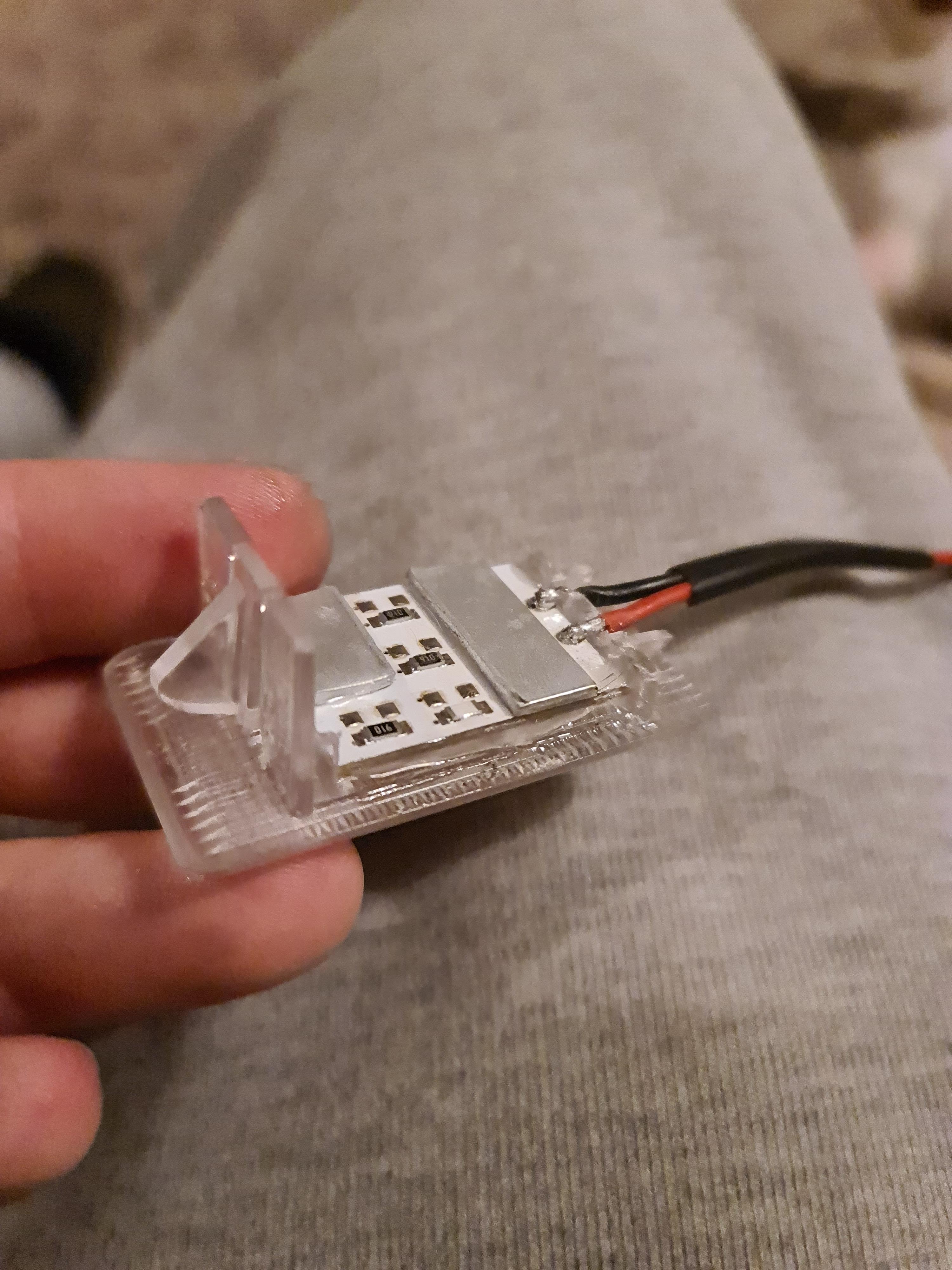

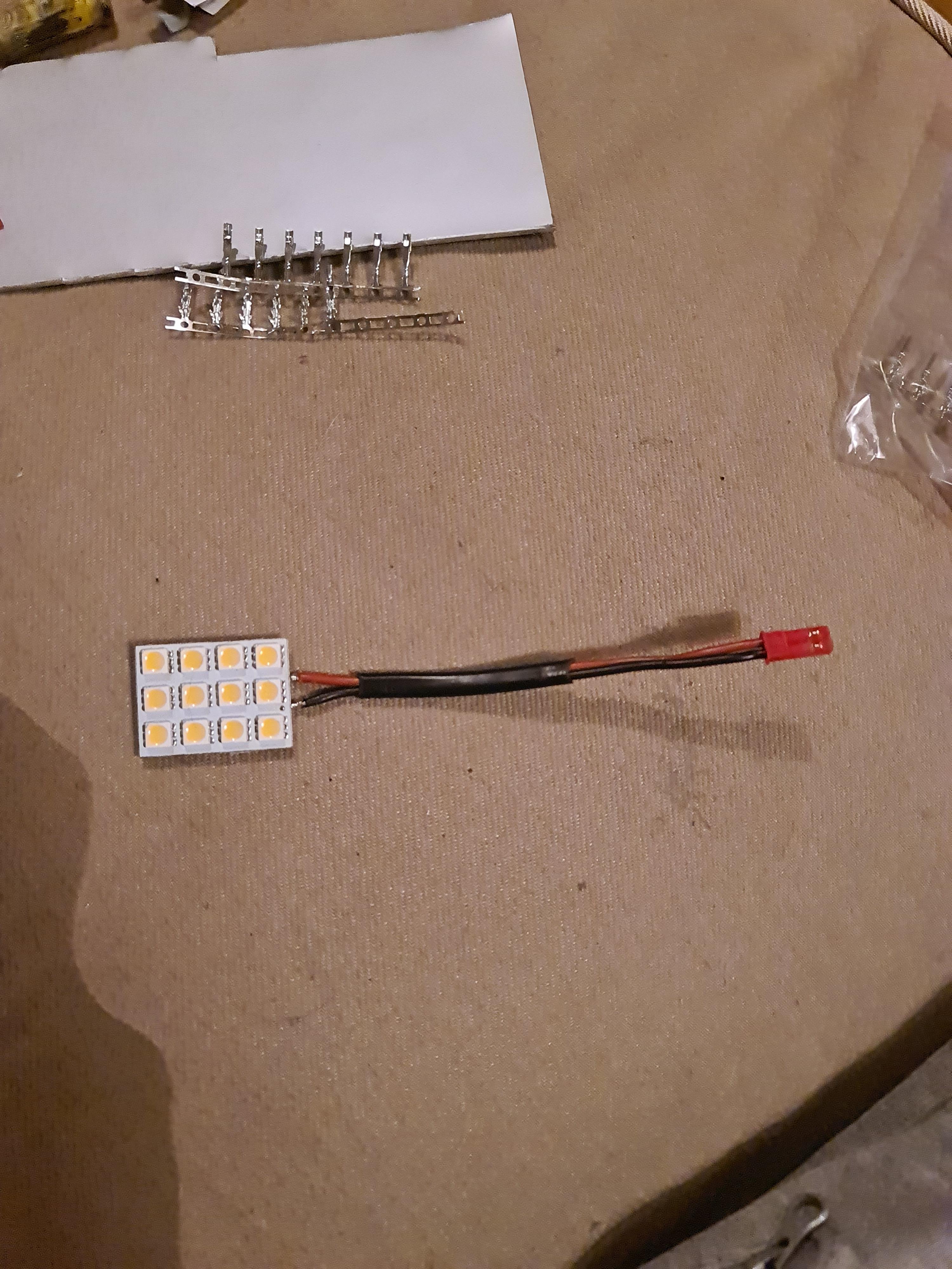

20/03/2021 Finished the boot lights - glued the LEDs into the plastic lense thing and stuck some aluminium strips onto the back of the LED board to act as a bit of a heatsink but in actual practice it's probably not needed Although if I was going to do this again, I would probably place the lights differently as the clearance between the plastics and the chassis is minimal with where they are now but I got lucky with my guess work I also copied the idea from @Claymoreand got a Glanza radiator expansion/overflow bottle for use at a later date. Didn't come with a bracket so I will have to make one like Claymore did with his. Cleaned it up inside and out I wanted to replace & renew the seat belt buckles as they are getting on a bit and I don't have full faith in them to be totally honest. At the same time I decided to spice up the interior, so I had my seatbelts replaced also by a place called FDTS (very friendly & fairly priced, and I would fully recommend them if anyone else would like to look into having theirs done) This is the colour I chose, taking inspiration from the Corolla G6R seat belts Still need to get the passenger seat retrimmed/repaired, also going to repaint the rails, have actually tried to do this already but the paint went pants so I need to strip them again and redo. I was going to get the cam cover powder coated but I wouldn't be able to get the desired effect The 'TOYOTA' lettering will be highlighted in candy red and I have been trying to paint it myself by spray can and airbrushing but this isn't going as smoothly as I would've liked (mainly because of lack of suitable painting environment). 21/03/2021 Resprayed the passenger seat rails with semi gloss black epoxy paint, hopefully should stand up well against any rust, scratches or chips, and fitted the new buckle. Just need to repair the bolster and paint the drivers seat rails
