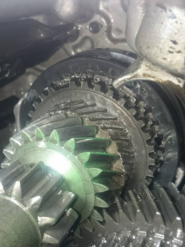

akaye4000 Posted June 3, 2016 Posted June 3, 2016 What do people use for 300HP plus as I've killed my box in 24hrs after getting my 5e Gt28 mapped. Stripped 3rd gear at castle combe today Quote
akaye4000 Posted June 3, 2016 Author Posted June 3, 2016 Well annoyed dude was just getting into it aswell car felt the best it ever had handling wise spool and power Quote

Socks Posted July 6, 2016 Posted July 6, 2016 Short Answer. There is no cost effective solution. Ignore anyone that tells you they've engineered or made a custom box. 5 or 6 speed. I've looked at every option going after blowing 5 of these gearbox's in the same way. As has MadMike on here. The strongest box is a GT C52 5 Speed. (Due to longer ratios which help a touch)6 Speed's have a thinner 3rd gear. Don't Waste your time. Sorry Your only options are: Zisco Straight Cut or Quaife. Both will cost you 6k + by the time there in a car.Both of which will still wear out eventually and dont give specs on what they can cope with either. Quote

Socks Posted July 7, 2016 Posted July 7, 2016 Tried Everything. Tried a BRAND NEW 3rd gear form Toyota and it didnt last. As they get stronger after being used for a while believe it or not, as they bed in. Cyro stuff isn't going to help. While It will help, its only minimally.Its not like we are JUST touching the edge of the gearbox's strength. Even at 300bhp your nearly 3 times what the box was designed to do! There is NO Option. The C6x boxes. Shit themselves around the 300-350bhp mark in the exact same way. A friend of mine has done this recently in his turbo'd corolla tsport. Quote
