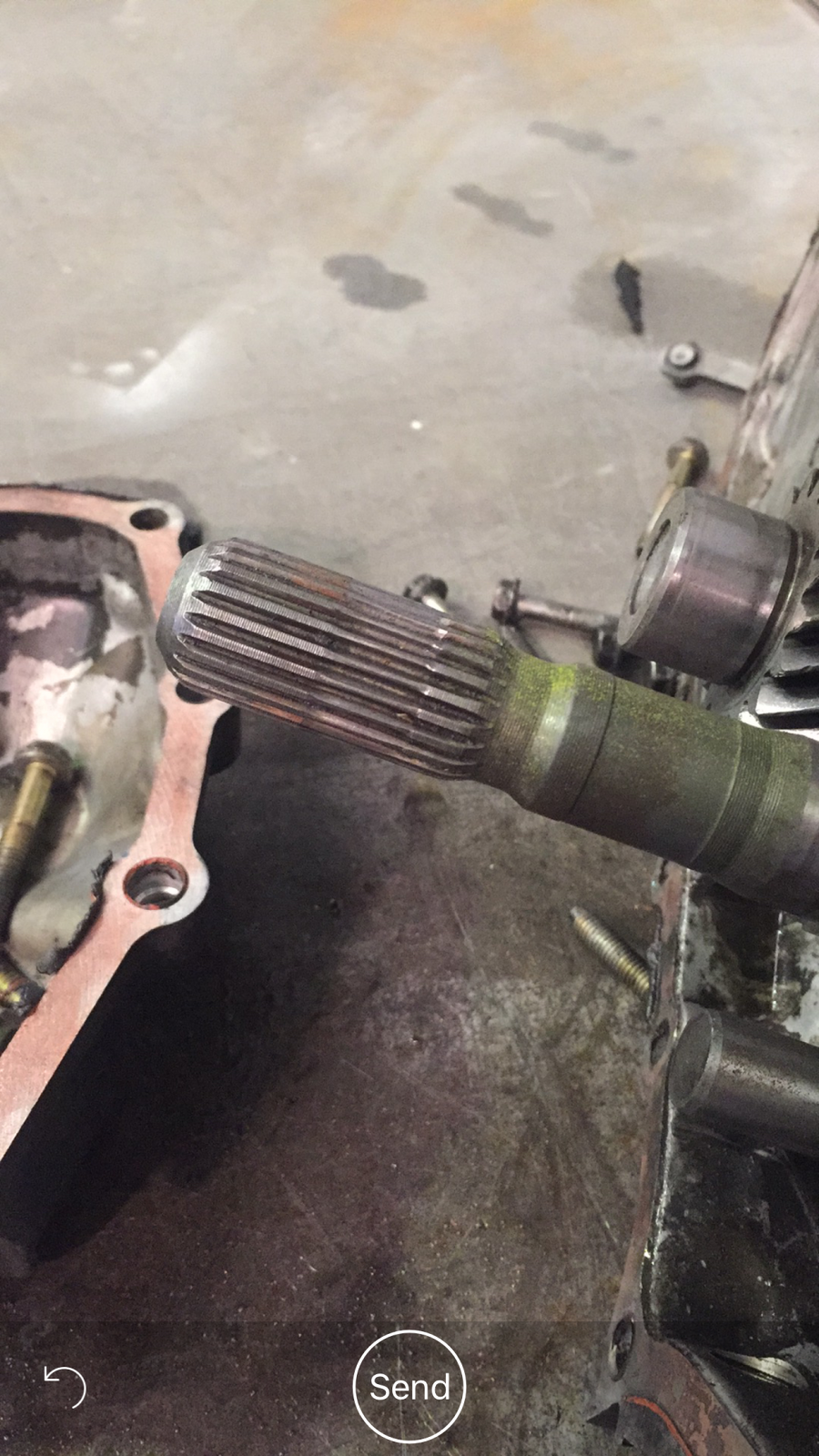

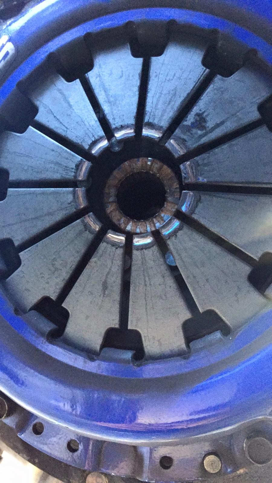

Hello people. As title says, i have had a major headache with said problem for some time now. Had the glanza forged at TD a while back. When I collected the car there was a slight tapping noise on idle. I was told this was piston slap as the car was warming. I later found out this was not the case. When the clutch was disengaged the noise would stop. We put this down to excessive play in the input shaft. The inevitable happened and the splines on both the input shaft and clutch where stripped. Had the gearbox opened up and the bearings wernt great but not too bad. I purchased another box locally and another spec 6 clutch. Rebuilt the car and identical tapping noise occurred resulting to stripped input shaft and clutch hub splines again. Starting to get really expensive and annoying. Anyone came across similar damage or know anything? I can only think something is not aligned correct.

post-13554-0-42291500-1473150121_thumb.j
post-13554-0-08899900-1473150140_thumb.p

Yes mate, friction plate was stripped and so was the input shaft. So i replaced both cluch and brougt a new box and the same happend a month later 😞
This time round i have took the fly off and had it skimmed just to be sure. It was definitely torqued when i removed it lol.
