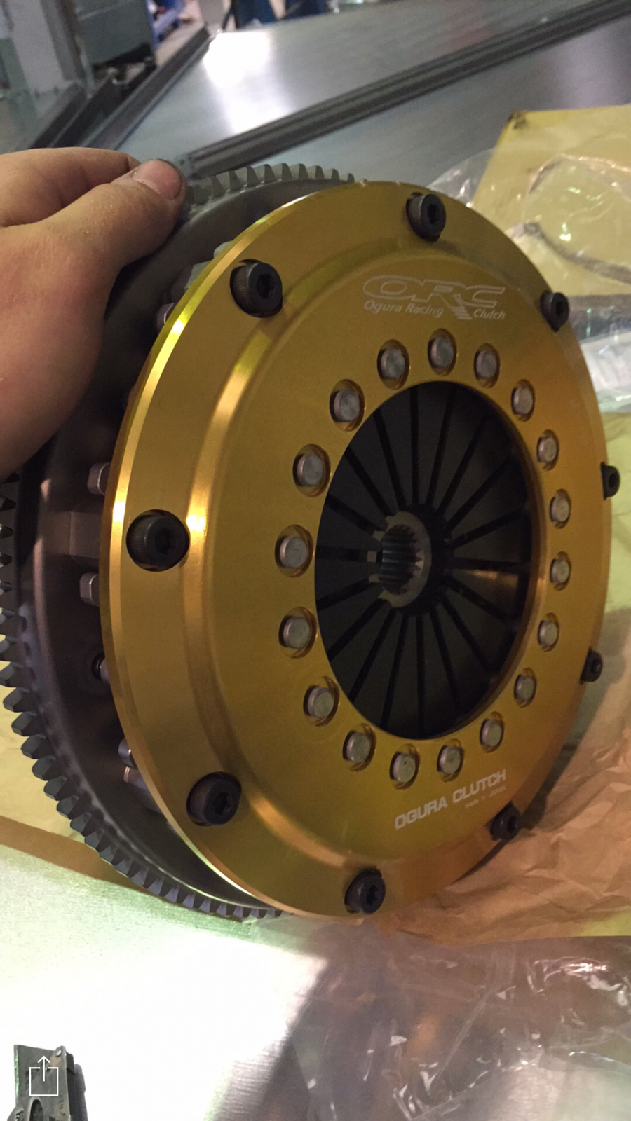

I purchased another box locally and another spec 6 clutch. Rebuilt the car and identical tapping noise occurred resulting to stripped input shaft and clutch hub splines again. Starting to get really expensive and annoying. Anyone came across similar damage or know anything? I can only think something is not aligned correct.

general question as you seem to have been sorted advice wise----is this a solid disc or "spring-centre" clutch?

Ive seen bad things about comp clutches too
same I've seen a lot of bad reviews a about cc the only good thing is cc customer service is ment to be really good and they always send replacement parts straight away with no messing about free of charge obviously still sucks if you got to pay labour to have it changed again
Ok mate. Still good to know! Definitely going down the ORC route tho. Just a bit costly lol. With lowering the import tax, think its still going to cost 700 😞

be well worth it in the end mate if I was to build another one I'd definitely be going for an Orc
