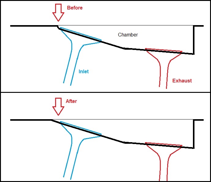

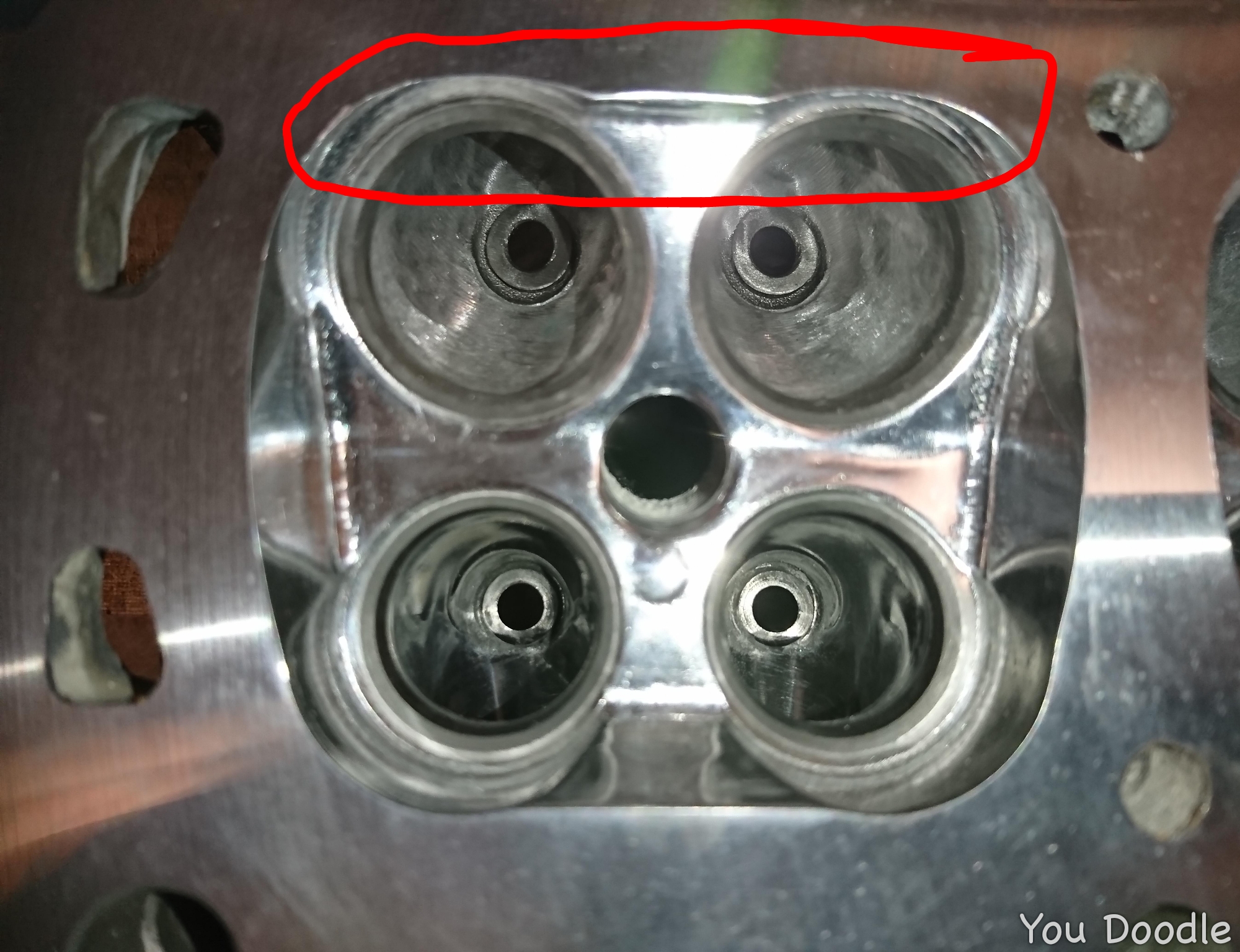

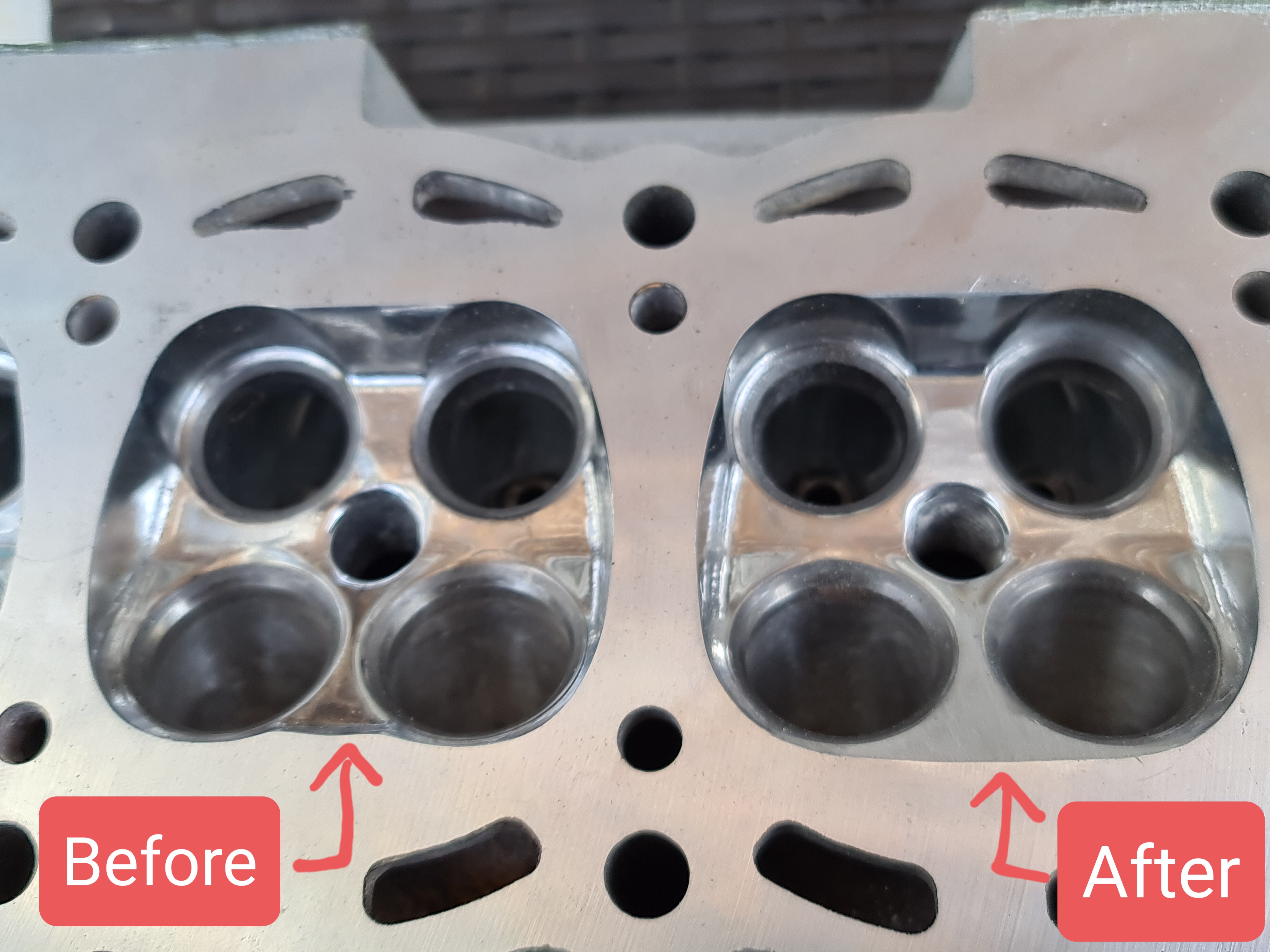

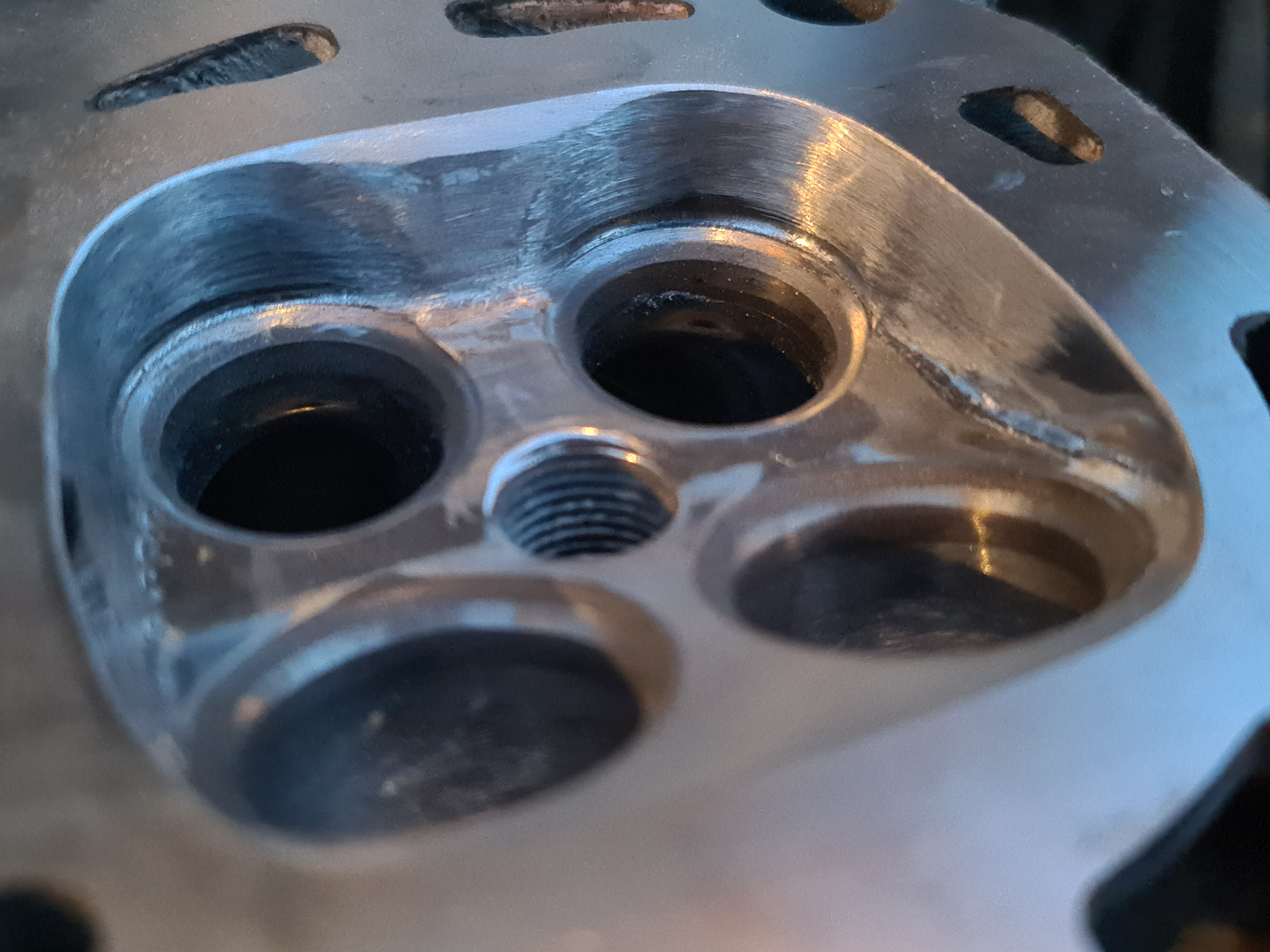

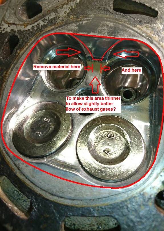

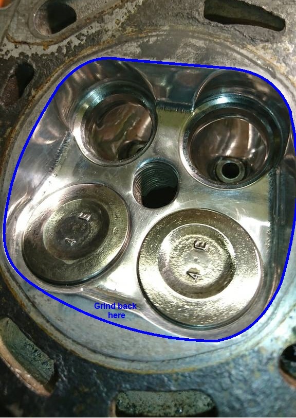

@sam44 ohh okay, I think im with you. So essentially it would look like this?:
chamber.jpg.87f09fc597c1cf05cdd3f5c74542b2ac.jpg4e924b3630a64cb59db5e14dab315c99.thumb.jpg.e7369ea3fb25188fe4b1f300a28af962.jpg
Also while im there, do you think it would be worth removing a bit of material from around the exhaust valves like so?:
Yep, exactly that, but be carefull on the exhaust bridge in-between the exhaust valves, there's a water jacket around 3-4mm down into the material (were the arrows are in the picture above) its thinnest point is smack bang in-between the exhaust valves so just round off the edges like in the picture above. The additional flow gains are mighty. Sorry about late reply.
  You can use a slightly thinner aftermarket head gasket to bring back any lost compression ratio. Only work the areas around the valves (all valves) the rest is much needed cylinder squish zones.

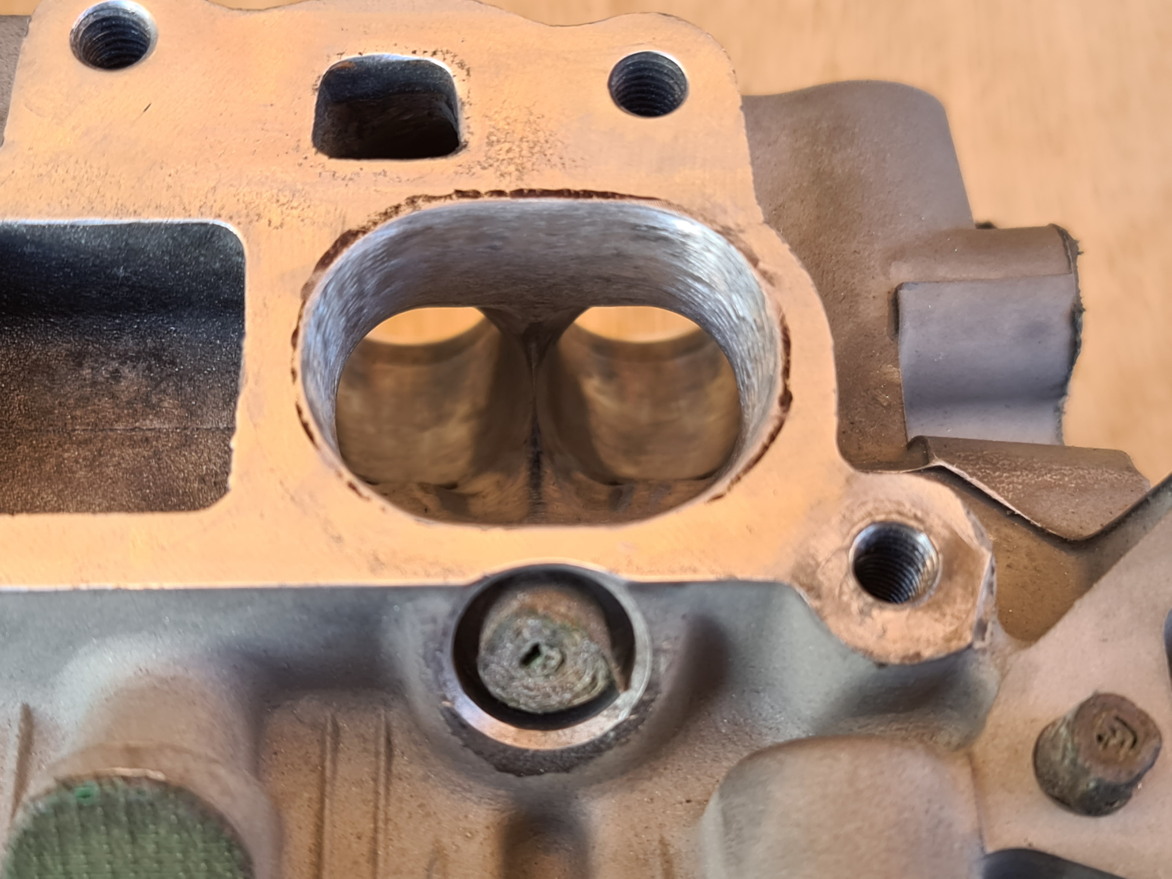

the area/lip I originally highlighted can be completely removed. This is a unfinished cast lip left behind (a production line product).
the thinner head gasket also improves cylinder squish/turbulence/mixing.

The thing to remember here is the valve to piston clearance. These gaskets quote 5efe, but if you run the higher lift 5ehfe cams I'd be tempted to check the clearance. From what I can see on you tube videos it will clear ok.
Cylinder mixing on the e series engine is poor at best due to the very thick head gasket and combustion chamber shape/design.

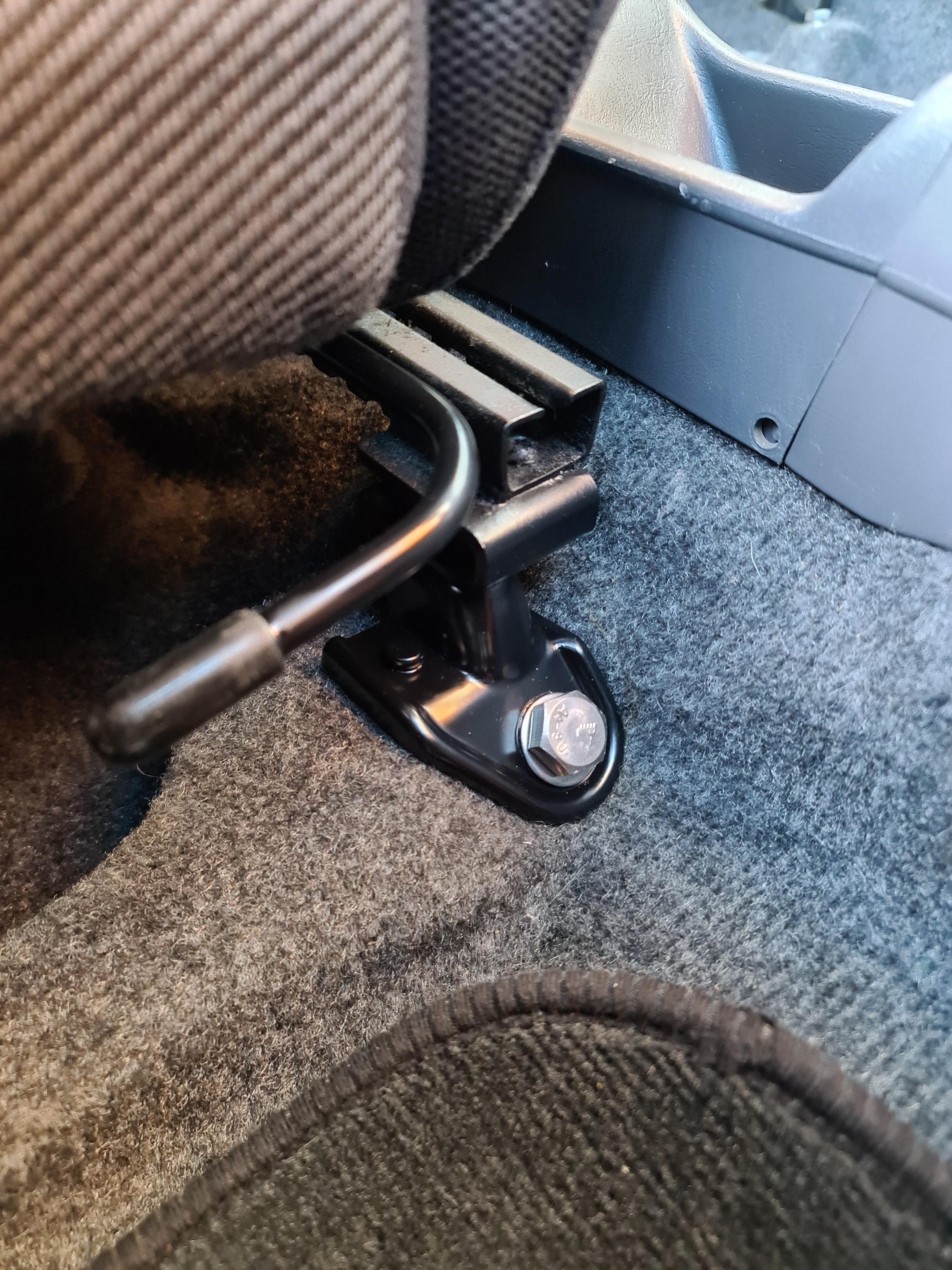

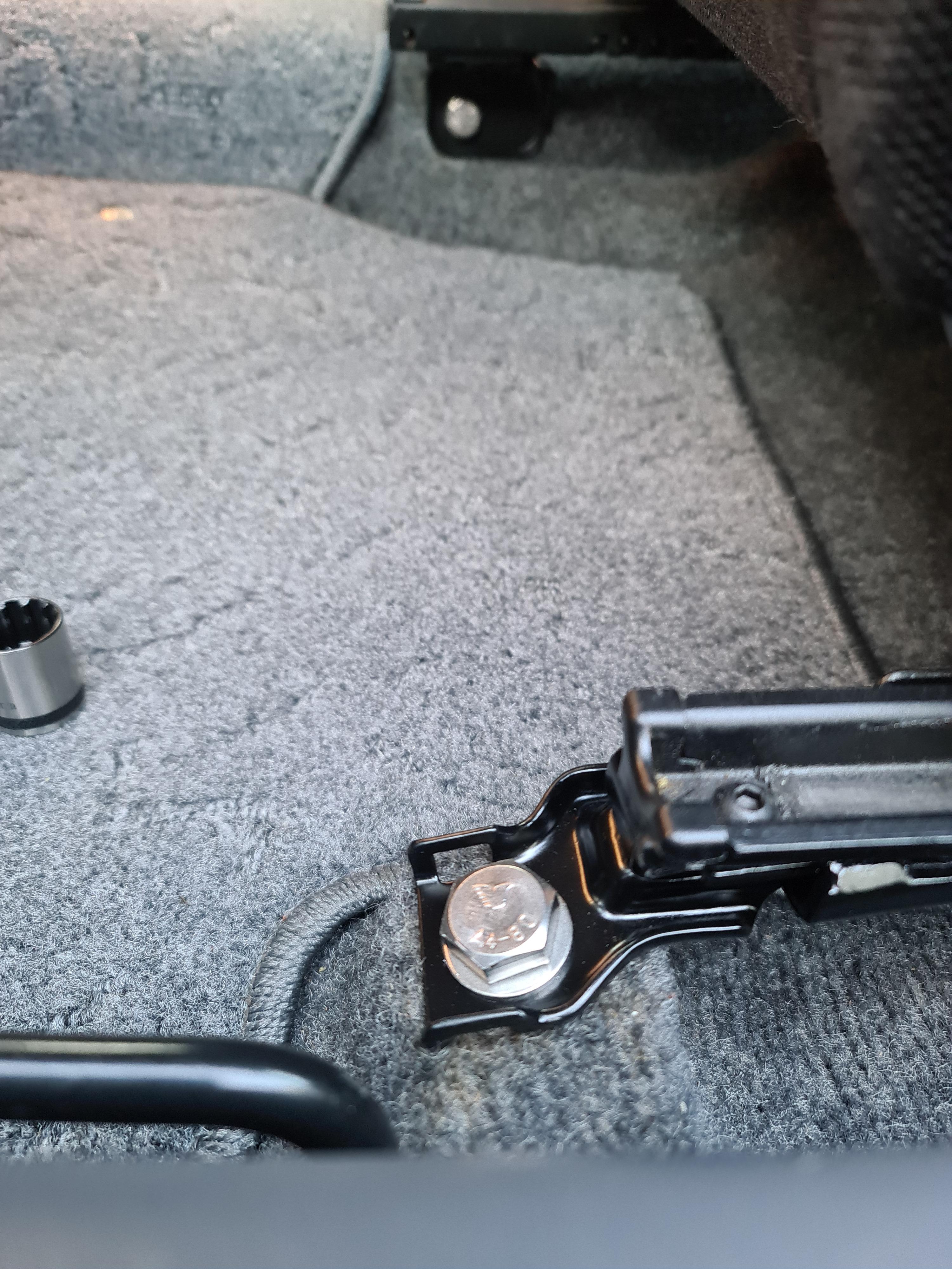

So lately I got the driver seat out to paint the rails. Did that, and re-fitted them and the seat.
However the threads on one of the bolt holes decided to shit itself, so out of frustration I decided to re-tap them and fitted some nice beefy M12 stainless steel bolts

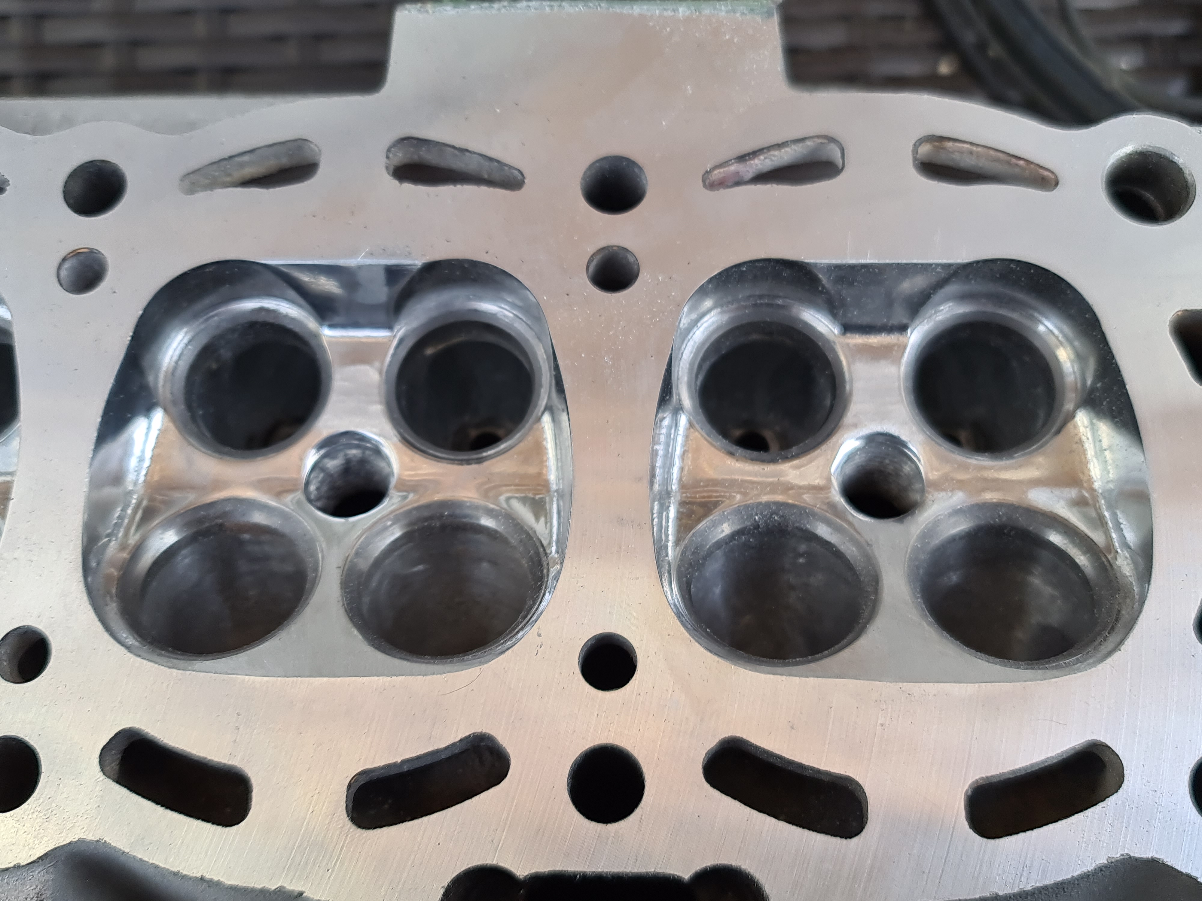

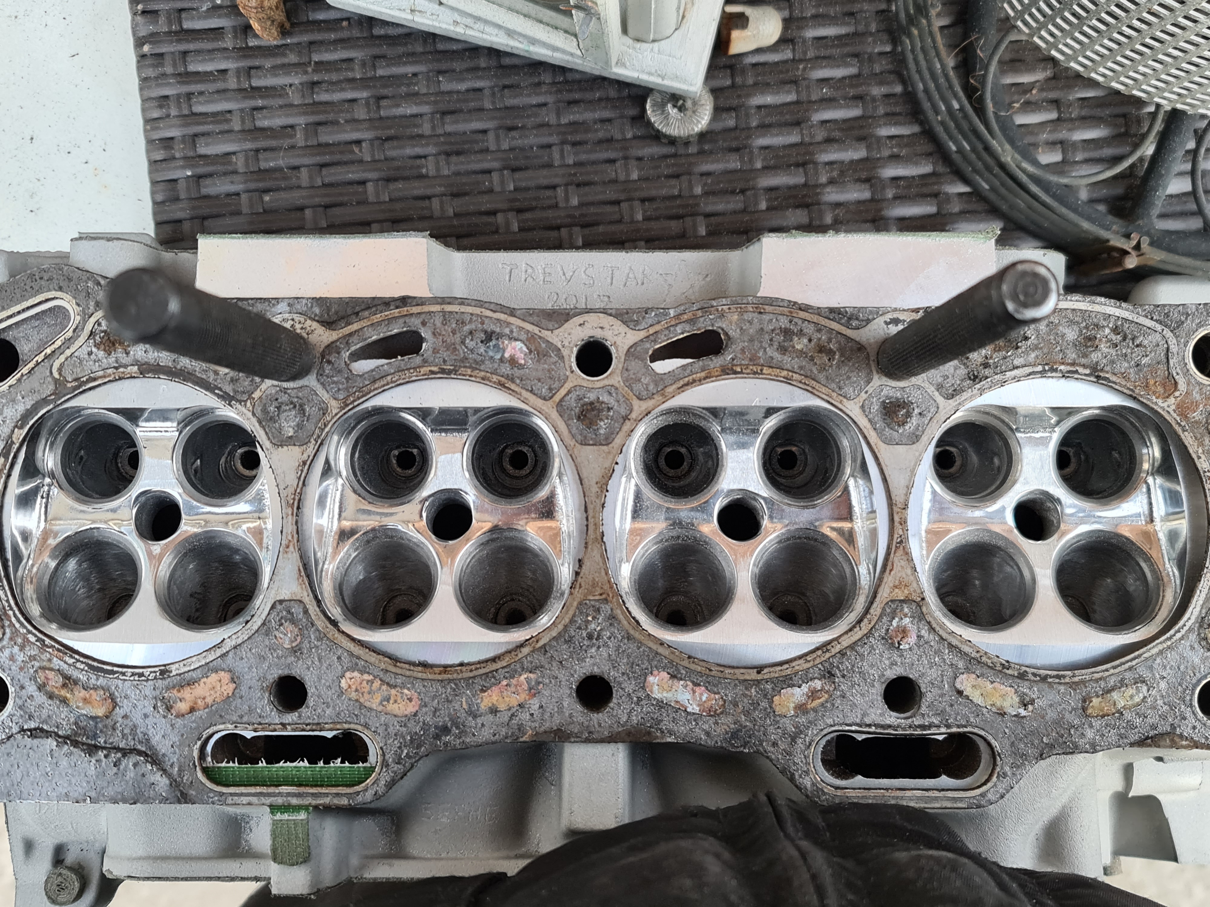

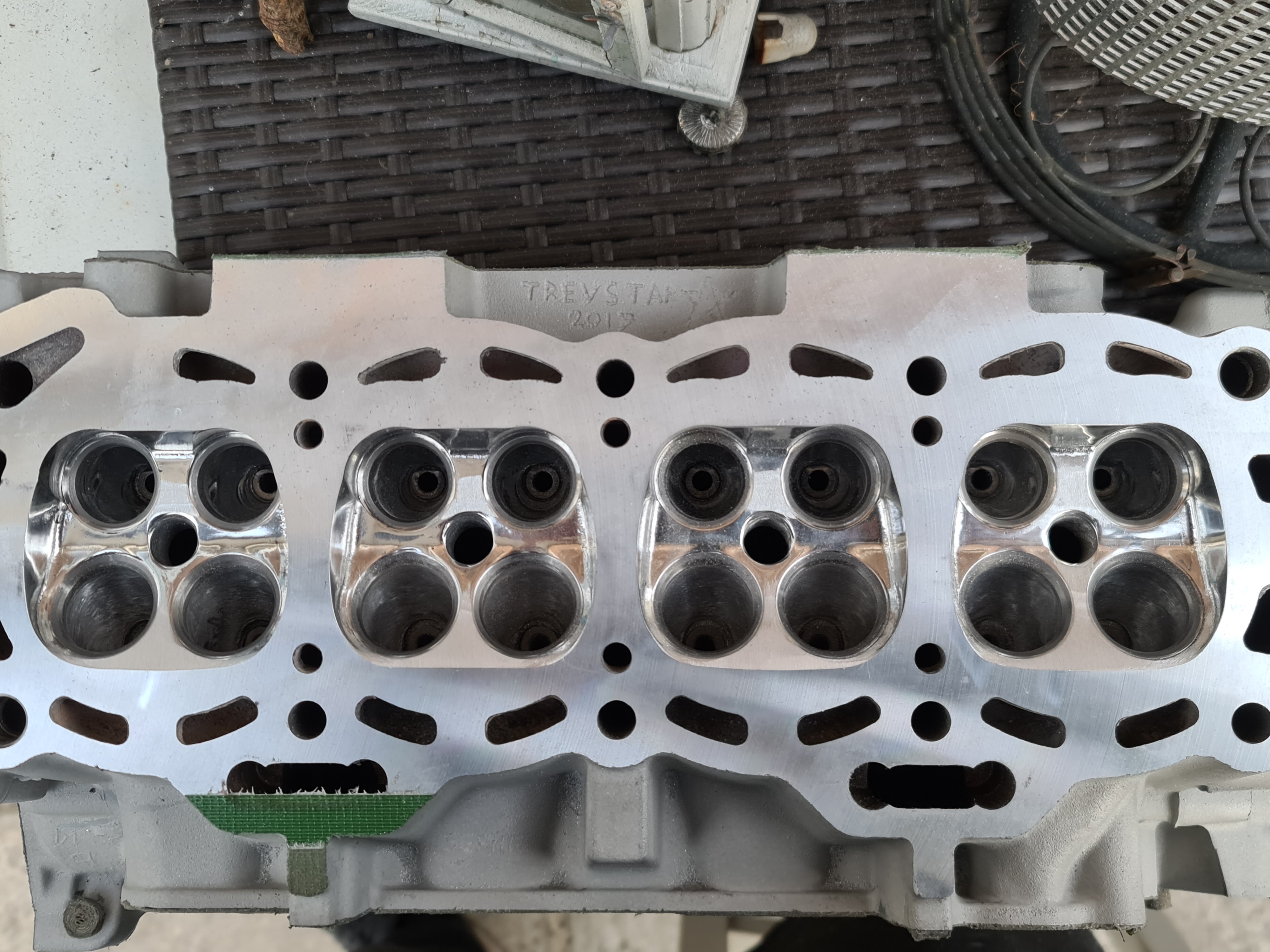

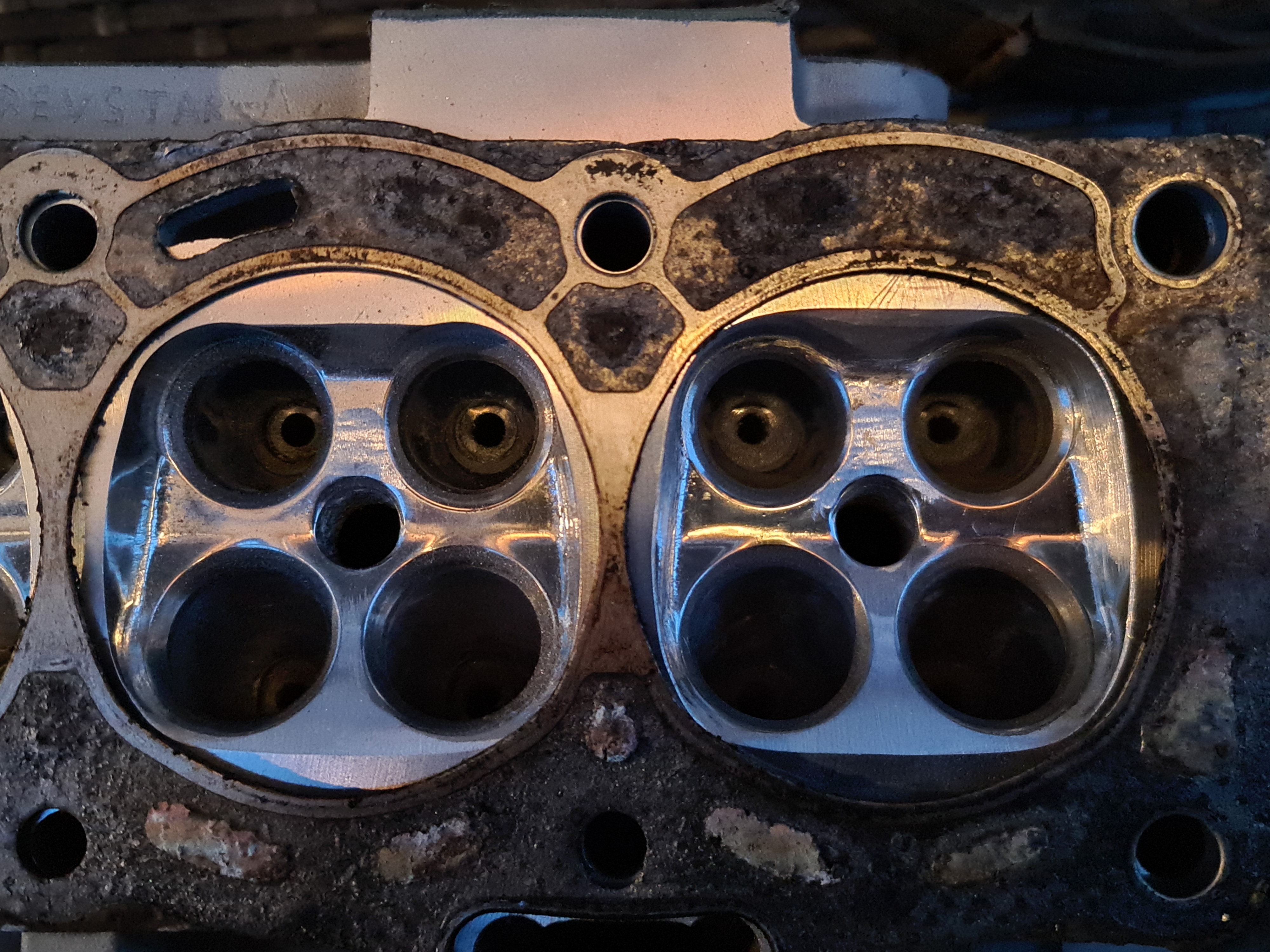

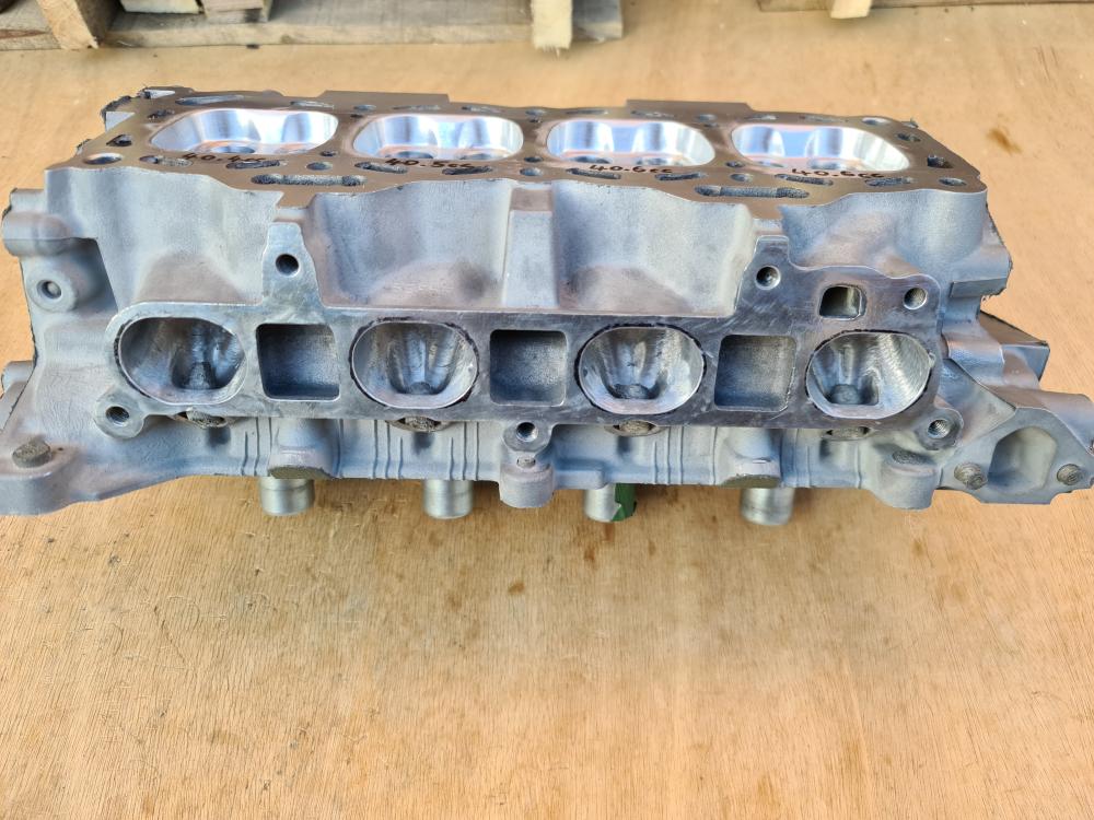

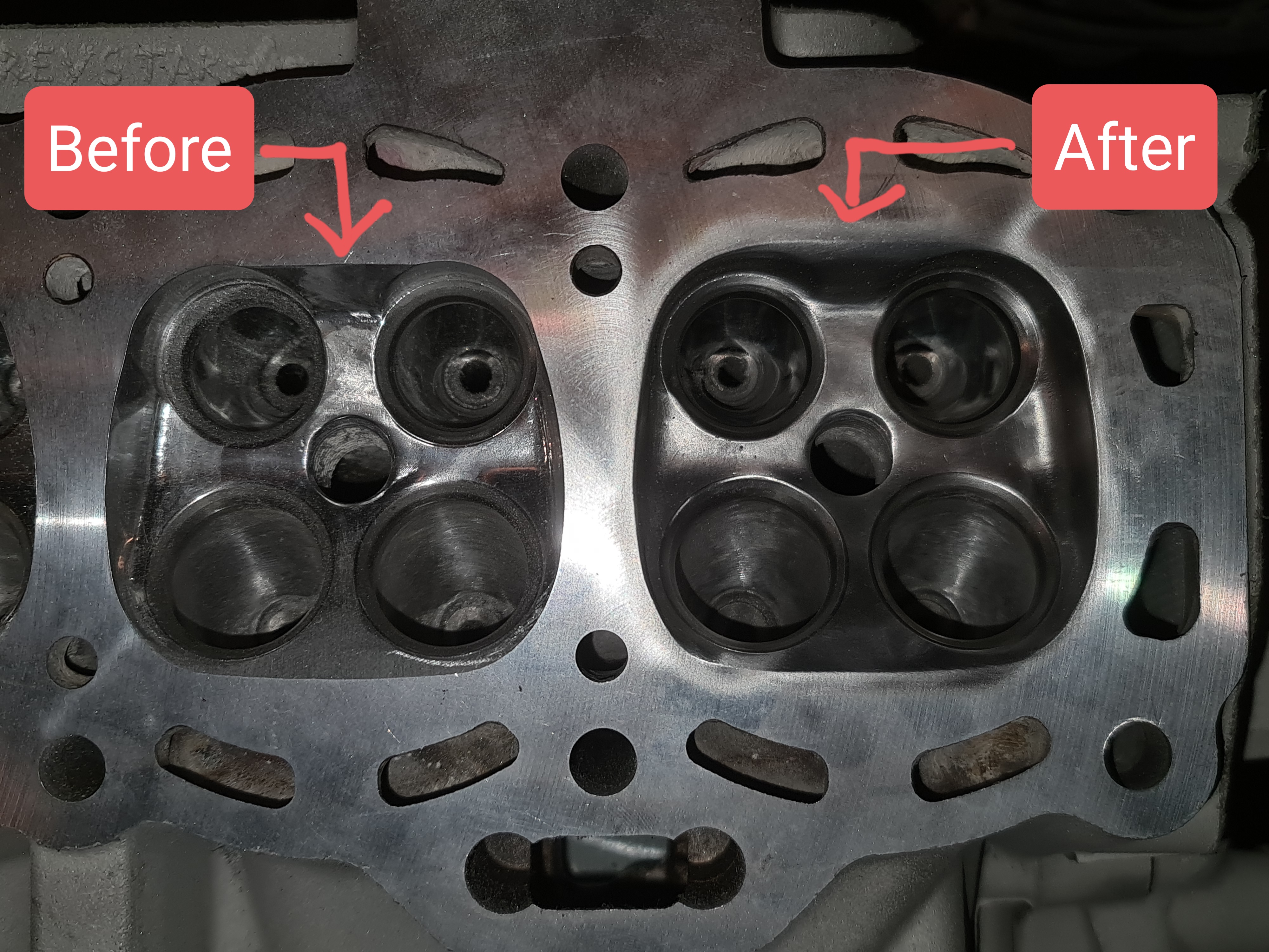

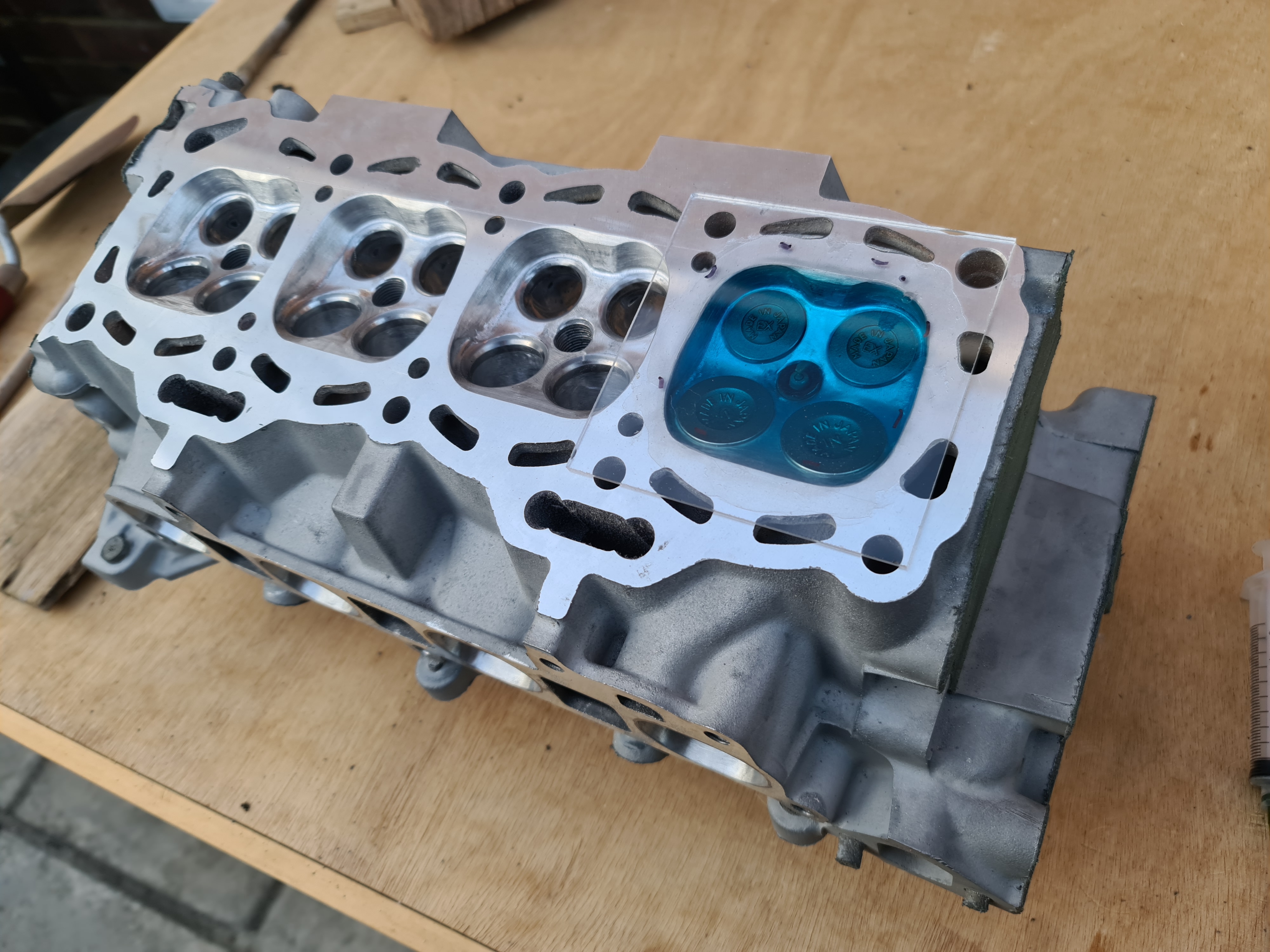

But big thanks to @Sam44 for his advice on improving the flow of the chambers, I went and collected the head just before they started so that I can make the changes suggested by Sam and then take it back to be coated.

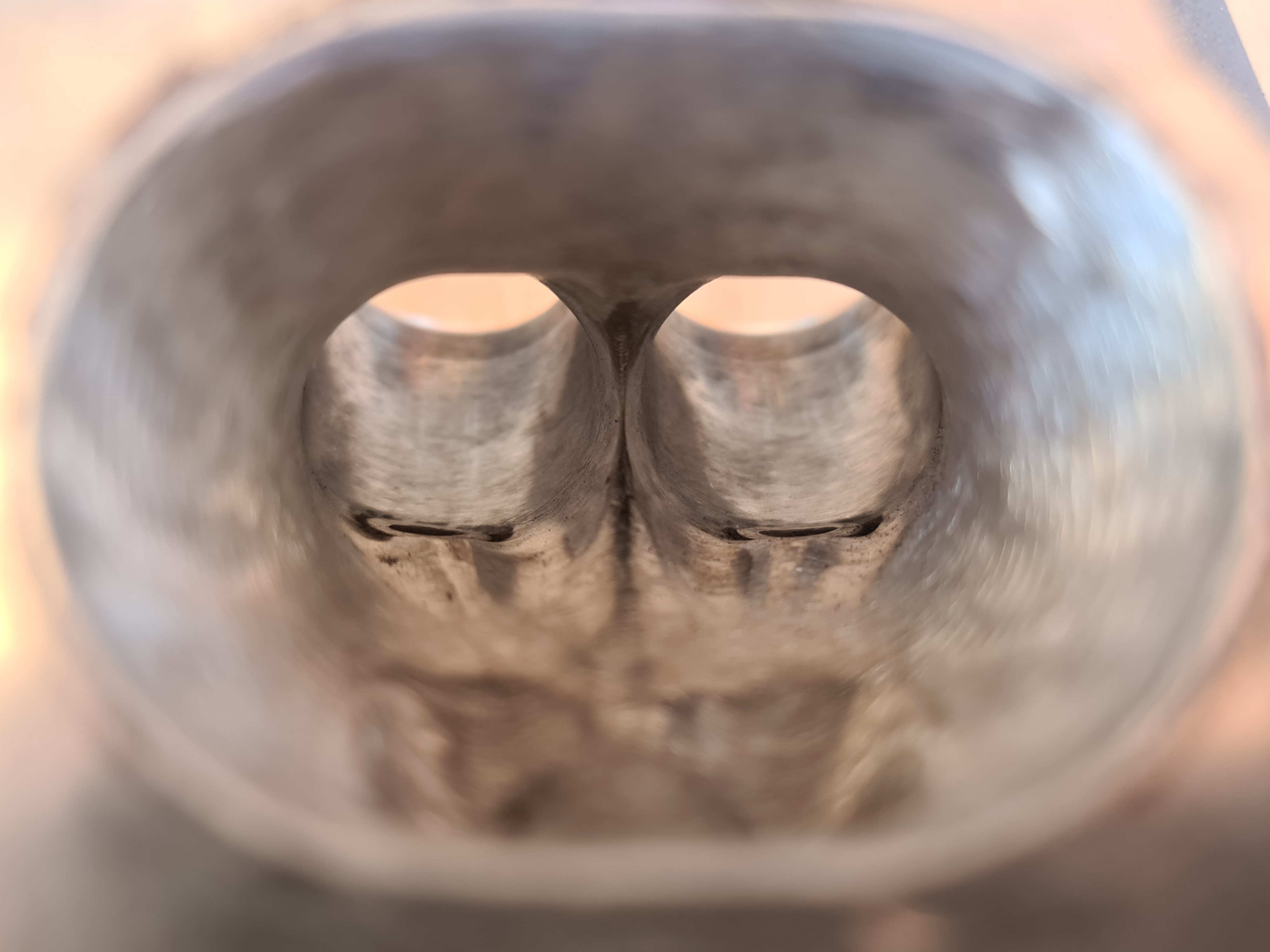

Started with the lip on the intake side:
And below is all lips on all 4 Chambers removed:
20210408_181158.thumb.jpg.b0d1bd742a6f6c95185732b2acb6515d.jpg20210408_190329.thumb.jpg.c08048e59f949fffe346414efd4d46f9.jpg20210408_190438.thumb.jpg.bc28e001a3157ca36eca78bac28100cf.jpg

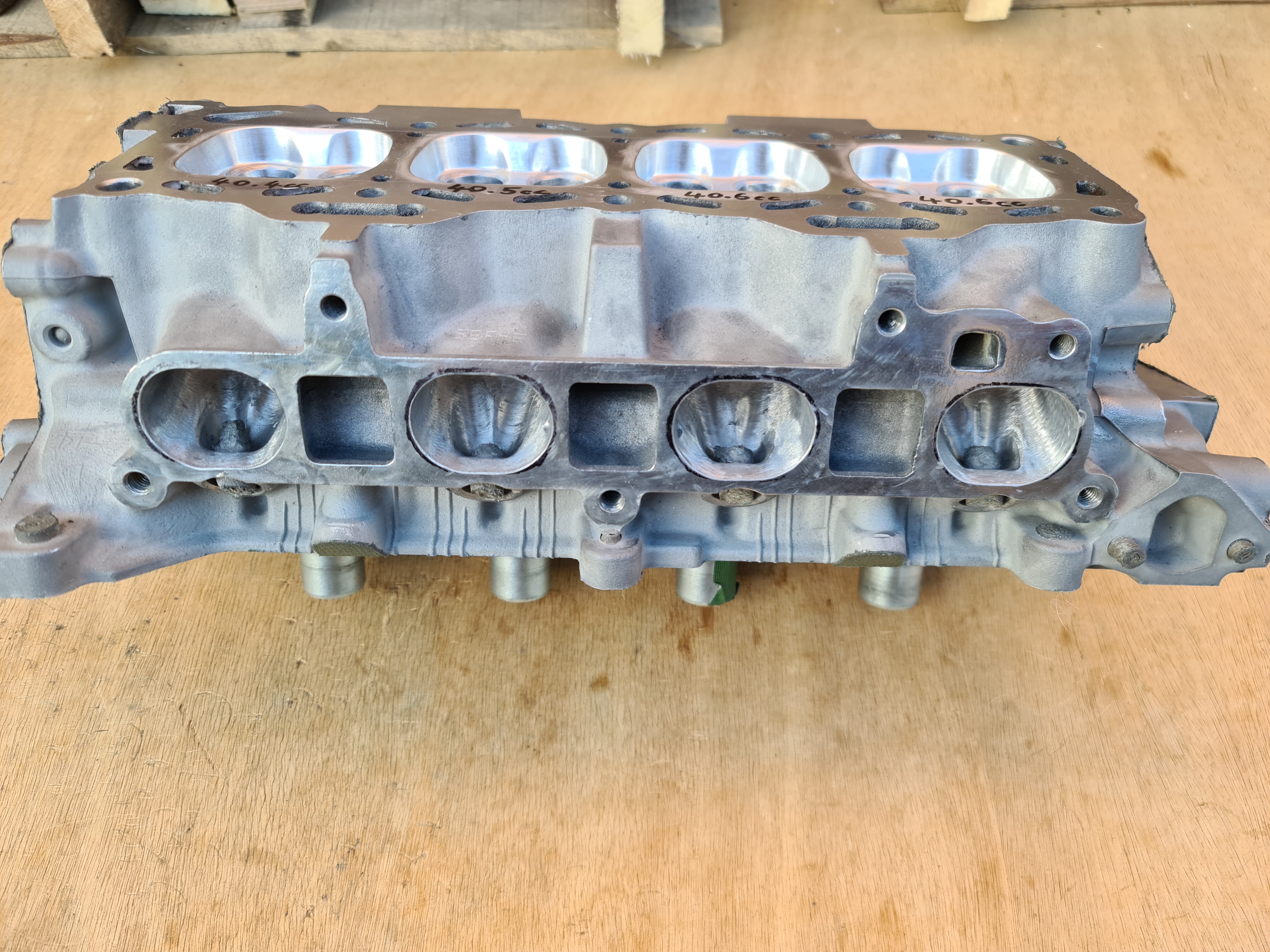

After that was done I turn focused to the portion of material between the 2 exhaust valves. Only done the one chamber today, but I will continue tomorrow, but you can compare the one I've done to the one next to it:
20210412_045940.thumb.jpg.87ba650ec7cd93e29655601e03b8ff8f.jpg20210408_211008.thumb.jpg.0af5ad024ef7941c404359a26bd6876f.jpg20210408_210943.thumb.jpg.cf092eb295cc32c6be6d9c85a6a9b8b2.jpg20210408_200532.thumb.jpg.fc60fdcec7a9f693e617966c75cfca30.jpg20210408_200626.thumb.jpg.3cc8f3e85f6efe1946eb2f9c88198d32.jpg20210409_002030.thumb.jpg.fbc5693e814569ff192ceffb12324c05.jpg
This should hopefully help exhaust gasses flow a little better around and out the exhaust valves

lovely job. the gains here are some of the best. you can cleaerly see now as the valve head lifts off the seat it flows across 80 to 90% of the inlet valve circumference. there is only 1 place/person i know does this to these heads and now you. keep up the great work. this is very similar to the head im running with the exception that my valve guilds have not been ground back.
have you port matched the inlet manifold to head?. you can use the gasket as a guild.
Edited by Sam44
Thanks again for your advise, if it weren't for you it would never have been done! :thumbsup:
Was scared to touch the chambers first time round as I didn't have the knowledge of what to remove. Do wonder about my valve guides now though from what we talked about
I haven't gasket matched the inlet ports as of yet as I didn't have a gasket so I was going to revisit that once I had a gasket to match it to, but I found an old one the other day so I shall get on and do that once I finish sorting the chambers!

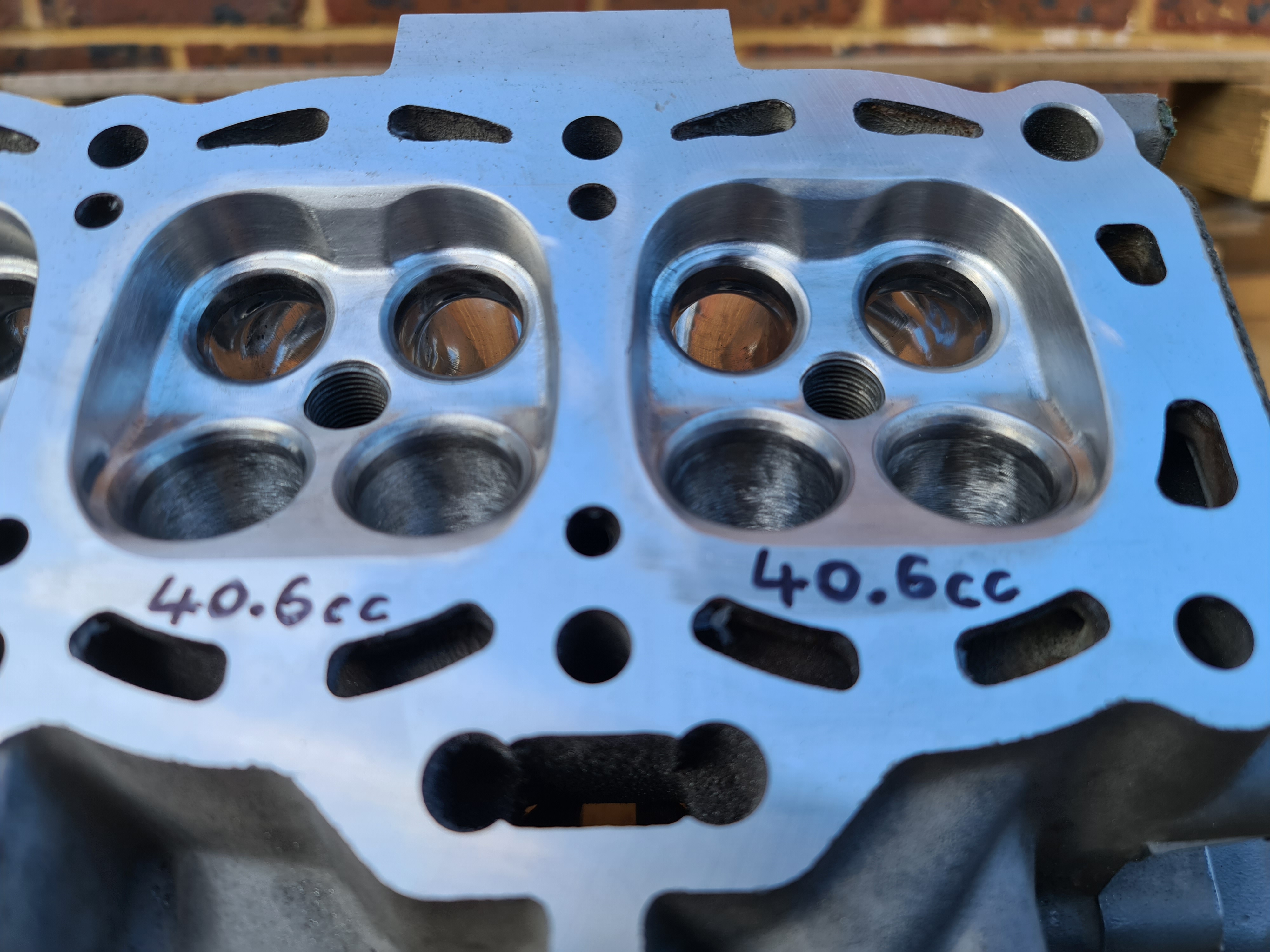

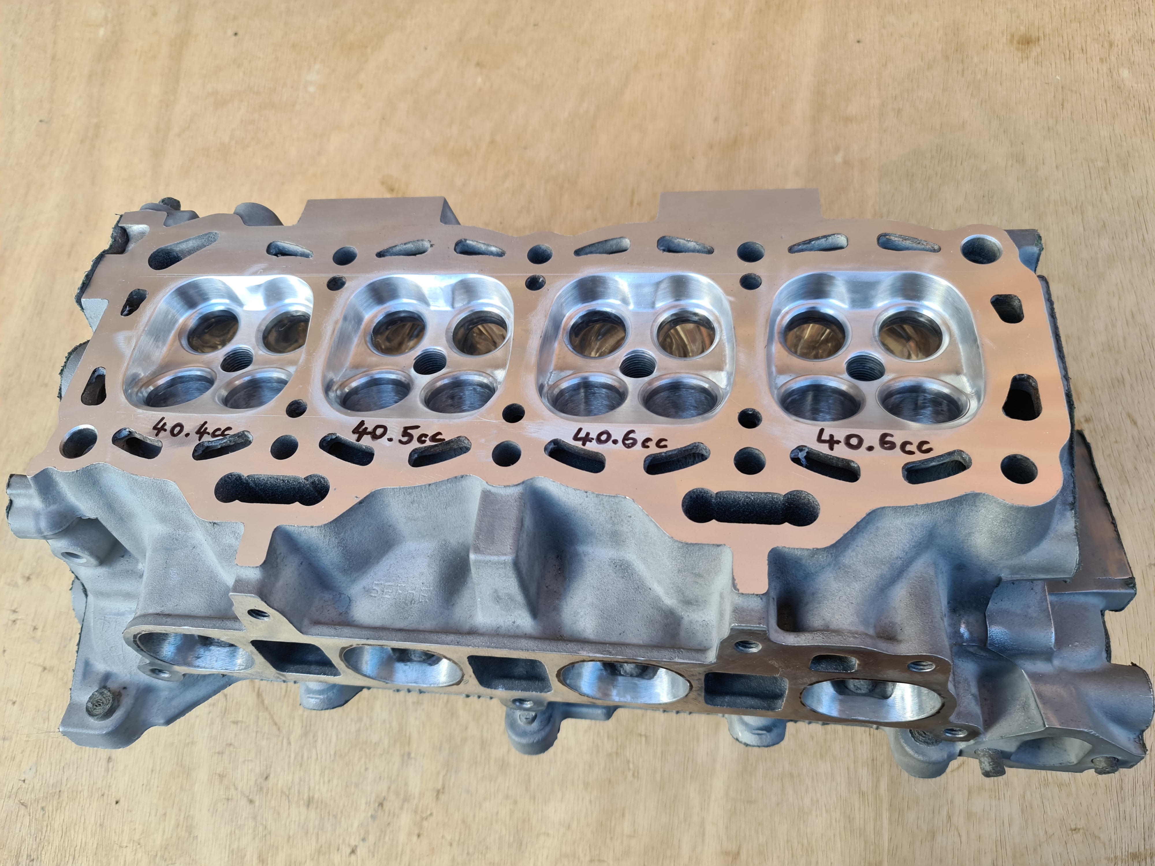

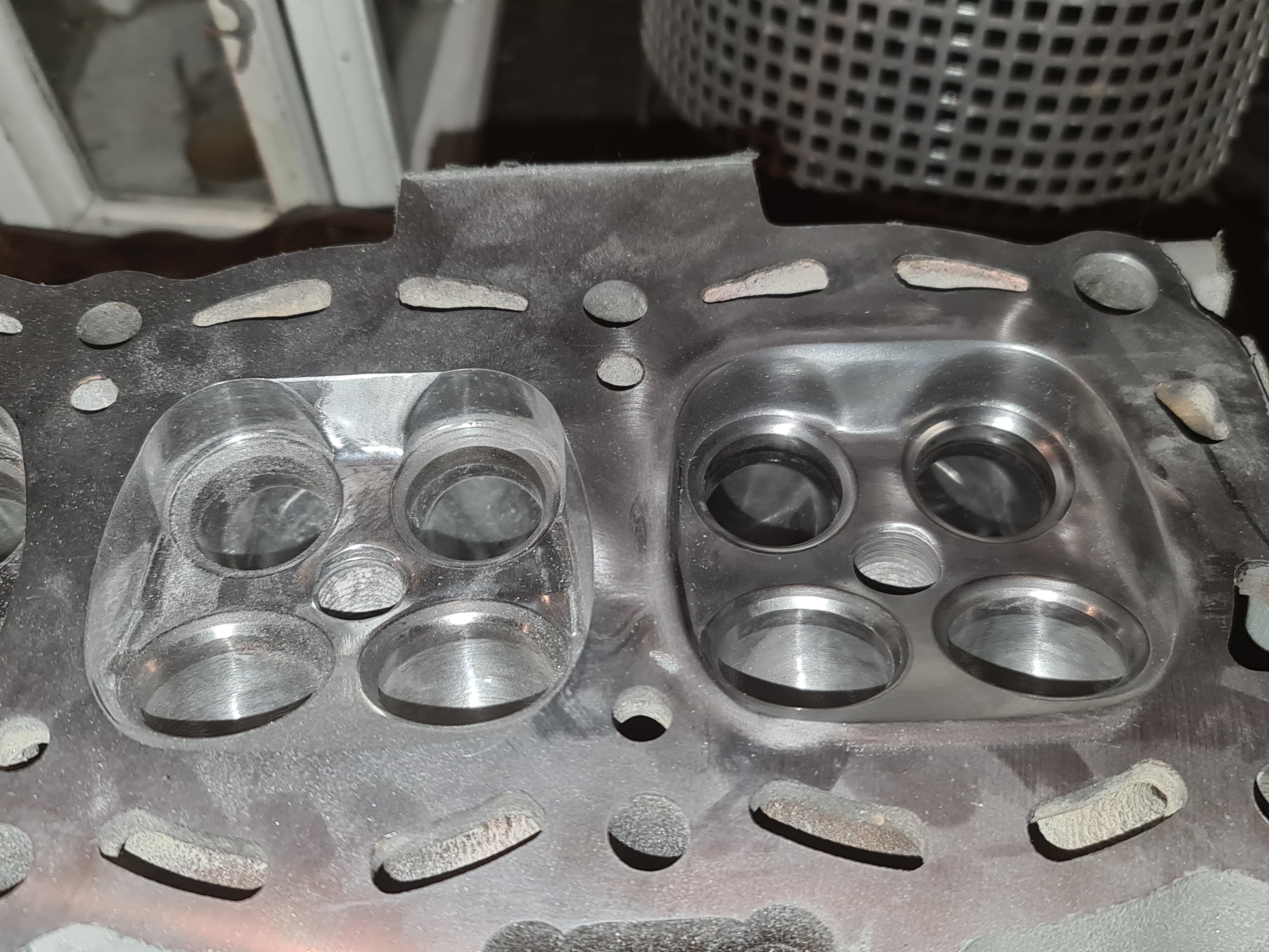

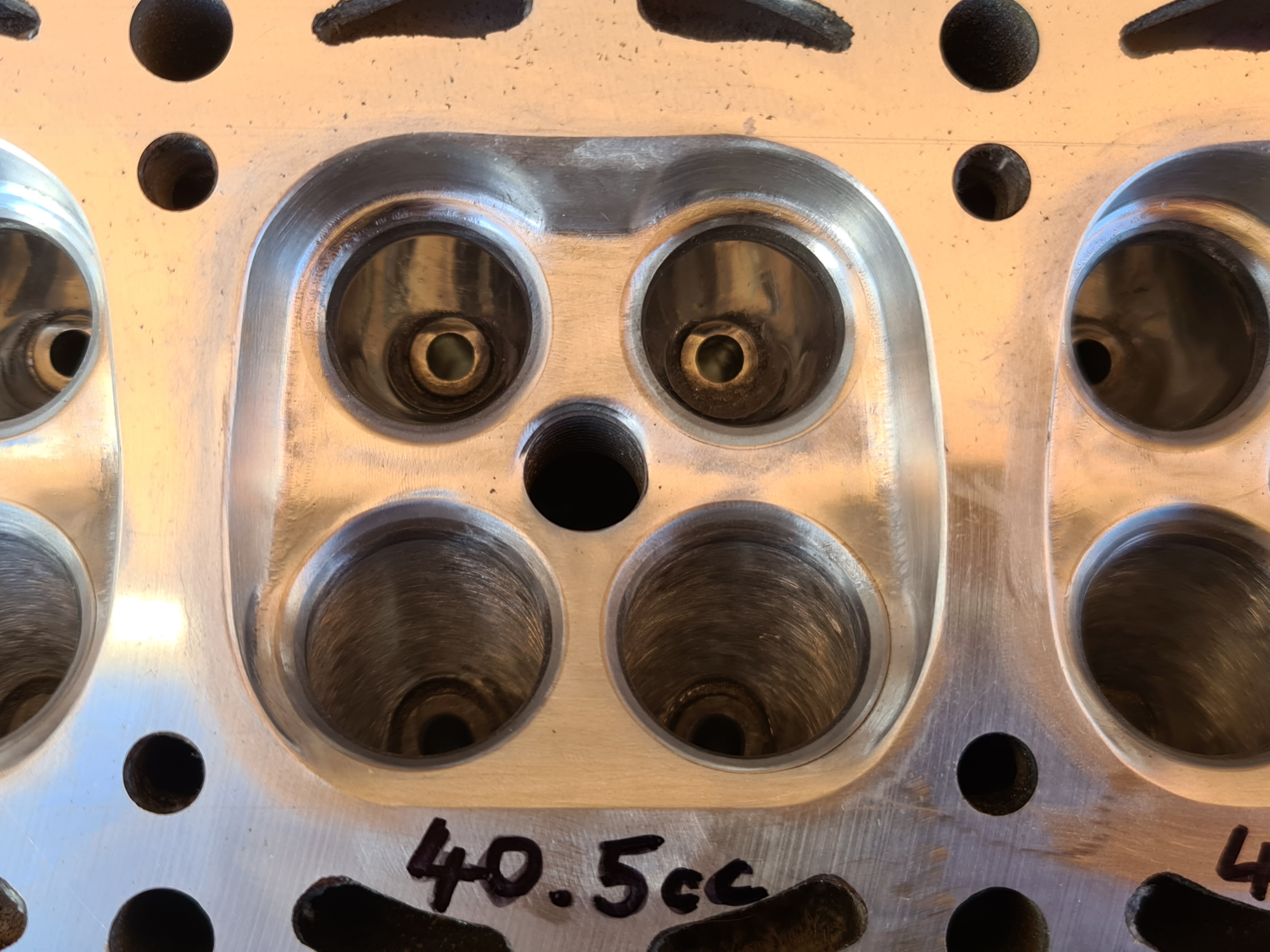

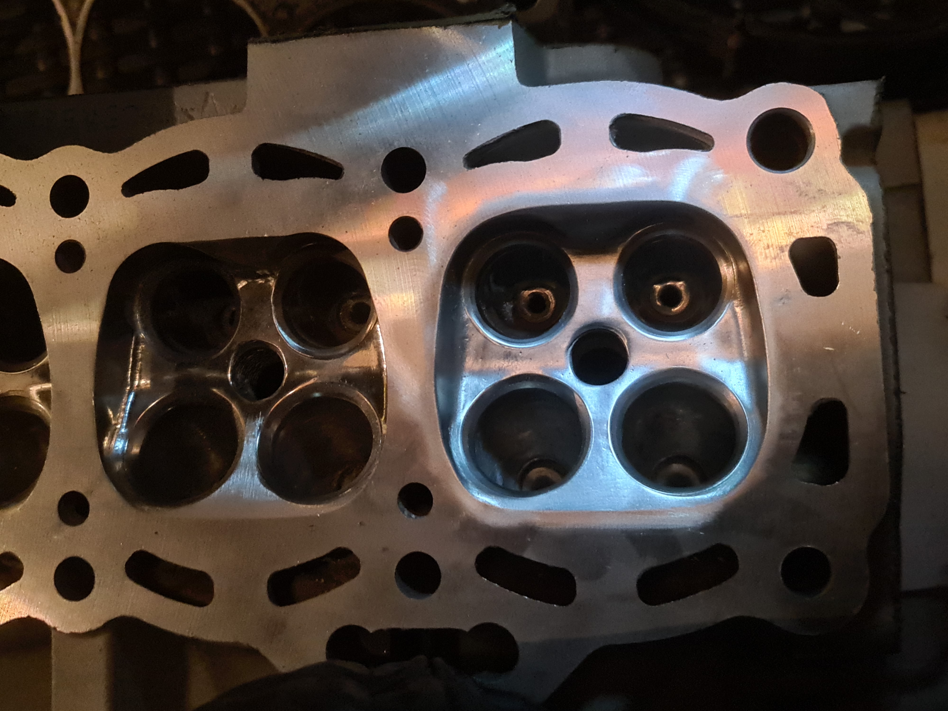

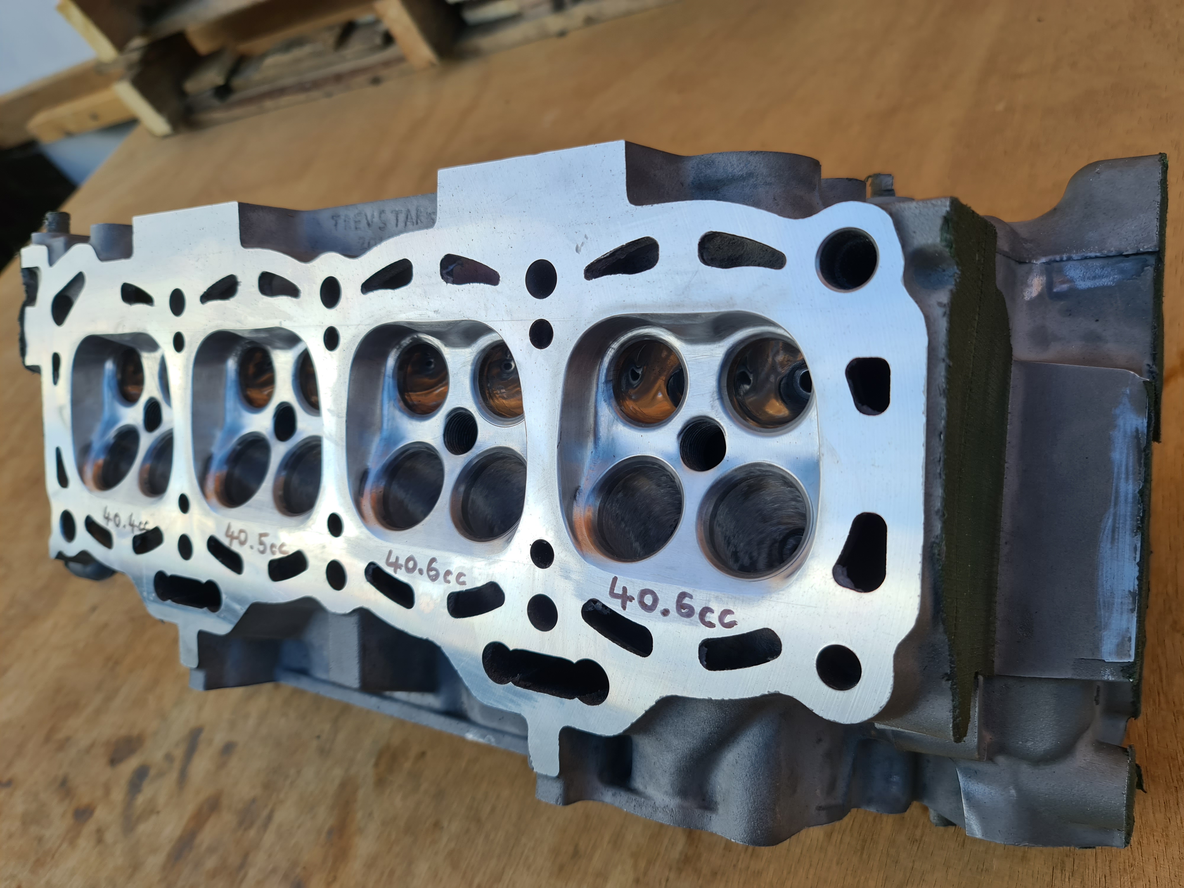

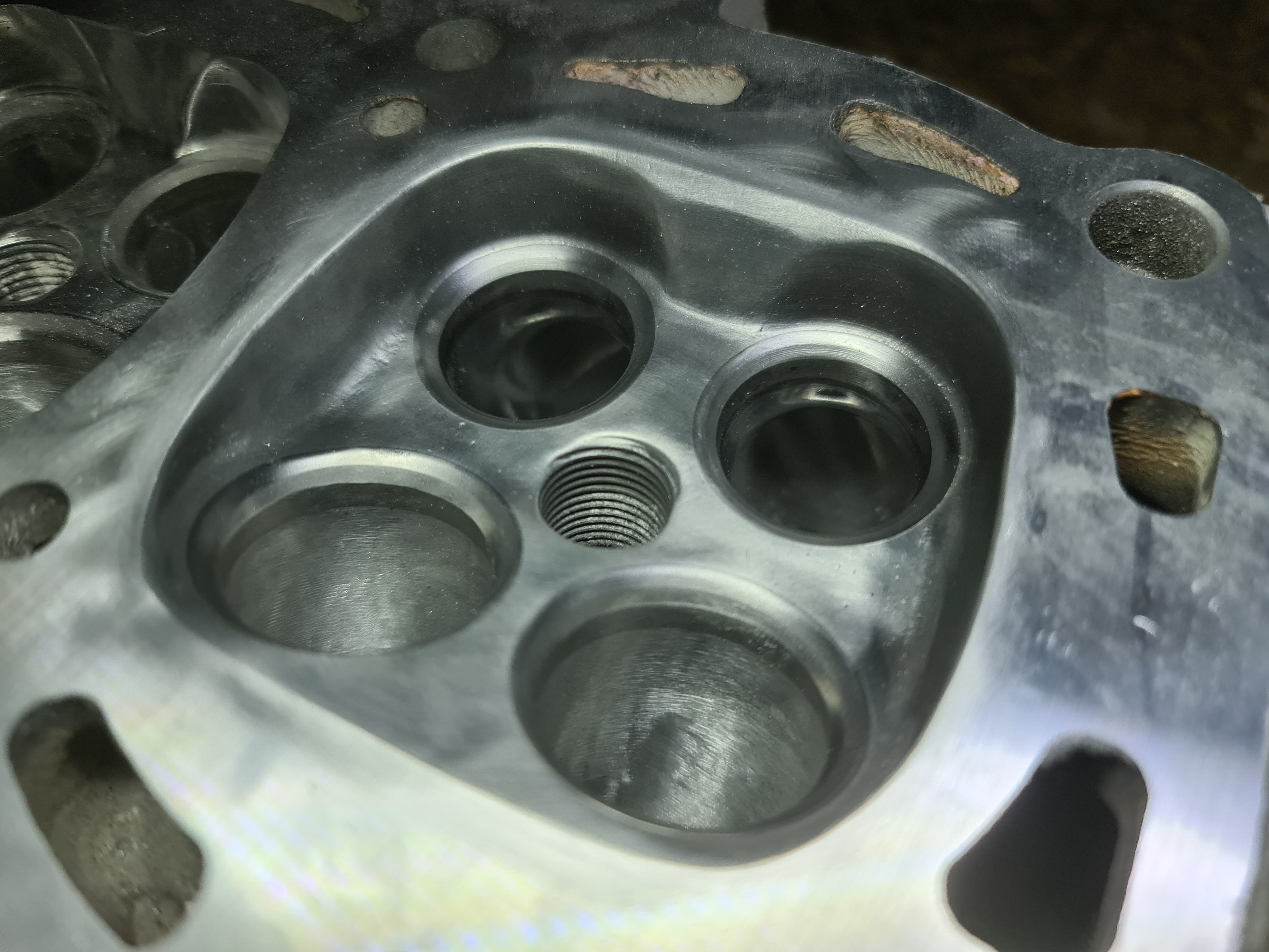

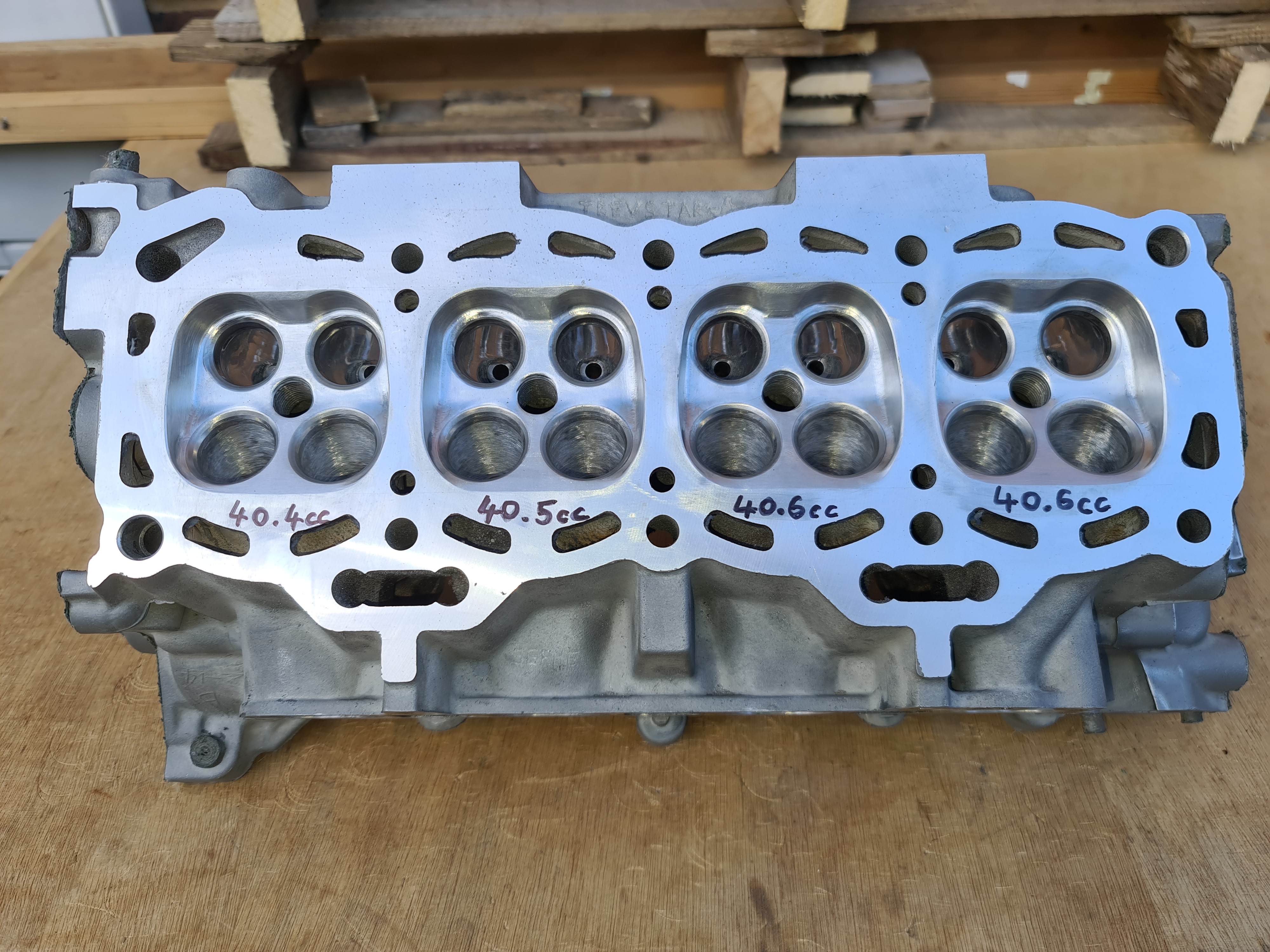

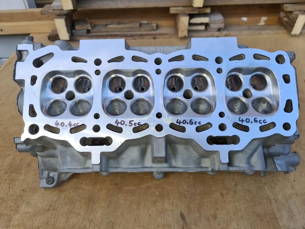

So ive finished the work inside the combustion chambers and measured their volume. They were all within 0.5cc of each other but I wanted to try to bring this closer, so I did a little more trimming inside two of the chambers and re-measured them
I also done the gasket matching on the inlet side
20210425_185323.thumb.jpg.96f9299666b361ef75c1ccb8e8057104.jpg20210425_185407.thumb.jpg.7f44b33cf2a282973bc3cf13d7fb9317.jpg20210425_185425.thumb.jpg.f02f29dd10d8830389ee0e8128e1e16e.jpg
The final result:
20210425_185121.thumb.jpg.11a109d600cc957e38e2c37fa9c9fef8.jpg20210425_185220.thumb.jpg.9450bc031733cd3a0b8cef06a45eecc0.jpg20210425_185203.thumb.jpg.f0b0acc14258dce07dcb690cb8158cbe.jpg20210425_185135.thumb.jpg.4f3f6d1fa0216b2efca910a54d06d05f.jpg20210425_185245.thumb.jpg.0edf210b4ee42833d2004edceb31a3a5.jpg
I measured the chambers several times and on average (taking into account any measurement errors) they're all within 0.3cc of each other 😎 not bad for a back garden combustion chamber re-profiling
I used the dokuro valves I had previously bought to make the measurements as I only wanted to check they were all the same size, but I have decided not to use these valves for my build because these have a deeper dish in the valve face than the standard valves which lowers the compression slightly and I have removed quite a bit of material from the combustion chambers which will have reduced compression by a fair amount already, plus when I get the valve seats cut that will further drop compression by a tiny bit more. So to combat the loss in compression I will have to get the head skimmed even further but I need to check piston to valve clearances etc.

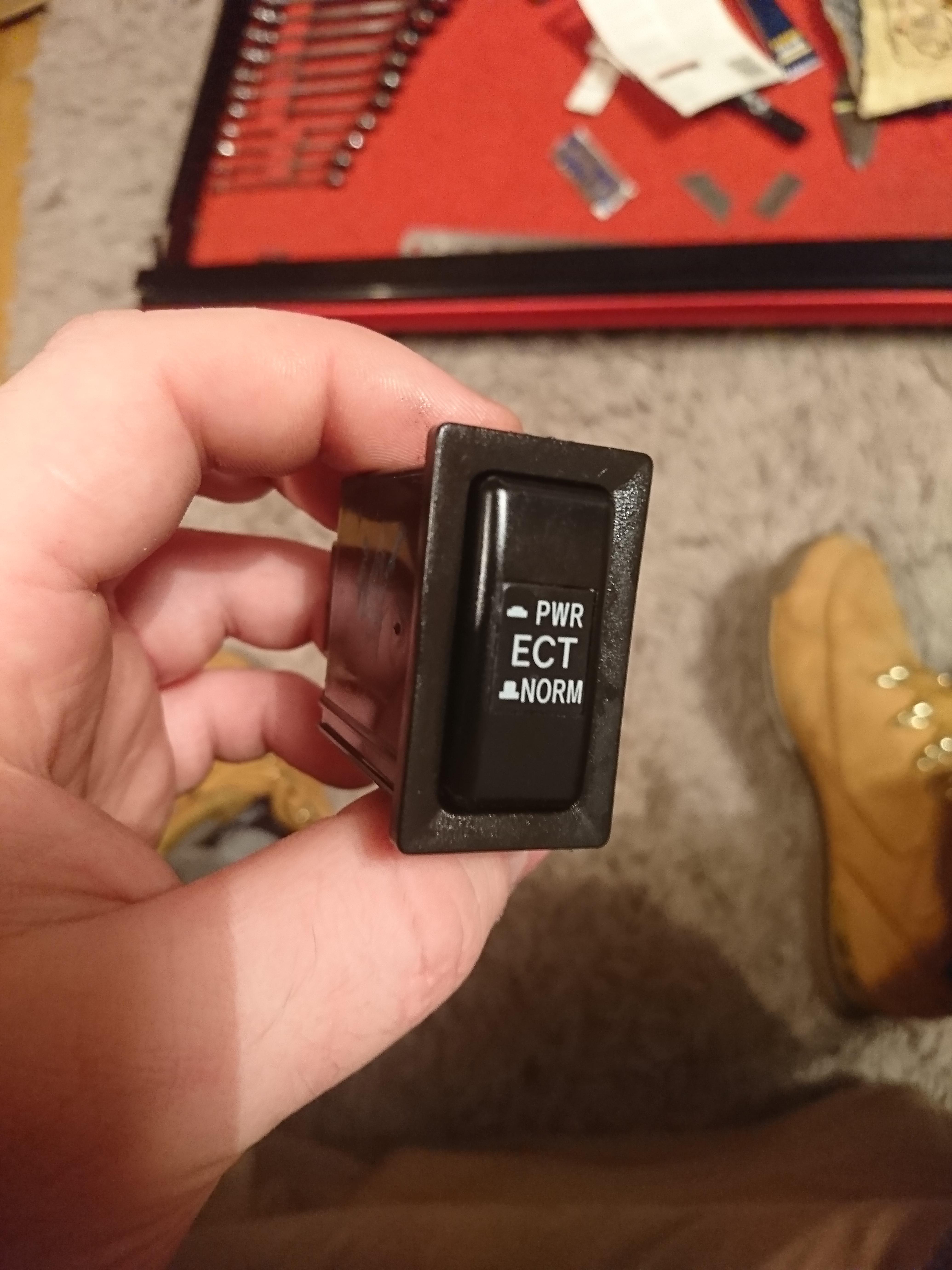

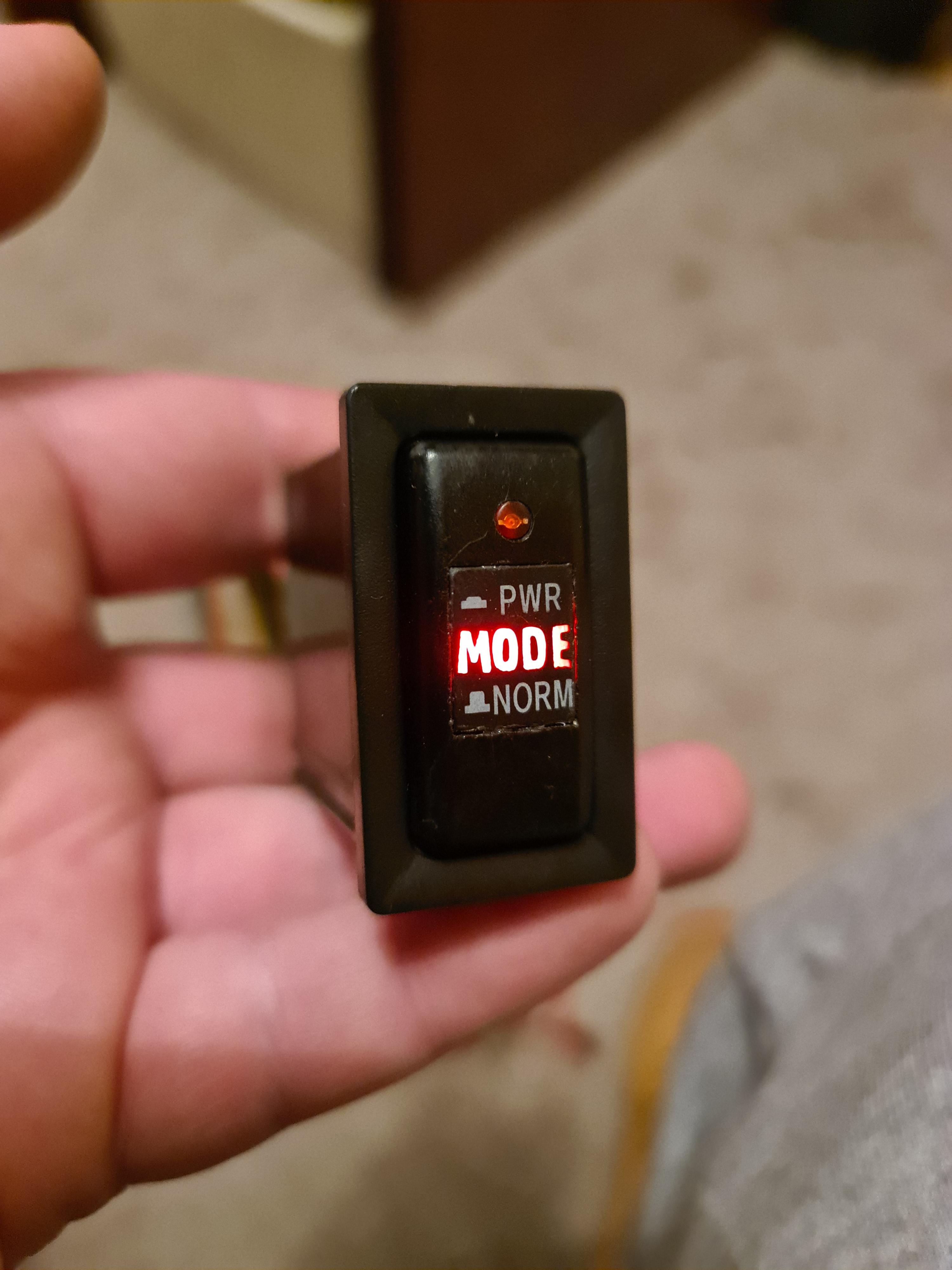

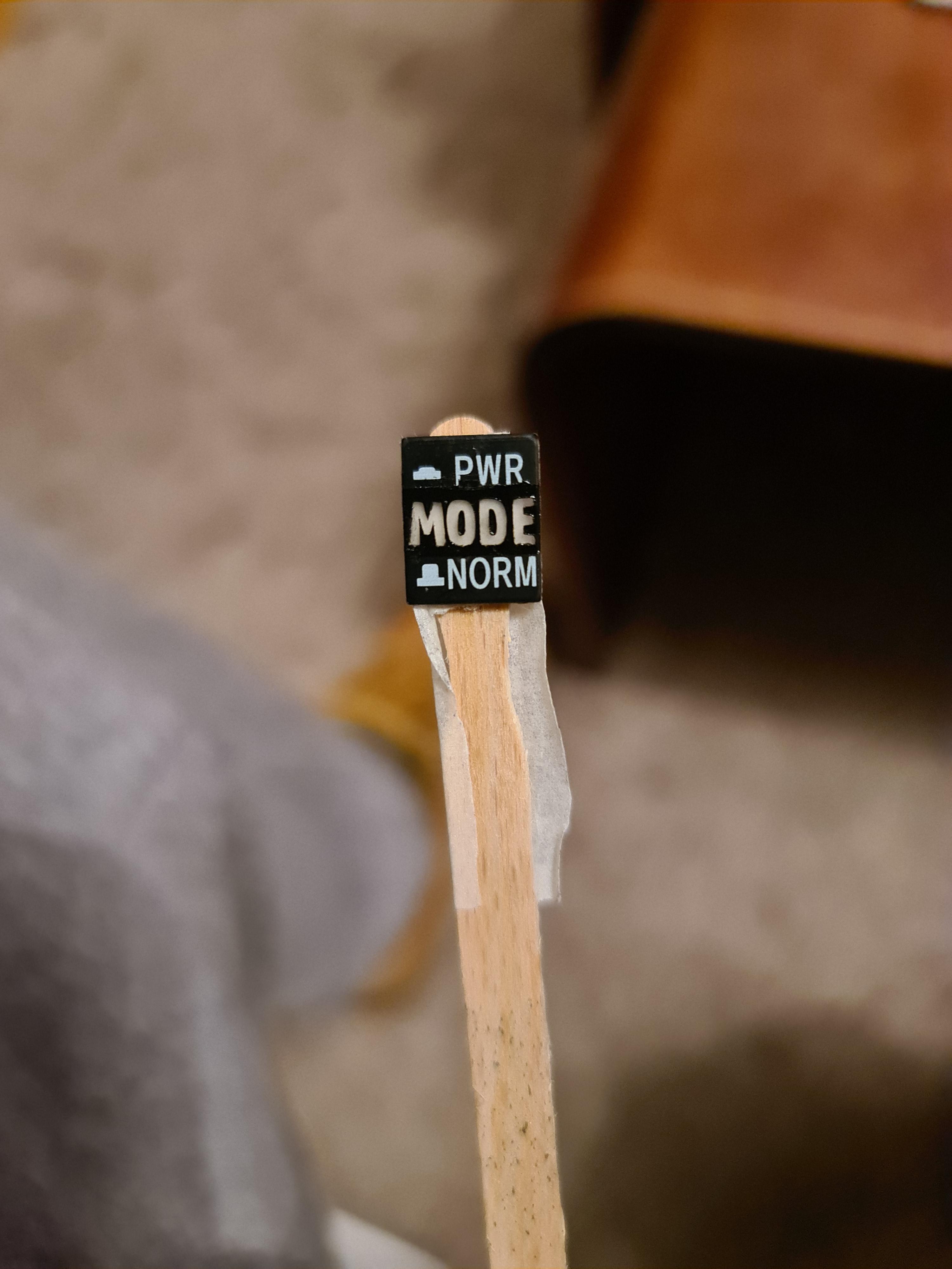

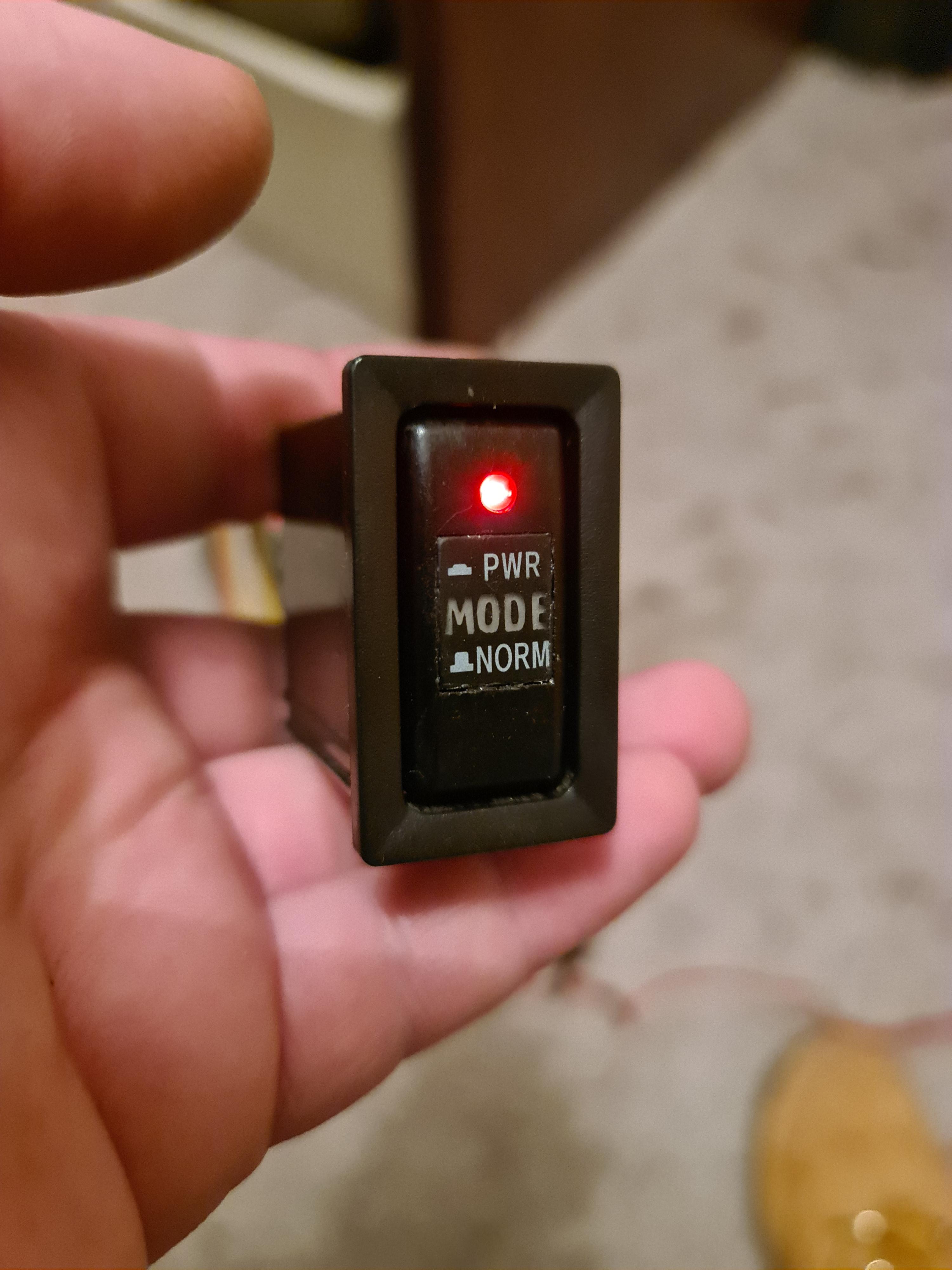

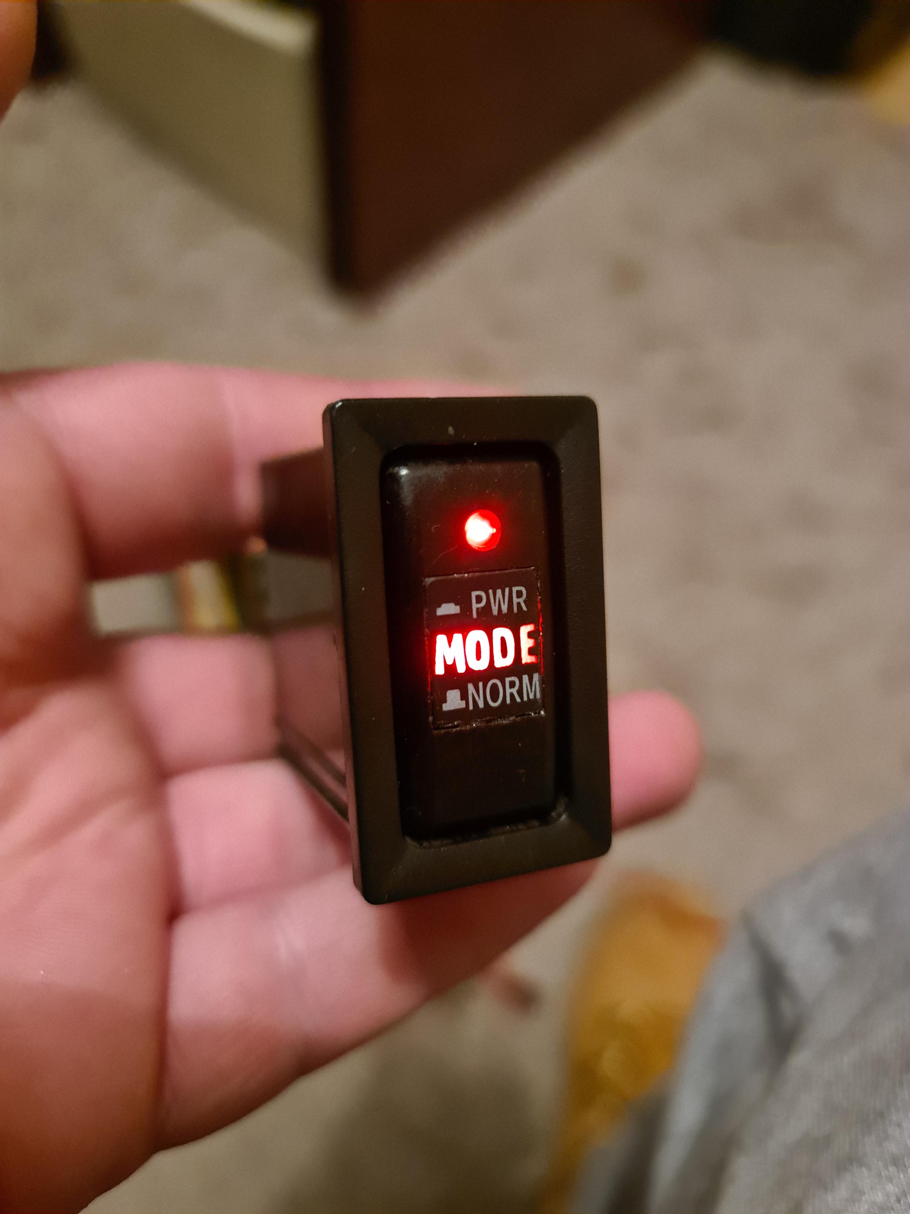

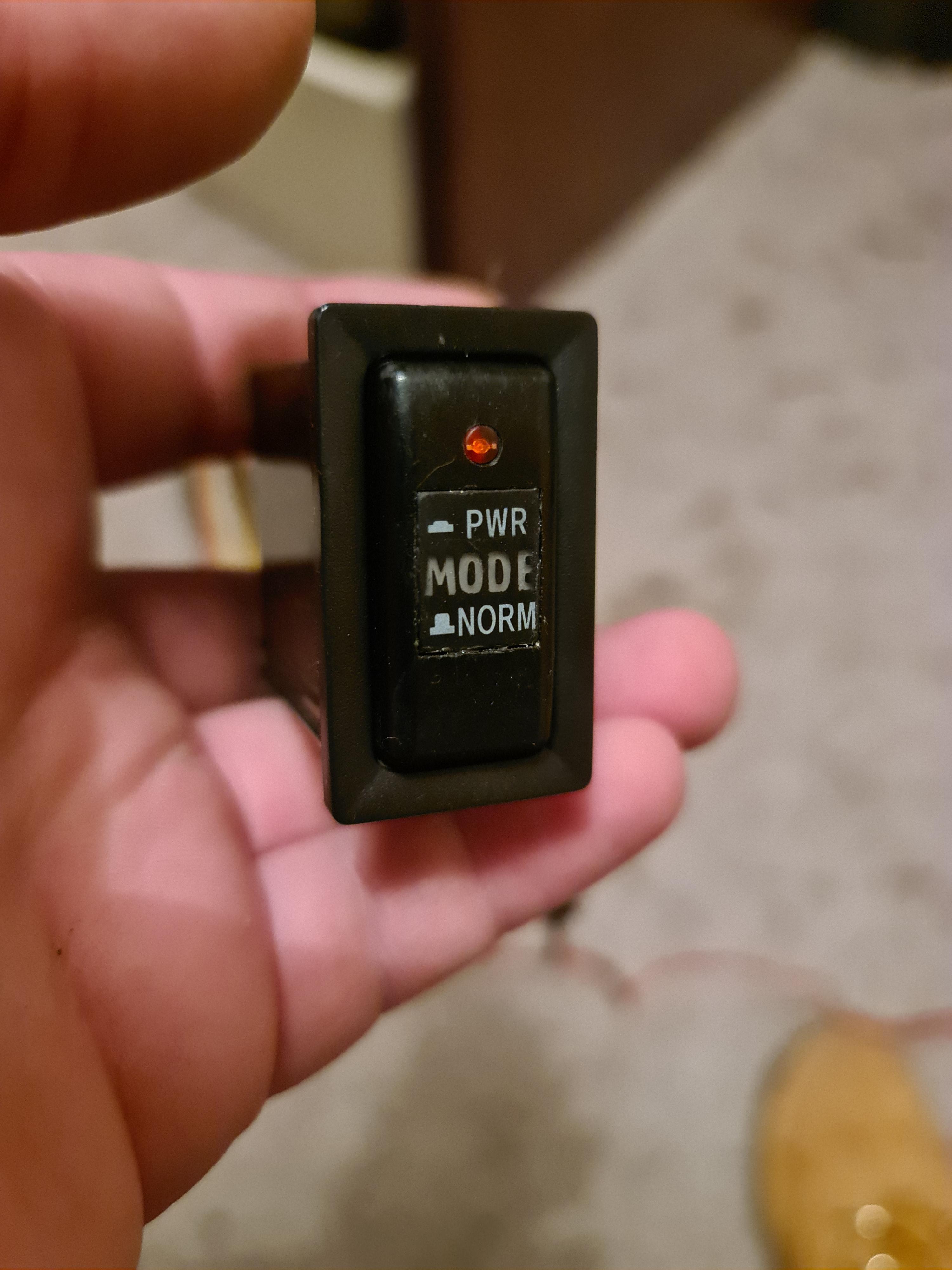

If you've been reading you'll probably remember the 'ECT' button I was gonna turn into a mode/map switch?
Well, it's finished and ready to go! And I have to say I'm well pleased with it!
After very carefully sanding away the 'ECT' text and letting it sit there for ages, I finally made myself a stencil with the word 'MODE', masked up 'PWR' & 'NORM' and airbrushed matte black over it which left me with this
The final product: (off)
On with backlight off
Off with backlight on
On with backlight

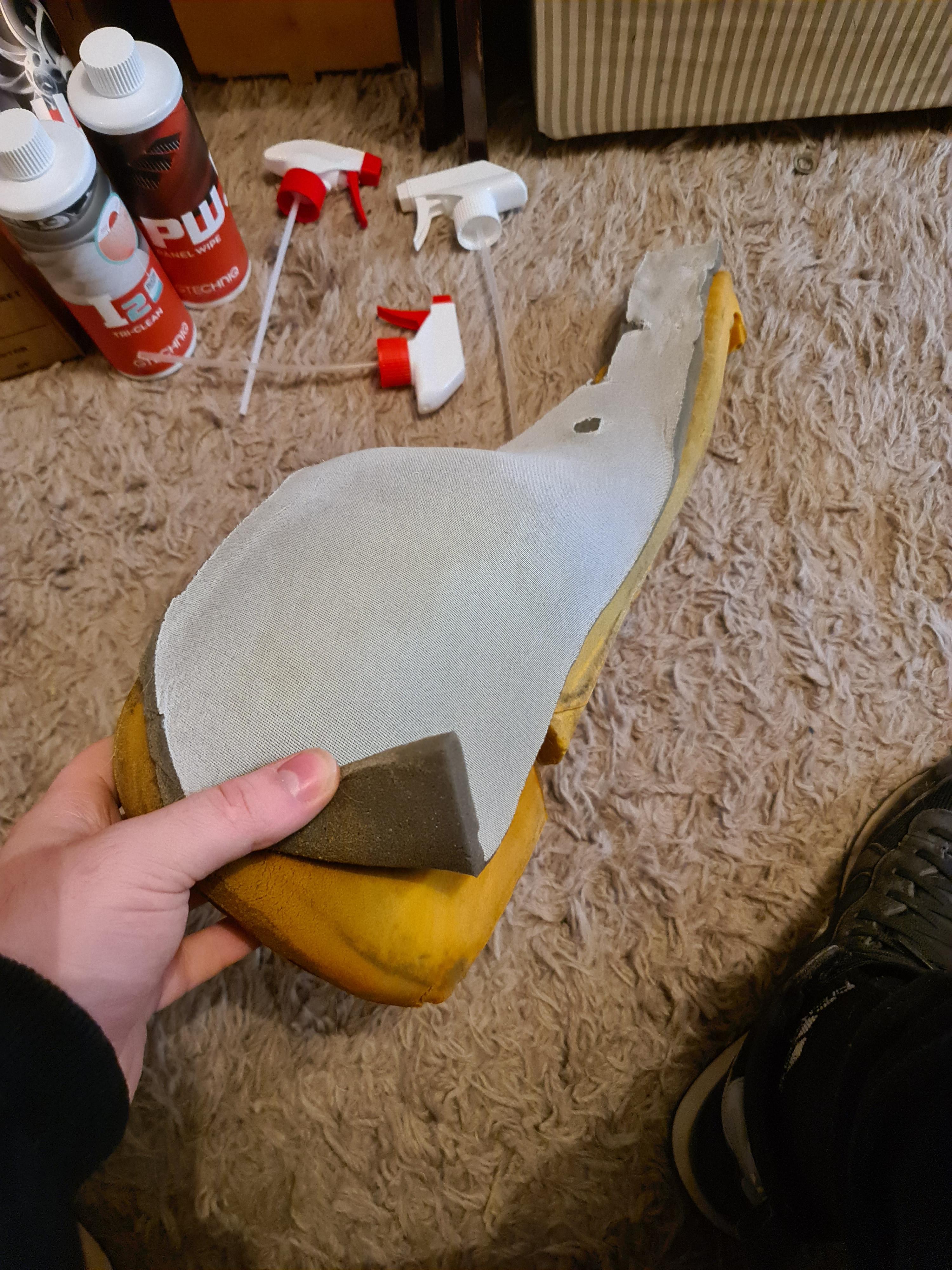

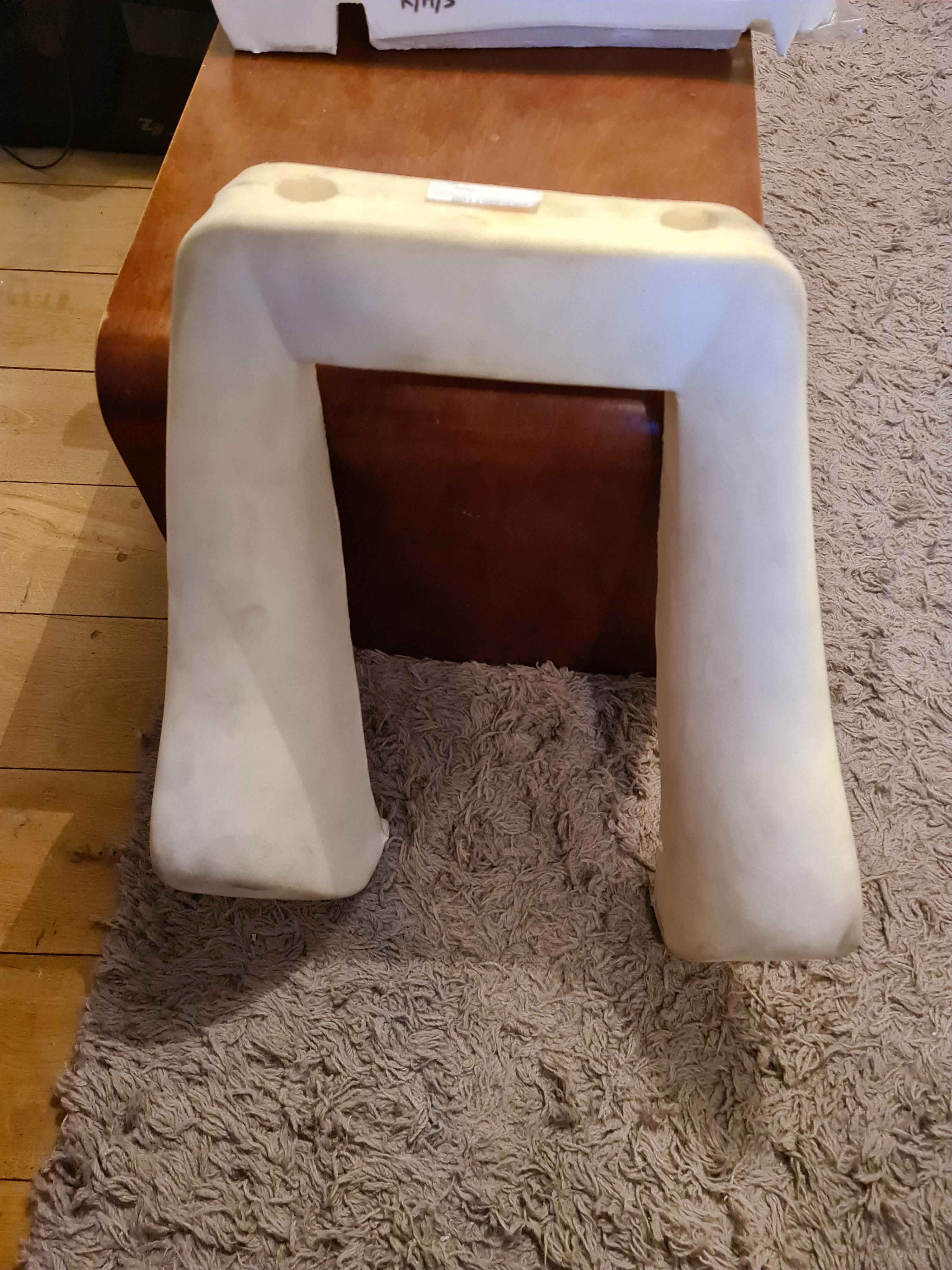

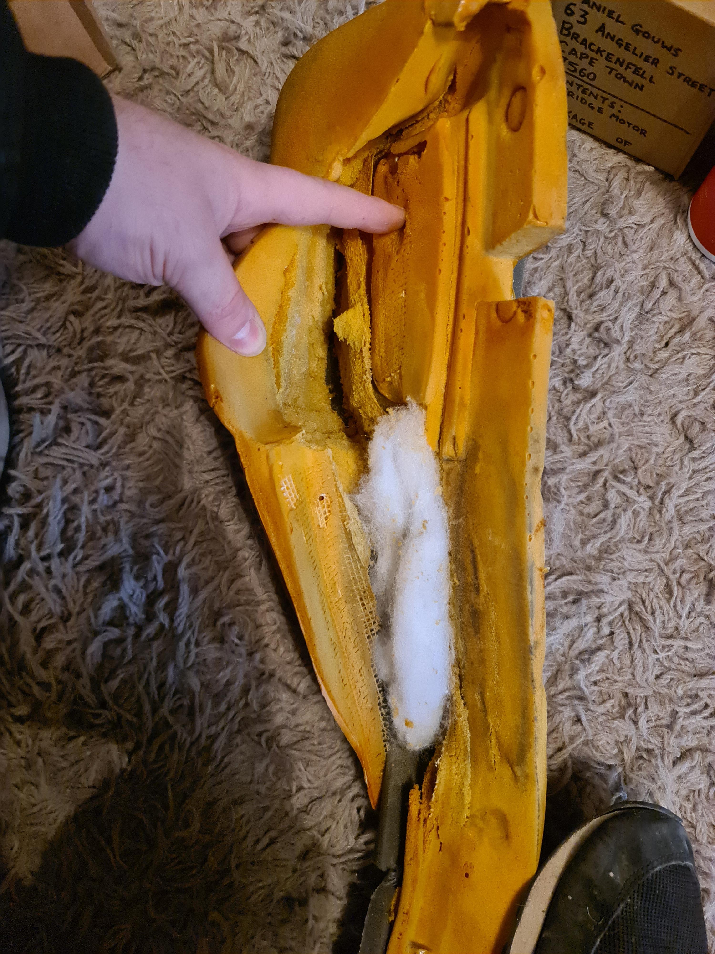

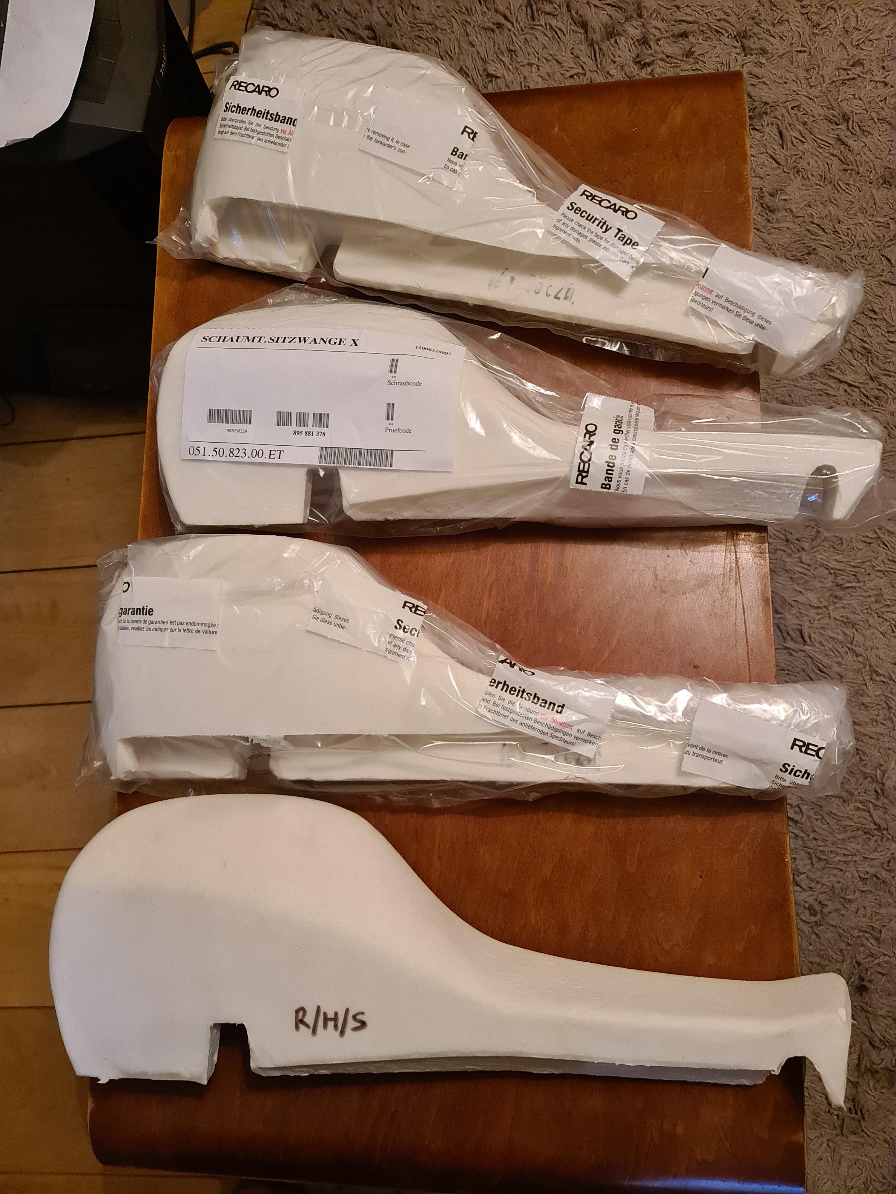

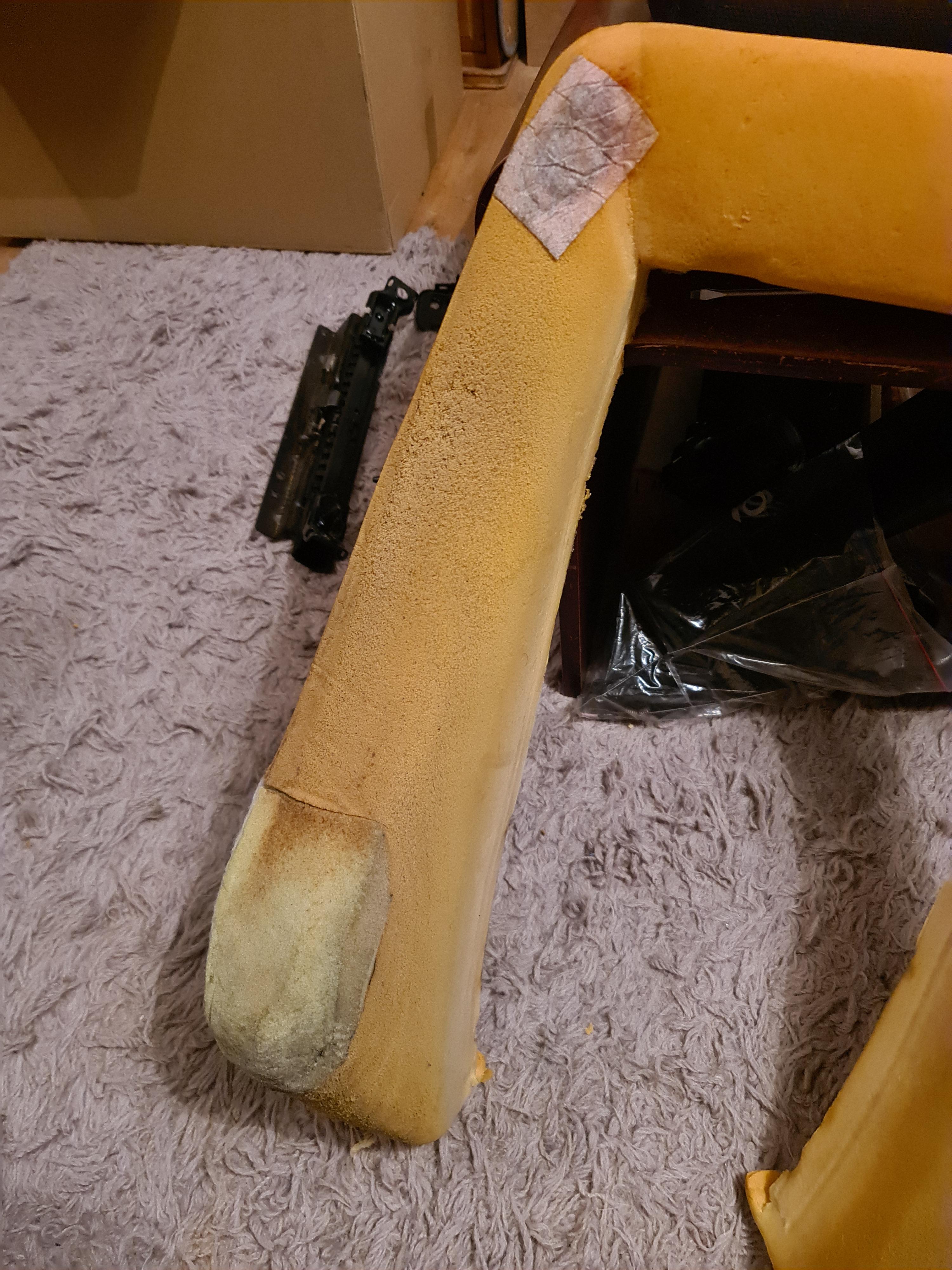

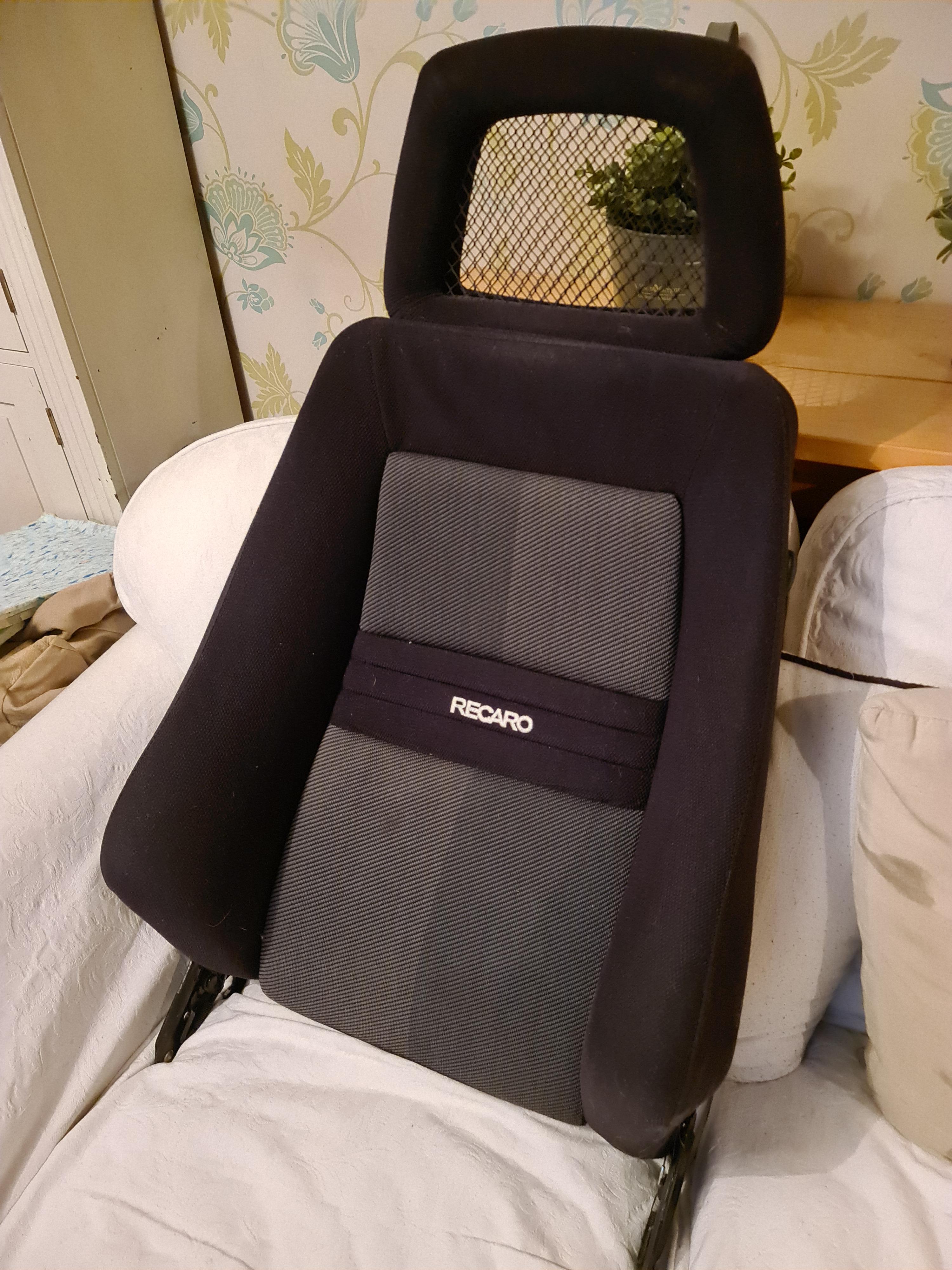

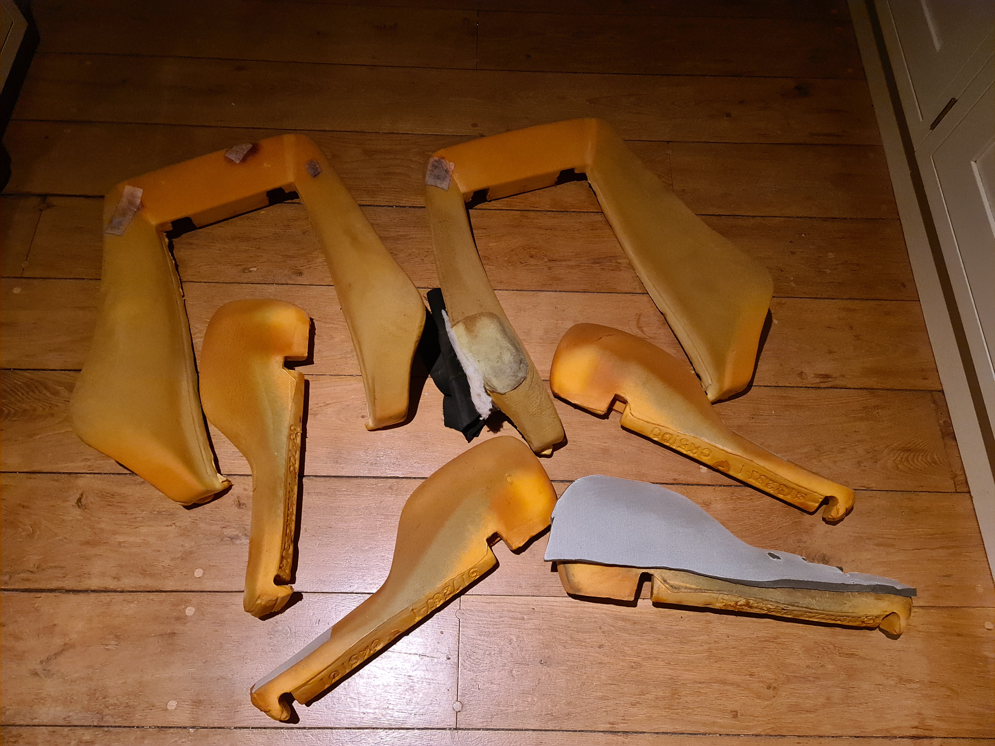

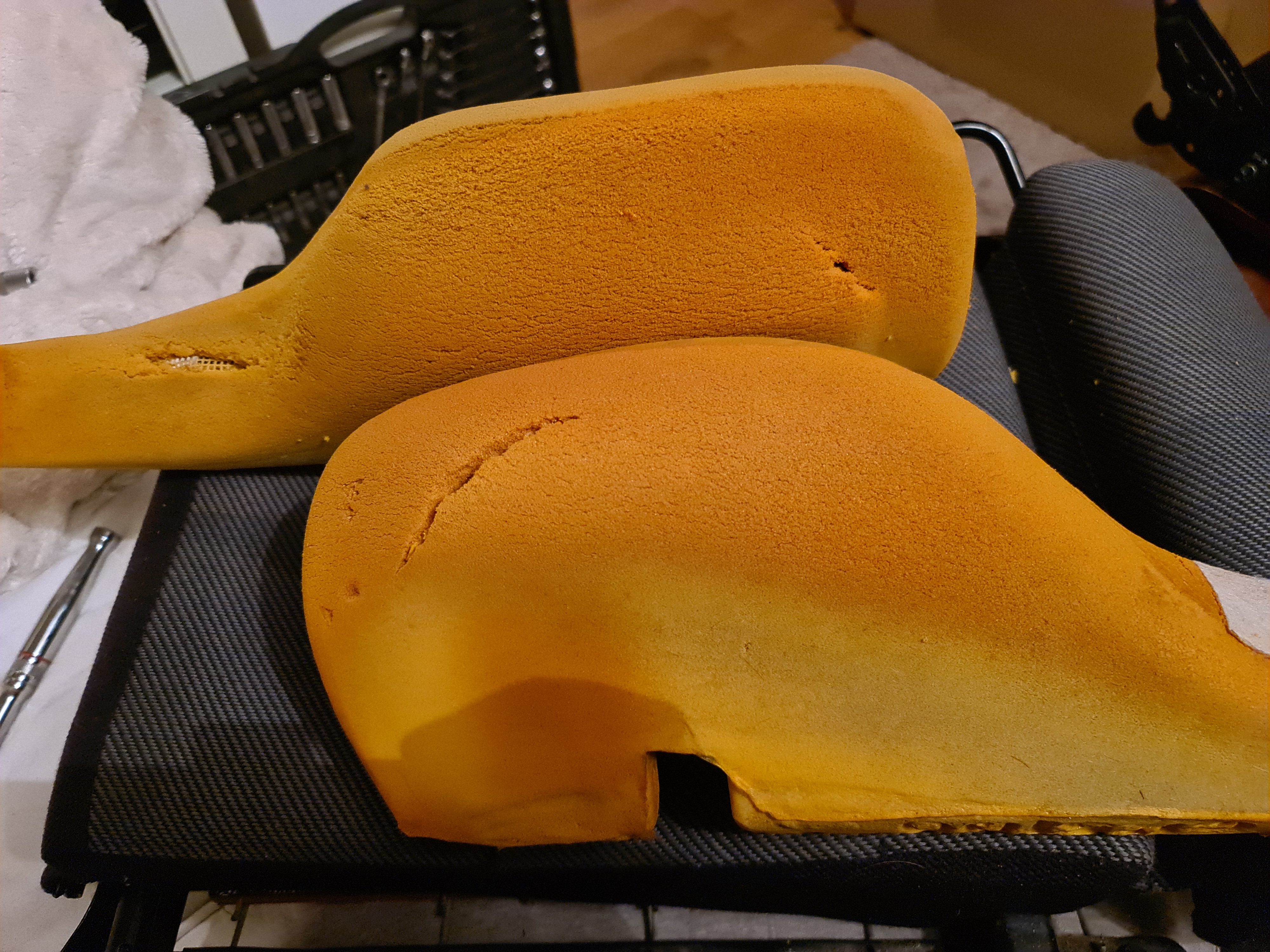

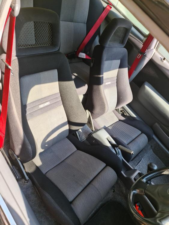

- Both the of the front Recaro seats have had all the bolsters replaced with brand new genuine Recaro foam, and I padded out the support bars on the frames to add a little bit more rigidity. I also had some material replaced where it was wearing thin
Here's what the old bolsters looked like:
And here's what they were replaced with:

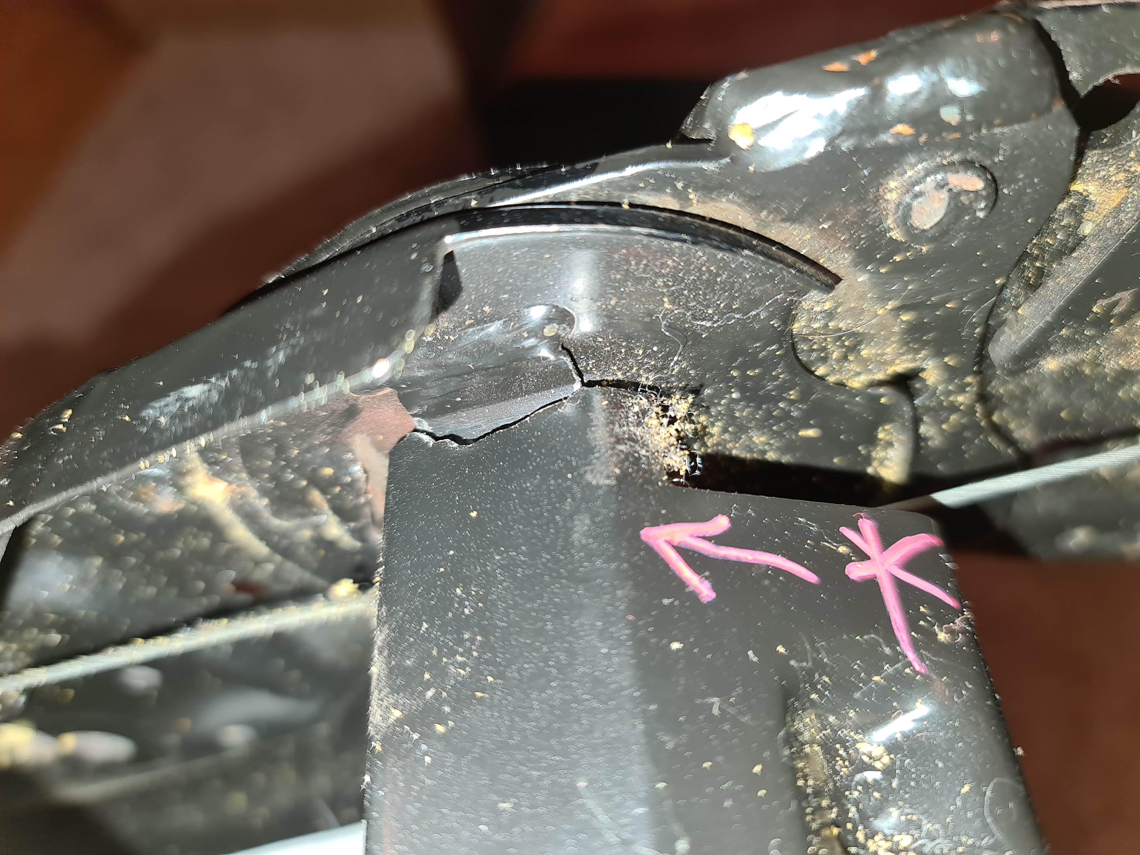

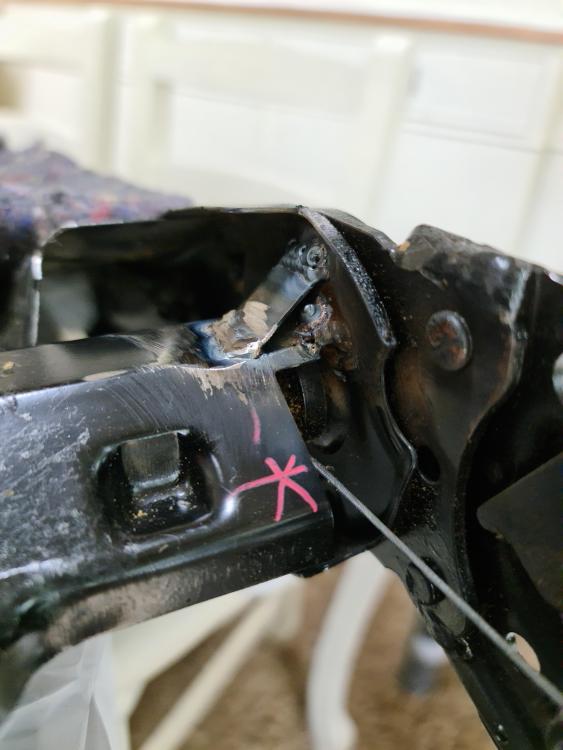

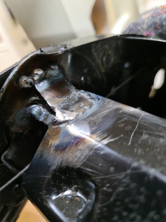

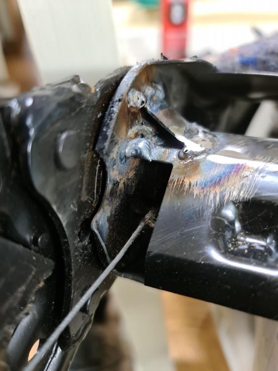

Whilst the seats were apart I noticed one of the upper seat frames had some cracks in it, so I took one to be welded which he struggled with because they were made of 'crap' metal (bit disappointing for a Recaro seat if I'm honest).
Having already left with one repaired, I then noticed the other one was actually worse, and rather than go back and pay him again, I thought I would try TIG weld it myself with a recent mma & tig welder I had acquired from someone I did some work for. I'm not gonna lie, the welds are pretty shit. Excuses being: frames made of thin pot metal, cheap welder, shit tungsten, welding outside, and lack of experience. That said, the welds should hold as the didn't break when I tried, plus I did add some reinforcement.
With these cracks welded up it immediately made the seats noticeably more ridged than before. Obviously I gave them a spray of self etch primer and some black paint before reassembling
