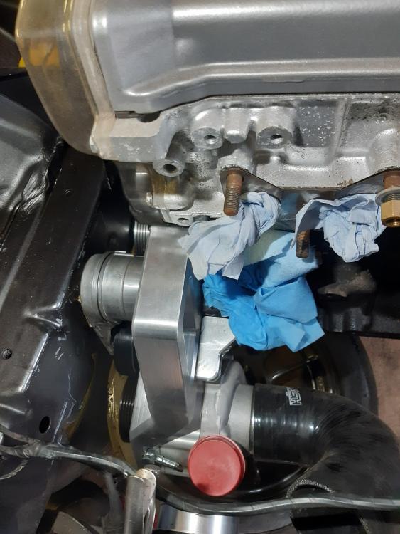

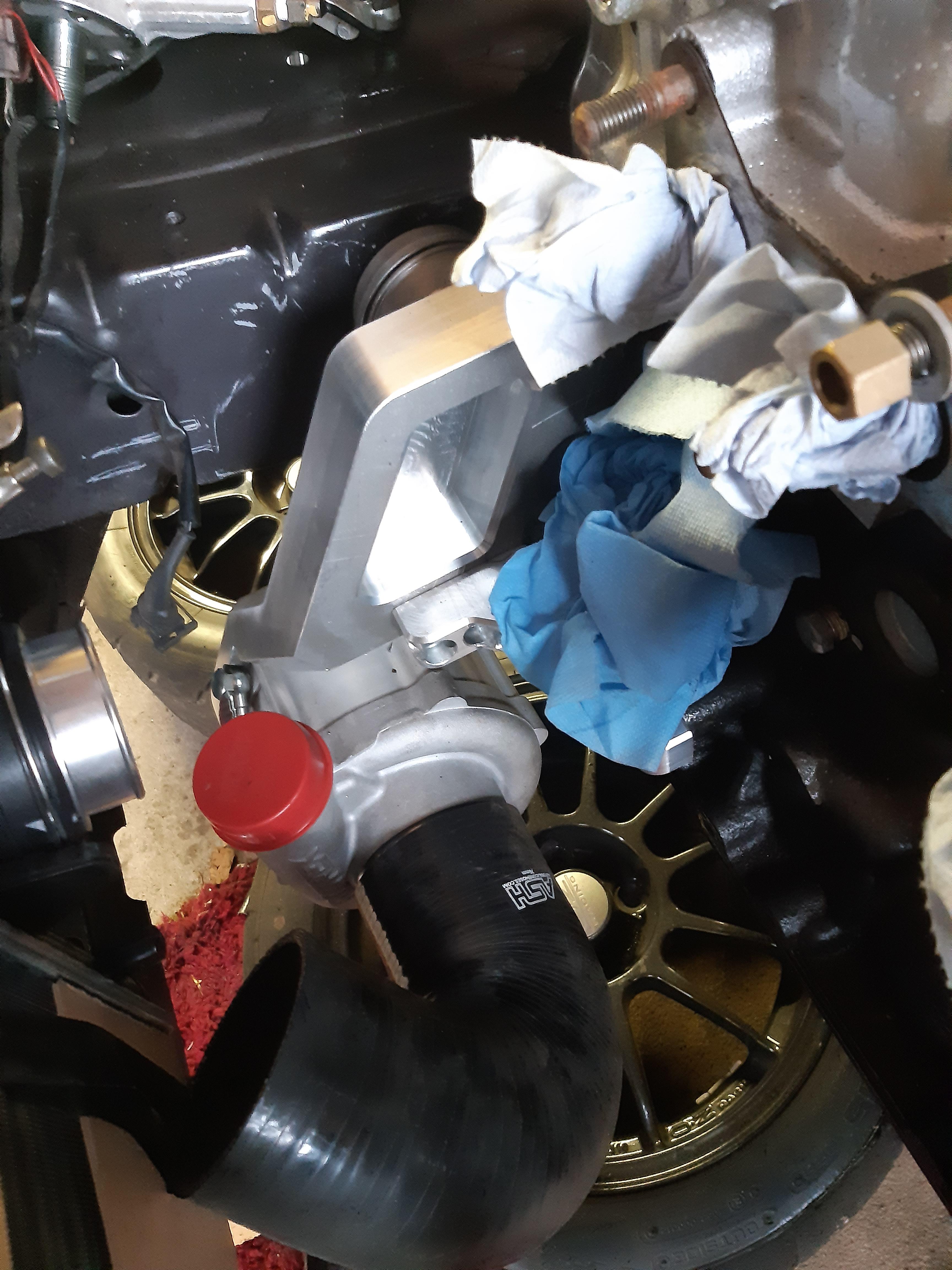

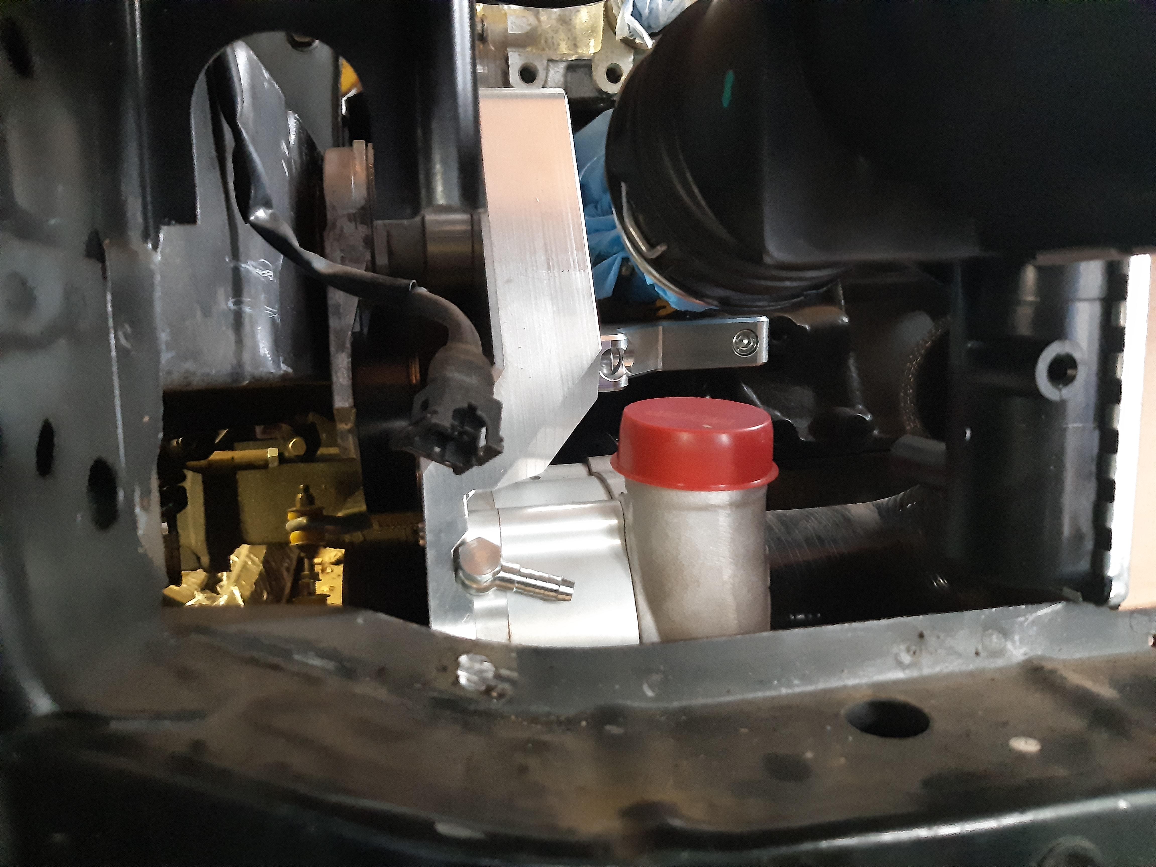

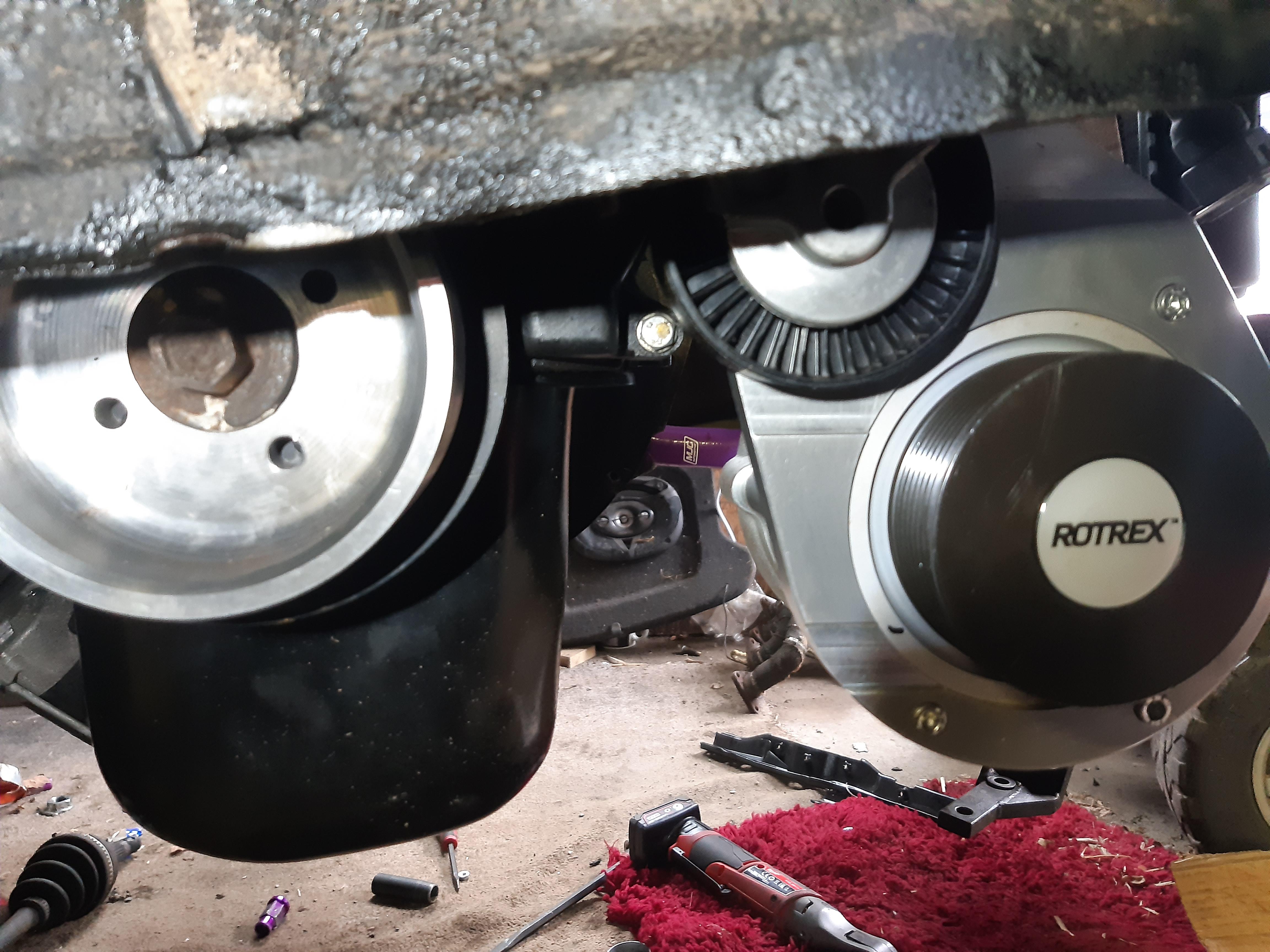

Some pics of how the supercharger mounting fits along with the tensioner
Pretty tight but it all fits , took abit of sussing out but hopefully it all works. Decided to use a landrover belt tensioner along with a slotted hole where it mounts. Which will hopefully allow me to keep the tension correct once the belts stretch / wear

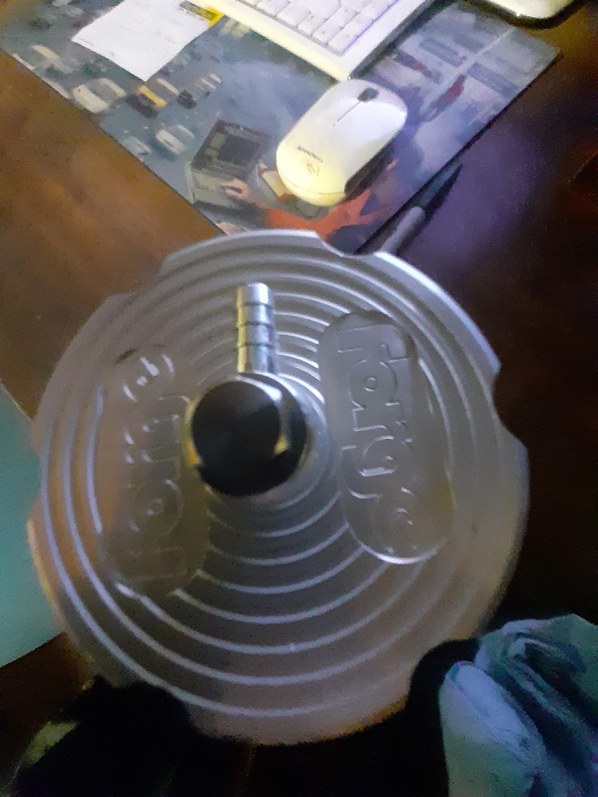

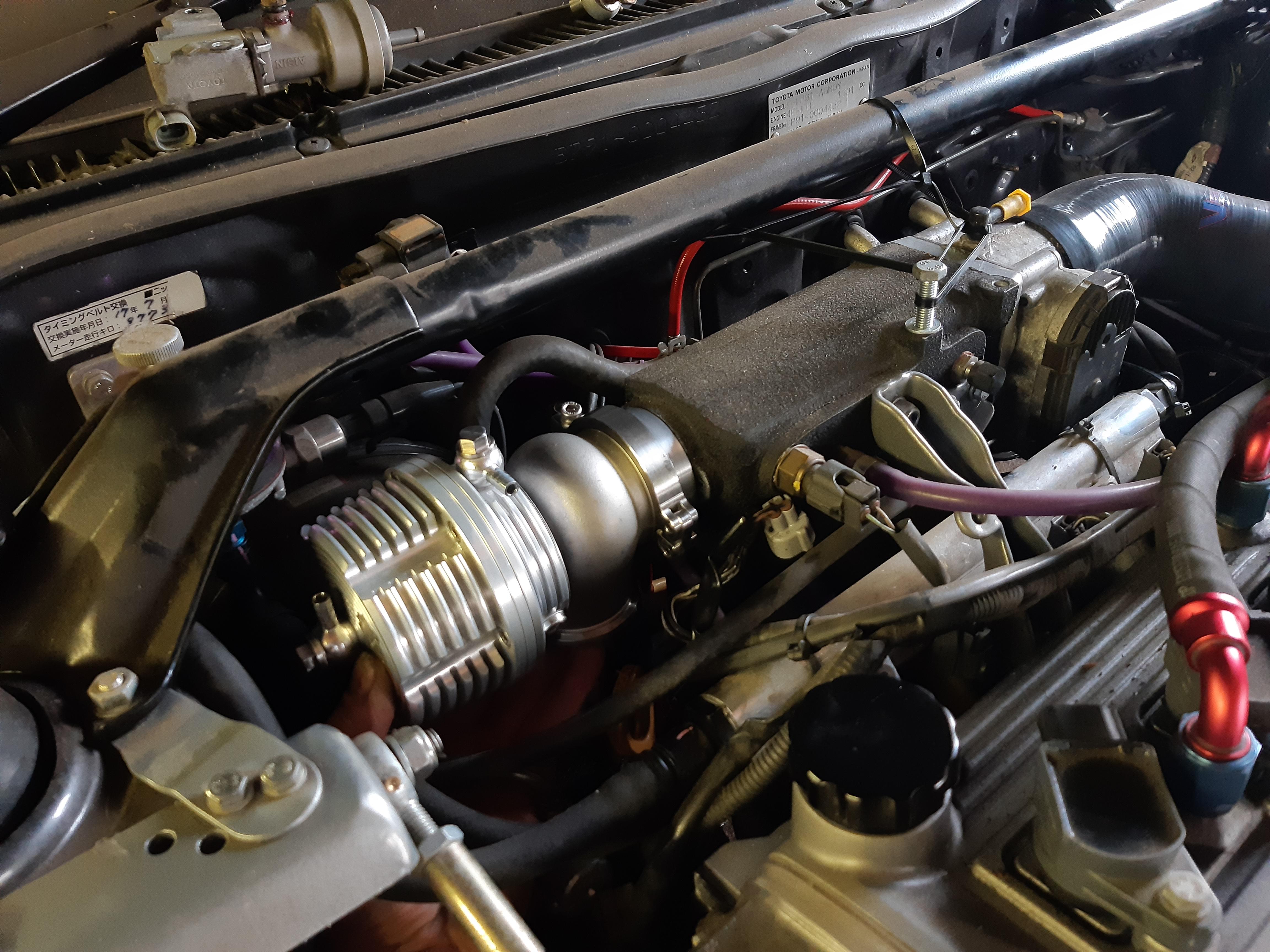

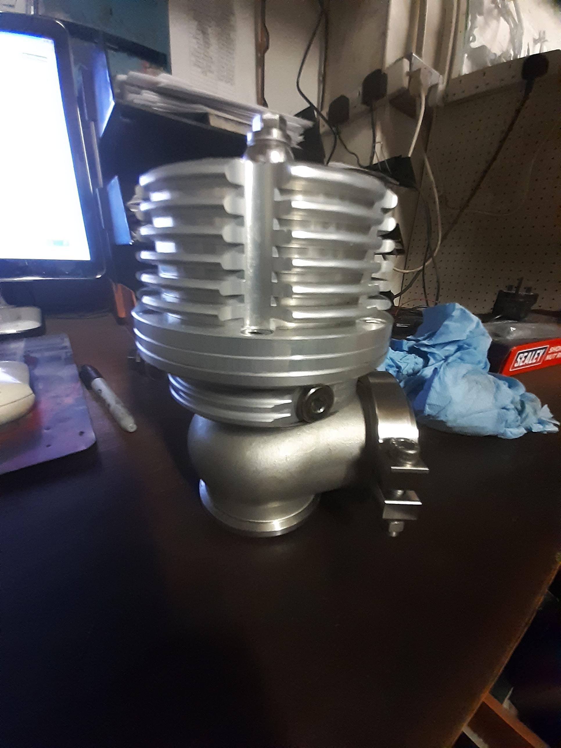

Purchased a new forge 44mm external wastegate for a bargain price , that should hopefully do for bleeding off boost. So boost pressures can be controlled via ecu😁
Kind of found a space on inlet I can mount it as wasnt keen mounting it on boost pipes. As it weighs a ton , but this lead to having to now make a remote reservoir for brakes. To give clearance for wastegate🤦‍♂️

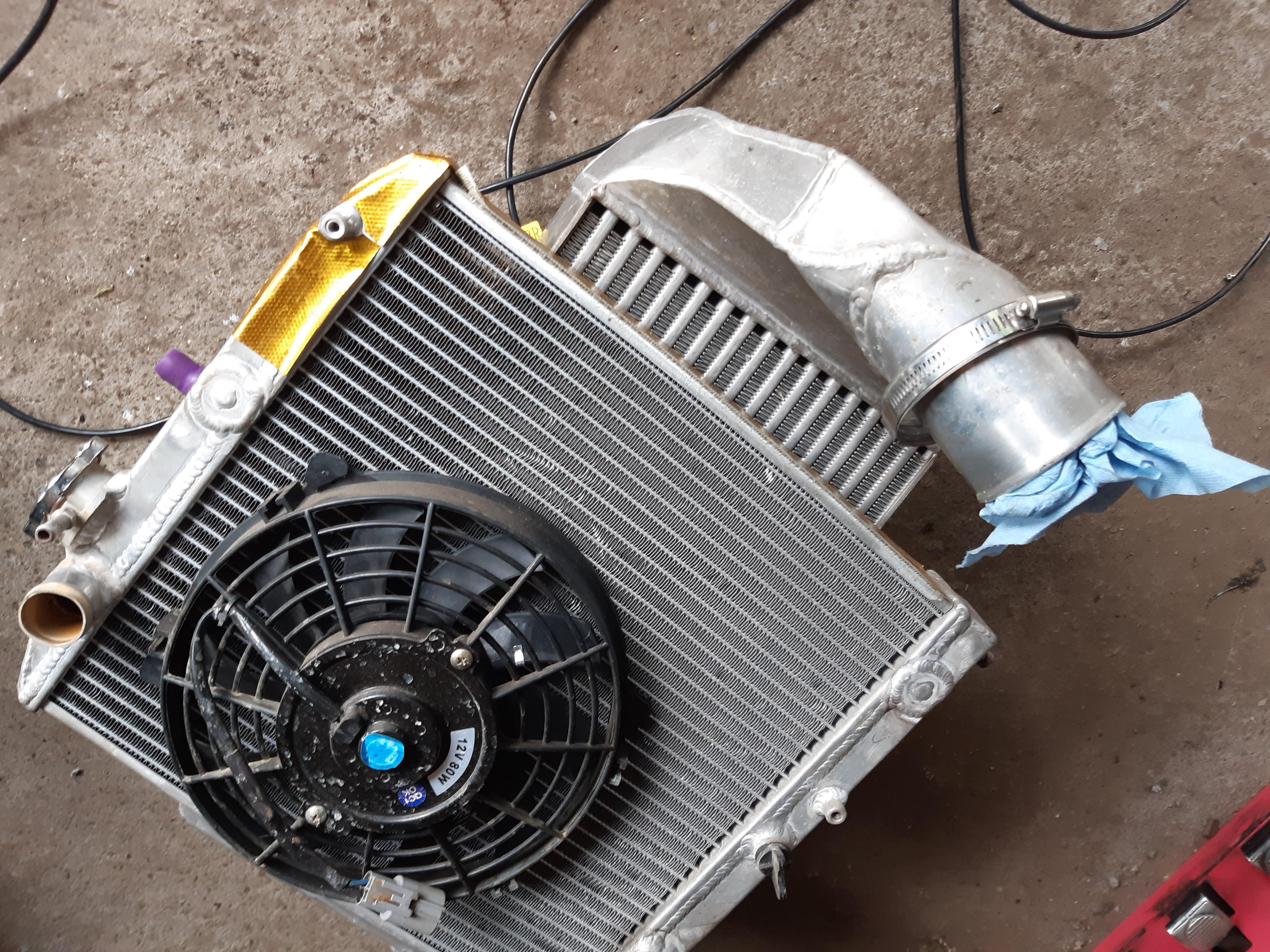

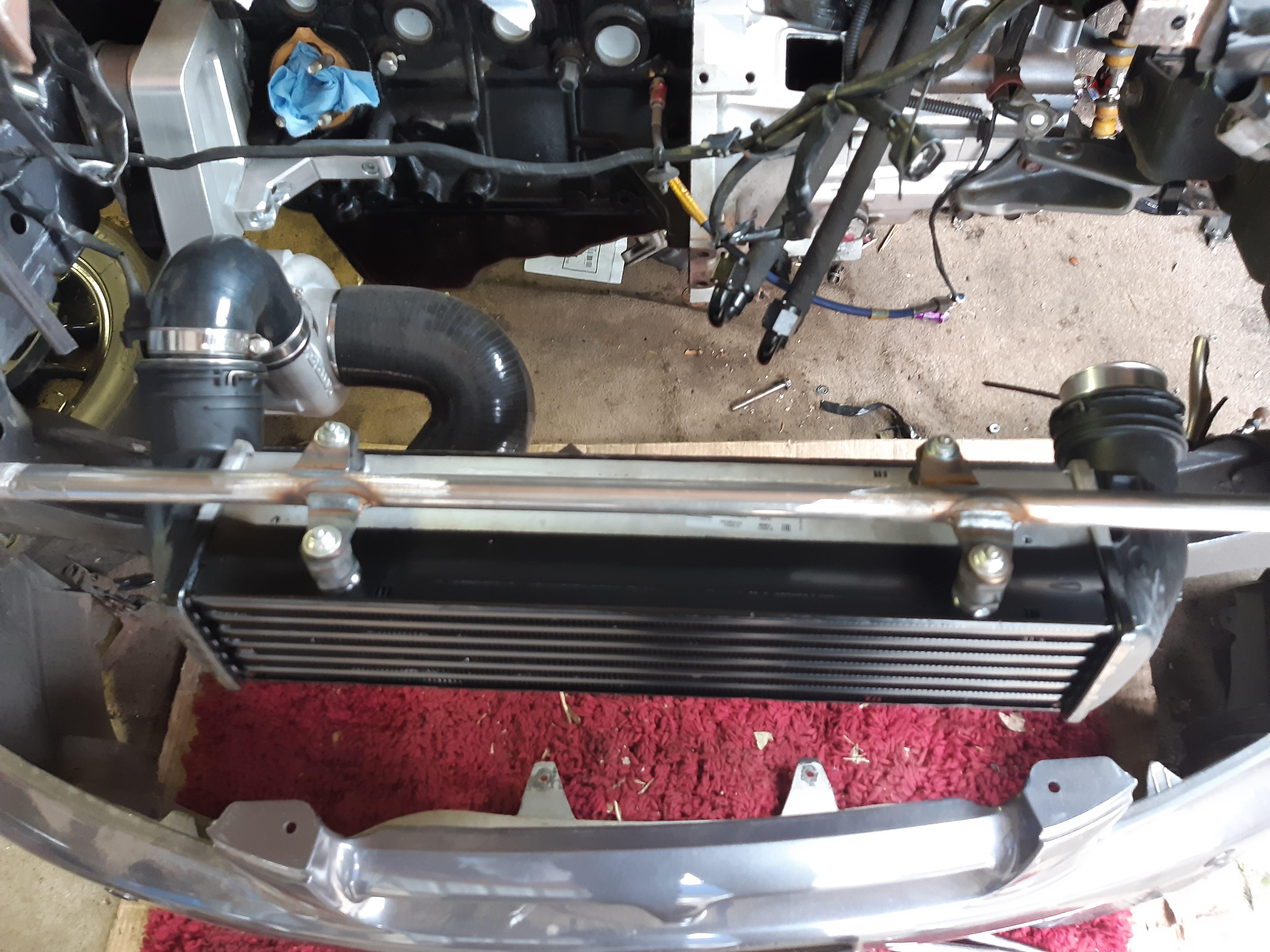

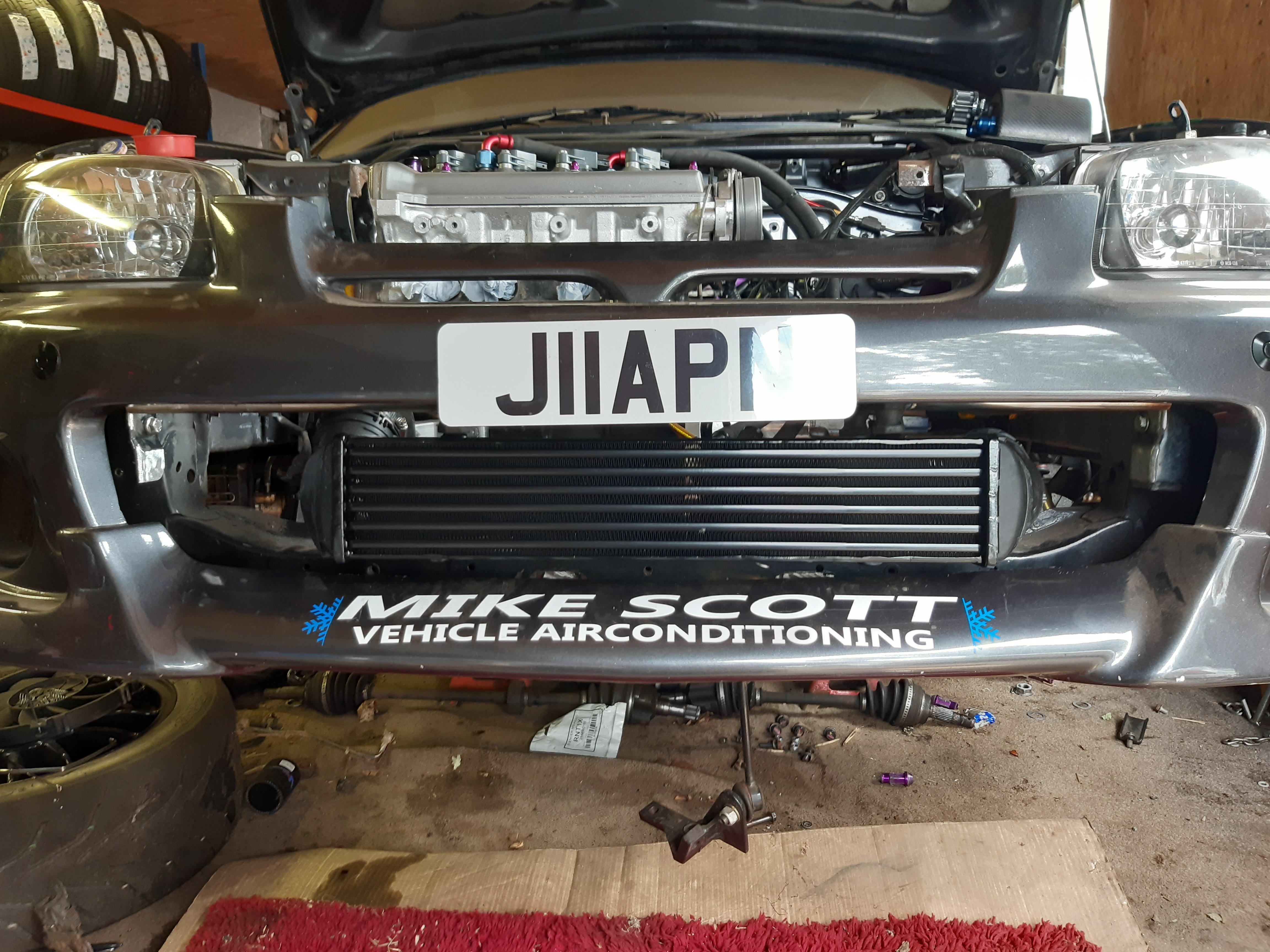

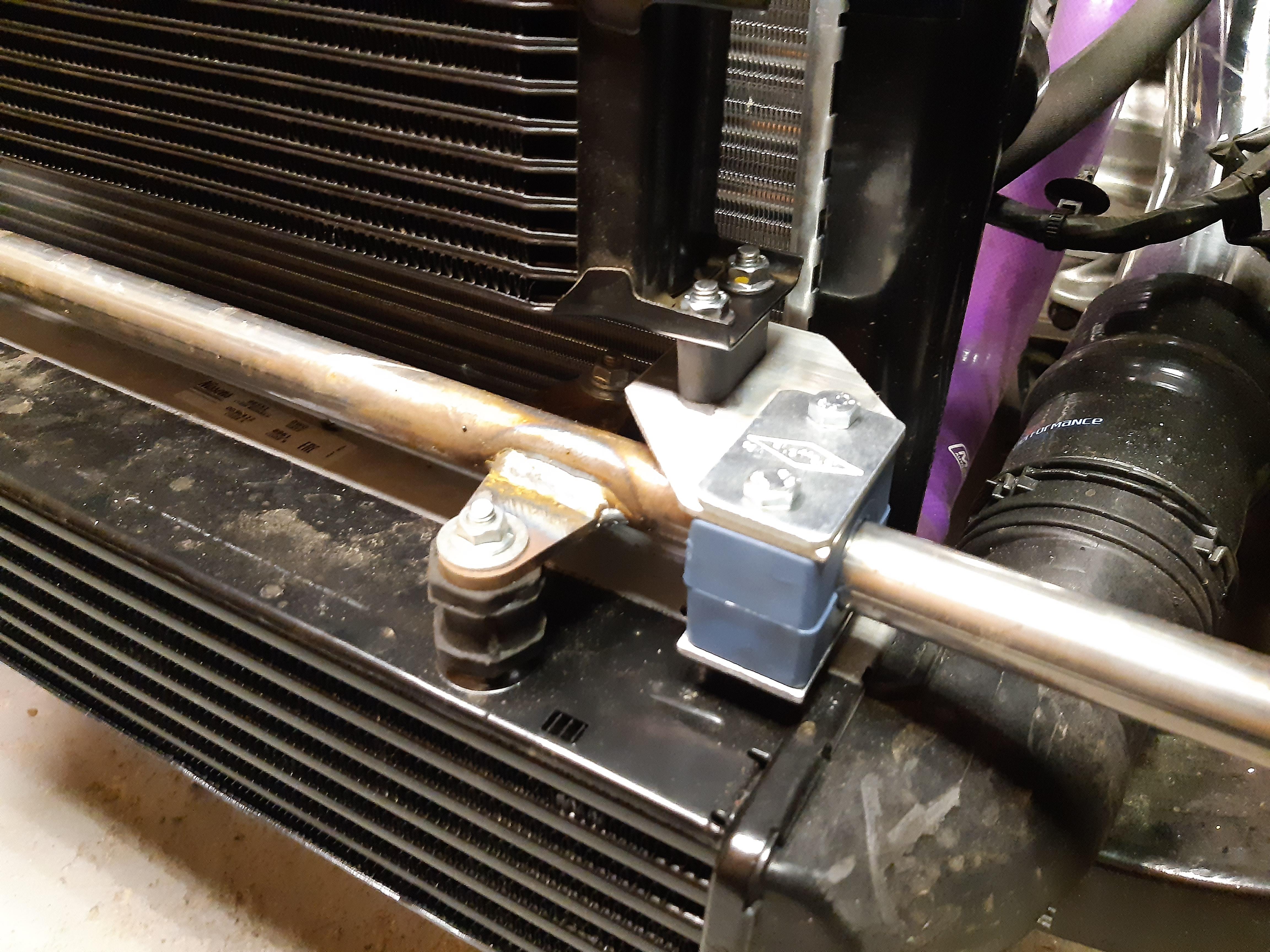

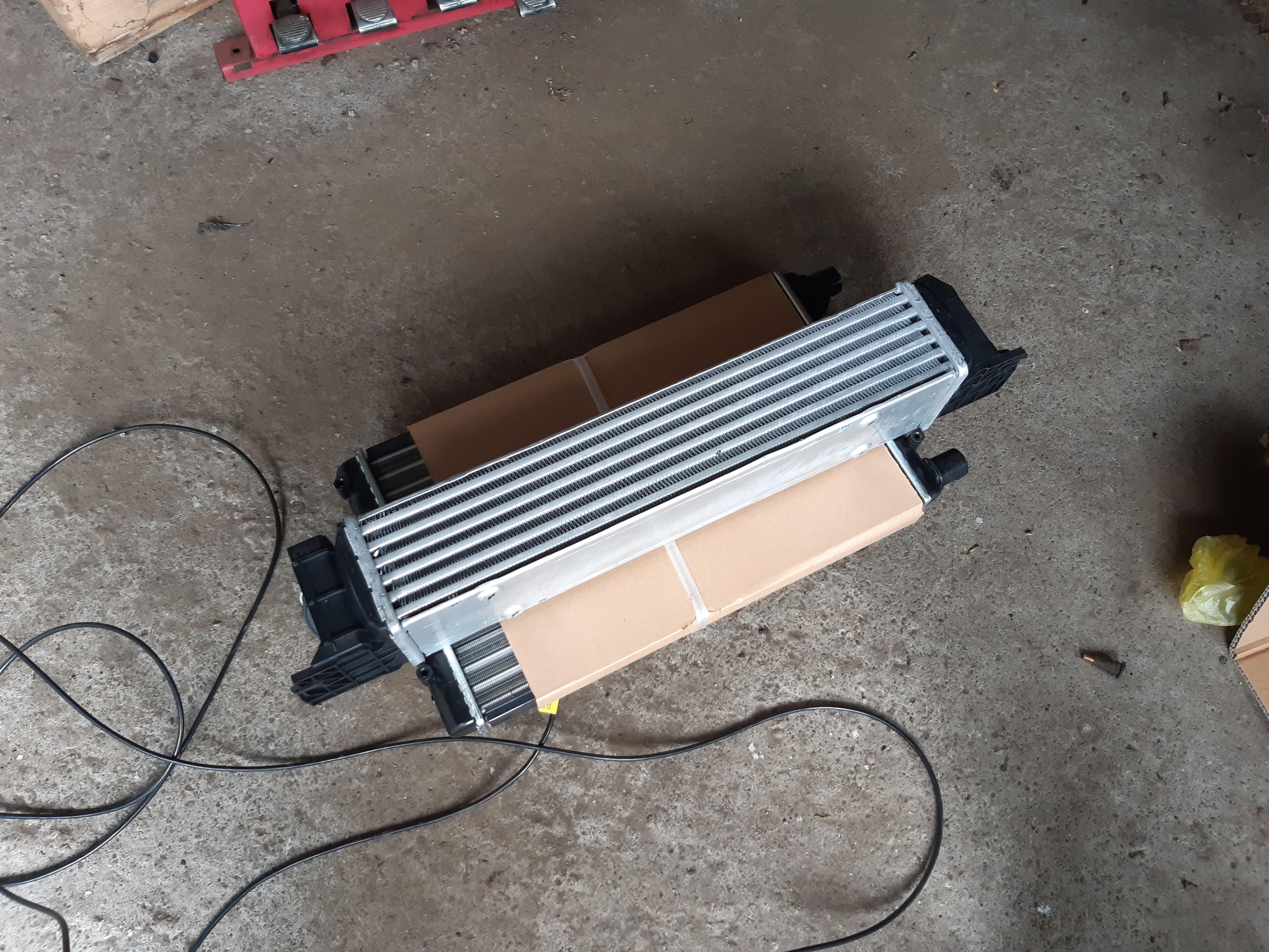

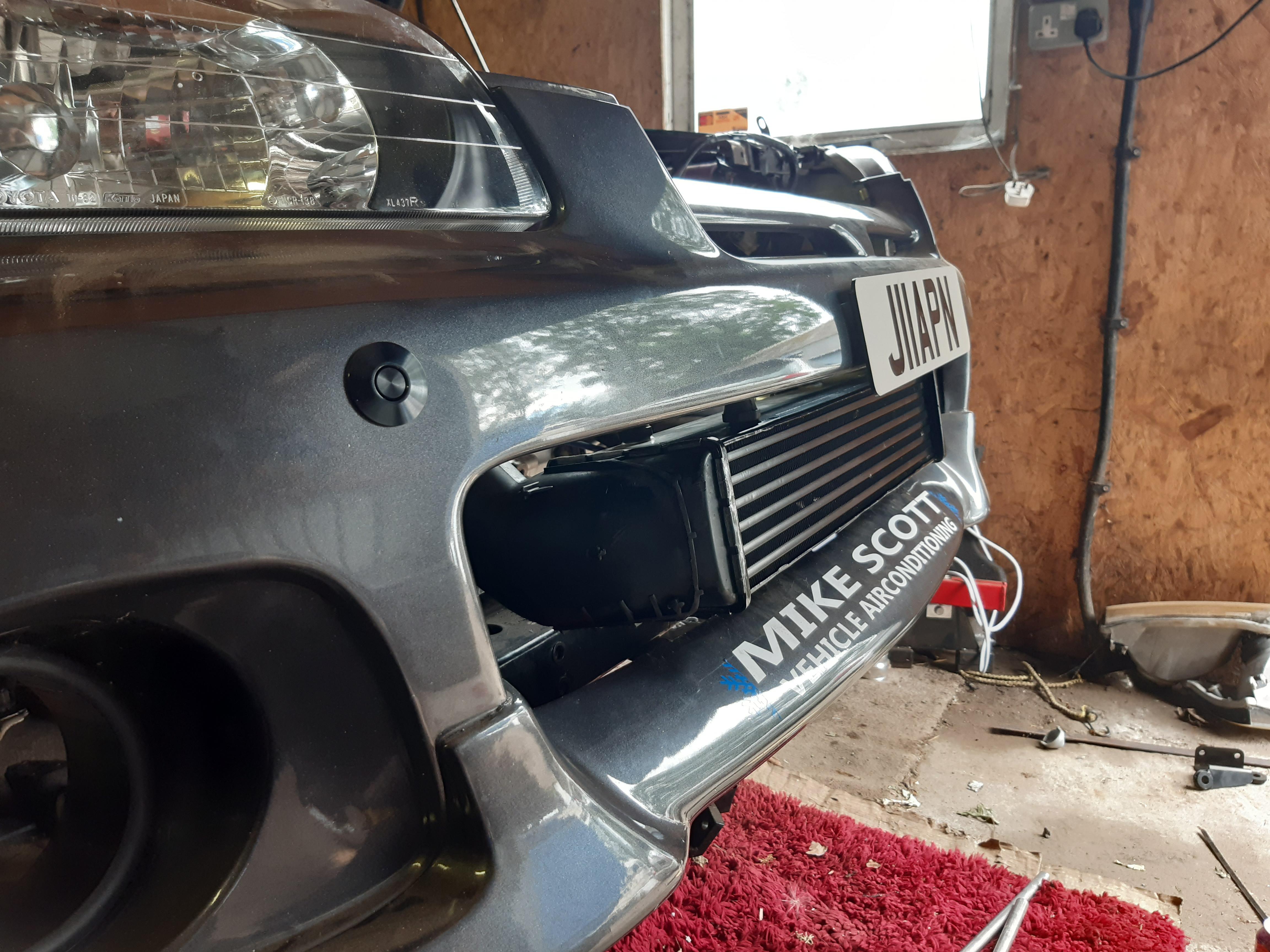

BMW intercooler mounted
After lots of thinking , managed to get it fitted with as short a route on hotside as possible.
This was mounted on thin wall tube and hung off rubber bobings.
Then a lick of black to stealth it up
I know its the first time I've commented on your thread but I don't want you to go to all this effort and time/money.......Are you sure you want the wastegate that side of the throttle body? I see something going wrong there.
I'm not sure to be honest
I see what your saying but I'm hoping it works the same as I'm basically only using it to introduce a controlled boost leak . So to be able to control what boost I'm wanting to run.
There will be a dump valve other side of throttle body to bypass at idle
Kind of makes sense to me I think lol
I'm thinking more idle and deceleration the vacuum created in the manifold can be upto -1bar I've seen mine at 0.8bar that could possibly suck the valve open causing a juddering effect when decelerating as the valve opens and closes with the vacuum increasing and decreasing. Its only in theory as I've never seen it done before suppose there is only one way to find out. I hope it works.

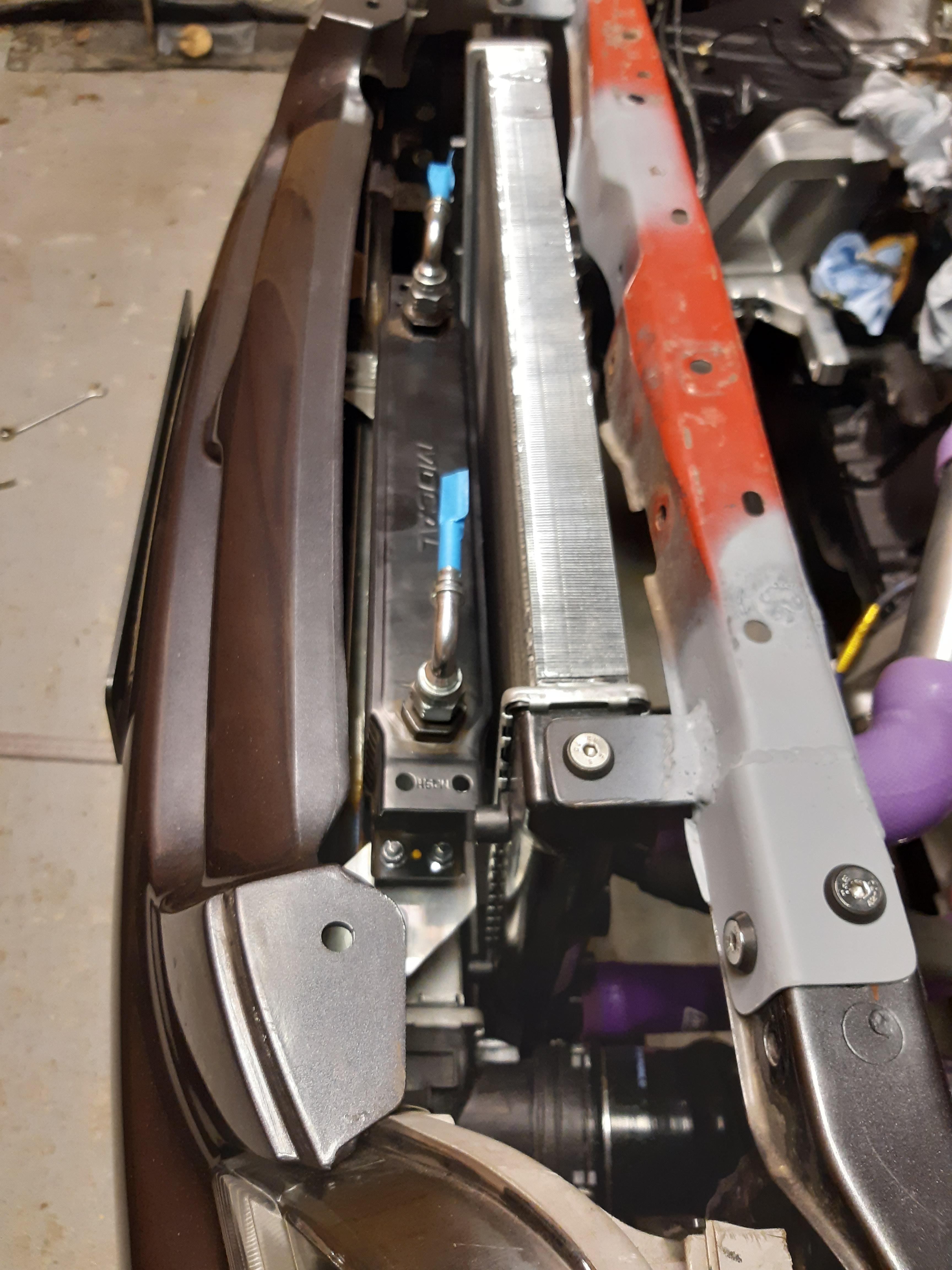

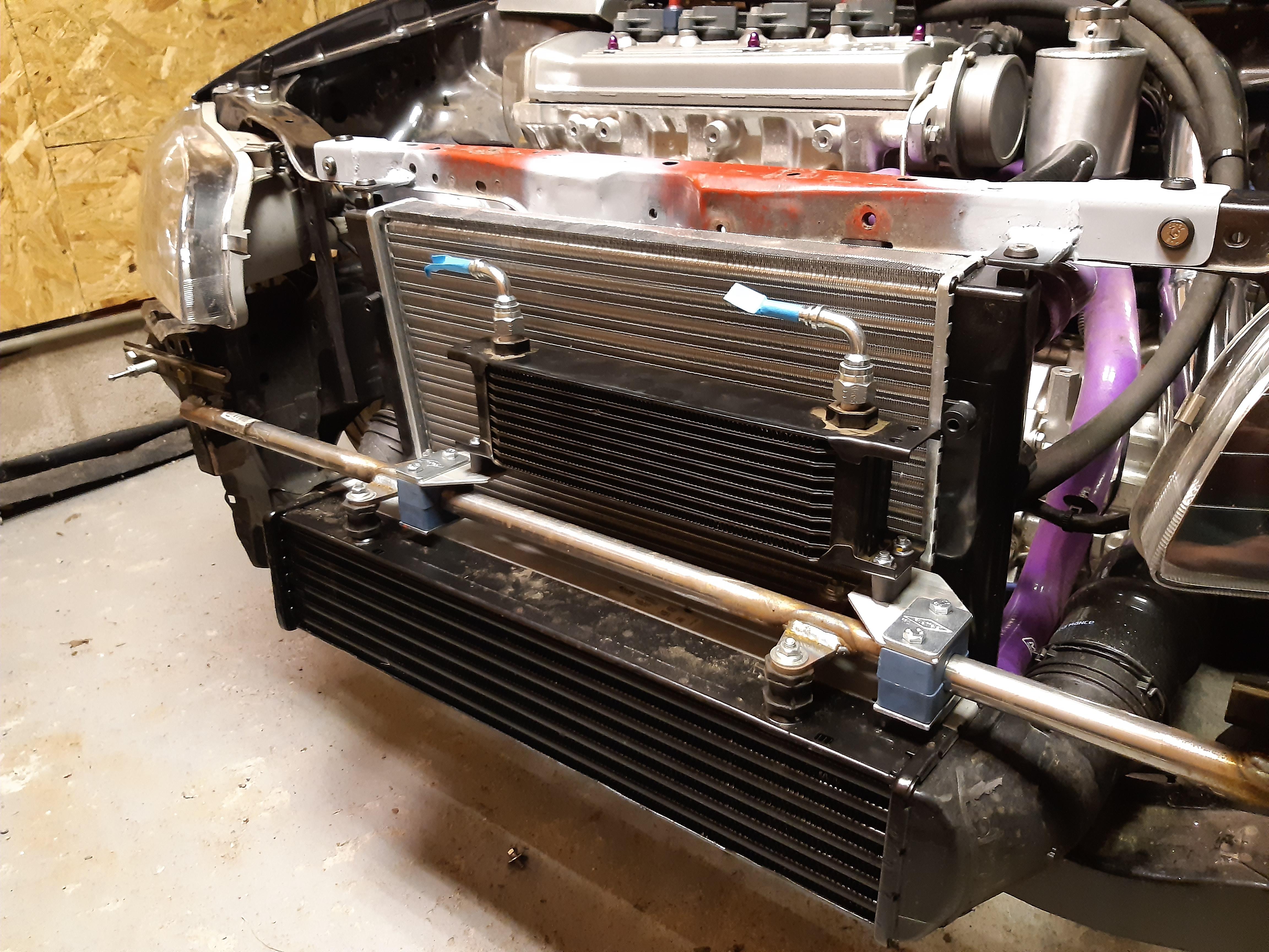

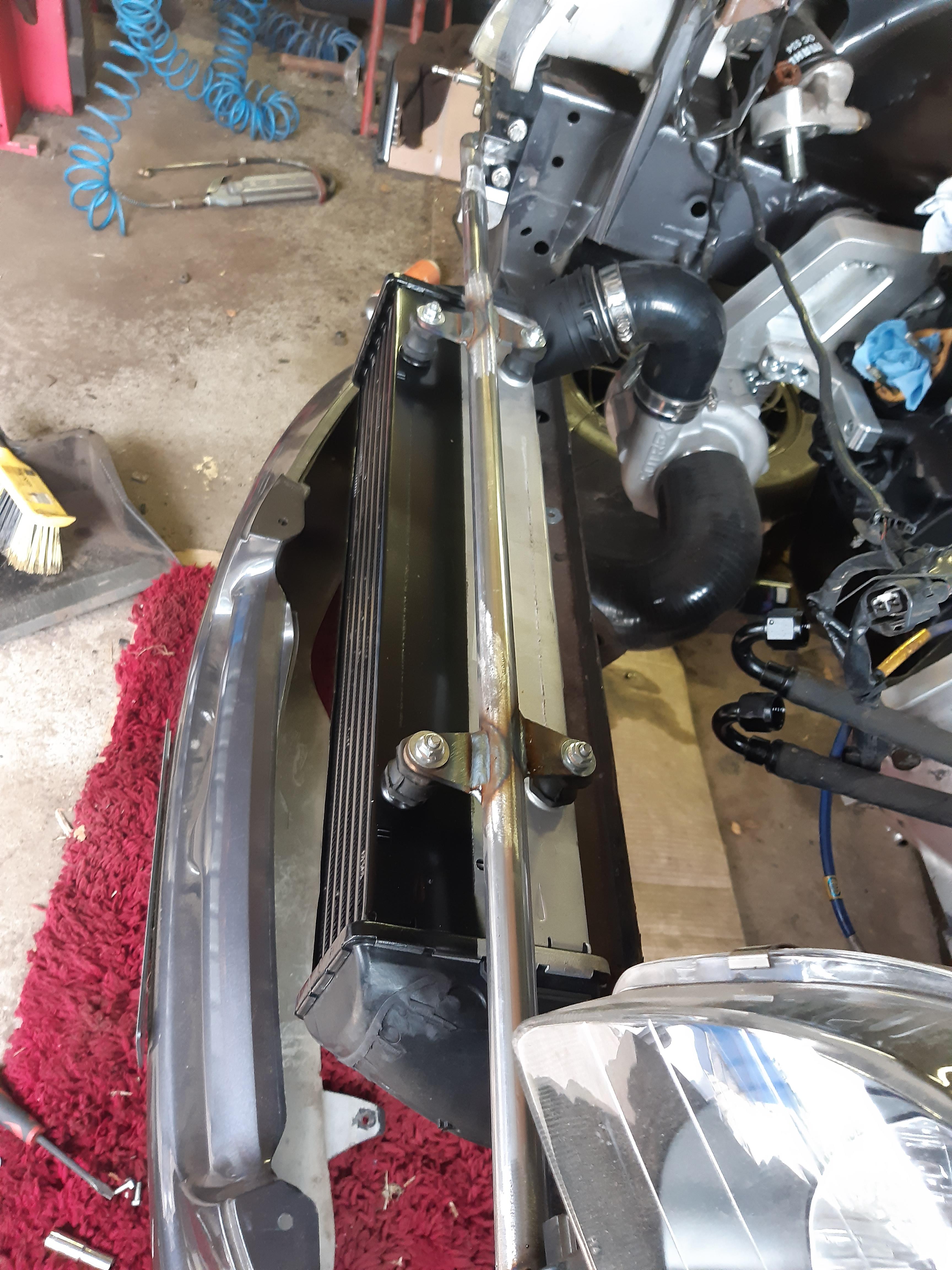

Amazing the time it takes to mount an oil cooler 😆
But finally supercharger oil cooler mounted along with radiator and new removable slam panel
What rad is that? Looks like it's dual core? I'm currently running a triple core civic half rad and looking for more cooling. That's a lovely setup you got going on. Everything seems simple and well done.
You going to run a thermostatic plate for the oil cooler?
Thanks
It's pretty random to be honest , it's a 1.2 seat ibiza radiator setup . I would have a part number somewhere if needed.
The oil cooler is actually for the supercharger oil system and doesn't need a thermostatic plate
18 hours ago, Mike84 said:
Thanks
Oh no worries. I was just curious since it's a nicely sized radiator. We don't really got parts for that car here in the states.
Reason I asked is because you don't want the oil cooler to be working before the oil warms up. Especially on cooler days it might never get up to operating temp but that's just my 2 cents bro.
You mean blowoff valve, a wastegate goes on the exhaust side
It's a wastegate but I'm mounting it on the inlet instead of exhaust .
To bleed off boost instead of exhaust gases if that makes sense
