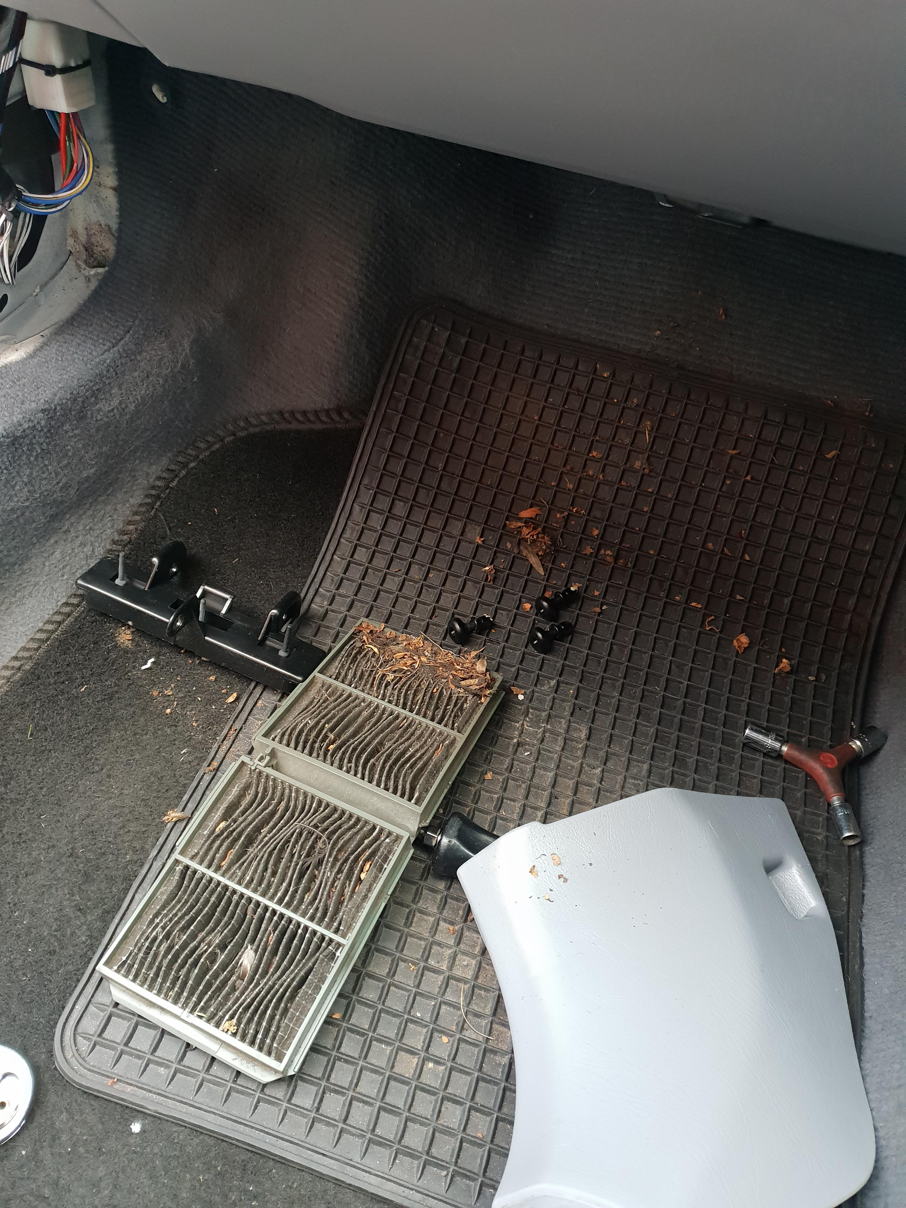

Well messing with my SR and there is a 3 x button clips on the bottom of the heater box so I pulled them out and a flap dropped out with a filter in it. First I've seen one... is it just UK spec or SR or have they all got one?

Well my glanza has one as well and there is 2 filters inside the box not one. Mine looks like a dead cat. 20years of never being changed.

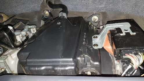

Here is a pic of my genuine 96 v.
(Sorry couldnt rotate pic)
The box has no filter hole. However i notice there's a pipe comnected that looks like it goes through the firewall, your car doesn't have that pipe so toyota must have changed a few things on the facelift system.

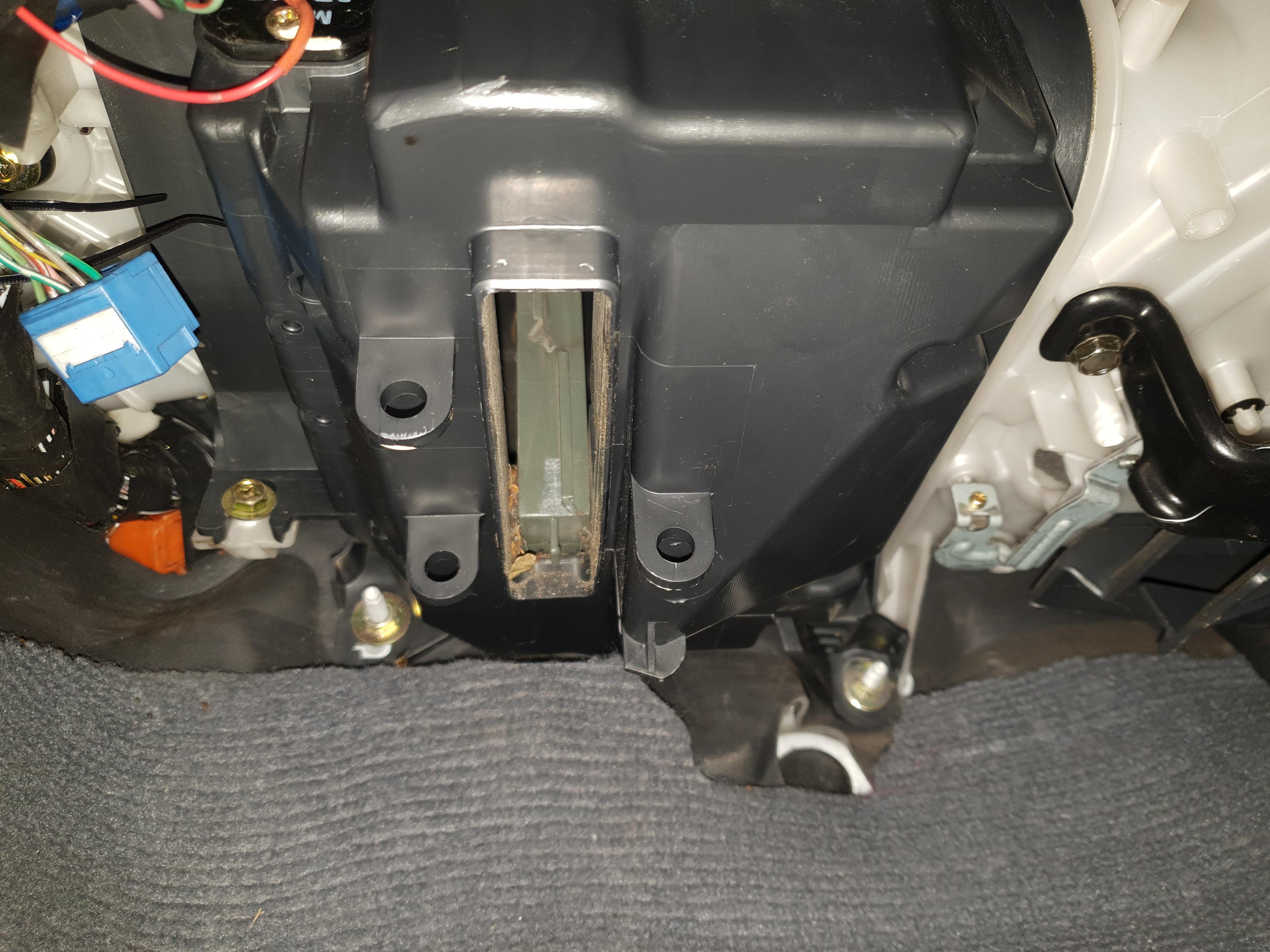

I have a 98 UK spec SR which I've turbo'd which had a pollen filter and a 98 imported Factory Glanza V with a pollen filter.

That pipe is a water drain for the A/C my Glanza has one but no need for the SR to have one as it's never had A/C

Quick update on explaining the mystery.
I got in touch with Jay on TGTT who told me that:
"Toyota started introducing a different evaporator housing from Dec 97 (coincides nicely with the mk2 V) which incorporated cabin pollen filters. As you can imagine in Japan this was a major feature as they are all about the air quality. Worth noting that it's not just as cut and dry as that. Pollen filters only became factory in 97, however before that you could still spec them as a dealer option. That means there's 1996 V's running round with them too albeit retrofitted."
Therefore, this would also generally agree with why toyodiy parts catalogue has only 97+ V's listed for the pollen filters.
Jay also mentioned that the EP82's never got them as they were obviously previous to this.
