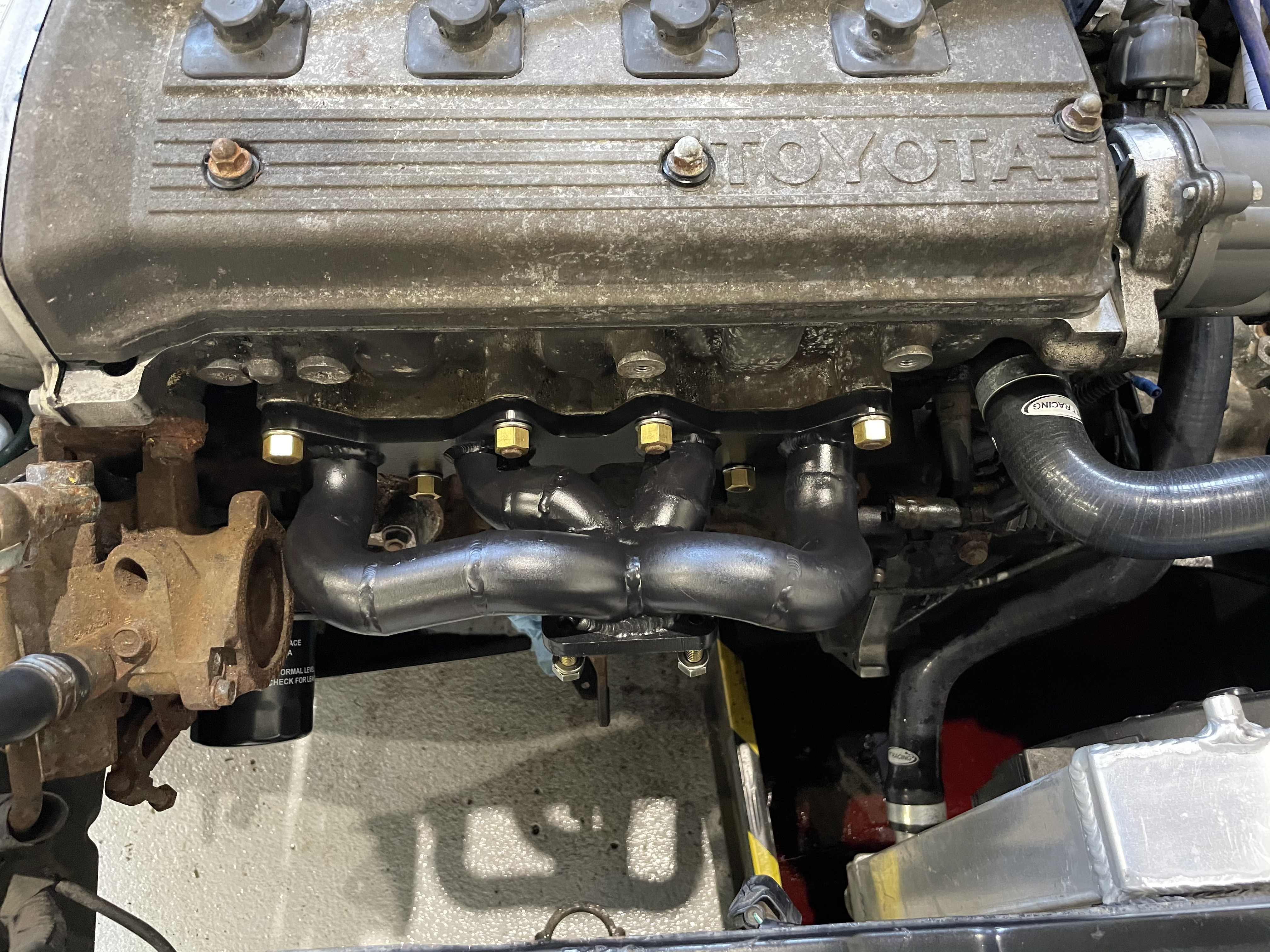

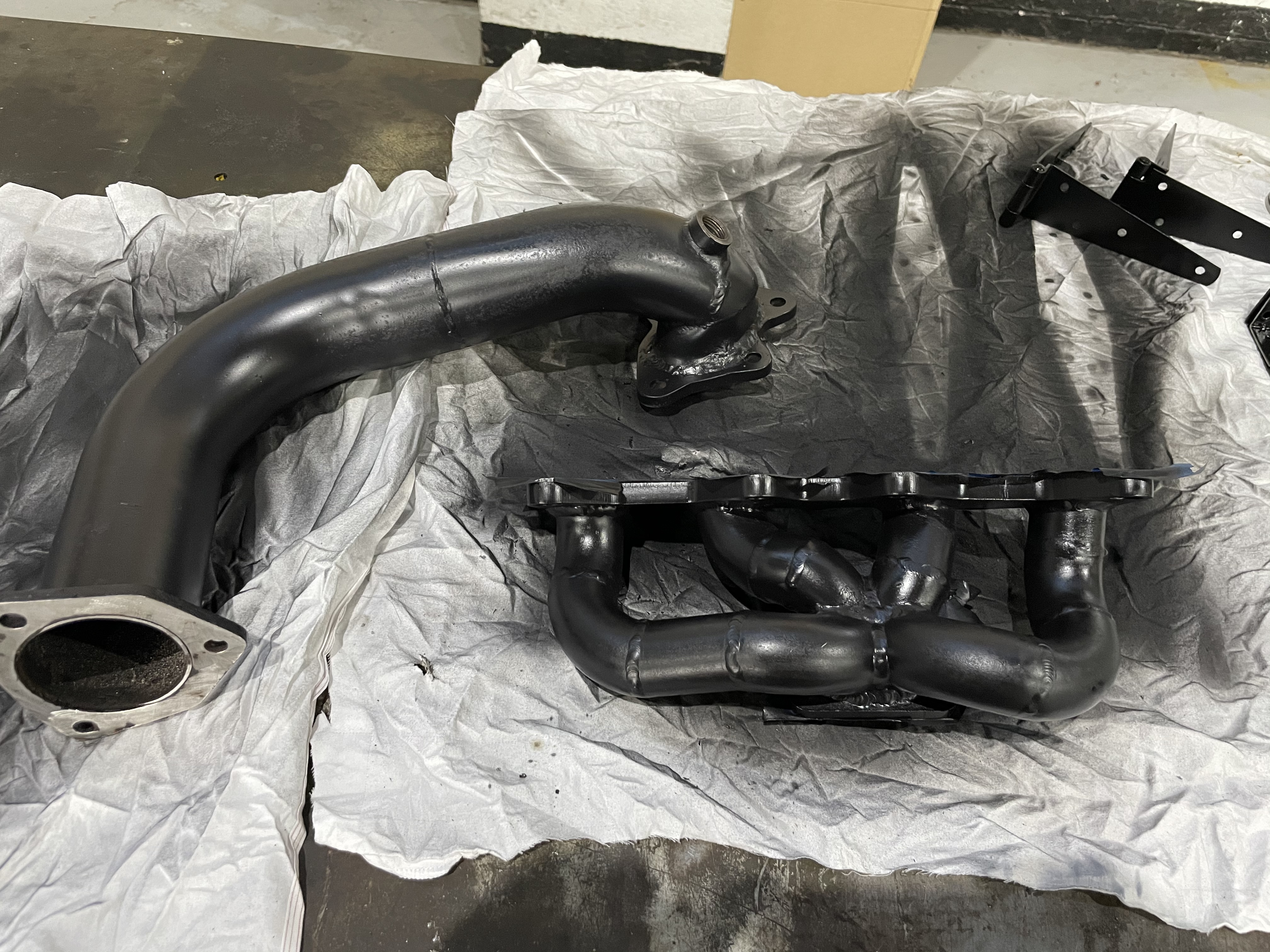

Pikey009 Posted February 25, 2021 Author Posted February 25, 2021 Manifold and downpipe cleaned up and painted, now ready to be bolted on Quote
Claymore Posted February 26, 2021 Posted February 26, 2021 14 hours ago, Pikey009 said: Manifold and downpipe cleaned up and painted, now ready to be bolted on Looks good. Quote

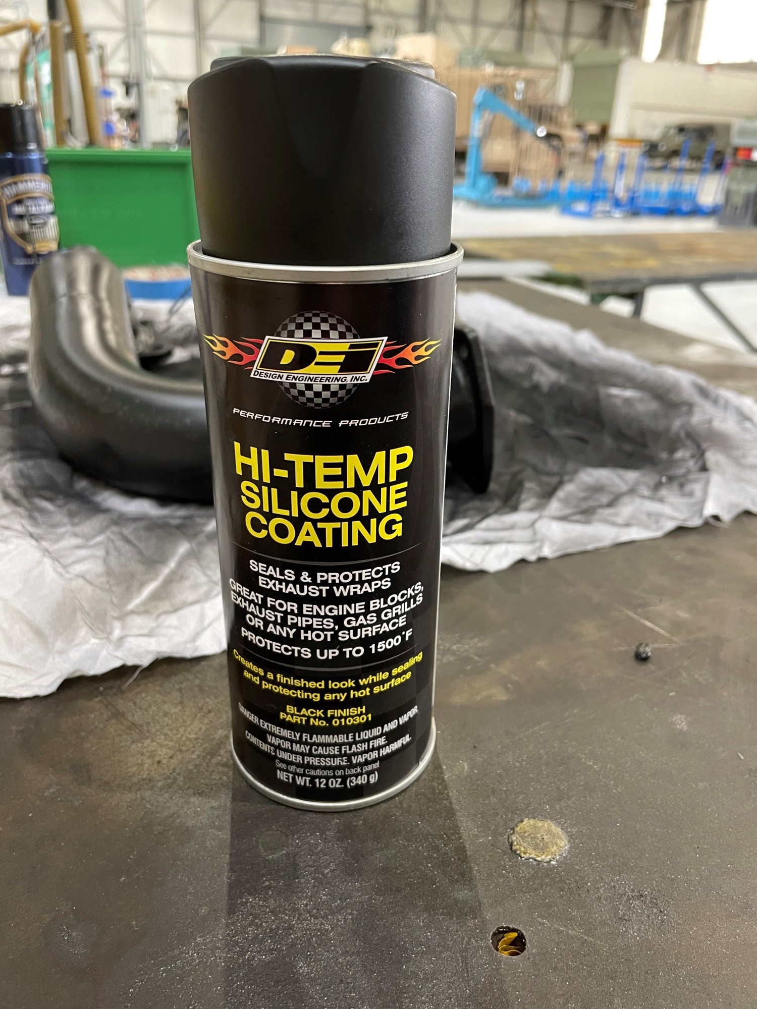

Djaniero Posted March 1, 2021 Posted March 1, 2021 Coming along nicely man😎 What paint did you use on the mani and decat? I've been wanting to paint mine for a while, but worried that it would just burn off? Thanks Quote
Pikey009 Posted March 2, 2021 Author Posted March 2, 2021 Thanks mate. It's DEi Hi-temp silicone coating. No worries with that, I had it on my GT-FOUR for years and it never flaked. Quote

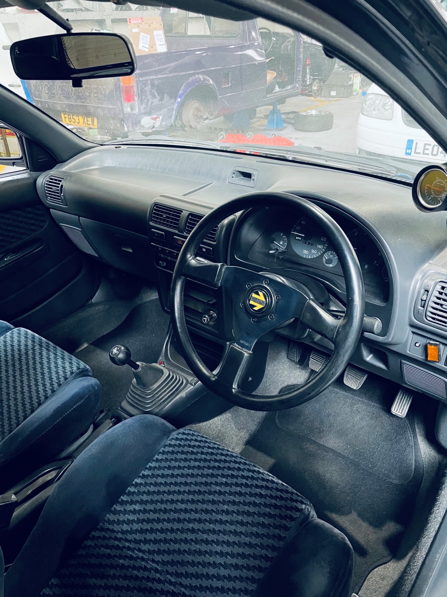

Pikey009 Posted March 2, 2021 Author Posted March 2, 2021 Got the wheel on with a MOMO boss kit, no problems with fitting and the horn works. I think the wheel looks very period and the MOMO horn button does go nicely so thanks for the help with deciding. Quote

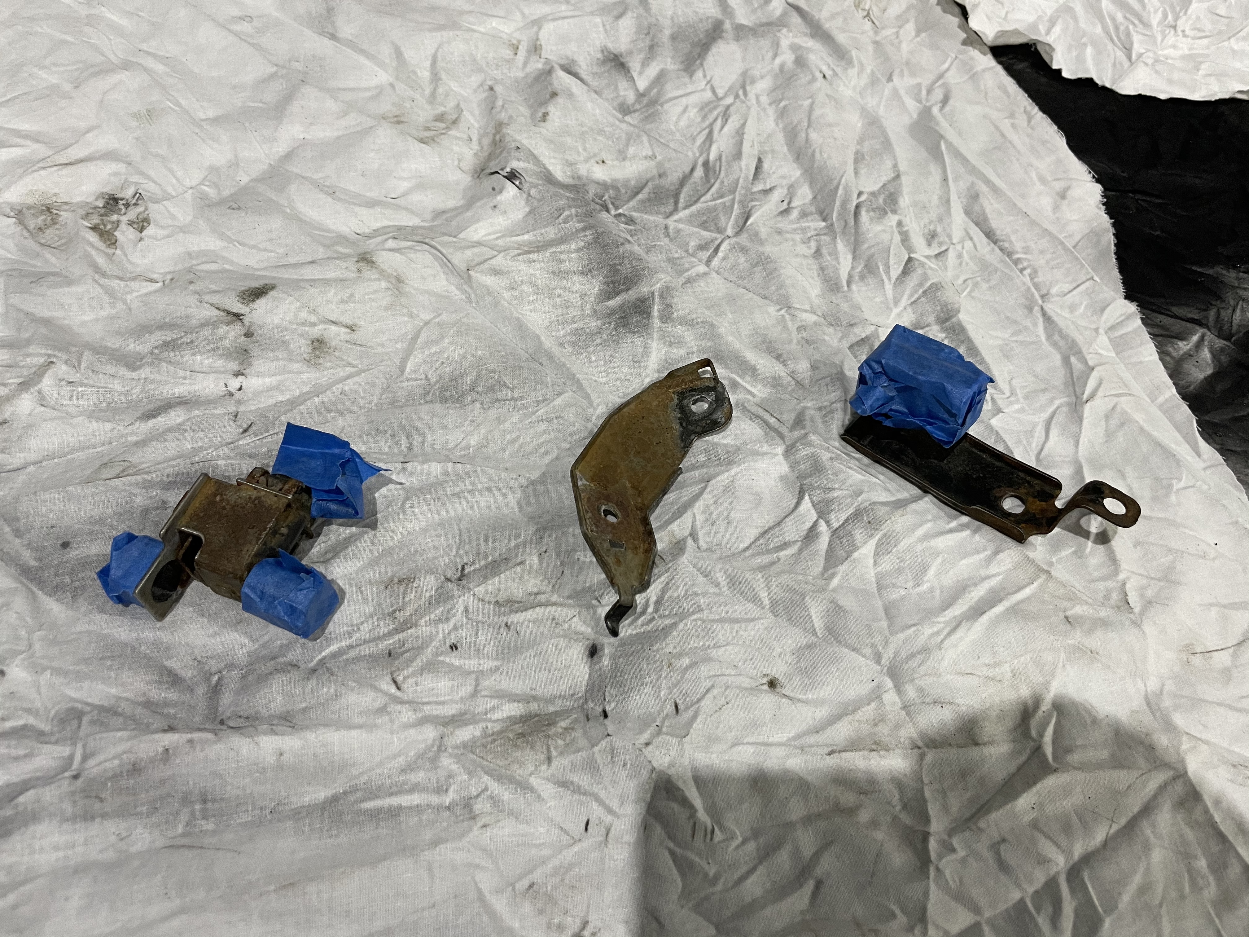

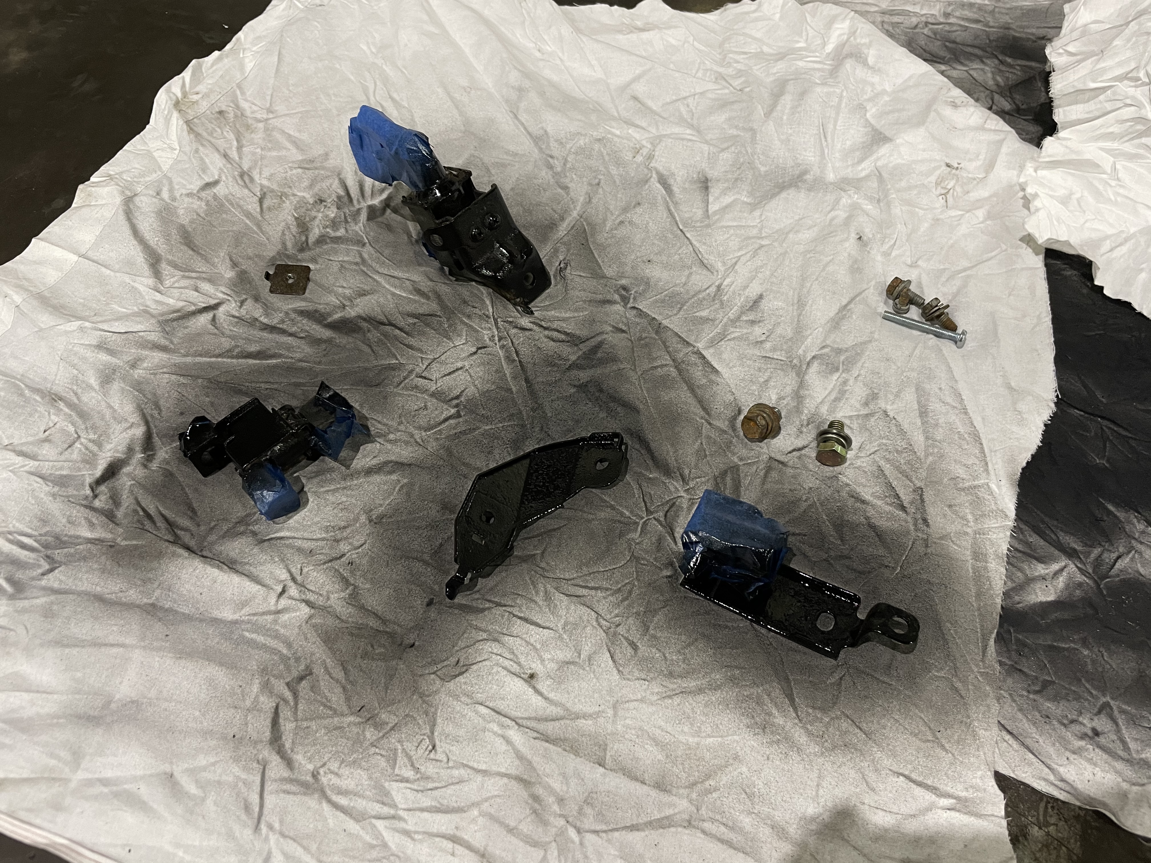

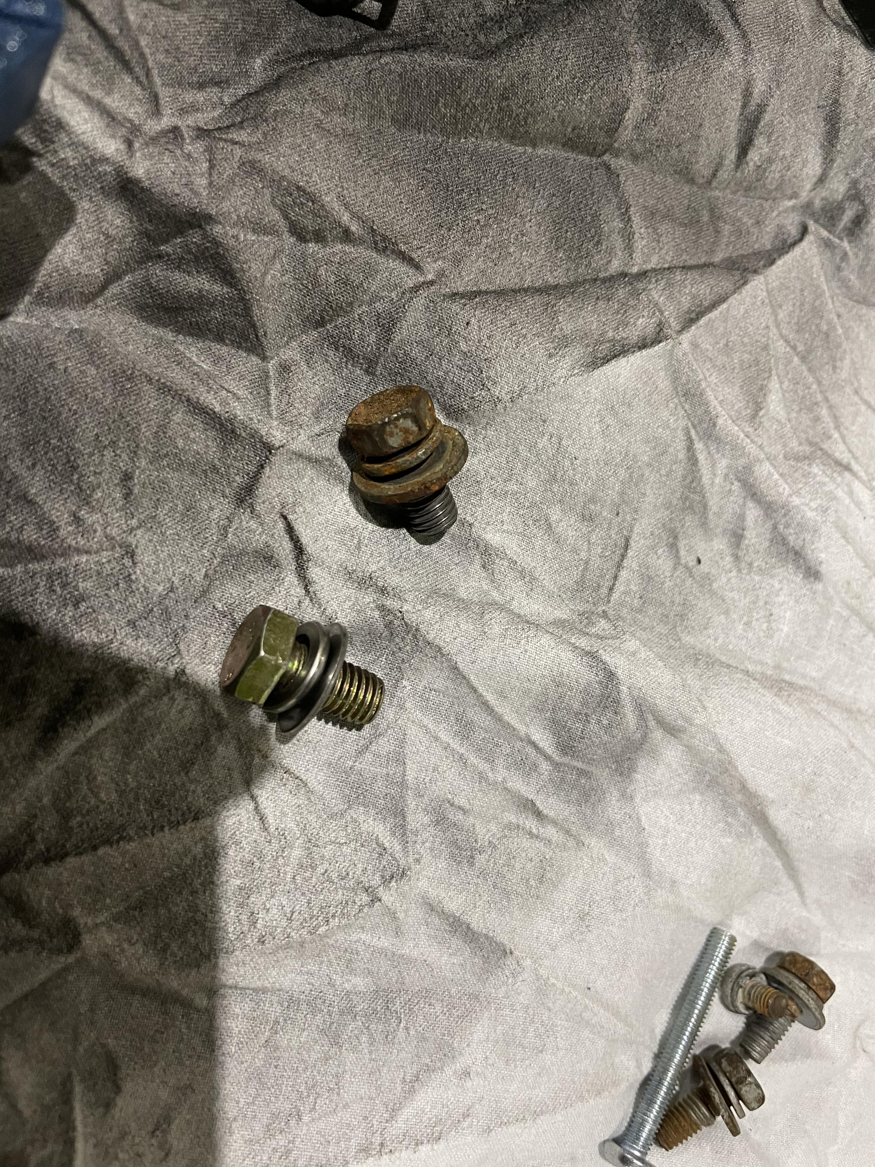

Pikey009 Posted March 3, 2021 Author Posted March 3, 2021 Began to freshen up a few brackets today. I was going to get everything powder coated but the finish I’ve been getting with the dremel a d hammerite have been great so that’s what I’ve gone for. I’ve also begun to replace the nuts, bolts and washers in the engine bay. Let’s just say I started off pretty enthusiastically but the novelty has now worn off. But it should all be worth it once the other shiny bits get bolted on. Quote

Bean Posted March 4, 2021 Posted March 4, 2021 Just got updated on your thread mate as ive not checked it for a while. Great work going on here. The downpipe repair looks bang on too. Quote
enots Posted March 5, 2021 Posted March 5, 2021 Just had a good read through this!! Car looks awesome man! Definitely be getting myself some of that manifold paint to try too makes it look alot tider! Quote
Pikey009 Posted March 5, 2021 Author Posted March 5, 2021 Cheers for the comments, she’s getting there. I’m just really busy at work as usual so most of the time spent on the car is during lunch as I’m still doing degree work In The evenings (god knows why I decided to do one at my stage of life). Thanks, the manifold took some time and patience but really happy with it. With the exhaust paint just make sure you heat cycle it properly so the first time is just letting the car tick over for the paint to bake then let it completely cool down. After that it will be able to take proper heat through it. Quote
Pikey009 Posted March 17, 2021 Author Posted March 17, 2021 Finally fitted the manifold with new brass nuts nuts and spring washers. I got the turbo back on too. Next, I’ll clean the front pipe mating face and re-fit the downpipe. Hopefully the rocker set up will arrive soon so I can get her started back up Quote

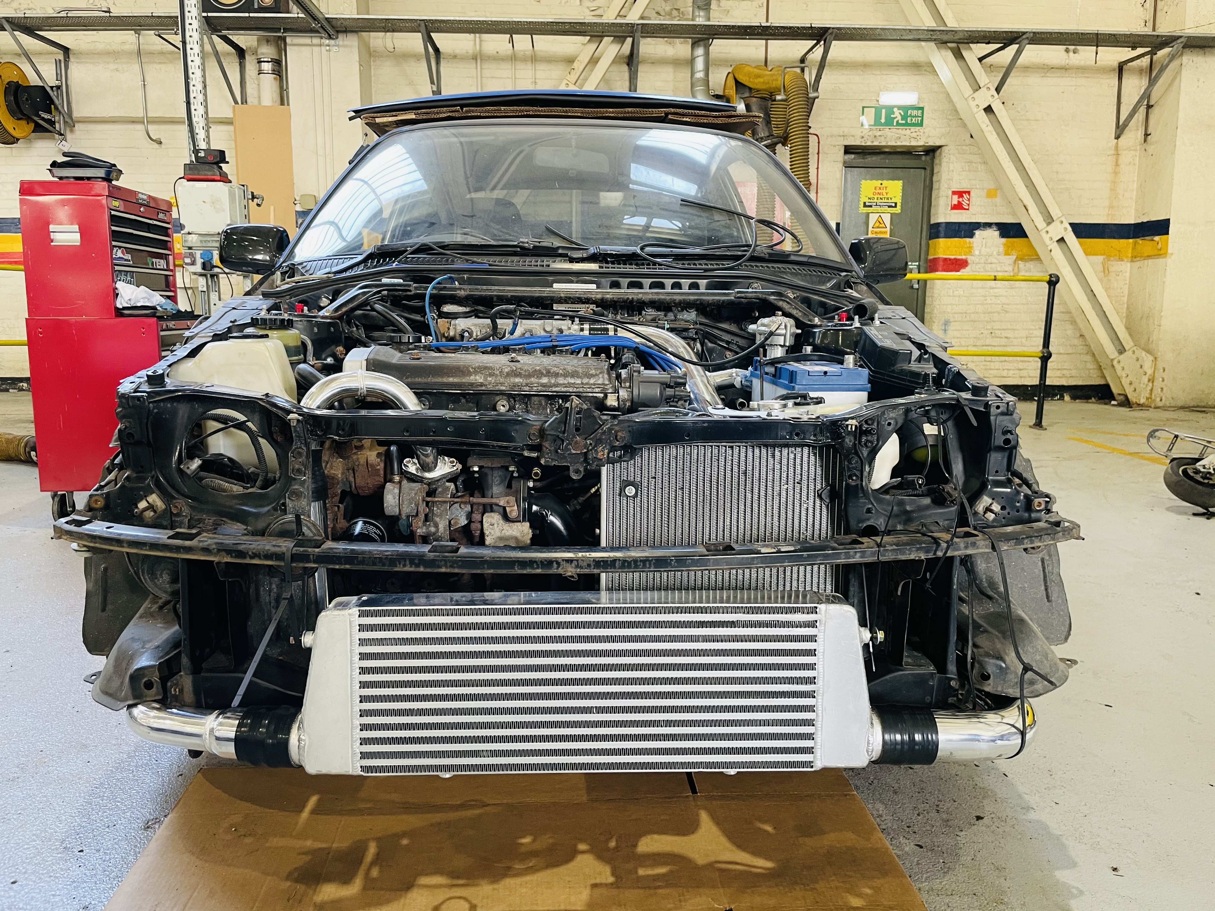

Pikey009 Posted April 7, 2021 Author Posted April 7, 2021 Last week I got the turbo kit back on the car and started test fitting the FMIC but ran out of time. I’m on leave this week so next week I’ll try to get the FMIC fully fitted. Quote

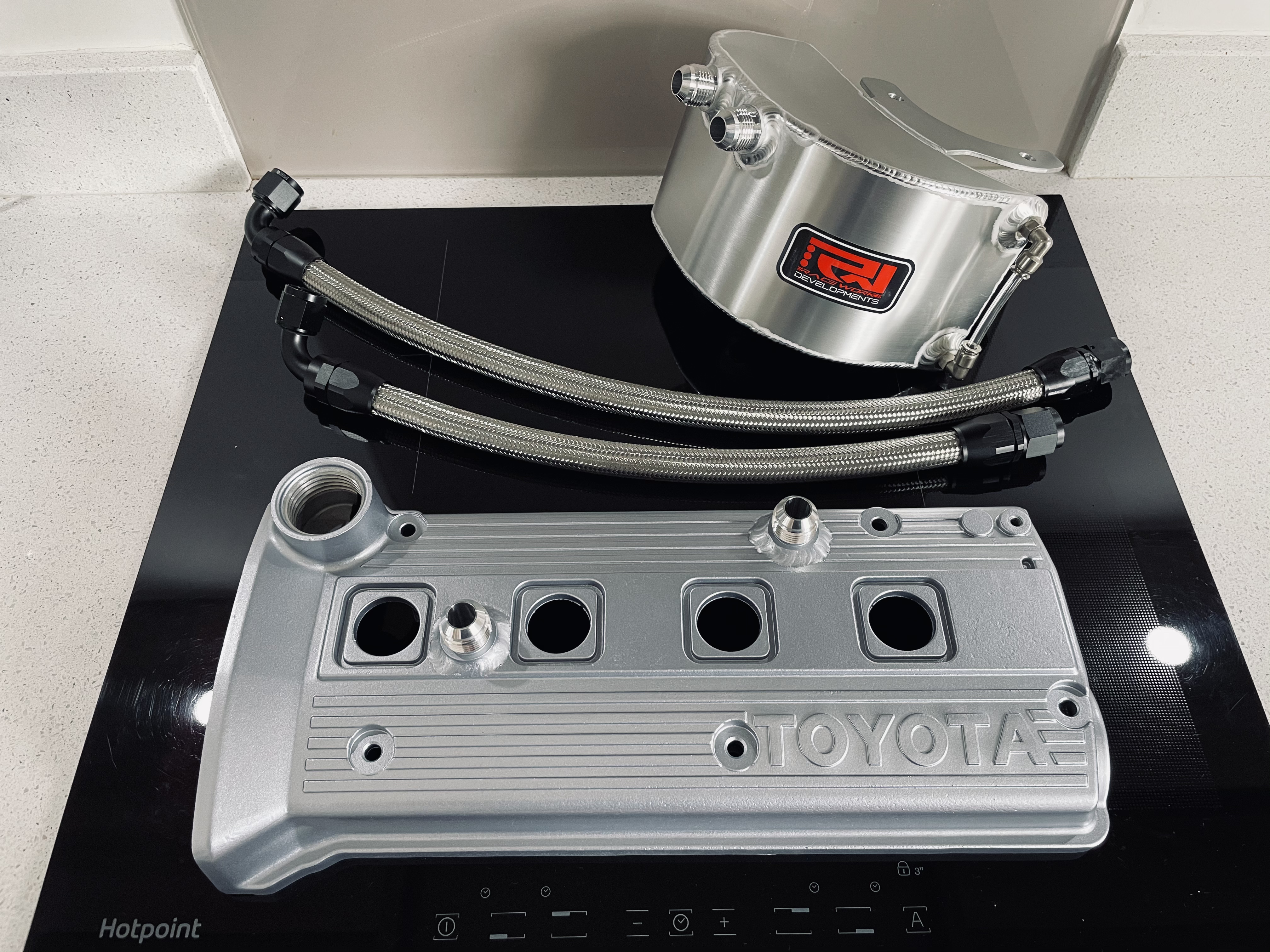

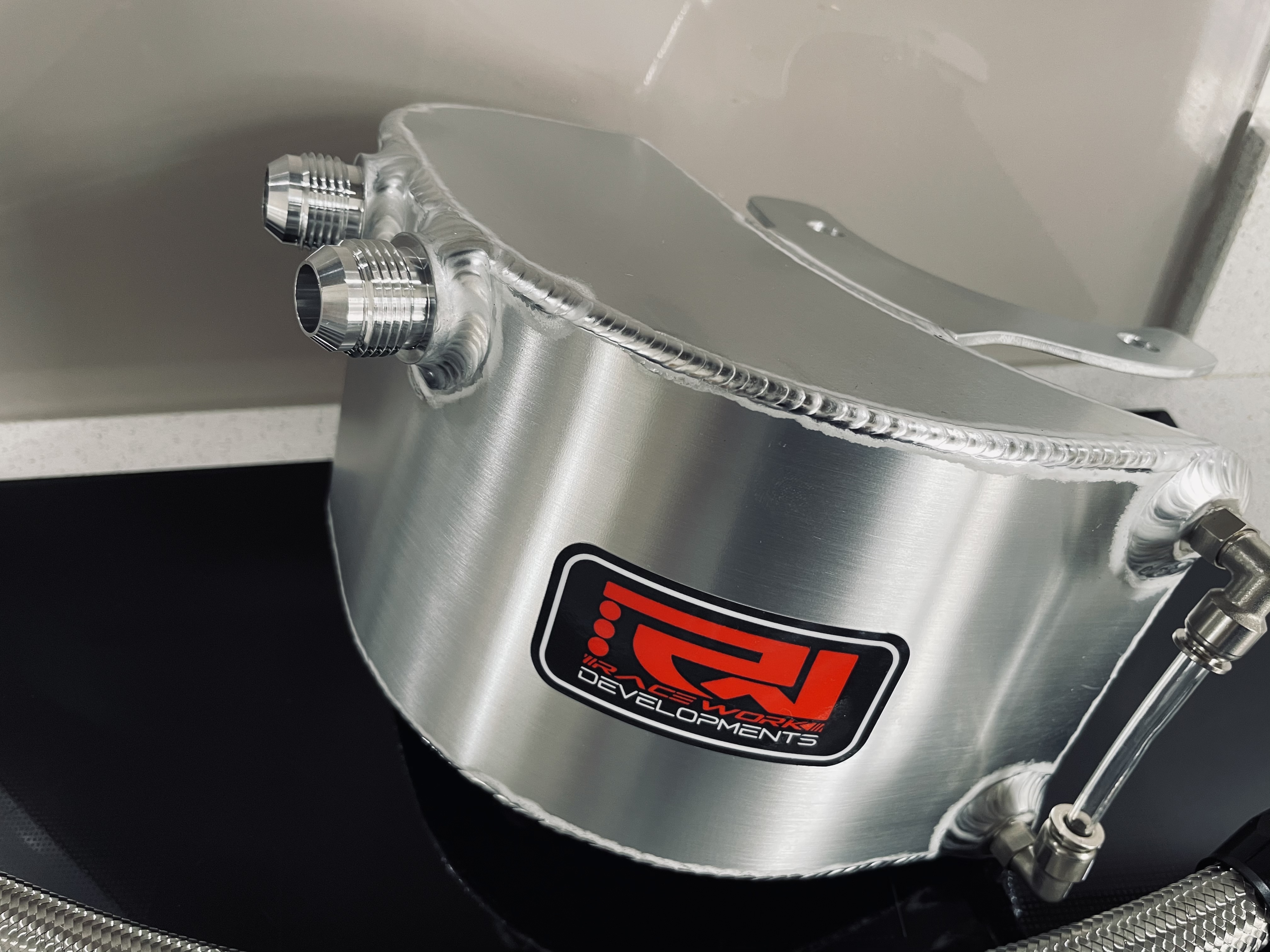

Pikey009 Posted April 7, 2021 Author Posted April 7, 2021 My rocker arrived today from RW-D. I’ve got to say, the quality is spot on. Not cheap but you definitely get what you pay for. Quote
Claymore Posted April 7, 2021 Posted April 7, 2021 49 minutes ago, Pikey009 said: My rocker arrived today from RW-D. I’ve got to say, the quality is spot on. Not cheap but you definitely get what you pay for. Top quality there mate. Nice to see a company producing to that level. Beautiful! 😍 Quote
Pikey009 Posted April 7, 2021 Author Posted April 7, 2021 Yeah, I’ll be taking any future projects there I think. He did it in 1AO silver for me so has a little purple in different light Quote
Sam44 Posted April 7, 2021 Posted April 7, 2021 Agreed they look fantastic. Really going to make the bay look brand new at this rate. I can see I'm going to have to go on a cleaning spree on mine. Quote
rasslenny Posted April 7, 2021 Posted April 7, 2021 1 hour ago, Pikey009 said: My rocker arrived today from RW-D. I’ve got to say, the quality is spot on. Not cheap but you definitely get what you pay for. wow wow wow wow wow... thats all i can say.... if only i lived in the uk .... sigh Quote

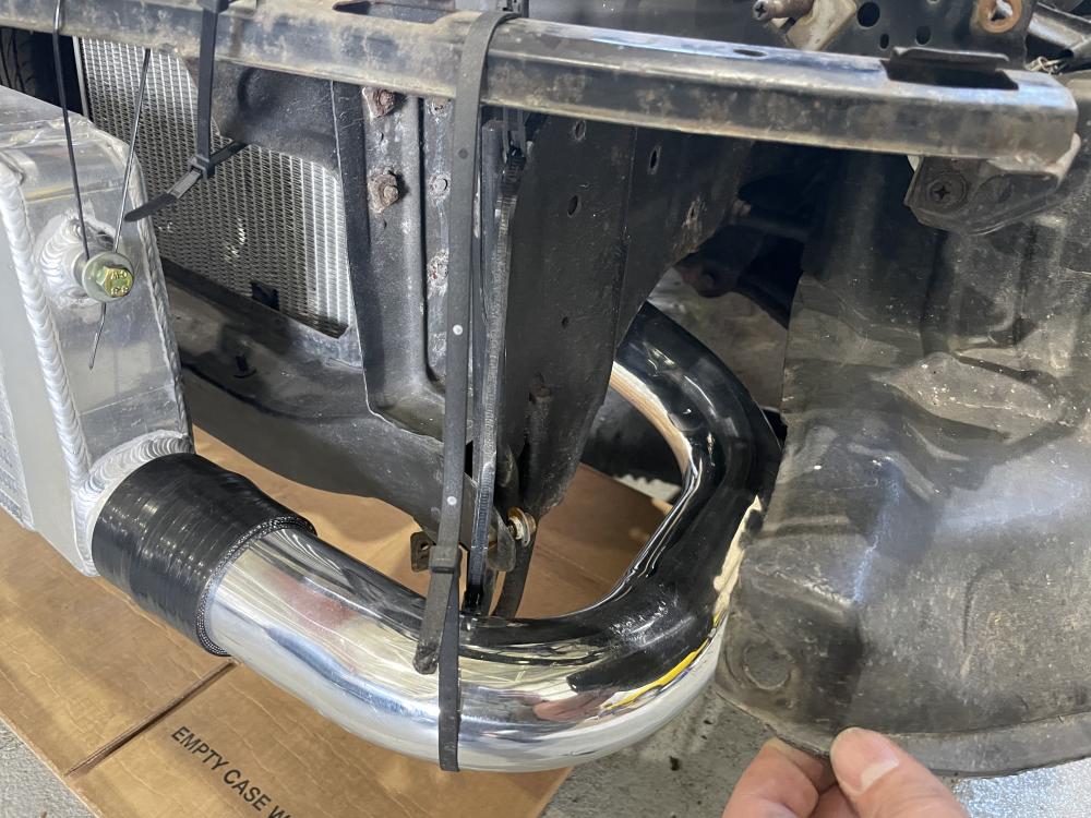

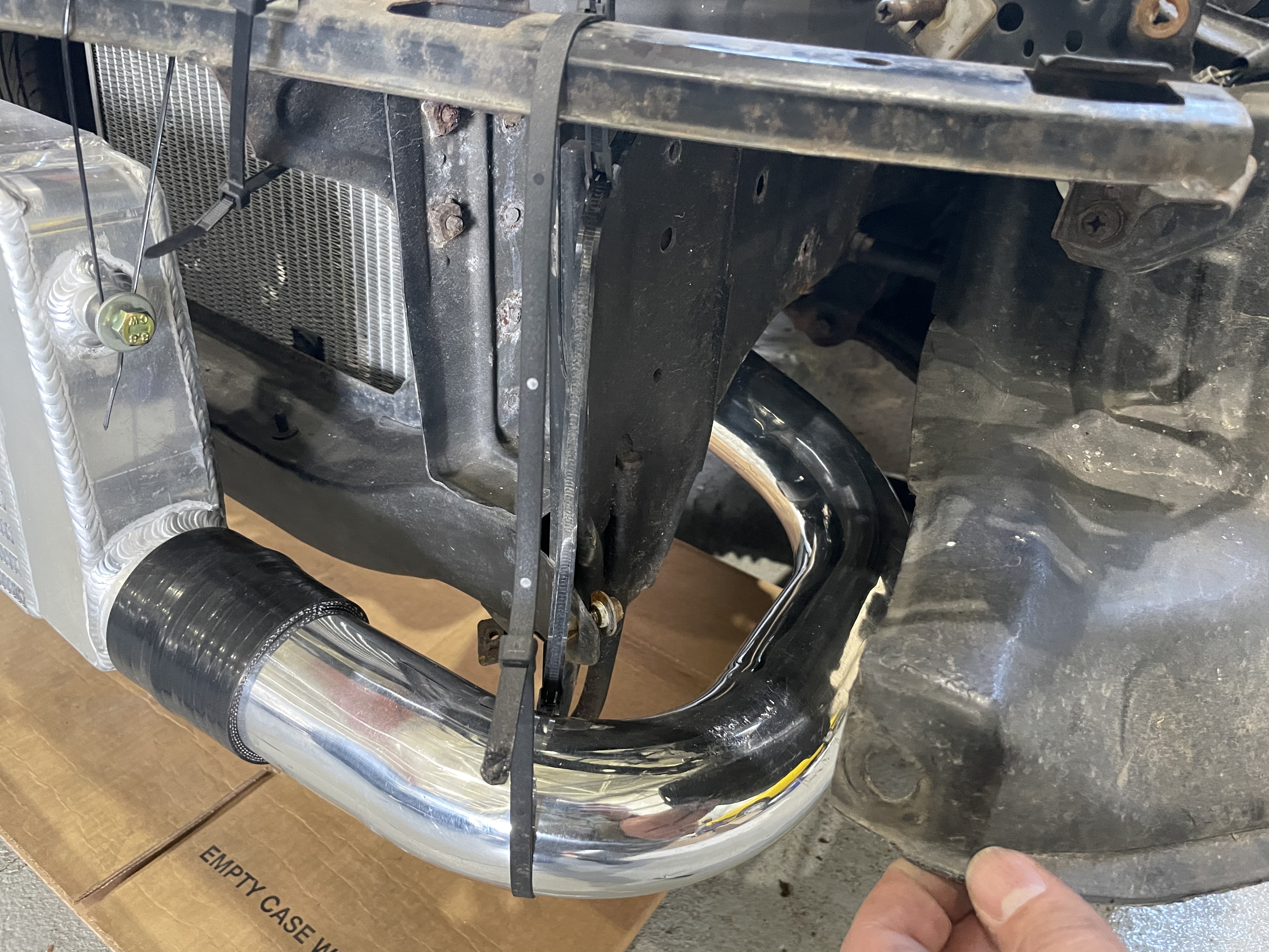

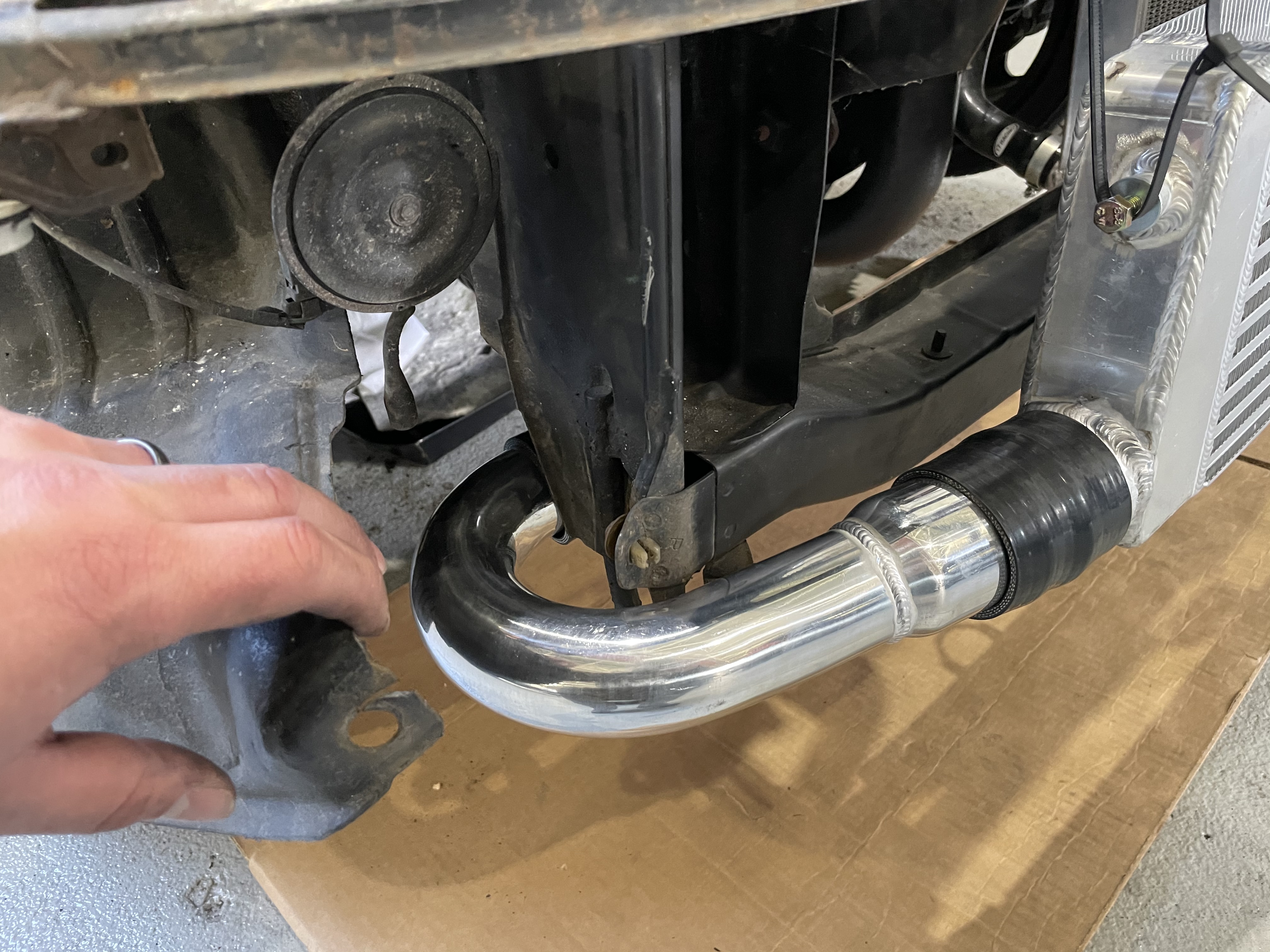

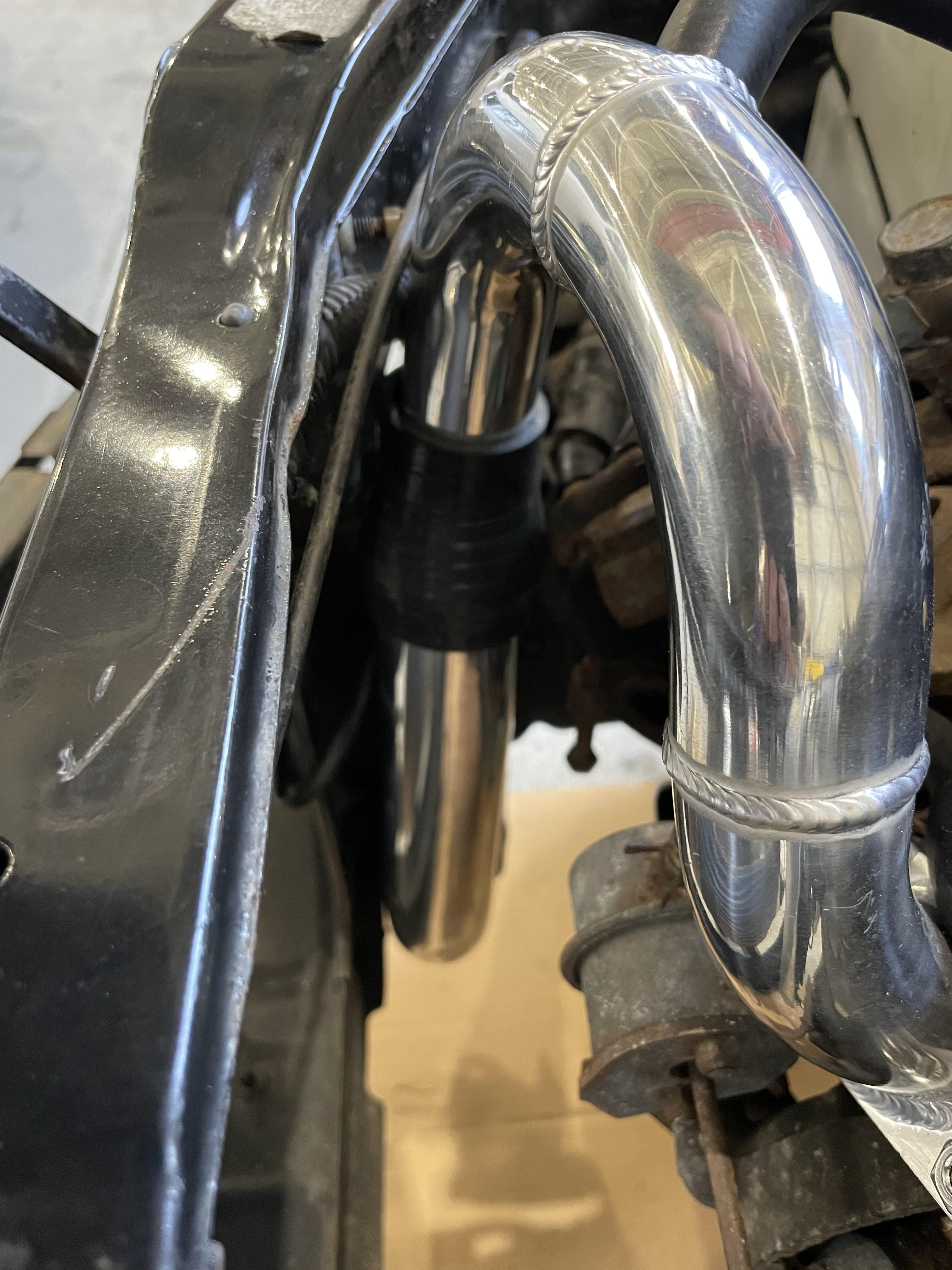

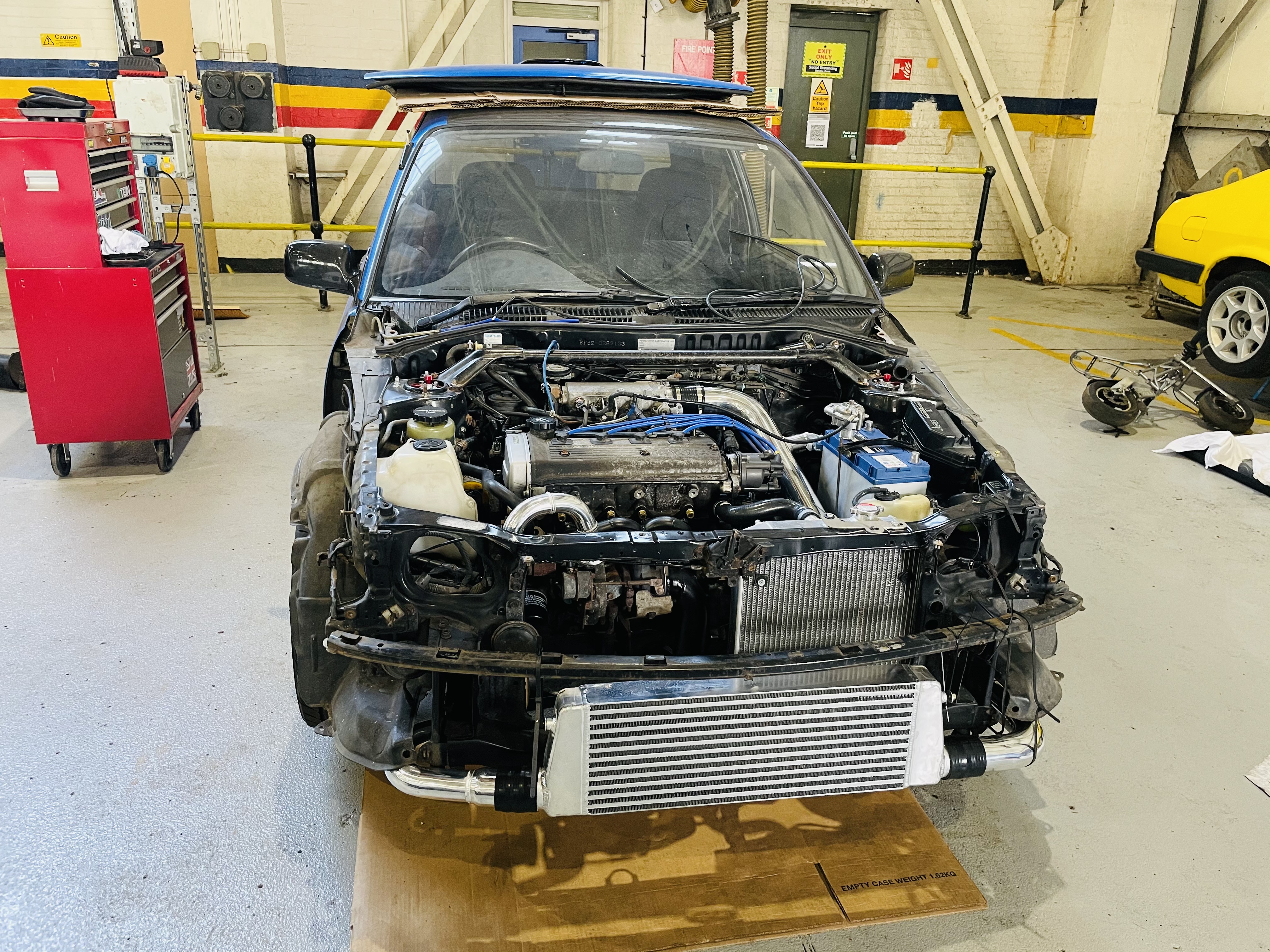

Pikey009 Posted April 13, 2021 Author Posted April 13, 2021 I test fitted the FMIC today- it’s a pretty good fit to be honest. The hot side is a little close to my aftermarket manifold so a bit of tweaking to do there. Quote
Pikey009 Posted April 13, 2021 Author Posted April 13, 2021 Managed to get it pretty level and centred, none of the pipe work fowls or rubs. Quote
