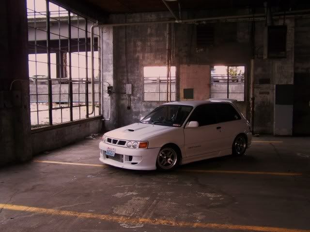

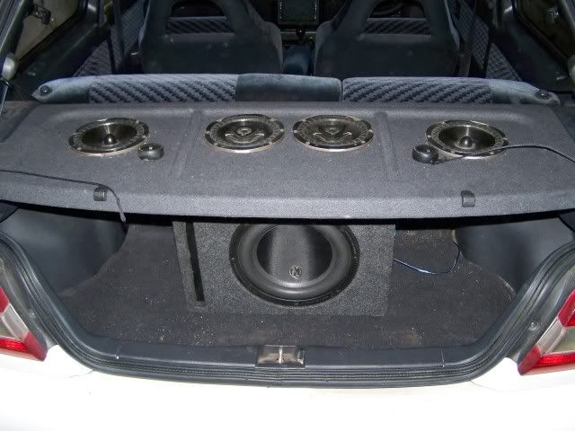

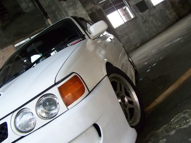

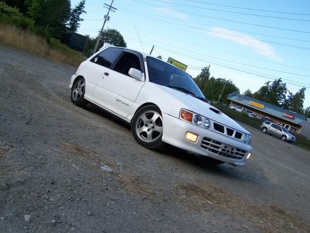

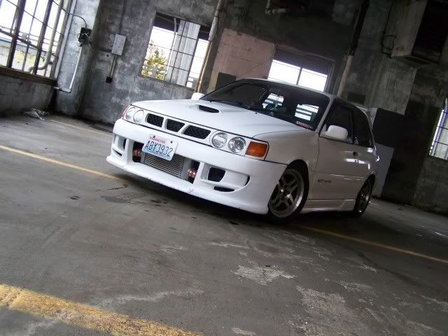

tersplat Posted December 29, 2010 Posted December 29, 2010 well it started with the Whiteline rear sway bar, black front fenders, Tenabe Sustec Pro coilovers, Cusco Carbon Fiber front strut tower brace,Ultra Racing Fender bracesHKS FMIC with HKS piping hks SSQV BOV. It has changed a bit in the last 6 months that I have owned it. since I bought it, I have installed a MOMO steering wheel, blitz turbo timer, All stock internal 1st gen usdm 5efe (5efe pistons with 5efhe rods), ACIS intake manifold, Custom Stainless exhaust manifold, grounding kit, Ultra Racing Spark plug wiresNGK BK7RE Spark plugsHKS GT2835R ball bearing turboTrust External wastegateAasco Aluminum flywheelCompetition Clutch Stage 4 6 puck unsprung clutch and pressure plate3" downpipeJasma full exhaust from the downpipe backScreamer pipeToms C2R 15" wheelsToms front bumperToms rear spatsToms sideskirtsToyo Proxes 4 195/50/15 tires4 focal 4" speakers up front4Kicker 6.5" speakers in the rear deck1 Memphis 10" sub in Memphis Ported boxKicker kx400.1 amp for the subAlpine 2 channel amp for the mids/ highsPontus Double DIN dvd/ radio/cd playerBRE-341 255lph fuel pumpprobably some other stuff but I'm tired and can't think right. Quote

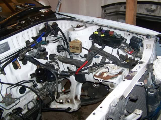

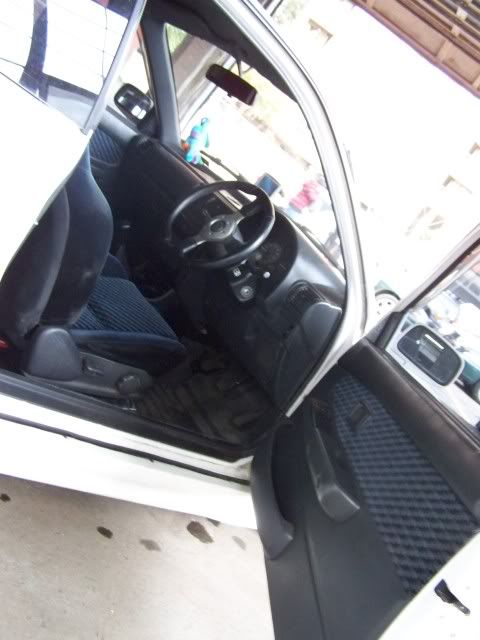

tersplat Posted December 29, 2010 Author Posted December 29, 2010 honestly no clue on power yet. I just got the new engine in 2 days ago. still running stock injectors while wiring in my emanage ultimate. I am not very good at wiring so its pretty tough for me. I think all I have left is to wire in the injectors and injector adapter. I would imagine that once it gets tuned, I'll be in the 250whp area. gonna tune it for 15psi while still using stock rods and pistons. anny advice on how to make it better would be greatly appreciated. I just want to keep the interior stockish, just gages and blue sparco milano front seats with blue or black 4 point harnesses. Quote

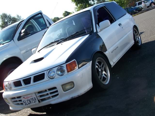

tersplat Posted December 29, 2010 Author Posted December 29, 2010 thanks guys for the kind words. the wheels will be changing a little bit soon, being powdercoated inner part black with the whole hoop in white, I also plan on building a forged 5e. also I need to install my Profec E-01 and multiple gages. I was getting off the car ferry and the front bumper got crushed, so I will either be buying a id-workz one or fixing this one, I know it is fixable. also would like some carbon fiber parts. thats about the limit of the plans right now. I wouldnt give up those wheels or this kit for anything, I absolutely love them It's the only Tom's kitted starlet in the US and one of 4 ep82's in the us(here, california, florida, New York). no glanzas. Thanks again. Quote

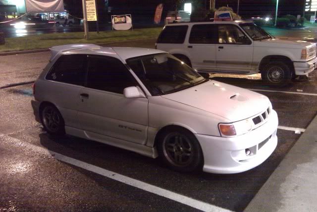

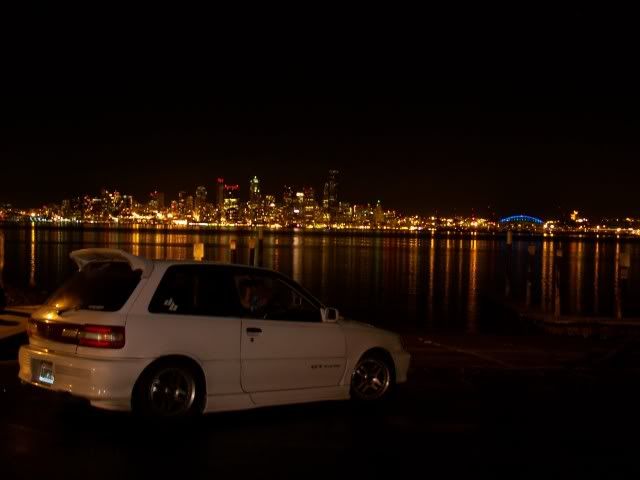

tersplat Posted January 4, 2011 Author Posted January 4, 2011 A little update. I got the 5efte in and running and then missed a shift from 3-4th and instead went from 3-2 at around 85mph which put the engine at 9700rpm. It instantly spun at least 2 bearings and I pulled over and they had welded themselves to the crankshaft and punched a hole in the block under the #1 cylinder where the rod came in contact with the block. So I started cleaning my spare block which should have been another 5efe as it came out of a 92 paseo, but it was instead a 5efhe with the high compression pistons, thick rods, and the 5e stamped crankshaft(5efe's are stamped 3e). So I got that engine in and running very well. better than the 5efte. Also will be going on Saturday to have the new custom 2.5" aluminum intercooler piping and TIAL 50mm BOV made and installed and will be picking up my custom 4 row half size aluminum radiator from Facetuned in Tacoma, WA. well here's some pics of the starlet on New Years Eve overlooking Seattle, WA. No TOM's front bumper right now as it is being repaired.Both taken on Alki Beach across the bay from Seattle, WA Quote
