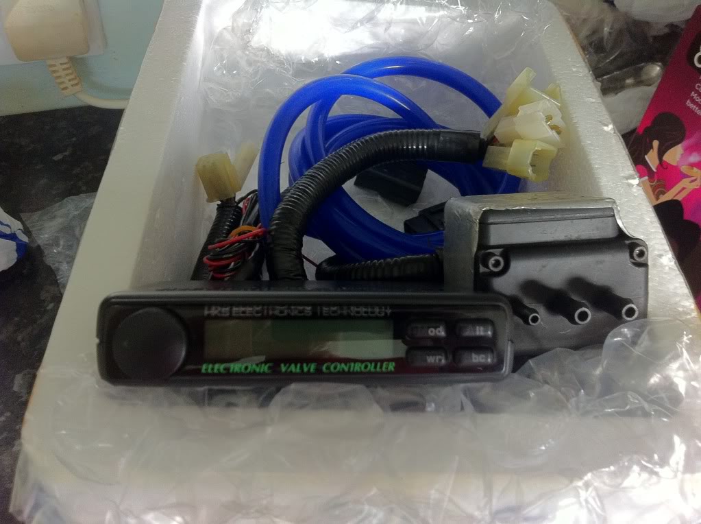

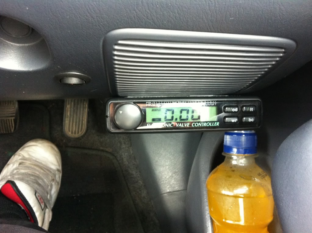

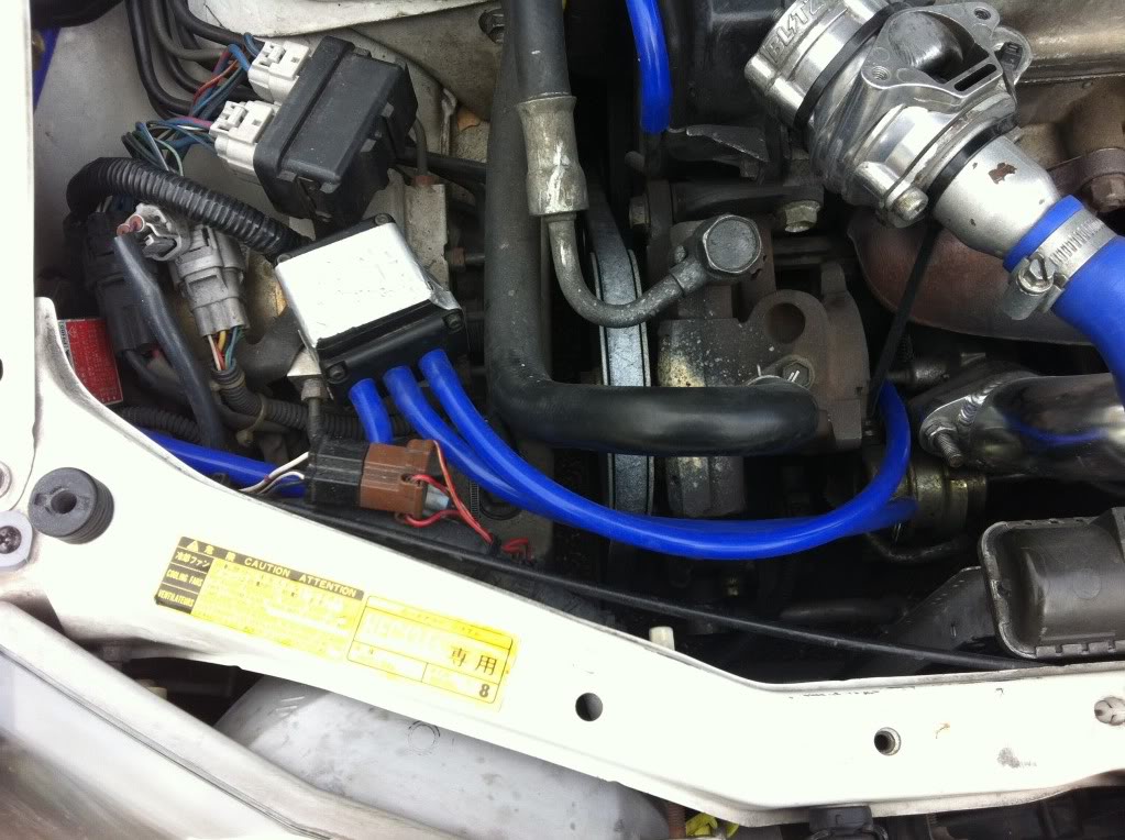

akyakapotter Posted April 15, 2012 Author Posted April 15, 2012 (edited) so dobbs (Chinky Dave) fitted my HKS EVC 4 for me today having trouble setting it up low boost setting goes to 1bar may be because i have a jam acutator im not sure any one know why? anyway heres a few pics Edited July 7, 2017 by akyakapotter Quote

akyakapotter Posted April 15, 2012 Author Posted April 15, 2012 im loving the hks boost controller just been out and set it up. Low 0.6 high 1.0 and scrable 1.2 i love it. also just put my 2 idwork stickers on one each side Quote

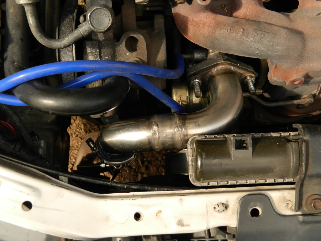

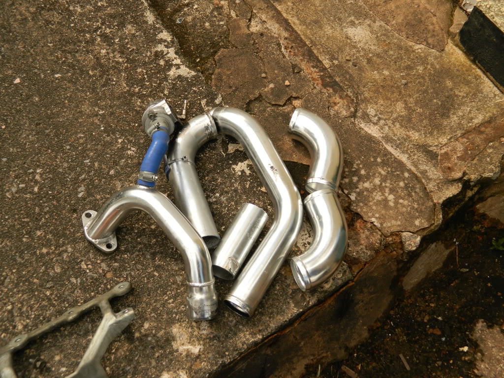

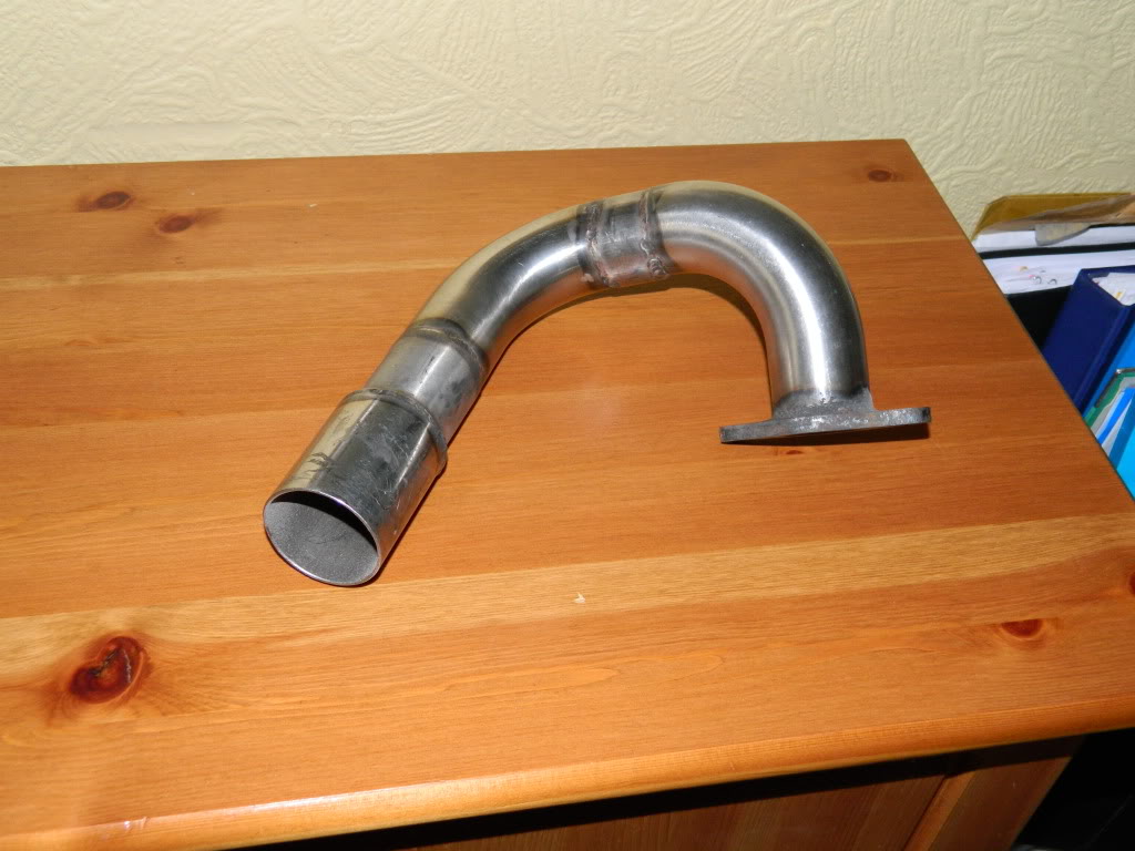

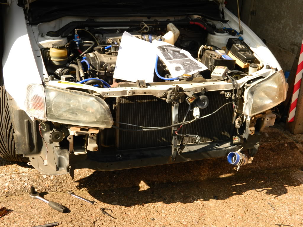

akyakapotter Posted April 24, 2012 Author Posted April 24, 2012 so been busy today. Fitted my short route hot pipe today what a bastard that was cost me £46 quid for bits that i needed and my A/C needs to come out but hey was gonna do it anyway hes the finished artical what you guys think.And heres how much intercooler pipe i got rid of need to get my bov welded into the cold side I/C pipe. chatter will do for now. car pulls so much better but i have loads of creep nothing the boost controller cant fix Quote
aaddzz123 Posted April 24, 2012 Posted April 24, 2012 LOL how much piping!!? Nice work matey. Have you fitted the decat yet? If not and you think you have boost creep now, wait till you fit that fucker lol! And a manifold will make it worse... Time to get that td04 on mate ;) Quote
akyakapotter Posted April 24, 2012 Author Posted April 24, 2012 no mate i havent got the decat on yet as i need to get my wideband bung welded when the depo wideband turns up. I had sod all boost creep with my over mani hot pipe but its stupid now lmao ill get the TD04 in when my money will allow. Quote
akyakapotter Posted April 25, 2012 Author Posted April 25, 2012 Coming along nicely JohnThanks John i swear since fitting that short route hit pipe the car feels quicker :-) Quote
ro55ifumi Posted April 25, 2012 Posted April 25, 2012 It aids spool time, making it quicker ;)John Quote
akyakapotter Posted April 25, 2012 Author Posted April 25, 2012 It aids spool time, making it quicker ;)JohnI love it and boost creep lots of boost creep. could be down to a massive crack I saw in my wastegate when I put the cat on for M.O.T :-( Quote
ro55ifumi Posted April 25, 2012 Posted April 25, 2012 Oh yes and will creep even more when you fit de cat,!!!! Quote
akyakapotter Posted April 25, 2012 Author Posted April 25, 2012 I hope it dosent get to bad :-S Quote
_shaun_ Posted April 25, 2012 Posted April 25, 2012 when your fitting the decat take the turbo off and if u have a dremel just grind the wastegate bit bigger should sort it out Quote
akyakapotter Posted April 25, 2012 Author Posted April 25, 2012 I did that the last time the turbo was off must not have been enough :-( Quote

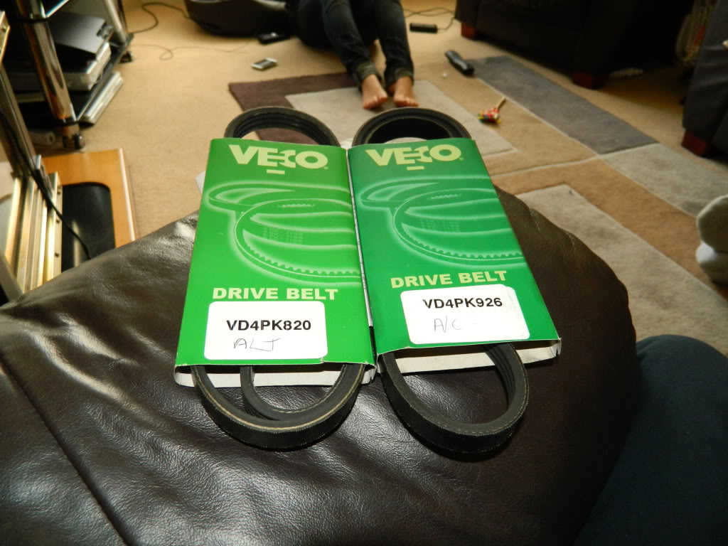

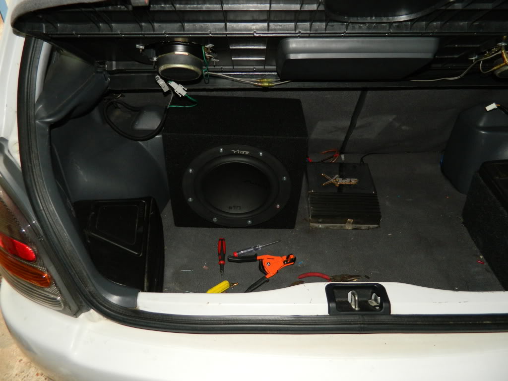

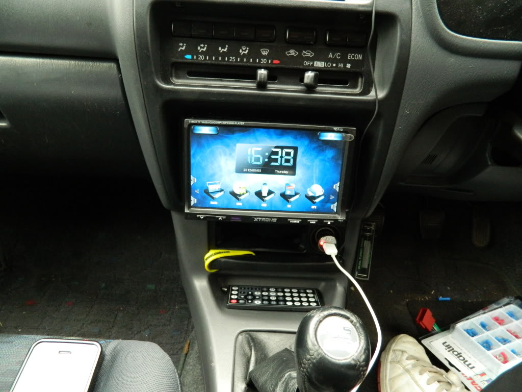

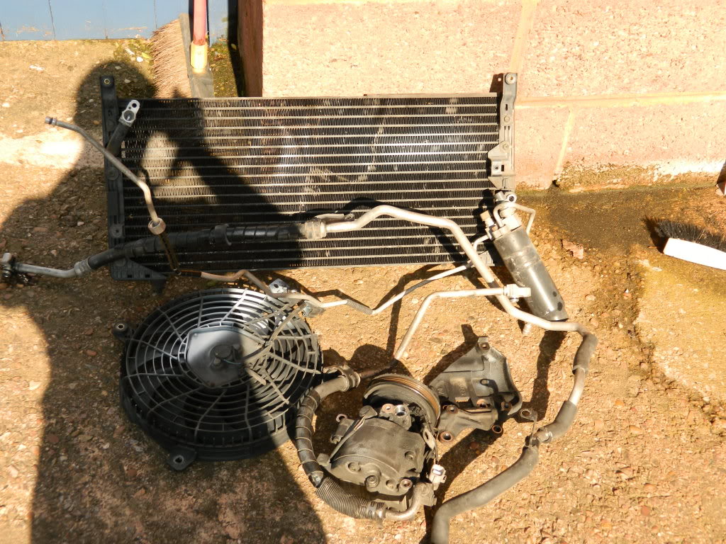

akyakapotter Posted May 3, 2012 Author Posted May 3, 2012 Managed to get my A/C ripped out today replaced both belts while I was at it do much more room with no A/C. :-) also fitted a DVD CD player and my wideband turned up today to 2/5/12 will post pics after tomorrows antics got a sub and amp to fit tomorrow wide band will be going on next week once I've had the bung welded into my decat :-). Quote

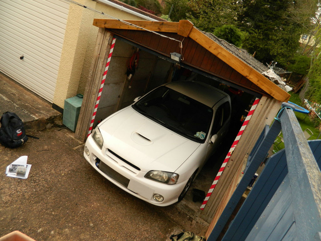

akyakapotter Posted May 3, 2012 Author Posted May 3, 2012 (edited) ok so heres a few pics from the last 2 days on the 2/5/12 me and chinky dave (dobbs) took my aircon out feels so much better and chainged both belts and today 3/4/12 i fiitted a new cd/dvd head unit and sub and amp as i was fed up with no bass so much better and a cheeky photo of my car in the garage Edited July 7, 2017 by akyakapotter Quote
Dave D Glanza V Posted May 3, 2012 Posted May 3, 2012 feels so much different when you remove the air con saves so much weight looking good Quote
akyakapotter Posted May 3, 2012 Author Posted May 3, 2012 haha thats not me thats my mate who helped me was stood on the step of my house though. wide band and decat will be going on some time in the week Quote
