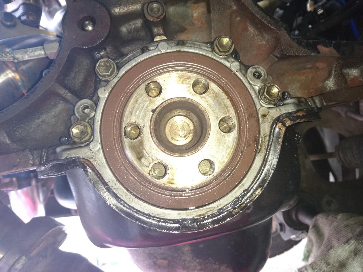

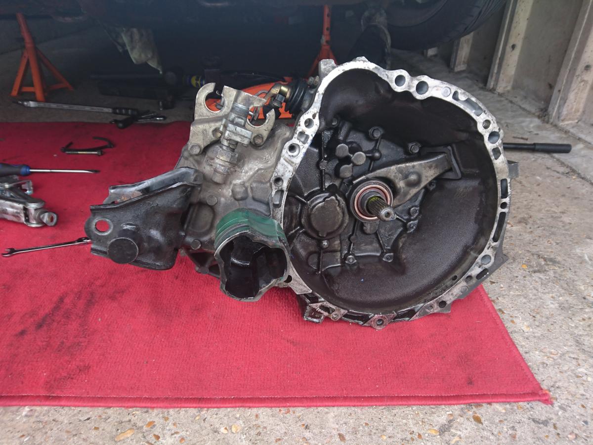

akyakapotter Posted May 16, 2016 Author Posted May 16, 2016 This happened today been leaking oil so box had to Come off to see if it was sump or crank seal not sure which one it is though think I removed it just in time to save the clutch getting buggered by the oil. Never again will I try take the box out on my own what a pain in the ass lol Quote

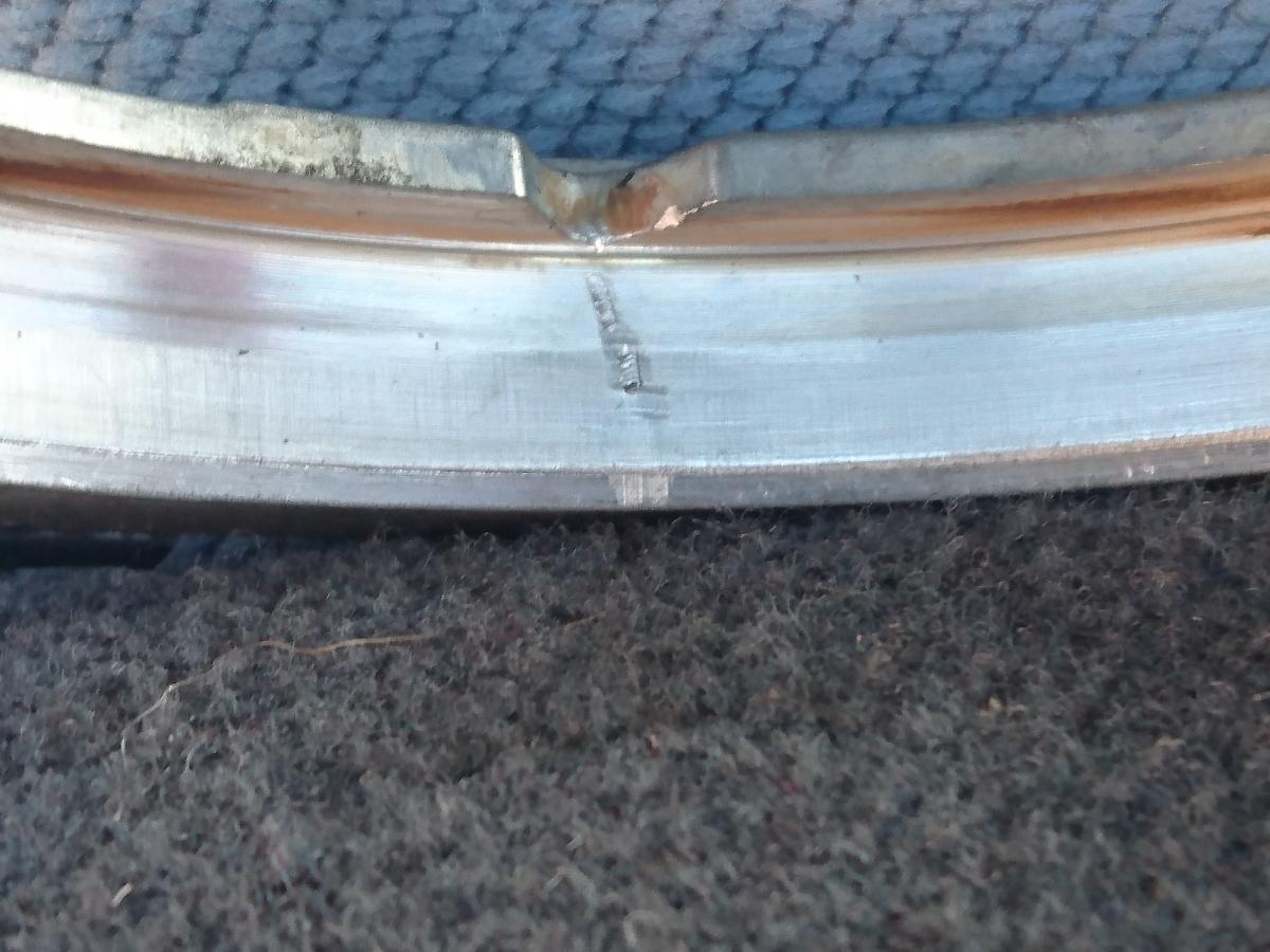

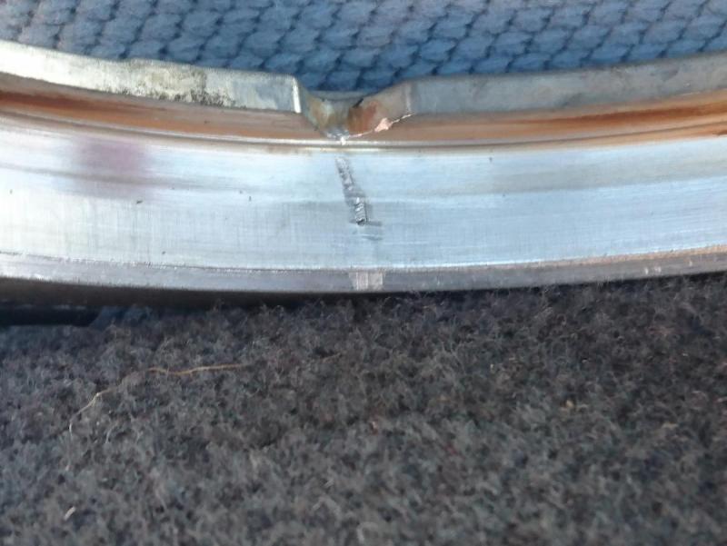

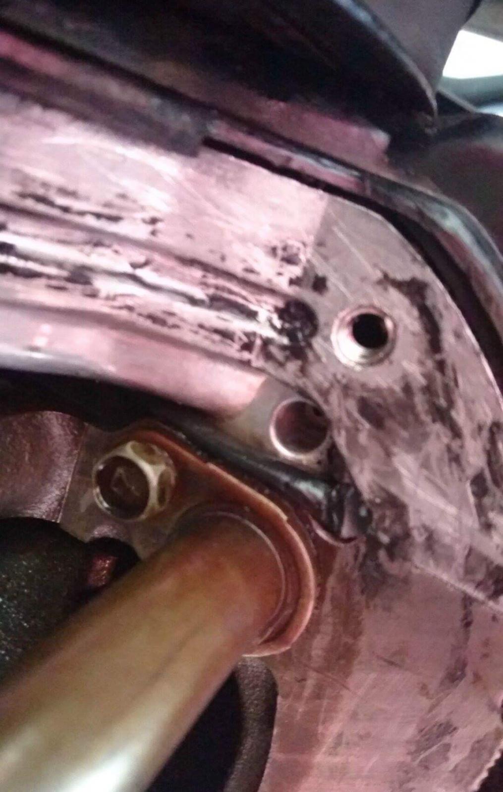

akyakapotter Posted May 16, 2016 Author Posted May 16, 2016 Had a nosey around this Saturday, very smart car love the optional tints.Thank you bud Possibly found the reason for the leak removed the seal and carrier and found this. Quote
jiggaman_16 Posted May 17, 2016 Posted May 17, 2016 (edited) hope thats the problem right there. Removing it on your own, that aint so bad, but re-installing it on your own without the proper tools ....... thats a doozy right there Edited May 17, 2016 by jiggaman_16 Quote
daniel_g Posted May 17, 2016 Posted May 17, 2016 Wait till you put it back in yourself on the deck haha. Quote

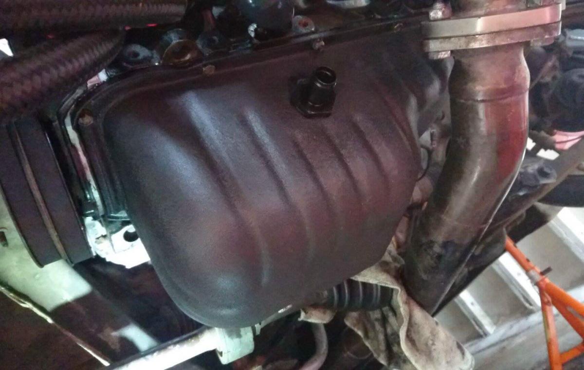

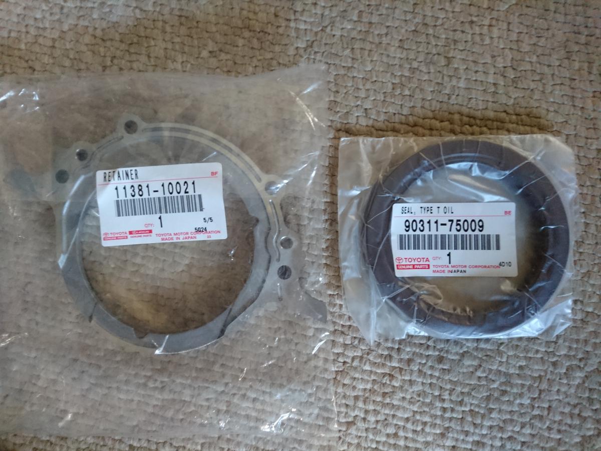

akyakapotter Posted May 23, 2016 Author Posted May 23, 2016 Ordered a new rear main oil seal and new seal housing should sort that issue. Also have a baffeled sump on route will put it all on at once while it's all off its having oil and filter plugs dizzy and rota arm change sort a few minor oil and coolant leaks then hopefully it stops being a c*n* for a few months and I can start doing a few track days and enjoy it Quote
akyakapotter Posted May 24, 2016 Author Posted May 24, 2016 Got the bits I need to be able to put it back together but waiting on my sump to arrive before I do start. Quote

akyakapotter Posted June 16, 2016 Author Posted June 16, 2016 So cars being a cunt both cambelt side bolts through the sump decided they didn't want to do there job and stripped the threads in the ally part they bolt to fun for me not fucking car. Quote
akyakapotter Posted June 17, 2016 Author Posted June 17, 2016 (edited) decied im going to helicoil the 2 threads that have decied to no longer do there job am i right in saying that they are m6 bolts ? Edited June 17, 2016 by akyakapotter Quote
jiggaman_16 Posted June 18, 2016 Posted June 18, 2016 decied im going to helicoil the 2 threads that have decied to no longer do there job am i right in saying that they are m6 bolts ? Not sure about the M6 but what i did was get some 11 mm head bolts & a tap to suit. That route is a bit simpler than the helicoil. It happens all the time, we forget that the end bolts on the crankcase screw into aluminum (oil pump & rear crankshaft seal housings) & not steel as the rest of the block. I got 3 11mm bolts out of 4 in mine nw. Quote
akyakapotter Posted June 18, 2016 Author Posted June 18, 2016 Not sure about the M6 but what i did was get some 11 mm head bolts & a tap to suit. That route is a bit simpler than the helicoil. It happens all the time, we forget that the end bolts on the crankcase screw into aluminum (oil pump & rear crankshaft seal housings) & not steel as the rest of the block. I got 3 11mm bolts out of 4 in mine nw. thank you for the input bud ive ordered a helicoil kit now so ill do it that way pain in the ass cars been off the road for a month already and its annoying me haha Quote

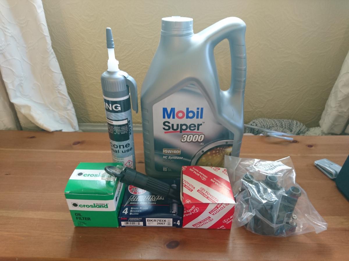

akyakapotter Posted June 18, 2016 Author Posted June 18, 2016 This turned up today get it sorted Tuesday and crack on putting the box back in. Quote
akyakapotter Posted June 21, 2016 Author Posted June 21, 2016 So got the helicoil's fitted today that was fun. Sump resealed again. Just the box to get back in now. Change the cambelt as I'm not sure if I went a bit to deep with the drill and snagged it so changing it for piece of mind. Chuck the service bits on then I can enjoy the car for a bit. Quote
