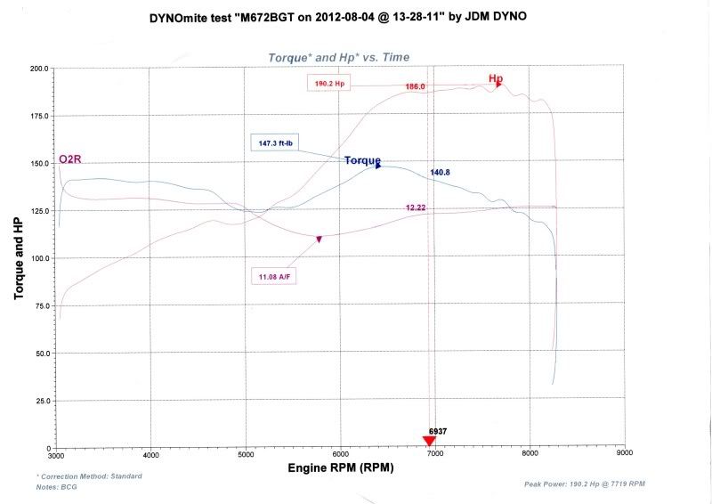

DevonGT Posted September 14, 2014 Posted September 14, 2014 Third graph is AFR, looking a bit lean. Quote
Glanza Mac Posted September 14, 2014 Author Posted September 14, 2014 Yeah it is a bit but I did say go for it so if anything did happen I would of been liable as I did state I have another engine so I'm not bothered, I just wanted to see what it would make for shits and giggles :-) Rob. Quote

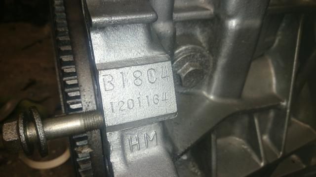

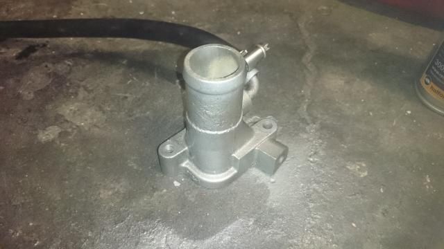

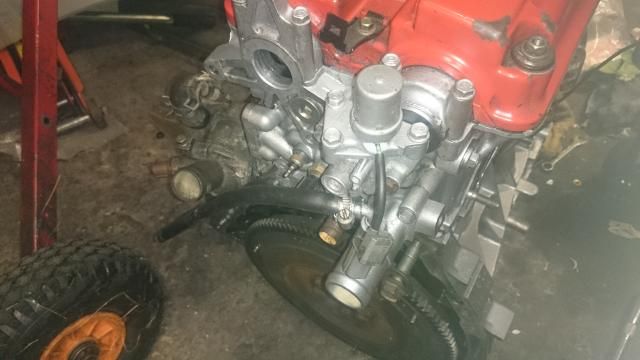

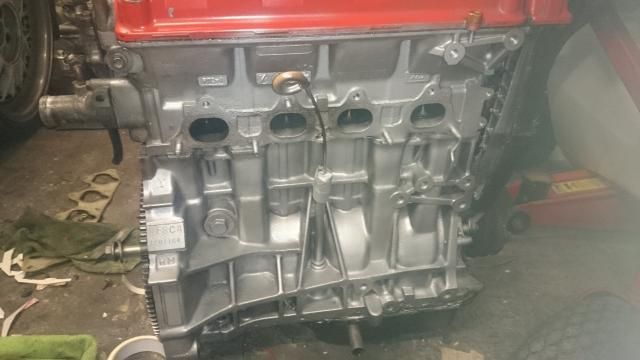

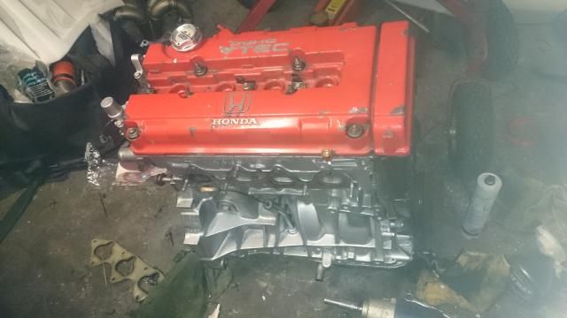

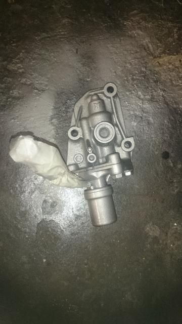

Glanza Mac Posted September 18, 2014 Author Posted September 18, 2014 Got bored after work last night so sprayed my forged block with some aluminium spray paint :-) Rob. Quote

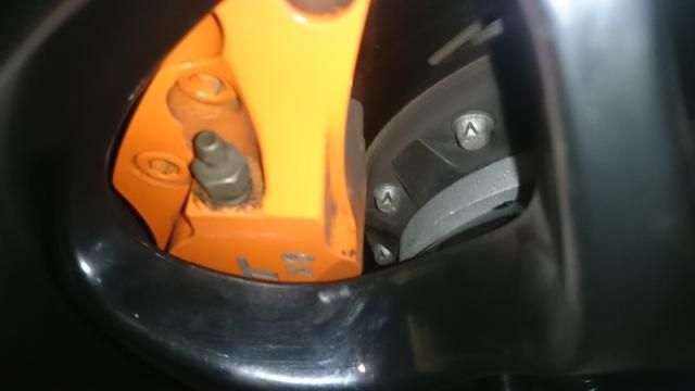

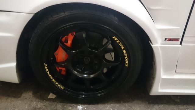

Glanza Mac Posted October 6, 2014 Author Posted October 6, 2014 Yeah I had to scrape to get themClose fitment isnt the word, even with 10mm spacersRob. Quote
jimmymac101 Posted October 6, 2014 Posted October 6, 2014 damn thats a tight fit Look mean as though!! James Quote
Glanza Mac Posted October 6, 2014 Author Posted October 6, 2014 1mm clearance from the inner of the rim, I'll take some more detailed pictures :-) Rob. Quote
Bean Posted October 6, 2014 Posted October 6, 2014 (edited) That fuelling is a good bit off. Ive got a stock b18c4 with just a edelbrock victor x inlet, and a full 2.5" exhaust system i made. heres the graph. The car still had the stock lsi exhaust system here and ran quite rich. ive not had it back on the dyno since the exhaust system and leaned the map out a little. Imho this dyno reads about 7-8% higher than others ive used. also are you in need of a p28? i have a spare one i socketed. i used to quickly swap a few maps over on the dyno. Good going on the swap!! Edited October 6, 2014 by Bean Quote

Glanza Mac Posted October 6, 2014 Author Posted October 6, 2014 That's for that graph dude, not a bad result!Yeah I knew the fueling would be out but not to the point where they wouldnt go full revs, I would of signed a disclaimer if need be haha I'm borrowing an S200 that was mapped at cpl but was on a stock inlet so that's my problem but I will be getting a s300 for my boosted build :-) Rob. Quote

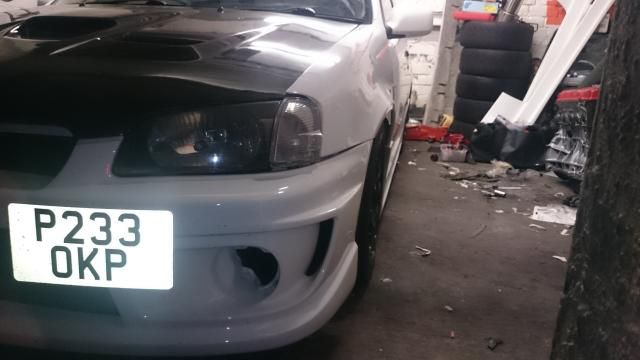

Glanza Mac Posted October 6, 2014 Author Posted October 6, 2014 (edited) Here's some picturesCould do with some wider spacers to make them fit the archsSome clearance pictures Rob. Edited October 6, 2014 by Glanza Mac Quote
Idrees Posted October 6, 2014 Posted October 6, 2014 We need some proper pictures of the new wheels on Rob! I really liked the old wheels too, well they're not really my cup of tea but they actually looked so good on your car. Good to see she's up and running well, bring on more power!Ps. My brakes were that close, ran them daily for months without issues but after a full day on track at Japfest the wheel rubbed against the caliper causing a spoke to crack. Ruined a set of Advan RGs Quote
jimmymac101 Posted October 6, 2014 Posted October 6, 2014 Damn!! Are you they actually don't rub ? James Quote
Glanza Mac Posted October 6, 2014 Author Posted October 6, 2014 I won't be using these wheels on track so I hope that doesn't happen :-/ Yeah more power will come in time :-D Nope they don't rub, I did 4 hours of driving yesterday with no issues :-) Rob. Quote
