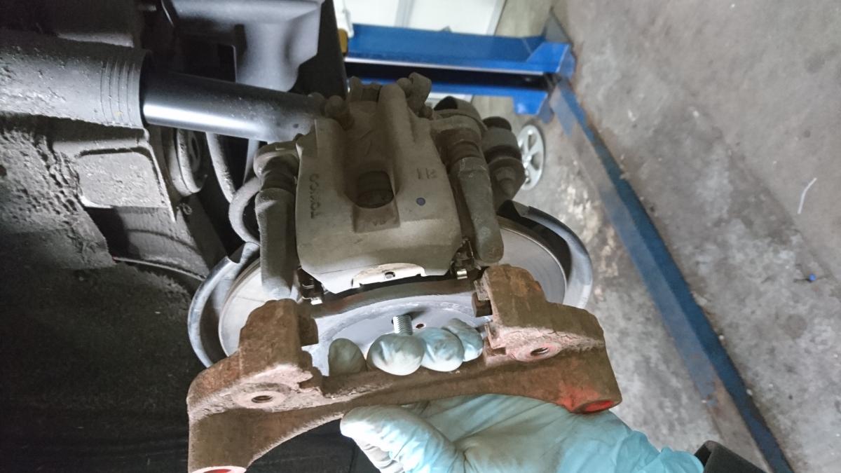

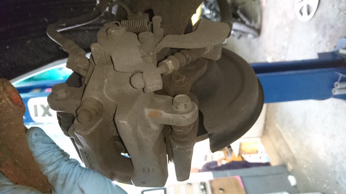

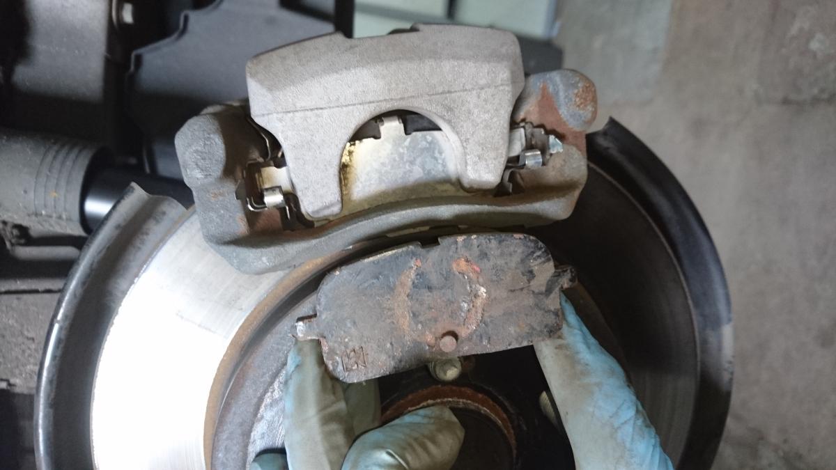

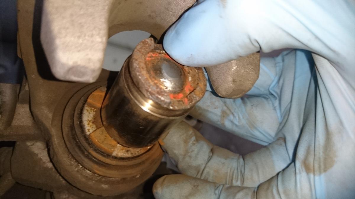

What about using rear calipers from a prius? (I know! Hear me out)
Was working on one today and the calipers look very similar in design and size, they would need a different carrier bracket though, or an easier way would be a different mounting bracket (that bolts to the axle which the carrier bolts onto) to suit
But the calipers & pads are a similar size so could use the standard sized disc, or slightly larger, plus the piston is much larger and you could still utilise the standard handbrake cable by using a custom lever plate
Just an idea :unknw:
Comparing the Glanza carrier to the prius

Pads
post-9573-0-36564700-1468593052_thumb.jp
Handbrake cable
post-9573-0-12950300-1468594418_thumb.jp
Piston
post-9573-0-04096200-1468596543_thumb.jp
