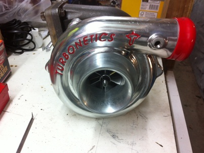

Stu Posted January 22, 2013 Author Posted January 22, 2013 (edited) Picture less update I'm afraid...(well of my car anyway) Have pretty well finished the inlet manifold now short of welding on the injector bosses and making a fuel rail mount. Have modified the intercooler pipe to suit and will be re-fitting the antilag solinoid at some stage soon. With the intercooler pipe changing I've cut off the BOV and will re mount this onto the shorter pipe. Currently sorting a couple of other cars to fund a few new parts - have got a mates fairly serious forged 5efte EP82 that I'm building a new manifold and drop pipe to suit a big Turbonetics T4 along with fitting his big brakes. Just waiting for the turbo to arrive. Have already setup the coil on plug ignition. Edited January 22, 2013 by Stu Quote

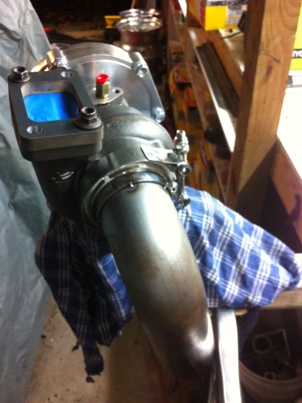

Stu Posted April 27, 2013 Author Posted April 27, 2013 Have also been working on the Angry Smurf again - the turbo finally turned up after a 4-5 month wait so started on the new turbo manifold. Made up a quick downpipe Then made a start on the manifold Have made the merge collector but no photos of that yet Quote

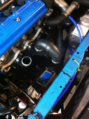

Stu Posted June 3, 2013 Author Posted June 3, 2013 More progress made on the Angry Smurf - will be welding this all up soonish Will update on my car at some stage Quote
