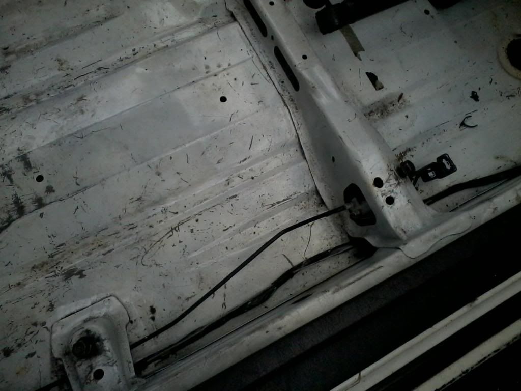

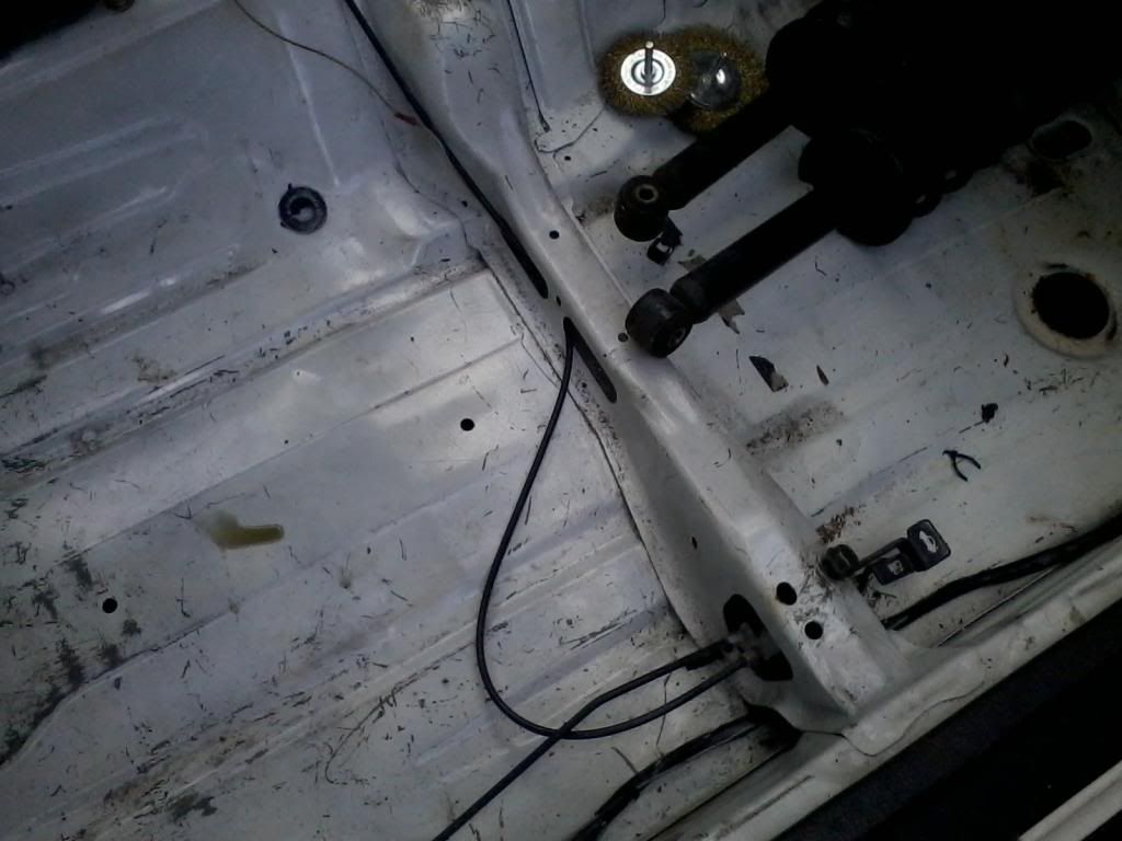

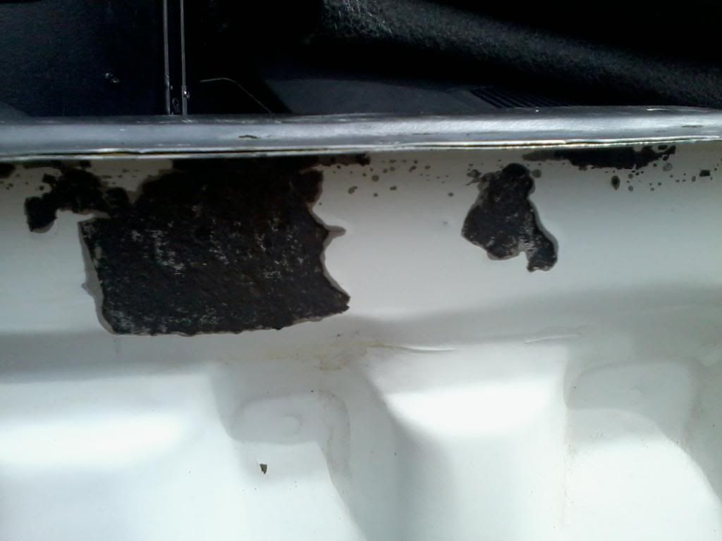

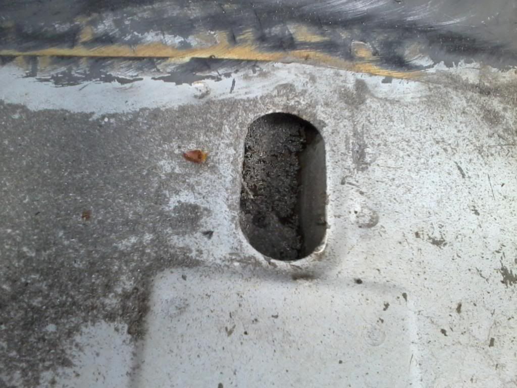

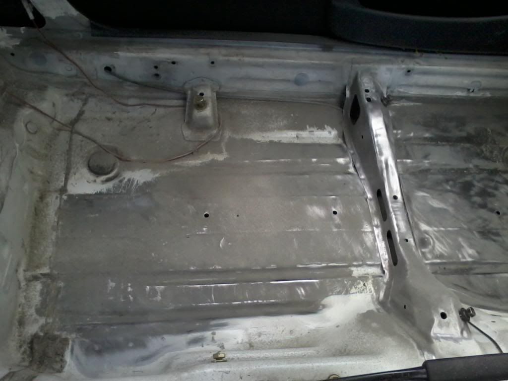

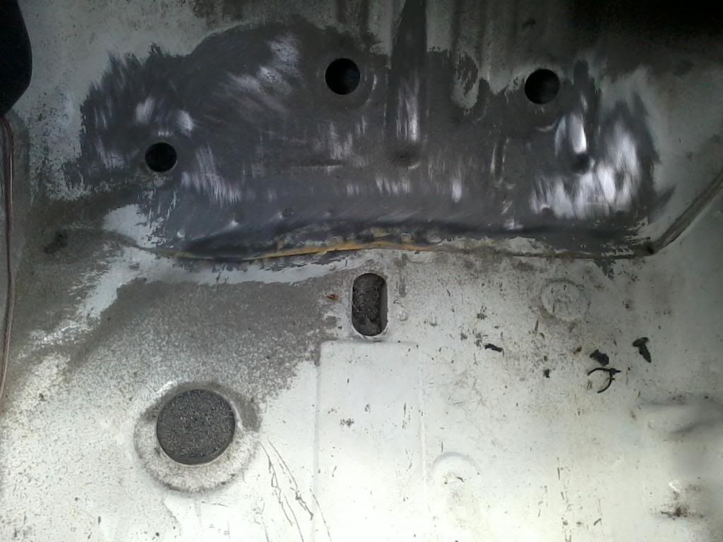

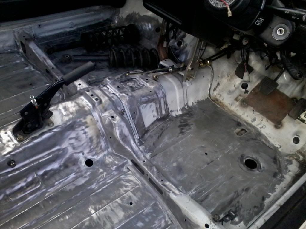

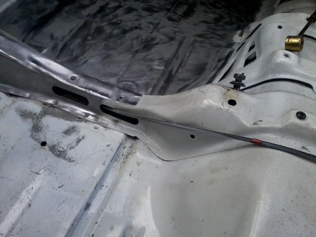

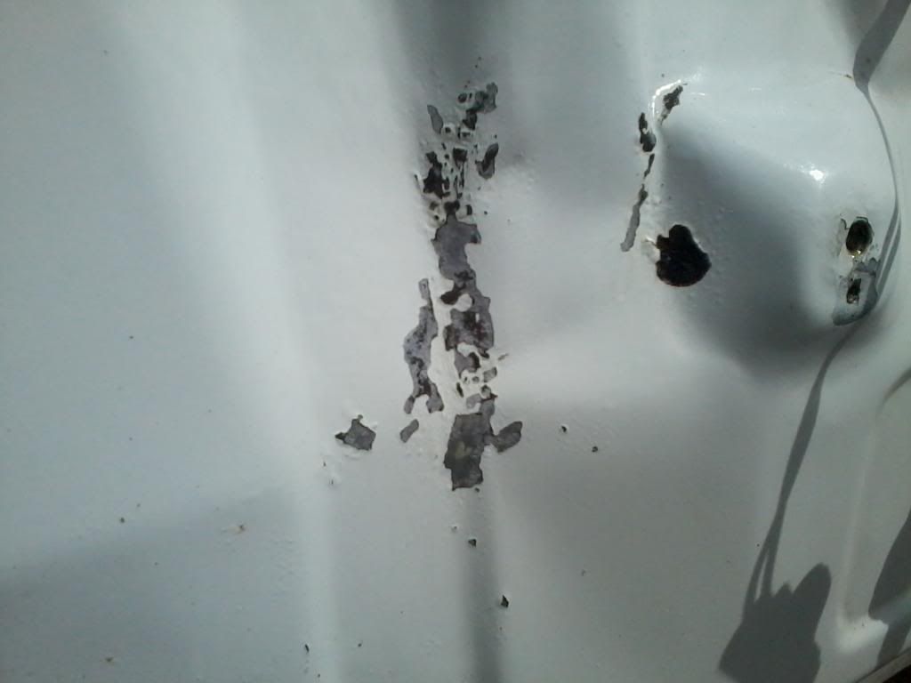

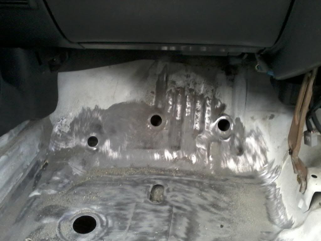

AdamB Posted July 29, 2013 Author Posted July 29, 2013 Did some more work on this today.I pulled the front carpet up the other day and gave it a good clean, but now I'm debating about even putting it back in, looks quality fully stripped When I removed the carpet I found this plate that had been tack welded to the slope on the way to the bulkhead on the drivers side. I've looked through some pics of other peoples stripped cars and haven't seen this before so this definitely OEM. Kinda got me thinking whys it there in the first palce though, I would associate with this part of the car getting rusty, although I did find some water sitting in the bottom floor skin, can't see it very well as it's full of dust but this is a cut out on the passenger side footwell. I then decided to re-route the fuel flap pull cable as it was under, over and through the tunnel looking quite messy, especially if I was going to leave the carpet out.Here is how it was before : And this is it re-reouted right the way through the tunnel Then carried on getting rid of the paint on the passenger side floor, nearly finished it. Suprising how quick it took but the paint is only thin so doesn't take much time to get off. Hope to finish off that side tomorrow then start on the drivers side, hopefully won't take too long either. Will then need to pull the dash out and do the bulkhead.Now on the lookout for a welder as well Quote
turbo Grant Posted July 29, 2013 Posted July 29, 2013 Looking good. I suspect the captive nut for the wish bone went. Plate put in for access Quote
AdamB Posted July 29, 2013 Author Posted July 29, 2013 Argh yes forgot about that issue, think you might be right there mate. I think I'll remove the plate just to check and make sure, then I'll weld in another nice new bit of material. Quote

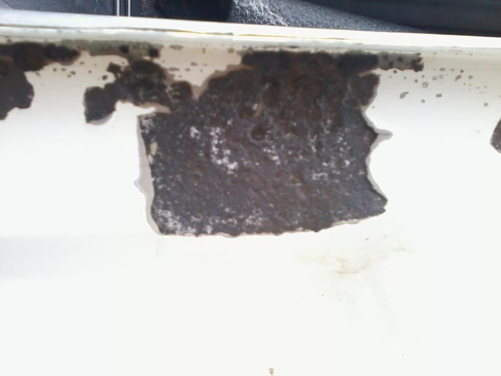

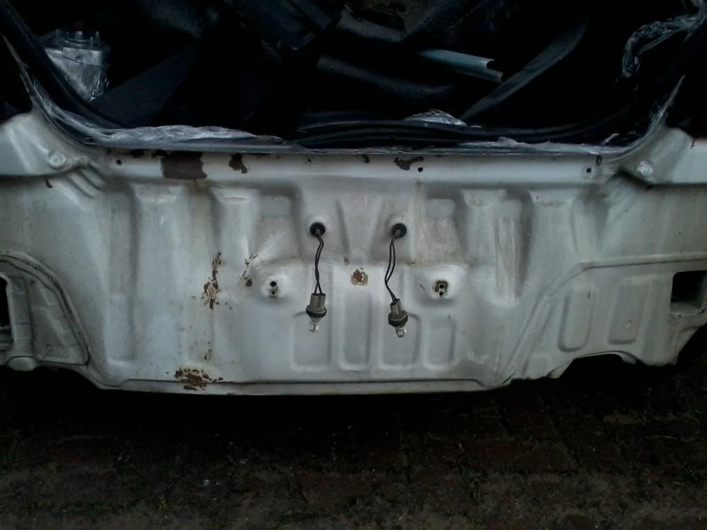

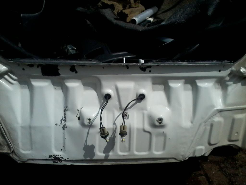

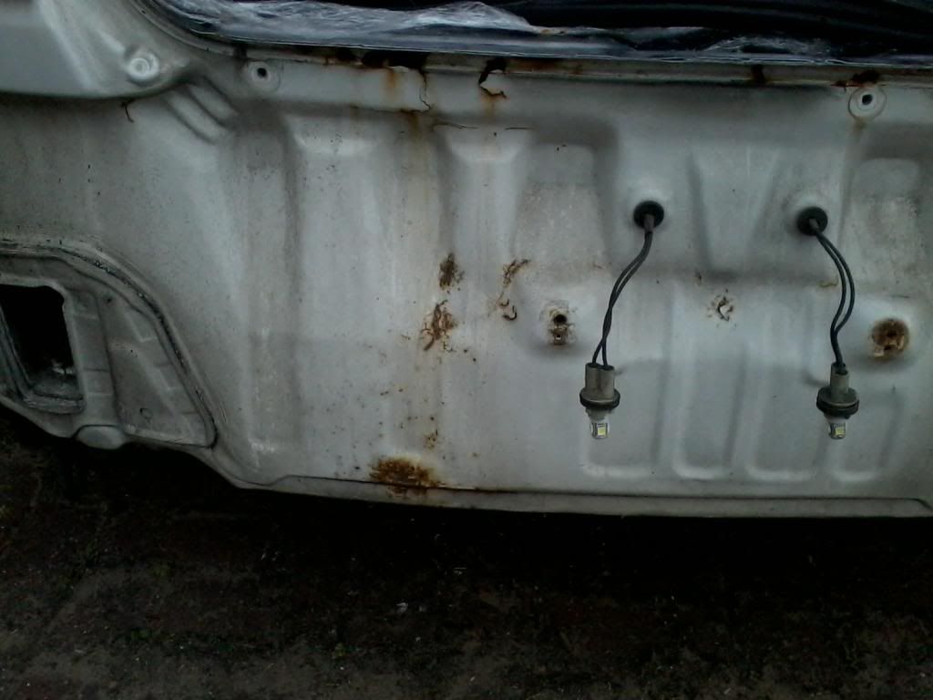

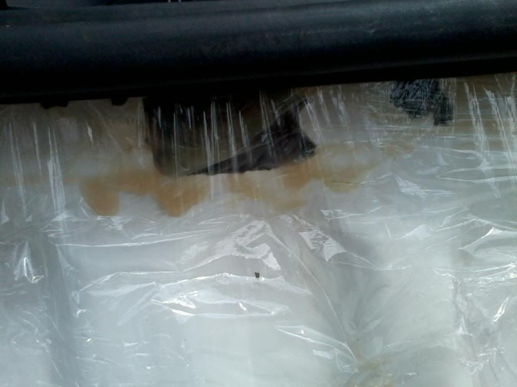

AdamB Posted August 3, 2013 Author Posted August 3, 2013 Recieved my Bilt Hamber products the other day Went and started my rust treatment process today, removed the rear bumper, wire brushed the rust and removed a lot of the dead material. Then I used a sanding block just to go over it and remove anymore small pieces. Before I touched anything this is what it looked like After a wire brush, sanding, degrease and a wash with got soapy water this is what it came out like. Then I pasted on the deox gel over the rust area's and covered with cling film to stop it drying out. Didn't get any pics of this as it just started to piss down with rain.Hope to go back out tomorrow and check it, probably do atleast another application then see how the rust is from there. Quote
AdamB Posted August 6, 2013 Author Posted August 6, 2013 Got round to applying my third coat of the gel today after leaving the previous coat for around 36 hours, this is how it came out after I washed the old coat off On the large section at the top, you can just see it's started to go back to bare metal where it's coming through in silver patches Applied a thick third coat and hoping this will be the last one to do, have wrapped it up again and will leave it for another 24-36 hours before removing. Have to say overall I'm very happy the way it's coming out, it's not exactly a quick process, although only taking around 20 mins to apply. That said I'm in no rush, but would recommend this stuff to anyone! Quote

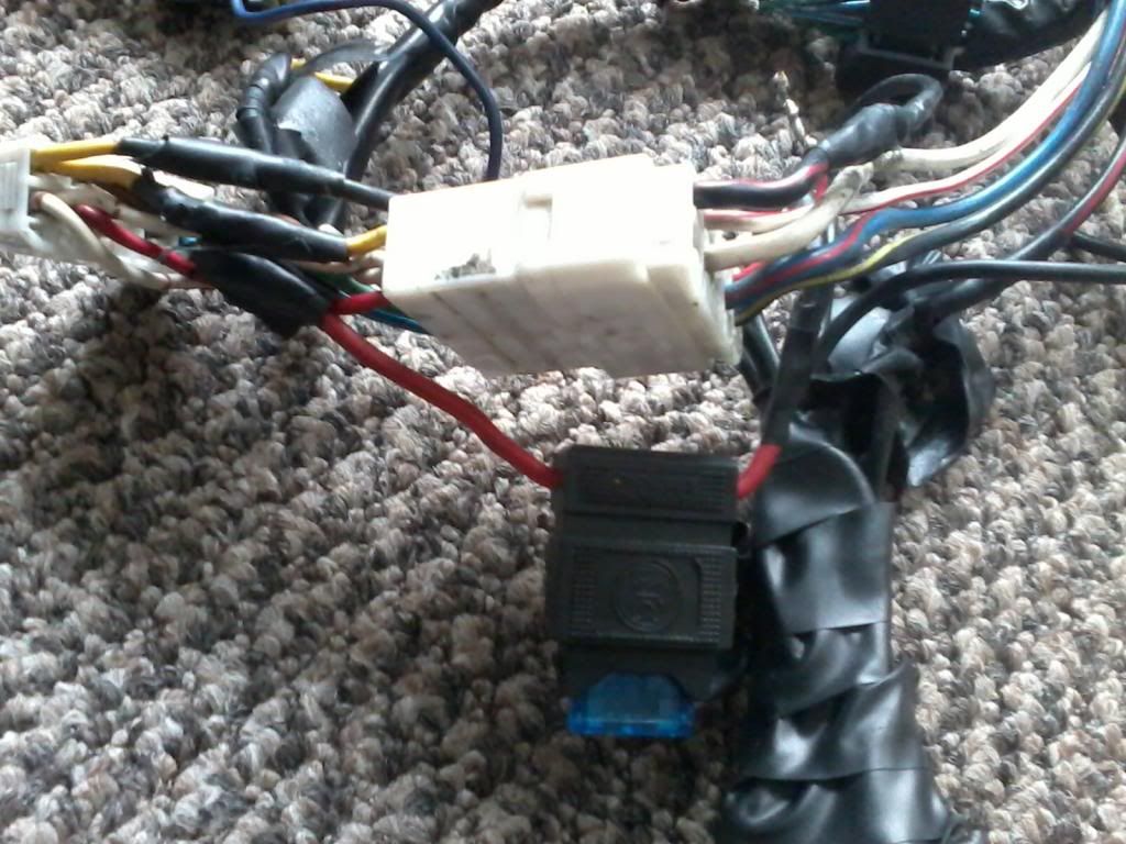

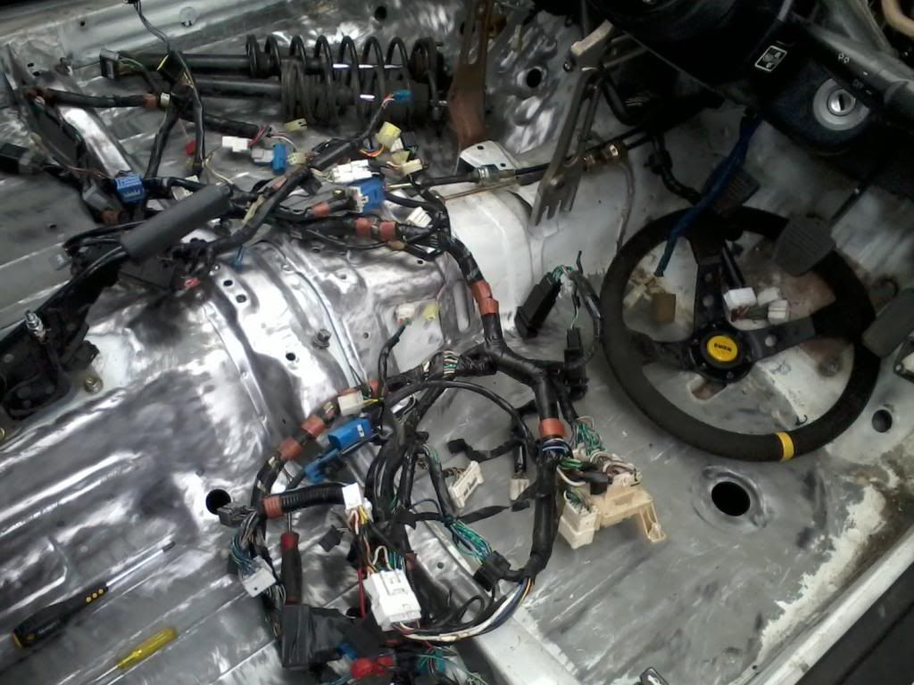

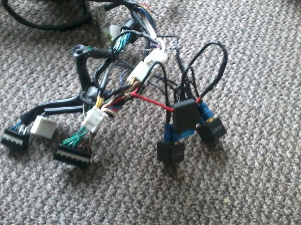

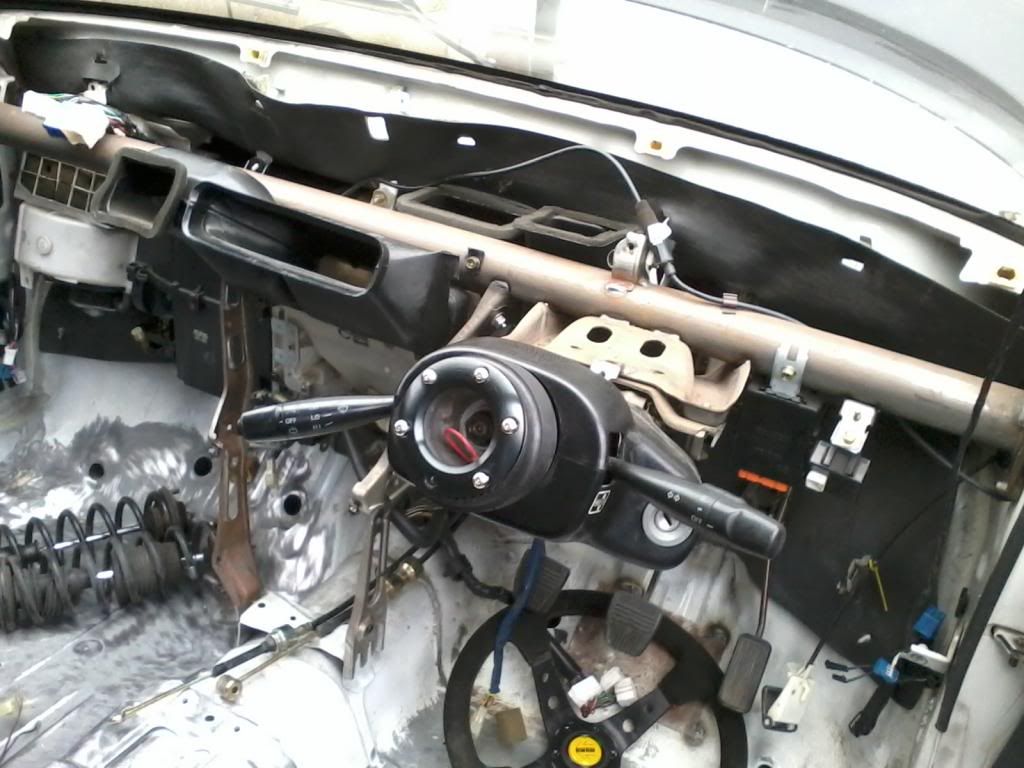

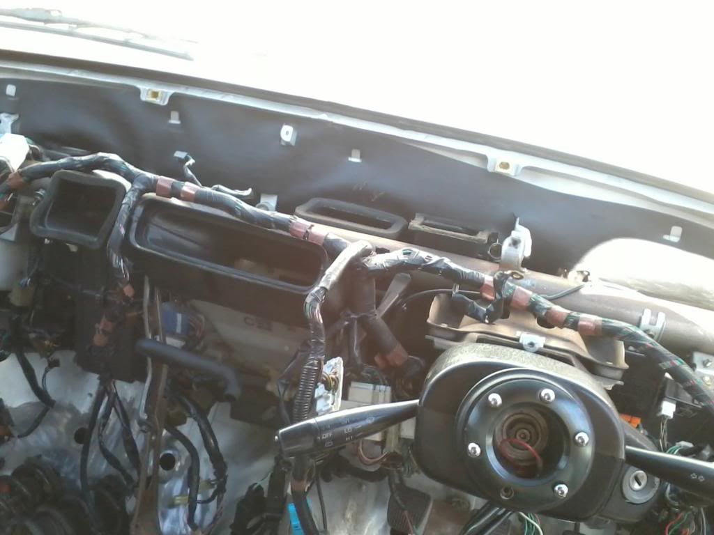

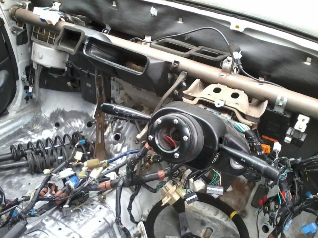

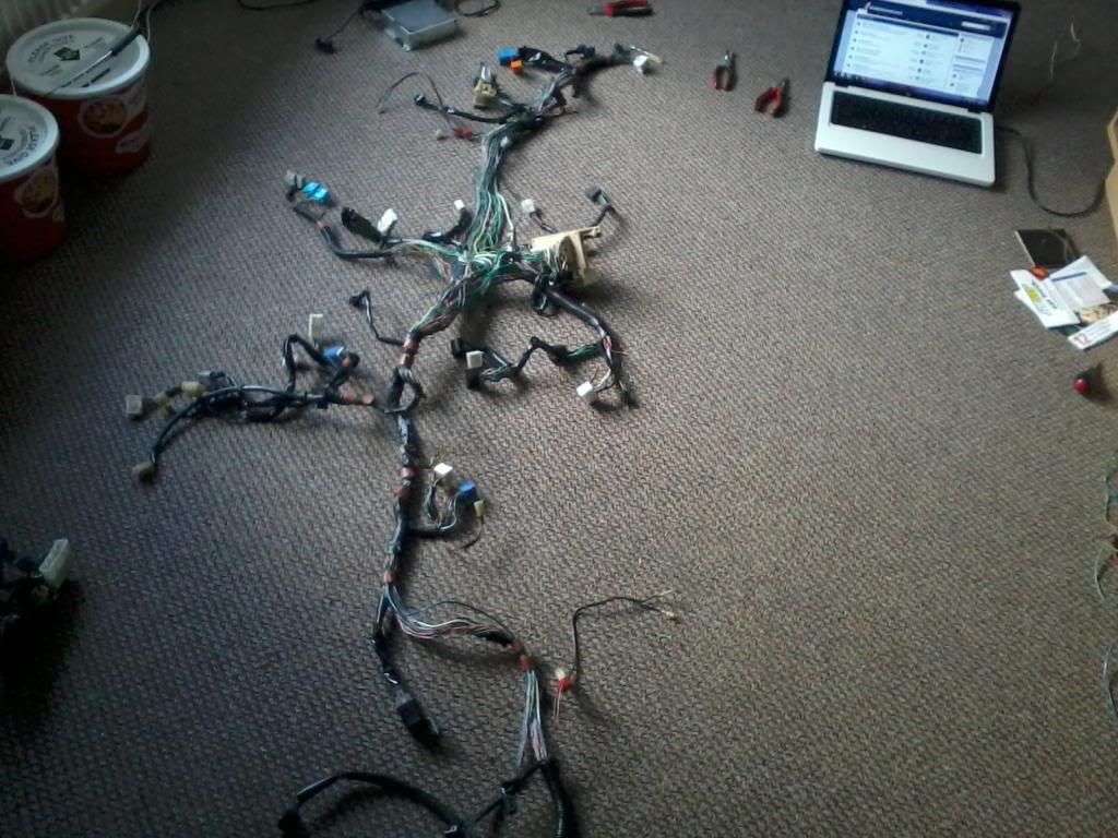

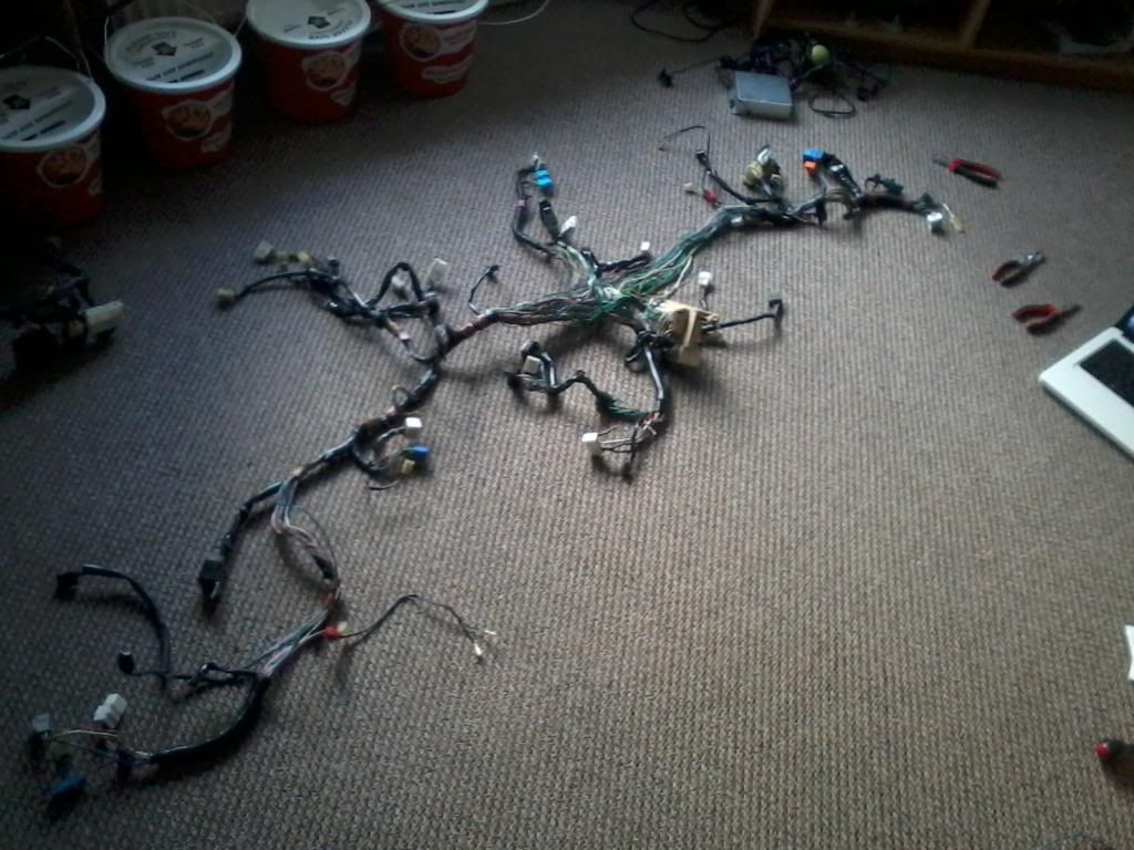

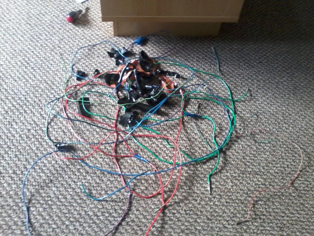

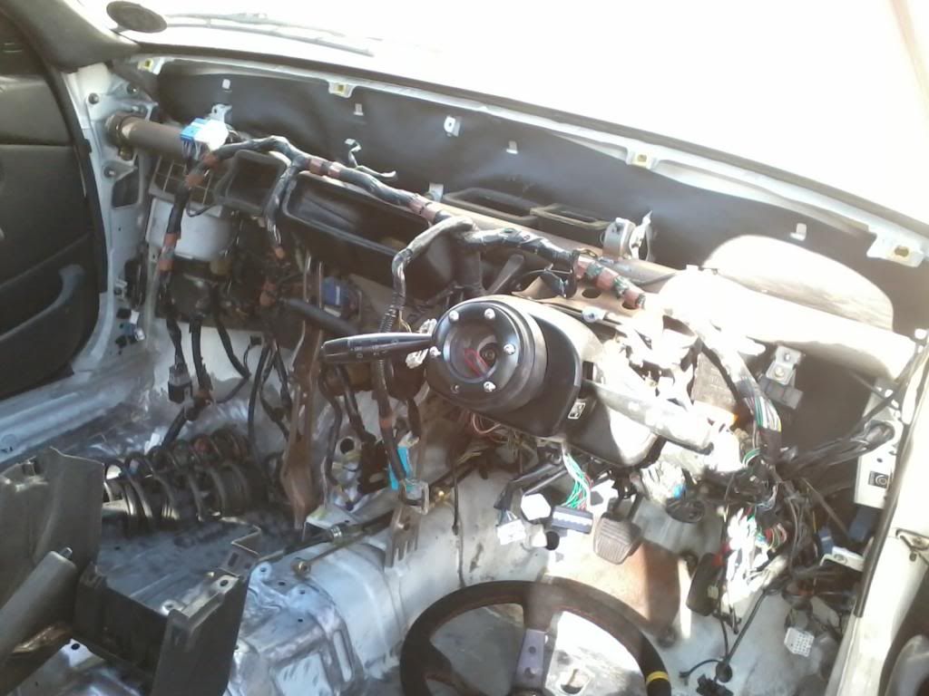

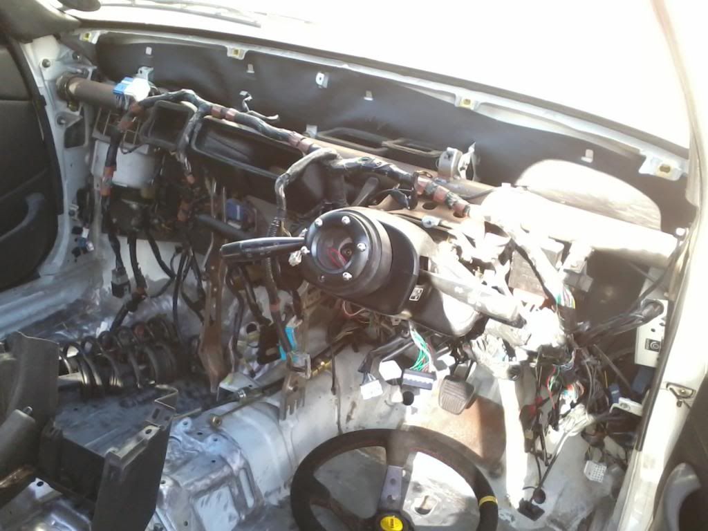

AdamB Posted September 27, 2013 Author Posted September 27, 2013 Not updated this for quite some time. Have been doing a fair bit over the last week. Finished off removing all the paint and sealant from the front of the car. Then I removed the dash and wiring loom Out comes the loom All out Started removing some bits from the dash loom, just a few loose wires nothing major. Also tidied up what I believe was from a turbo timer which was a right mess. Started out looking like this : And finally after removing all that gubbins looked like this : Still need to re-connect some of the wires but need some gas for my soldering iron first. Didn't end up removing too much really as I still wanted to keep it a road car, still kept the heaters, electric mirrors (which I was contemplating on getting rid of), and keeping the electric windows. If I could find some windy windows then I would get rid of that as well but they are pretty hard to come by. Also just started removing bits from the engine loom as well so should have an update for that over the weekend I hope Quote

AdamB Posted September 27, 2013 Author Posted September 27, 2013 Haha no worries boss Thanks to your offer I've just removed all this savage project adam some work goin into it all the same thats some turbo you have there the size of it ha and good job on fixing up the body too lookin forward to more updates Thanks mate! Turbo's plenty big enough for my needs, although its not what I want to run anymore. Still got plenty more to do on the body, I'm awaiting delivery of my welder until I can finish it off, which will hopefully be about 2 weeks time. This is how my dash loom is now finished, just need to wrap it back up Quote
