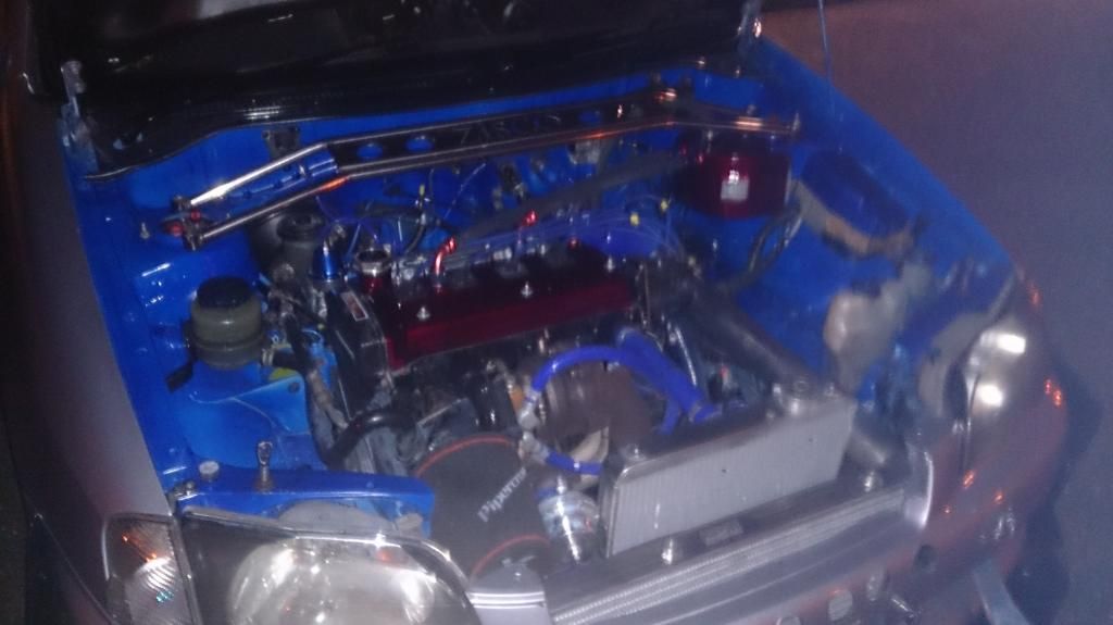

Bussey Posted March 18, 2014 Posted March 18, 2014 Gheeeeez that looks angry!!! Top work mate ! Quote

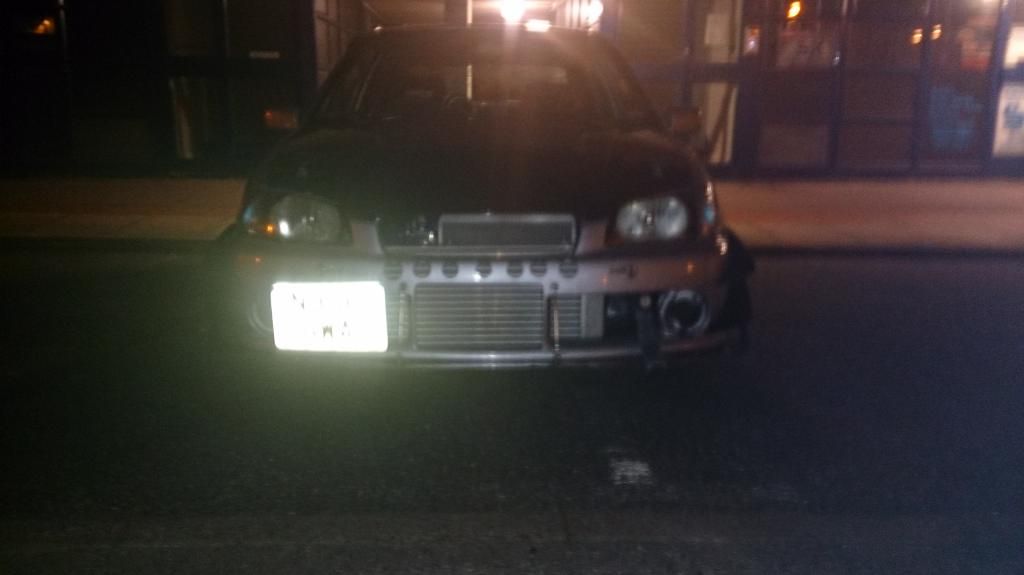

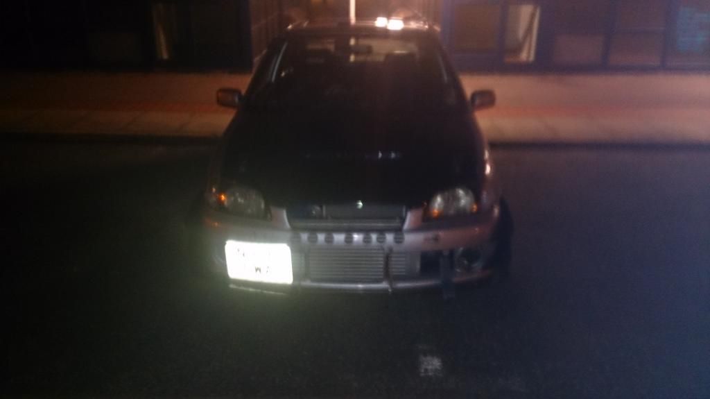

nikhilkamdar12 Posted March 19, 2014 Posted March 19, 2014 (edited) What do you have to do to be able to cut out the top panel and strengthen it?? and where to get it done? Cheers Edited March 19, 2014 by nikhilkamdar12 Quote
jayc-glanza17 Posted March 19, 2014 Author Posted March 19, 2014 cut it where I have, making sure you route the wires onto bottom crash bar.. then to strengthen have intercooler brackets welded underneath to act as a joining point. Quote
nikhilkamdar12 Posted March 19, 2014 Posted March 19, 2014 okay wicked also one more thing how the hell do you keep your radiator upright and not being flimsy? Quote
jayc-glanza17 Posted March 19, 2014 Author Posted March 19, 2014 again ive welded brackets onto bottom crash bar.. once the rad is bolted onto these brackets its solid.. the unions on op of rad, were created in case needed extra support but luckily I don't. Quote

Malcolm GT Posted March 21, 2014 Posted March 21, 2014 Looking good mate, inter cooler is hhuuuuuuggggggeeeeee Quote

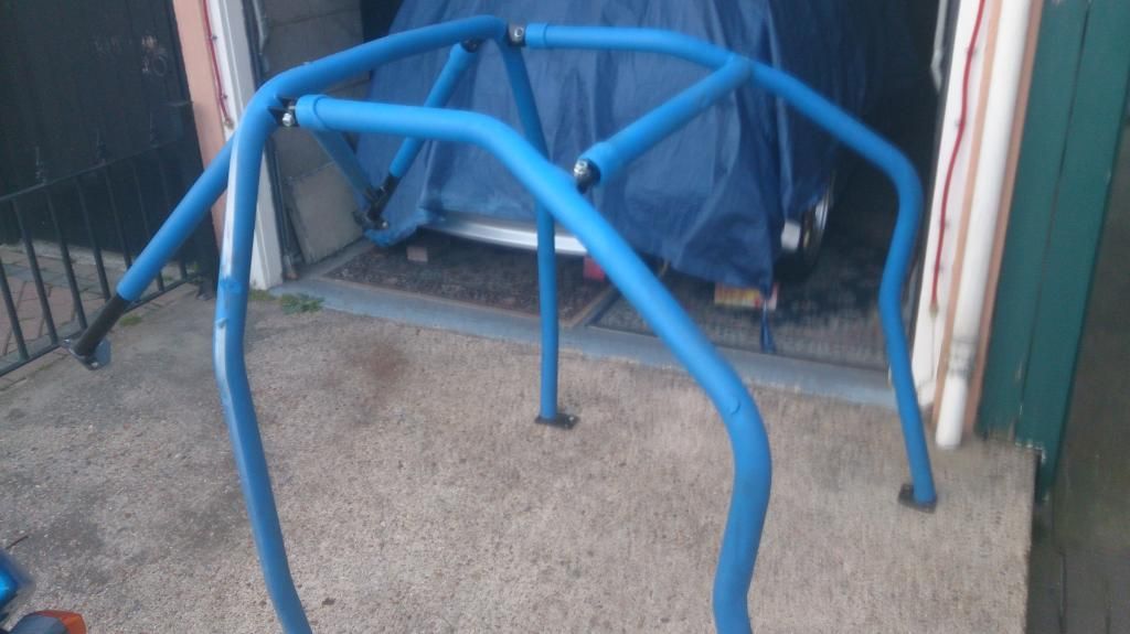

jayc-glanza17 Posted April 21, 2014 Author Posted April 21, 2014 haven't updated for a while.. basically my cage arrived from Iddy, but haven't had time to install it yet due to work/ family commitments heres a few pics of it put together outside garage.. I have sorted my inconsistent voltage issues. just simply topped battery up with distilled water and re did all earthing points (took ages) but at least I know its done.. cars running very nice now.. Also went to a jap meet with Russ78.. few engine bay pics.. Exterior shots Quote

jayc-glanza17 Posted May 6, 2014 Author Posted May 6, 2014 roll cage is in, footplates last bit of welding will be done thursday.. im not showing pictures just yet, as you guys can come and have a look on sat at japfest. Quote
