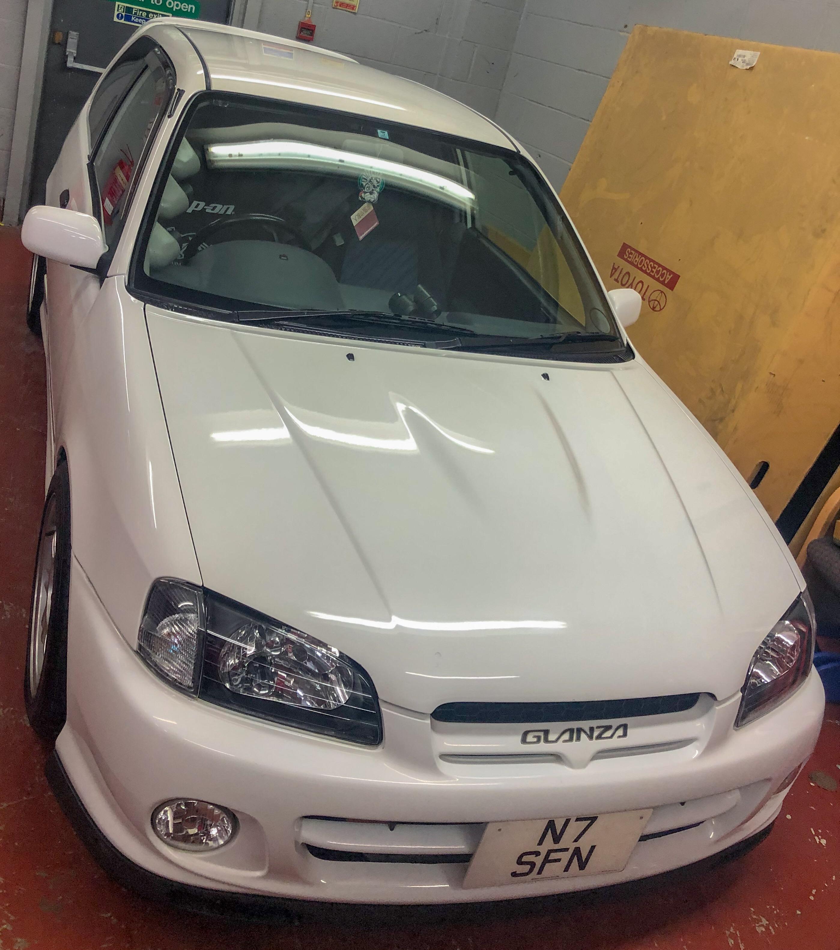

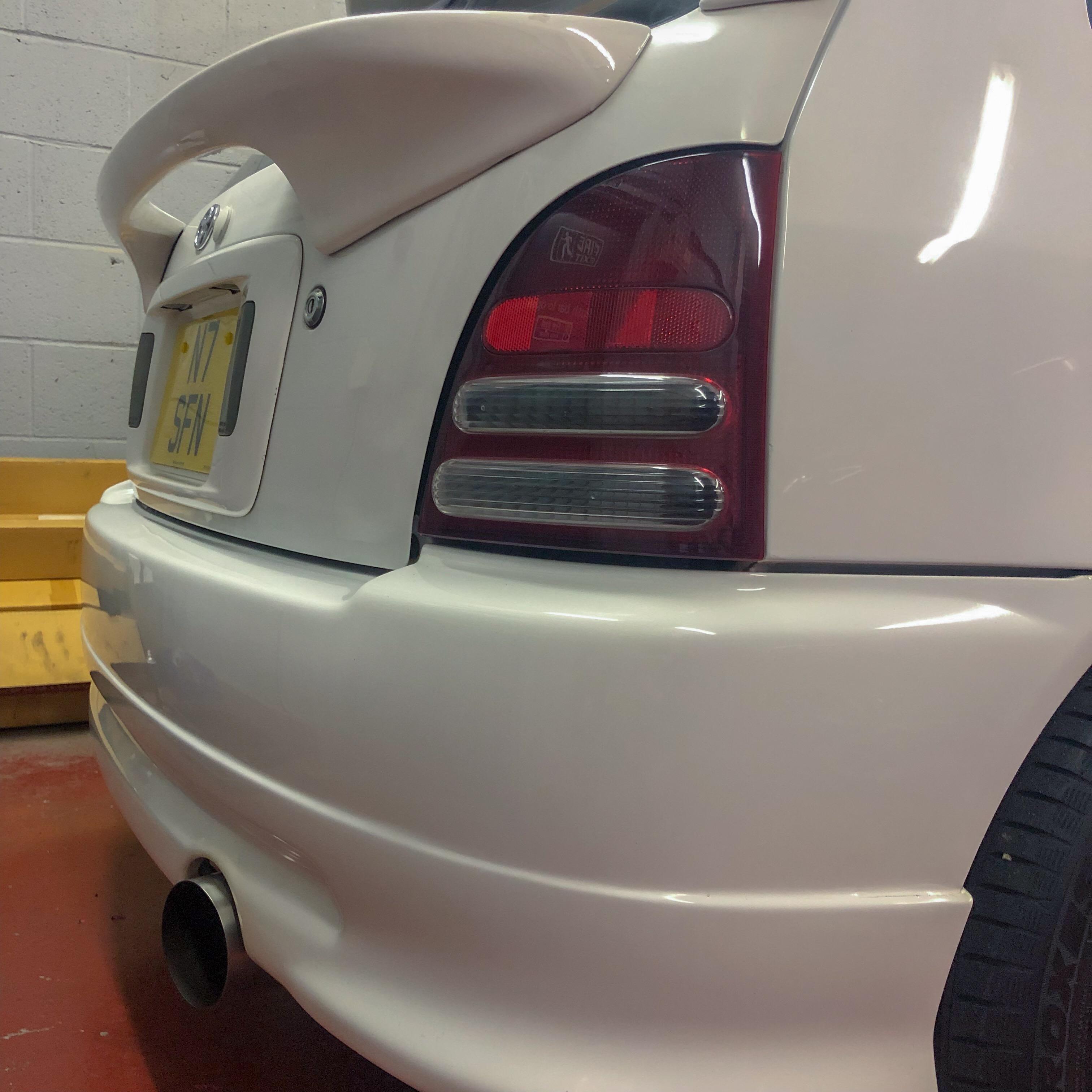

So I’ve collected the car from speedfab, I can honestly say the work gone into it is isane. I’ll get some proper photos over the course of this week and I’ll post them.
On 3/5/2019 at 10:13 PM, RobSR said:
Look forward to seeing it :)
If I’m completely honest I was hoping for abit more angle but maybe that’s just me being picky & I know once I’m boosting about I’ll forget all about it :lol: photo will be Saturday unfortunately as that’s the only opportunity I’m going to get!

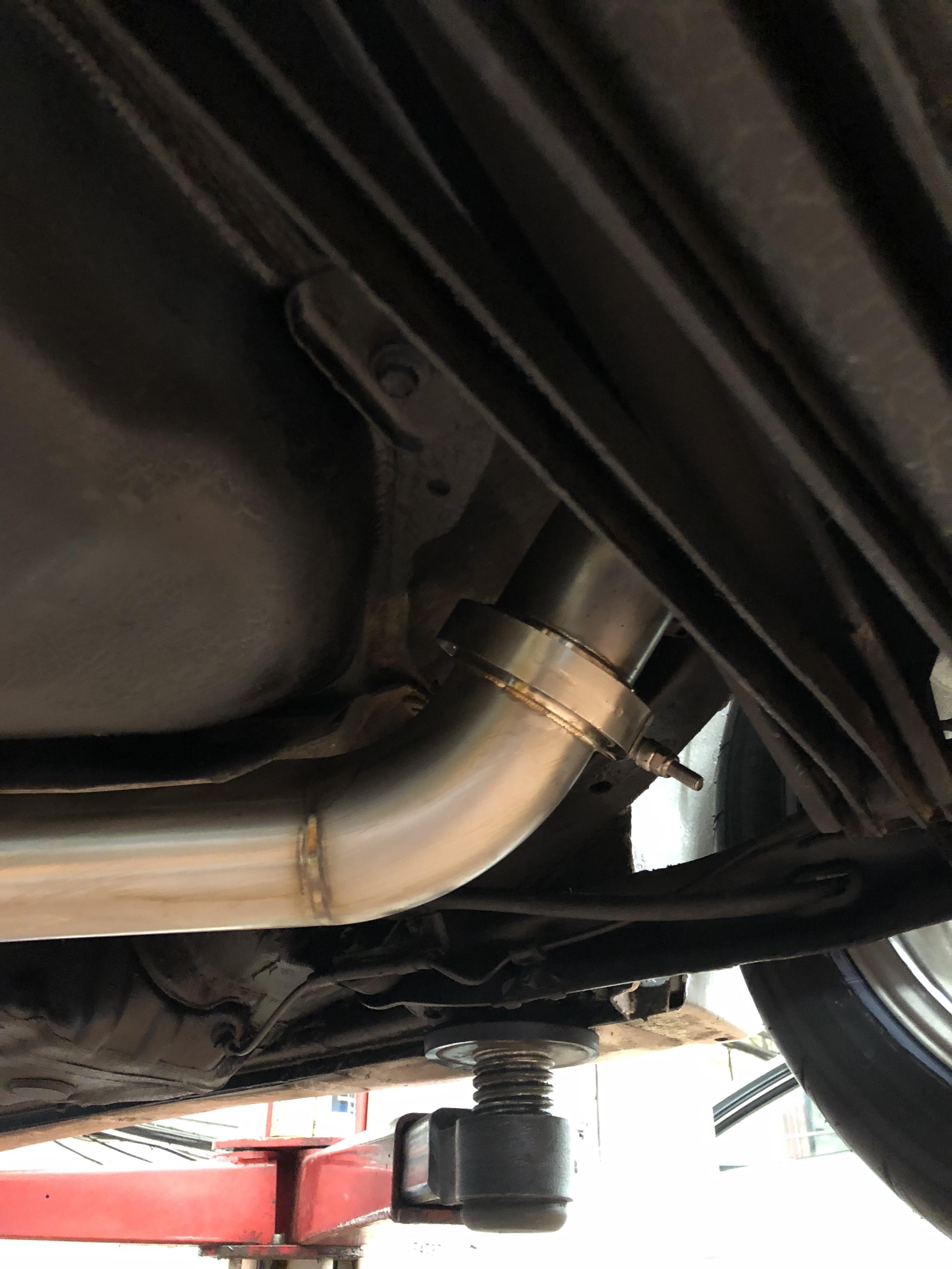

Just a small update, heres a small teaser of the exhaust!
I apologise for the dirt, the one day I actually have to drive my car and it’s raining! <_<

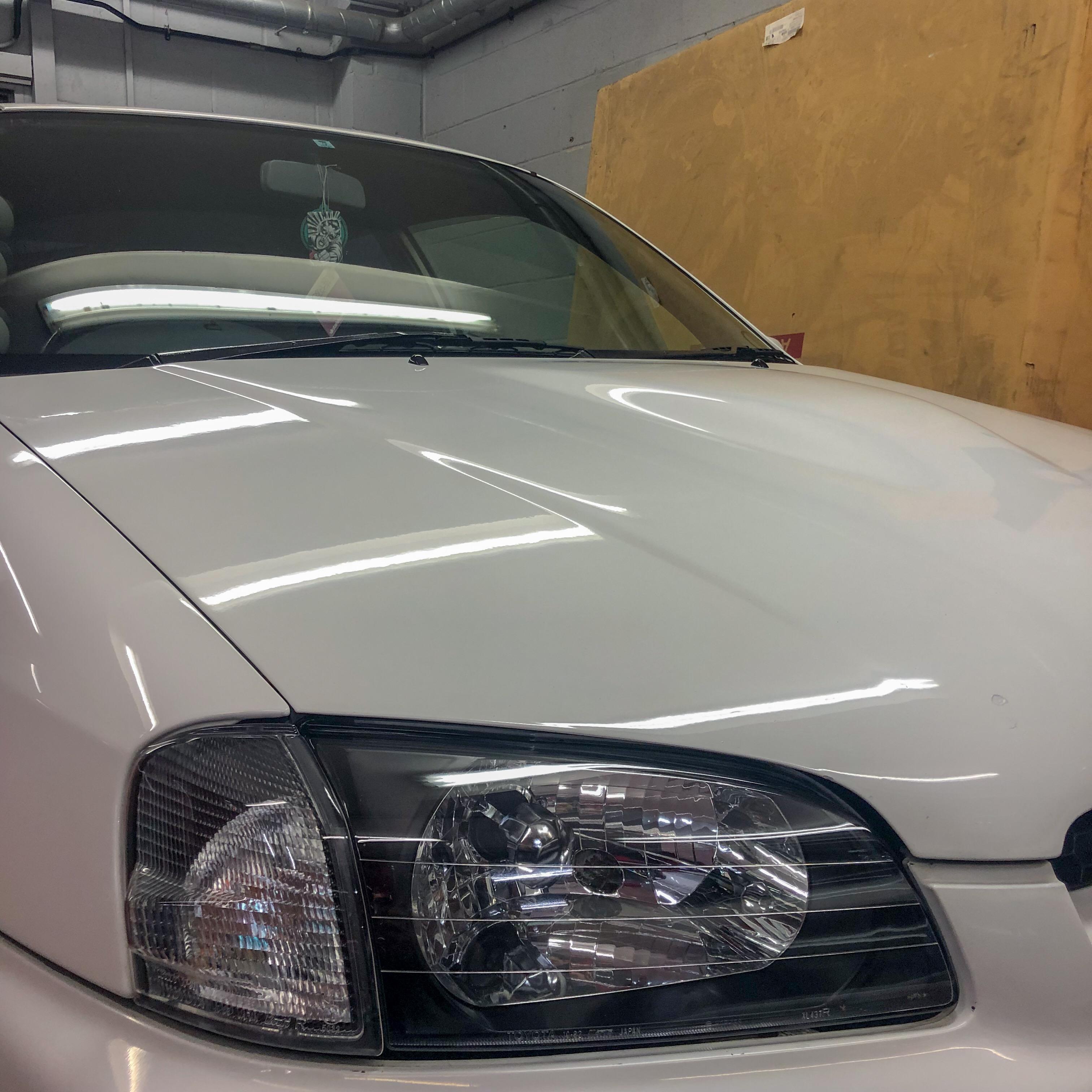

So because of the rain I decided to give her another once over.
F03C3F03-9167-4213-ADB7-DF5E695B476F.thumb.jpeg.14a869681b27b95b5f0df08af9d66c81.jpeg1FA0257F-9118-4B44-9C53-EF644E606C4E.thumb.jpeg.09bdac684f94e8e4a9fad9a75060cf07.jpeg98617CB6-78E0-45C6-AD6D-6AD19DAC24BB.thumb.jpeg.f5bf4c9515d3da8c0d9f647fd924f960.jpeg
She’s shining now :thumbsup:

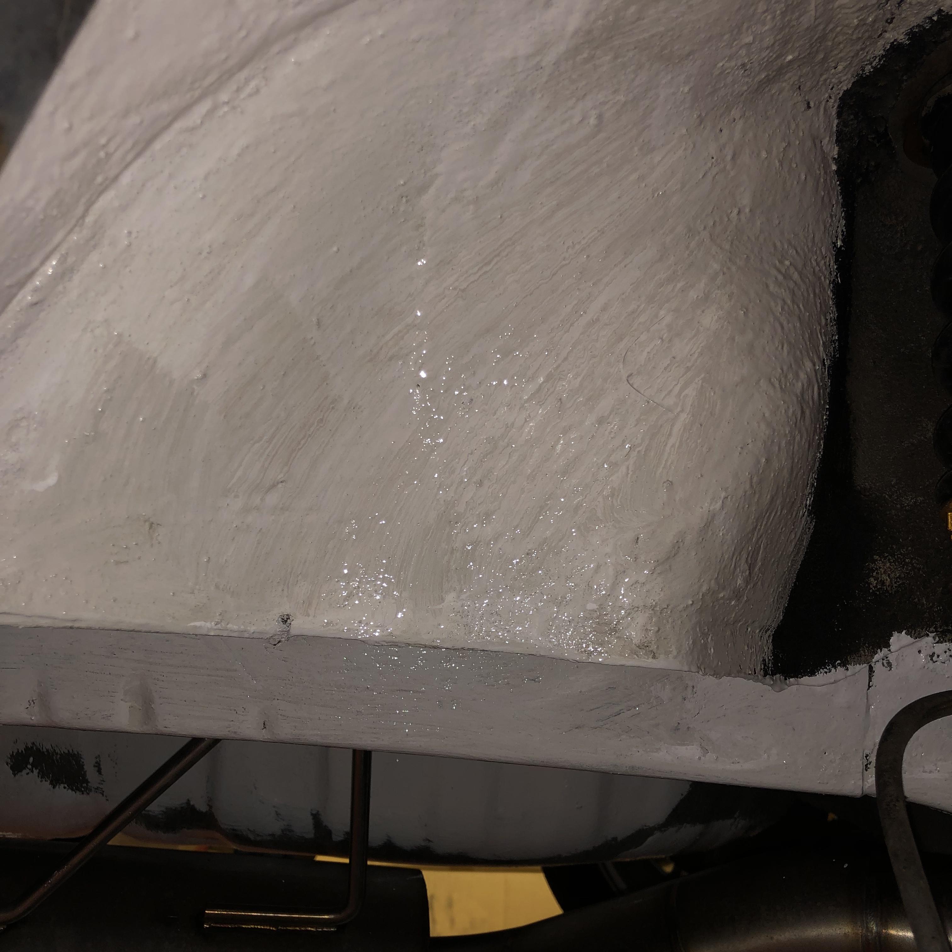

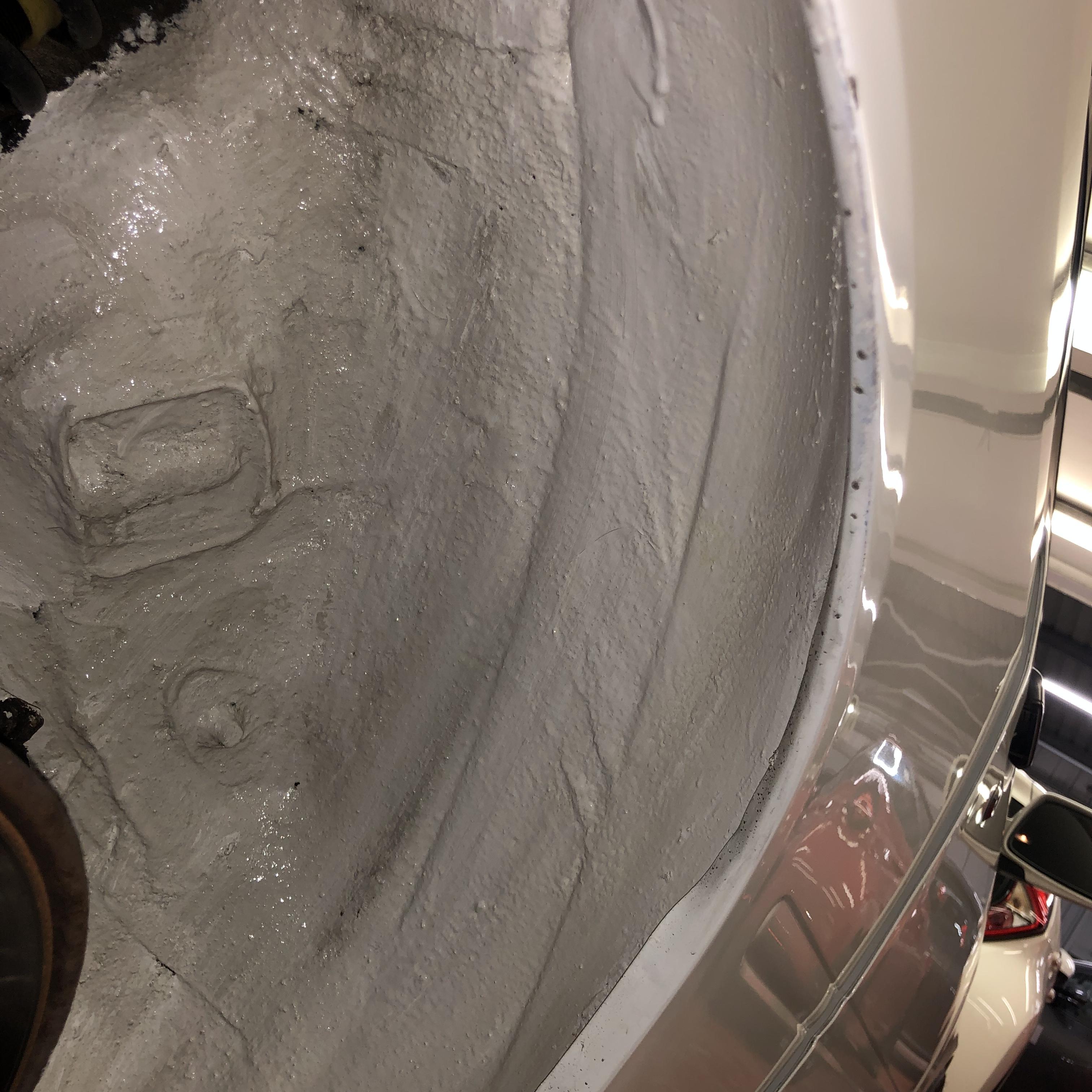

Made a start on the cleaning and hammerite underneath! Anyone planning on doing this, take my advice! Don’t do it! It’s an extremely messy job and requires lots of prep, if I’m honest I wish I never started!
As you will see from the photos, the whole under side (body) will go smooth white, the rear axle, fuel tank, wishbones and all the other bits will go Satin black.
8981B8D2-9A4C-46C7-AE38-1E3B9BB98B71.thumb.jpeg.e9c91928c53cdaed22f3c802af111cb7.jpegA9F89E66-7E96-457F-8F34-09C3A4A1ED75.thumb.jpeg.92615bfd2b99e57cf66f7f8995b58f5e.jpegB992A05C-8193-496B-BE1F-6F94BDE2CE45.thumb.jpeg.8ab8c2ff210f224c1eecc4f451a0a616.jpeg
I plan to get the car up on the ramp to do all the final bits to make it easier and I also plan on dropping the suspension after mapping to get round the back of the coilovers and also over the top of the exhaust.

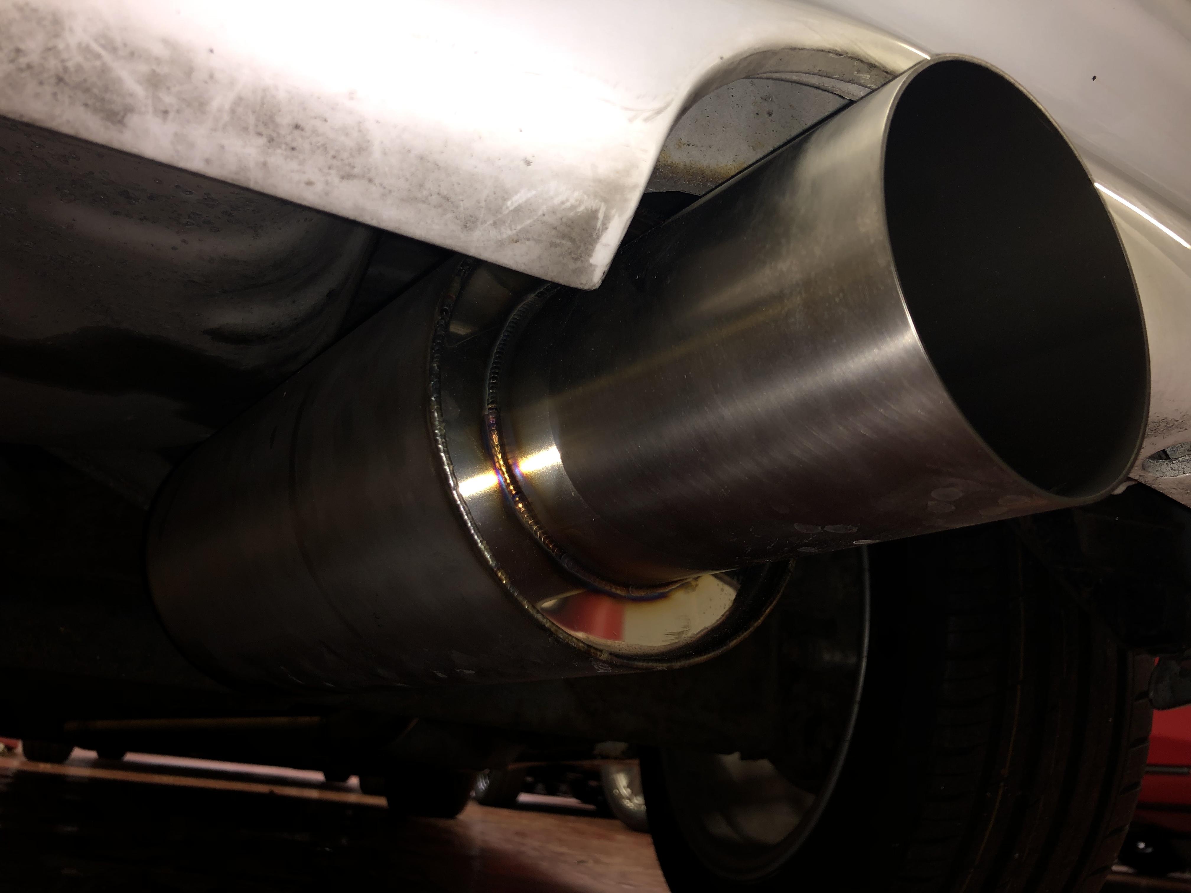

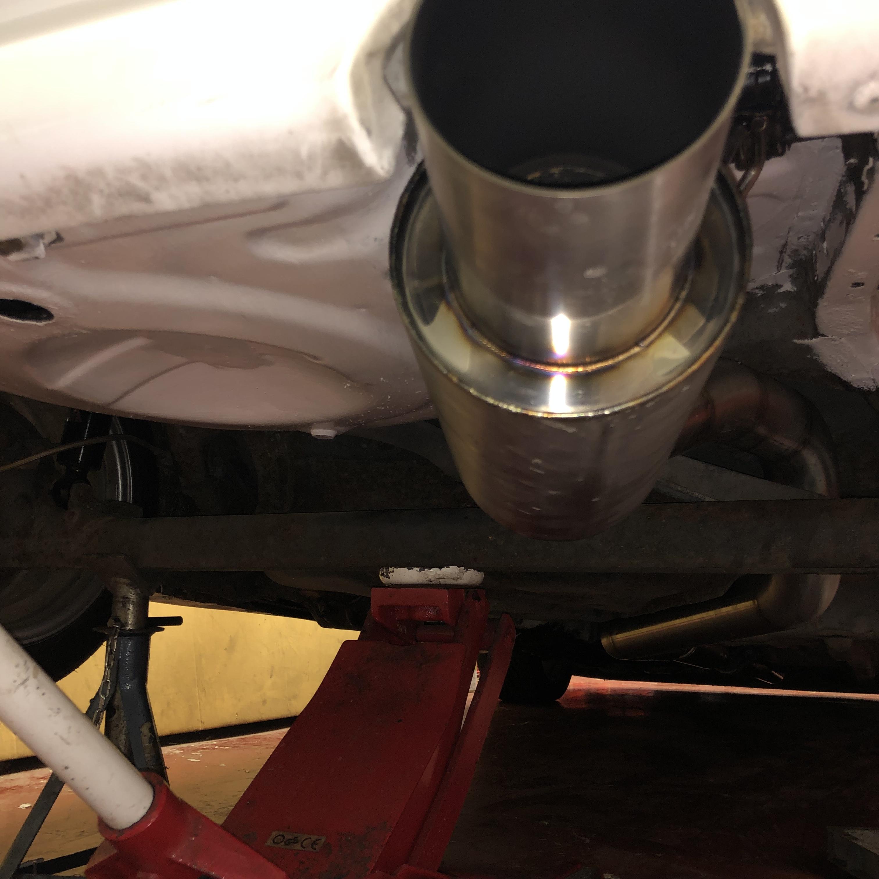

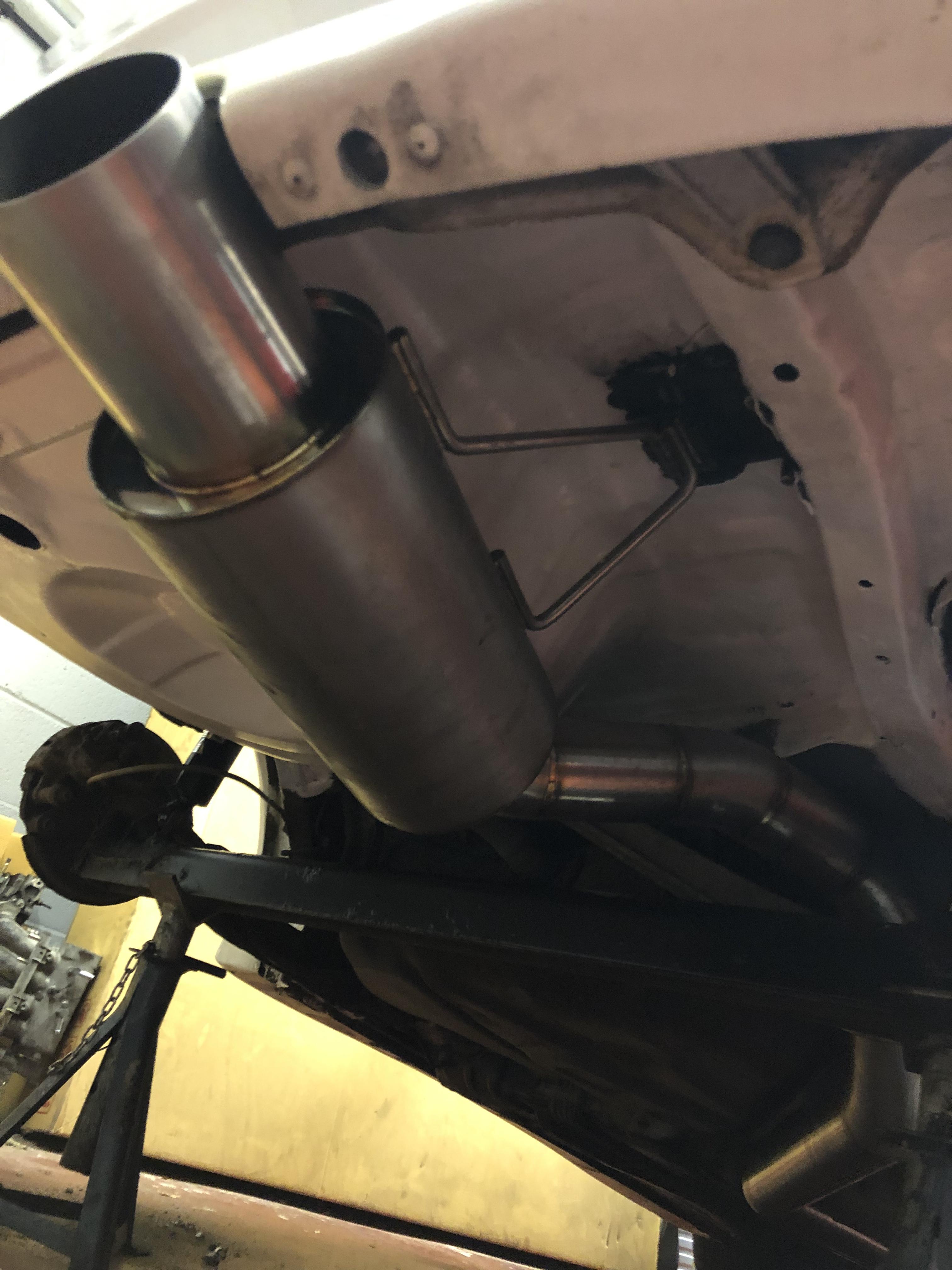

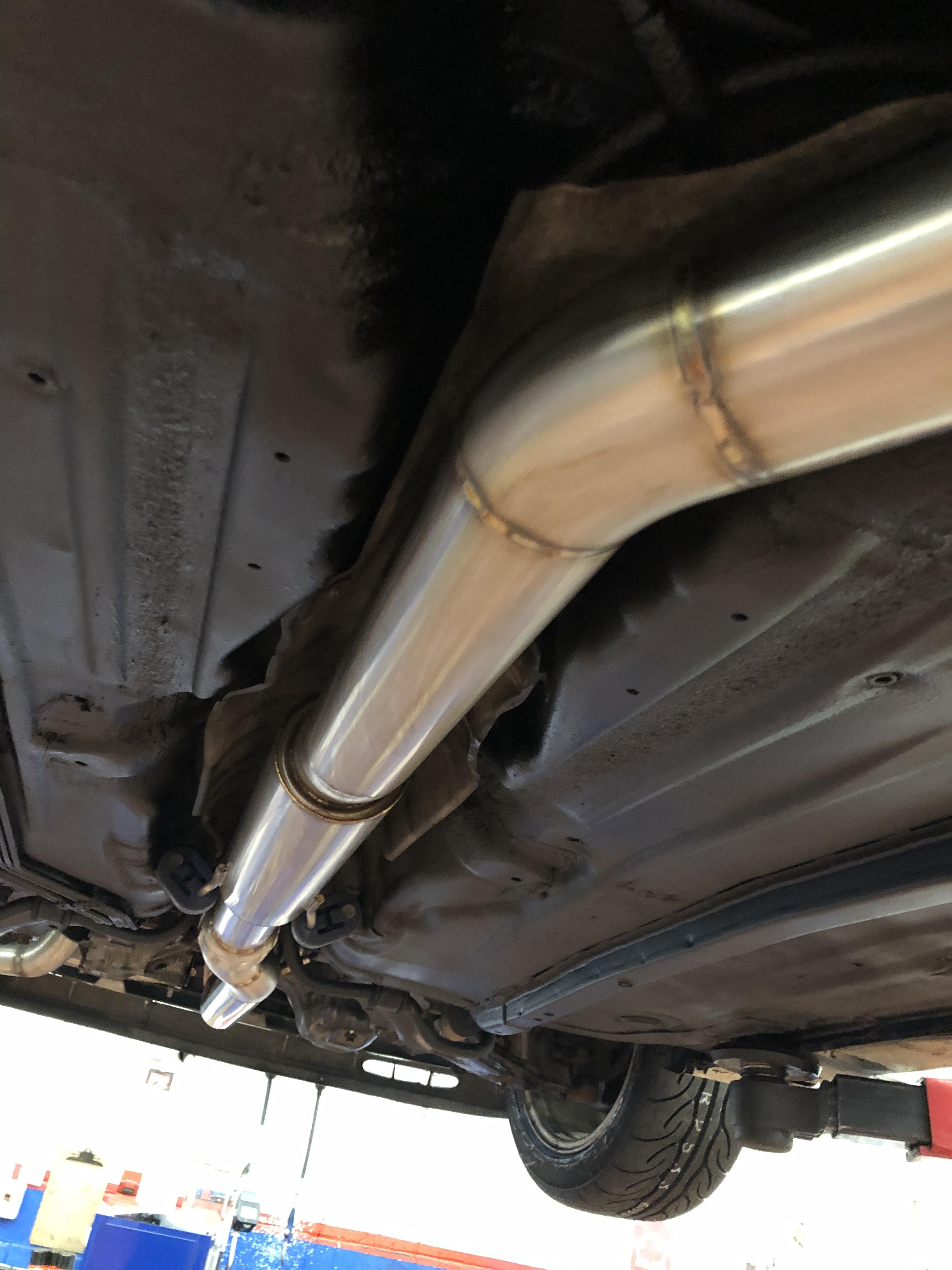

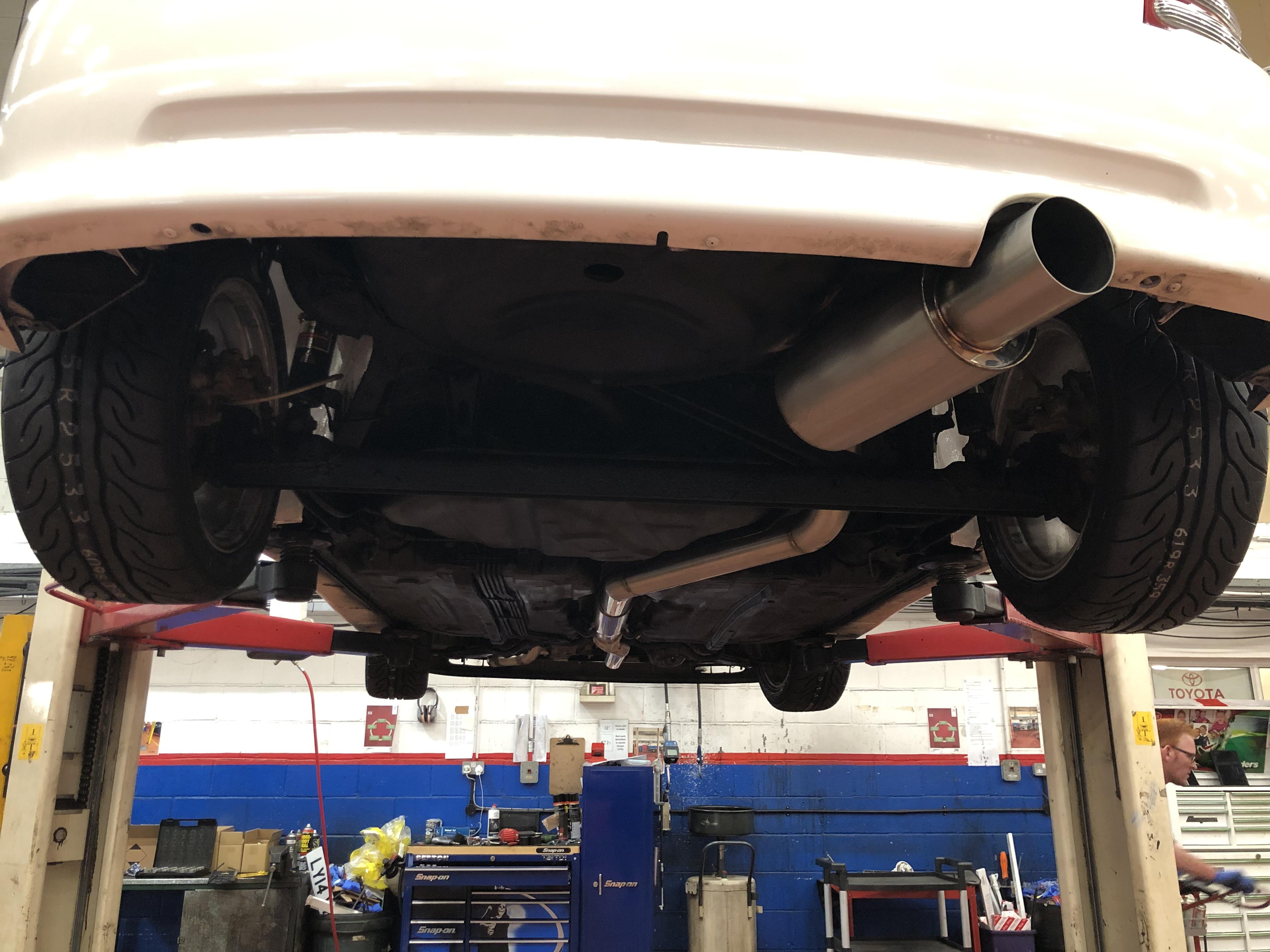

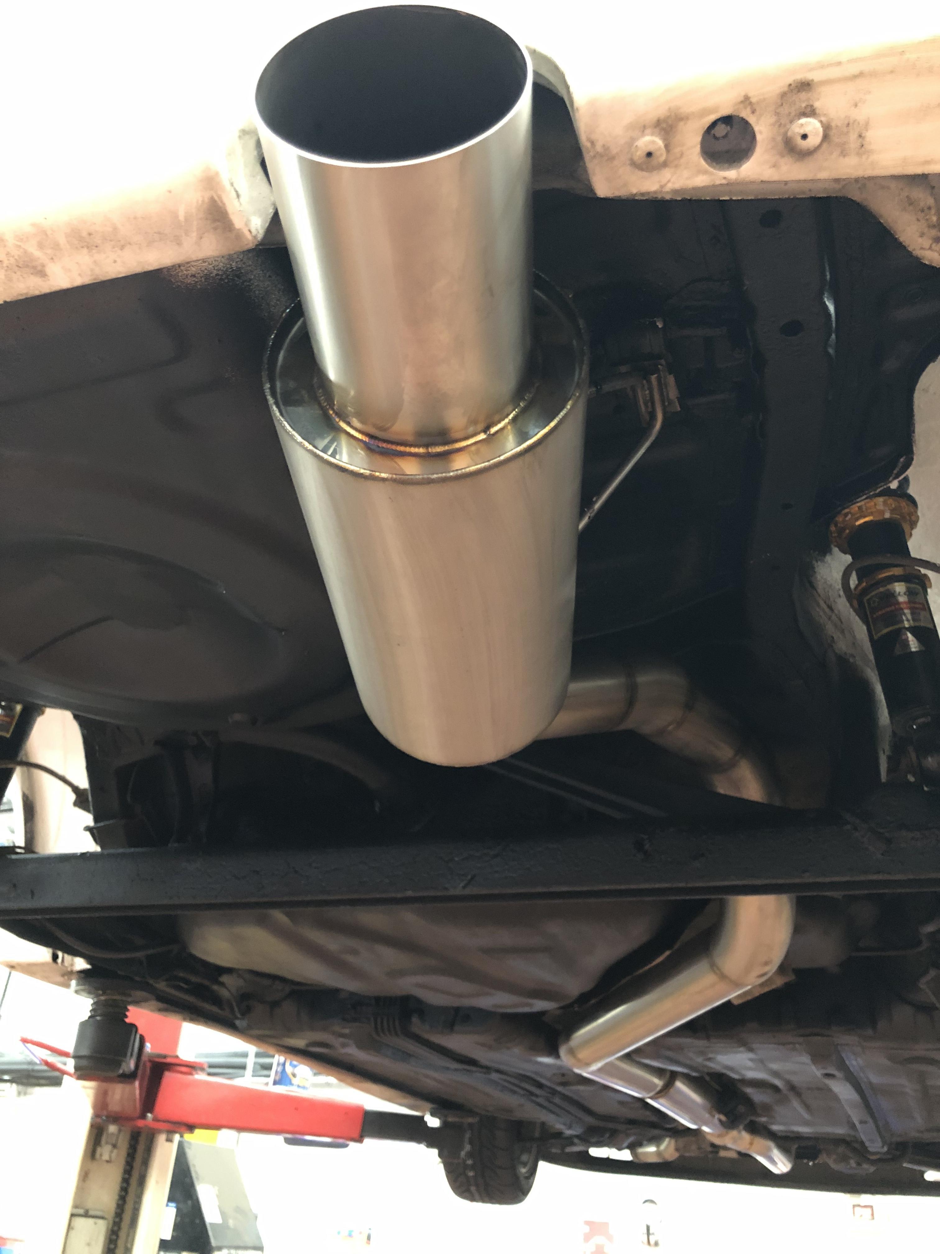

So at the moment this is the best photo I have of the exhaust, I’m still in the process of doing the hammerite underneath the car but this is where is have left it until Saturday morning. It’s has a few coats now, I’ve even started on the black bits and I must say when it dries it looks far better than it did, as said before, it’s pretty clean underneath but in the long run this will only protect it more :thumbsup:
So today I planned on getting the car finished underneath but if I’m honest it didn’t really do to plan, painting underneath was turning out to be a much bigger task than originally anticipated so I decided to ditch that idea and just under seal it, i left the arches white as I quite like them as it looks much cleaner.
I also managed to get some photos of the exhaust.

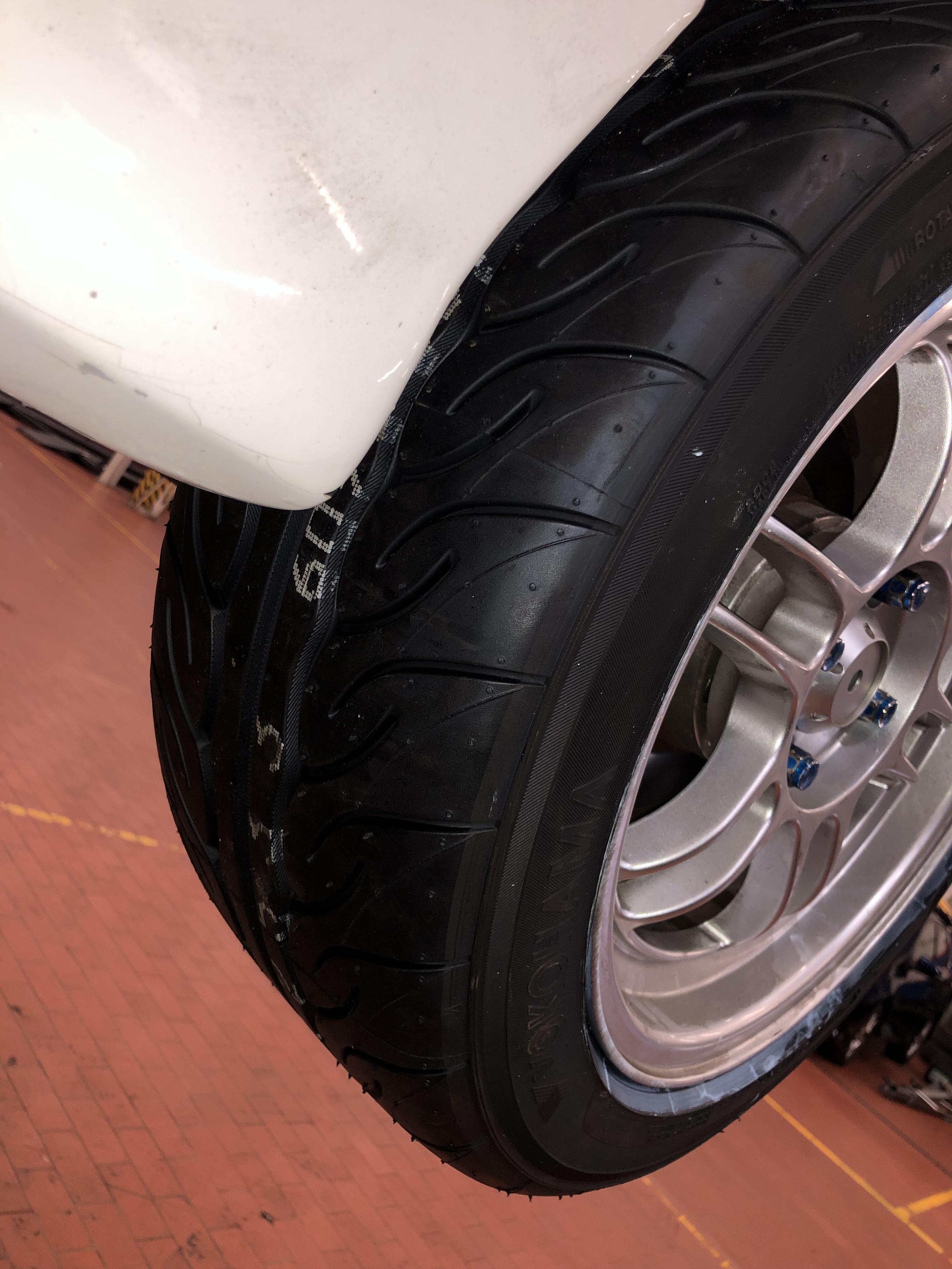

I also got my AD08R’s fitted so all in all a pretty productive day although not exactly how I planned.

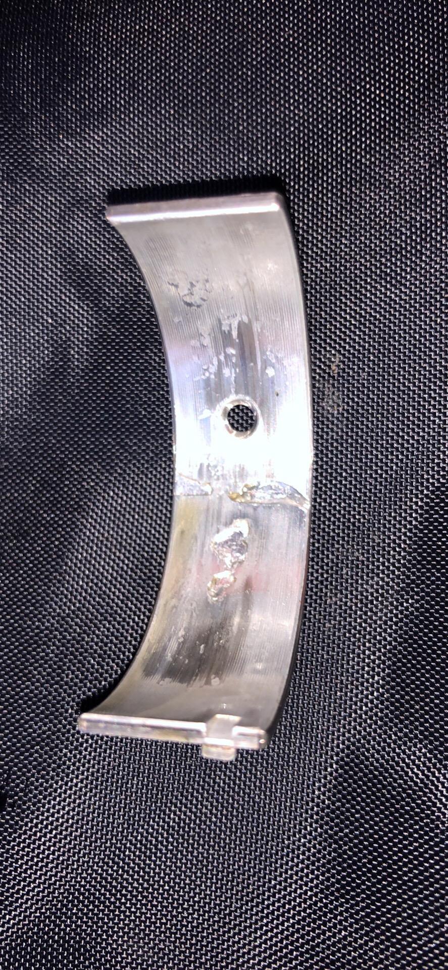

Car was then driven into the workshop for some extra work to be carried out, son after the technician working on the car called me over and told me the oil pressure light was on, I had a look at truth behold it was, after raising the car on the ramp it soon became clear that I had a MAJOR oil leak, it was very hard to determine where it was coming from as it was soaked, we drained what oil was left in the sump and we only managed to get around 200ml from it which unfortunately unveiled a nasty surprise, metallic oil! To cut a long story short, I got the car recovered home, I’ve found the oil leak which is down to the remote oil feed line for my oil pressure sender unit for my gauge and also the oil pressure switch. I’ve also stripped the sump off and taken the the main caps off and the big end caps, the main bearings are perfect but unfortunately I can’t say the same for the big end shells.
luckily the crankshaft is unmarked, so I’m a very lucky man. I’ve got the following ready to go back together.
ACL big end bearings (Thanks to rob fisher again).
ARP Main cap bolts.
ARP Con rod bolts.
Racing lines remote oil line.
while it’s apart I’ve cleaned out the oil strainer and also stripped and cleaned the oil pressure relief valve.
I’ve also given the sump a good clean and painted it on the outside to clean it up abit, I’ve also got new genuine sump bolts for it from work so everything is as it should be just because a few were odd, I plan on flushing all the oil lines out before it goes back together and running a thin oil through it to flush the engine out aswell.
Hopefully should have everything built back up and running by the end of the weekend, then the mapping will be rebooked and hopefully this time I’ll get on the dyno! :thumbsup:
Damn that sucks. Maybe worth getting a new oil pressure relief valve whilst its stripped. People tend to overlook these on a built motor considering they are over 20 years old and play a vital role in keeping your engine healthy
As said was very sorry to hear this mate after the last min efforts that went in to get it ready for the dyno!
Glad you caught it before anything else too serious got damaged.
You can space the oil relief valve slightly too when you put it back in.
