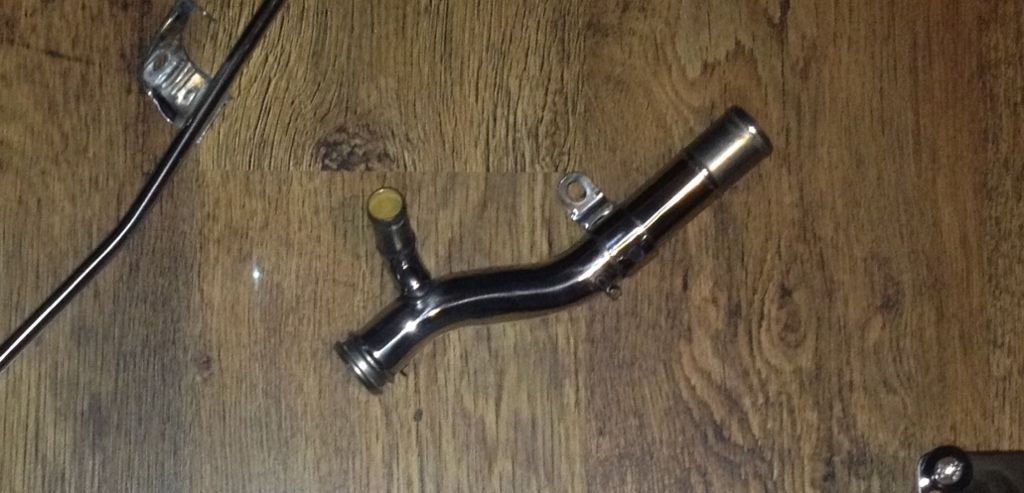

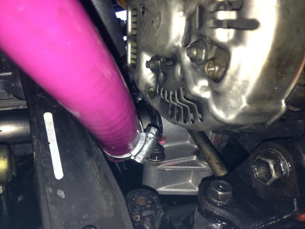

iamlegend Posted June 22, 2013 Author Posted June 22, 2013 (edited) I'd imagine the silicone hoses are holding the metal pipe in place, remove the silicone ones and completely remove the metal one.Them replace the O-ring, push the metal pipe back in, replace 10mm bolt (use loctite if your paranoid about losing it again) then reconnect the silicone hoses job done. mate there was a little 10mm bolt in place right next to it so dunno which one you mean can see the black bolt there right near the metal clip holding the hose on? Edited June 22, 2013 by iamlegend Quote
Lew91 Posted June 22, 2013 Posted June 22, 2013 That's the one, the seal could have been pinched when it was installed then and it's finally given up just bad luck it happened where it did. Do the process above and it'll be fine. Iddy should be able to sort you out with a new seal if not ask mike I'm sure he'll sort one out for you. Quote
Lew91 Posted June 22, 2013 Posted June 22, 2013 That's just a housing bolt, hang on I'll get a better pic. Quote
Lew91 Posted June 22, 2013 Posted June 22, 2013 The bolt will be in the bracket after the second bend in the pipe, it should have been bolted to the block. Quote
iamlegend Posted June 22, 2013 Author Posted June 22, 2013 so the case of taking that off? fit new rubber ring seal then attatch but again theres nothing bolt to secure it back in... so by the looks of it td have not put the bracket on? hmmmmm great Quote

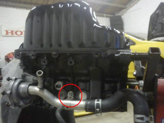

Ryan-11 Posted June 22, 2013 Posted June 22, 2013 should look like this (obviously the engine is upside down) http://s236.photobucket.com/user/RyanMcCluskey/media/glanza/DSC00250.jpg.html'> Quote
Lew91 Posted June 22, 2013 Posted June 22, 2013 ^^ that pic will explain it better. I thought the bracket was tacked on, could be wrong tho. Best bet is to just take it off and find out what is and isn't there for now. It has to come off any way. Quote
TurboTobz Posted June 22, 2013 Posted June 22, 2013 Look at the second pic I've uploaded it shows the bracket horizontally sat just as the picture ends on the left Quote

ryan lang Posted June 23, 2013 Posted June 23, 2013 How it should look, the right way up, with the bolt and bracket smack bang in the middle of the blockIf that little 10mm isn't there, I'd expect TD to fix it for free Quote
iamlegend Posted June 23, 2013 Author Posted June 23, 2013 (edited) think I kno who said it but will leave it at that shall we!! they look like the mug thow considering nothing bad was said! if they read it properly!! was not my intentions to say anything bad as you can see at the begging of the thread"" NOT POINTING FINGERS AT ANY ONE!!"" cheers lads yea am gutted to say the least... straight away thought for the worst..understandable? was on a dual carriage way meaning couldnt look in the bay for hours hence when went home found the leak straight away.. was lucky my car wasnt a write off due to the plonkers not seeing I was at a stand still so many people nearly wiped my car of the road lol TD are recovering it and having a look!! gonna leave it at that and should be boosting again! socks from what I can see that bracket aint there its flopping about all over the place... may of came loose? hmm Edited June 23, 2013 by iamlegend Quote
