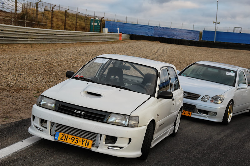

had some fun doing a short time attack circuit at the dutch toyo challenge. lots of mr2's, supra's, celica's etc. and a little old starlet that took home the 2nd prize :D
couple of vids:
klik 2nd place Toyo Challenge 2010
klik my wife running her time attack for the very first time ever

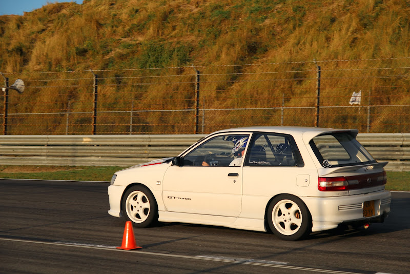

and finally a few shots of my new hobby :) dragracing!
my wife making her runs (she still has a faster time than me! no fair! by just 0.05 seconds)
waiting to start the race :)
go baby go! :)
best run sofar with my ct9a 1 bar setup on street tires is a 14.4 @ 158km/h
