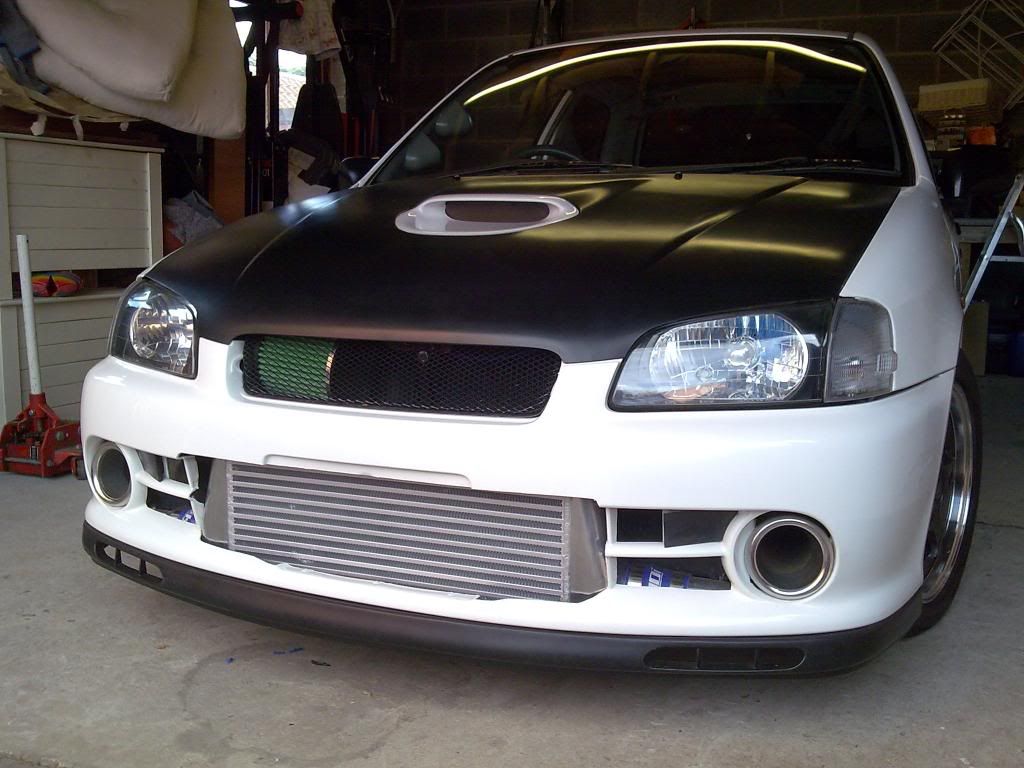

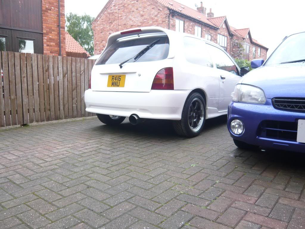

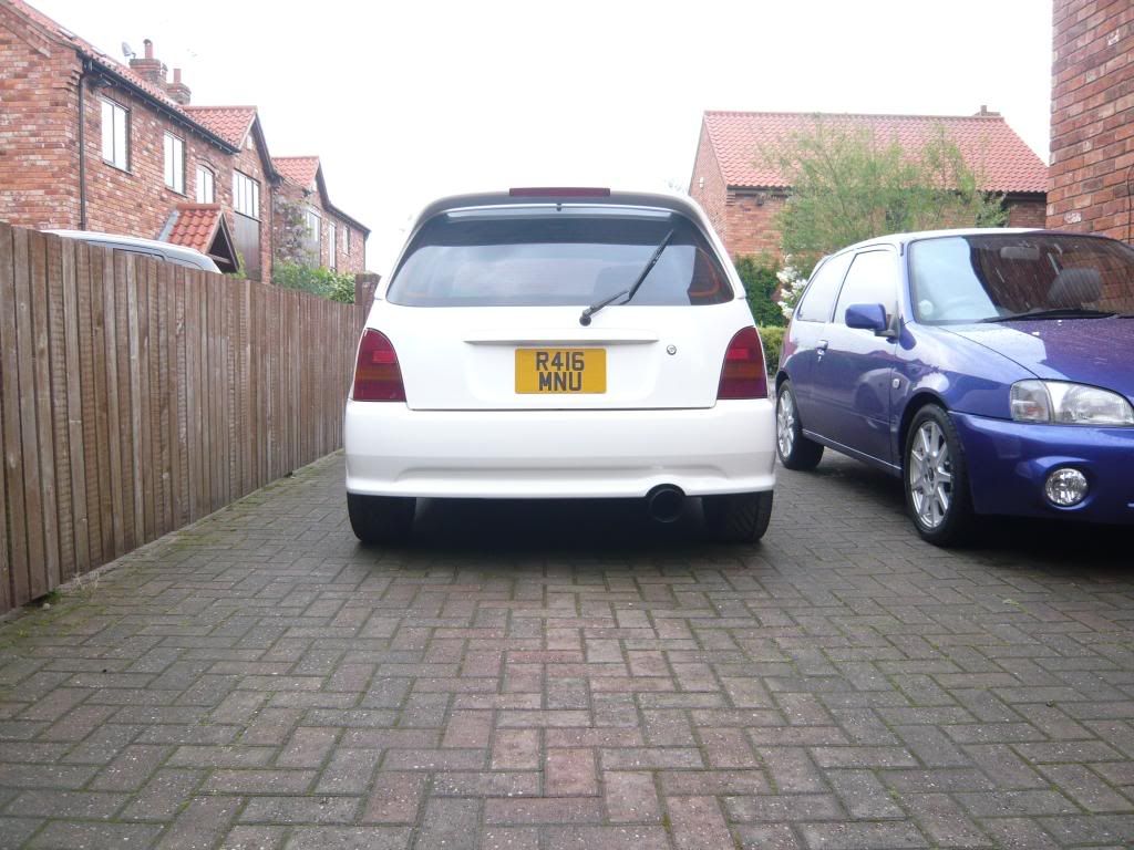

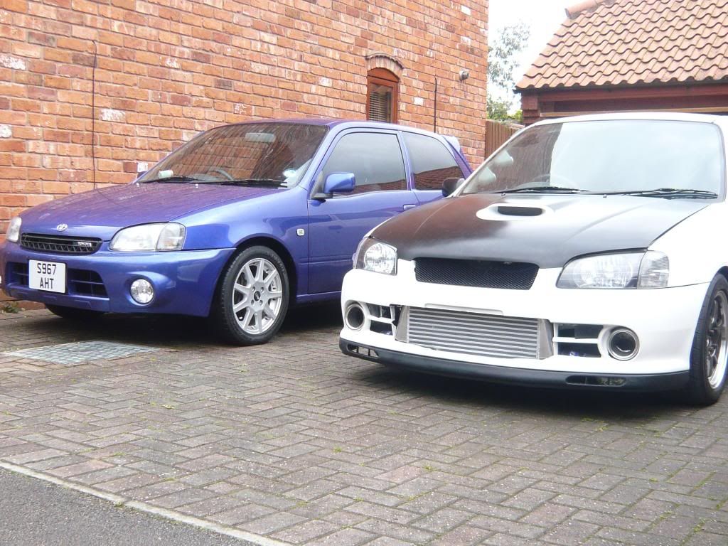

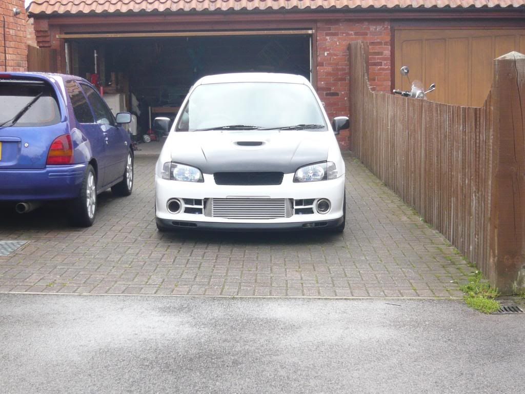

200sx-Starlet-Jay Posted May 18, 2009 Author Posted May 18, 2009 hi all,rite foto bucket is back up and running... so heres a few pics of progress the new exhaust... not a huge fan but will do for time being. 2.5 inch diametre, no silencers other than a small back box..... and heres the front bumper that everyone was hoping i wudnt do lol... i realy like it, it looks so much meaner in person. pics dont do it justice! the bonnet needs adjusting still and the latch is not attached so it doesnt look closed properly before u say anything!hope ya like it... if not.. ger it darn ya!think i have sorted all sensors now so hopefuly may get it started up by end of week.will post pics of centre console, which looks real nice indeed!!Jay Quote
Dean @RW-Developments Posted May 18, 2009 Posted May 18, 2009 looks awsome mate bet you carnt wait! Quote
200sx-Starlet-Jay Posted May 19, 2009 Author Posted May 19, 2009 cheers everyone!@ ian..i think we may be doi g somthing similar with wiring.. i will let the other lad read this lol and see what he says!thanks for tellin me both those other bits, may cum in handy, especialy TPS lolJay Quote
Liam_D Posted May 19, 2009 Posted May 19, 2009 I actually quite like the front end mate!!! Looks aggressive Quote
200sx-Starlet-Jay Posted May 22, 2009 Author Posted May 22, 2009 I actually quite like the front end mate!!! Looks aggressivewell its a good job cuz its staying like that!u need one of them shiney silver things behind ure bumper now mate.. Quote
Liam_D Posted May 22, 2009 Posted May 22, 2009 Lol, no not yet mate. When im ready and can afford to bloody insure one. Quote
200sx-Starlet-Jay Posted May 23, 2009 Author Posted May 23, 2009 lol hurry up and grow up then lol Quote

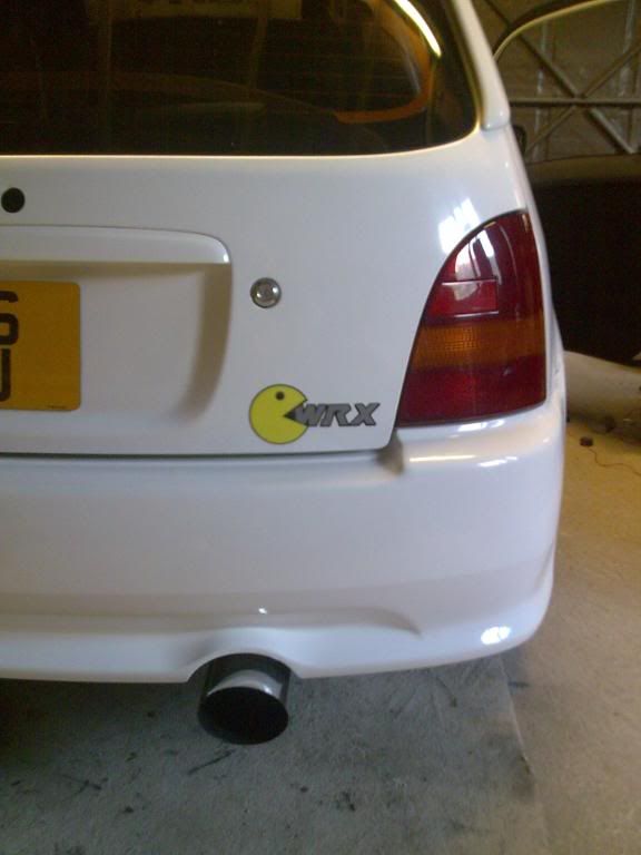

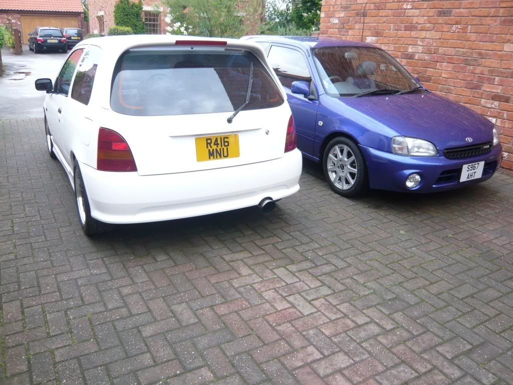

200sx-Starlet-Jay Posted June 5, 2009 Author Posted June 5, 2009 WIRING UPDATE....rite realy am geting so wound up now. car has been sat untouched for almost 2 weeks, everything bar 1 or 2 little things is ready to go, or being held up by the wiring. im waiting for a disk that all the diagrams i would need are on, off this company, and its taking ages to arrive.there is nothing more frustrating rite now, paying out for insurance x2 and seeing this beast so close yet so far from completion...also.. stuck a nice little addition on the rear end.. hopefully it will live up to it ! will get a pic later if possible.. Quote

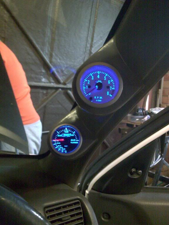

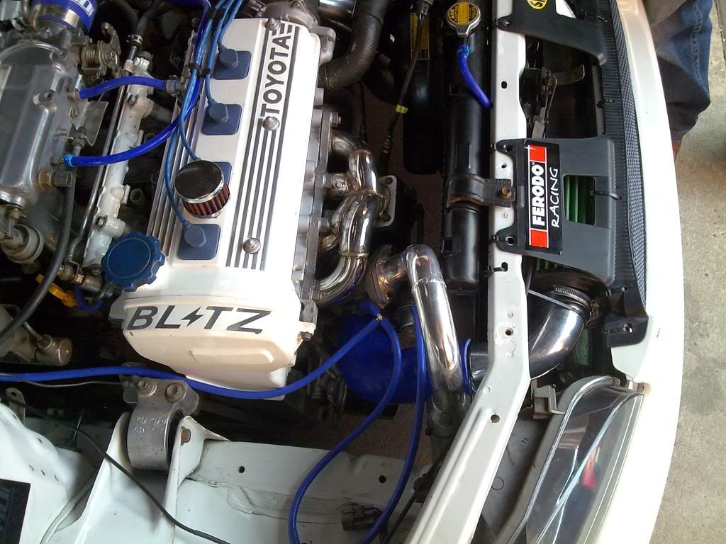

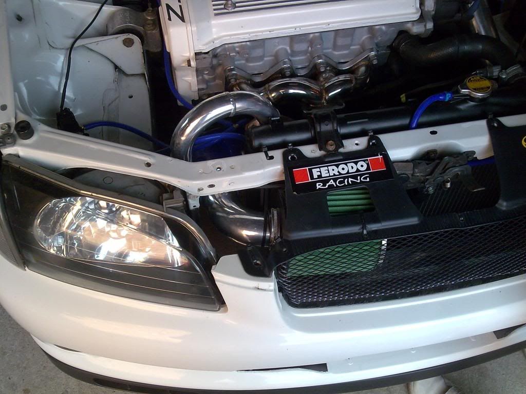

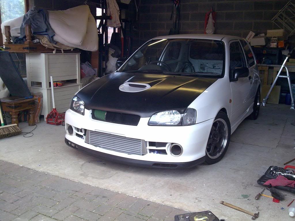

200sx-Starlet-Jay Posted July 12, 2009 Author Posted July 12, 2009 Hi allbeen a while since i posted a decent update of the progress!right, been fairly busy the past week finishing half done jobs and a few more things on the list. also ordered a green cotton filter thats rated to 340bp so should be more than enough!got a few graphics as well so a few pics of them.also wired up the boost gauge and rev gauge to see what they look like, as boost gauge is smoked! was quite pleased with it to be honestwiring update:had my uncle over today, he is an auto electrician and is going to be doing my loom. work on it starts next saturday so should have a nice update soonish anyway, pics....Any comments welcome as usual Quote
Sparky Posted July 12, 2009 Posted July 12, 2009 Looking tidy as fuck mate to be honest!!Cant wait until its running!! Quote
Idrees Posted July 12, 2009 Posted July 12, 2009 Looks sweet! It's crying out for a cooling panel though! And I happen to be doing a group buy on them. Quote
STEVO9000 Posted July 13, 2009 Posted July 13, 2009 Looks sweet buddy, seeing that engine now makes me wish I'd kept it lol. Glad your getting use of it though, be wicked to see it when its all done Quote
Nanglebadger Posted July 13, 2009 Posted July 13, 2009 fan-f**kin-tastic!this is a hell of a project! very impressive dude! loving the clean engine bay! top work all round!Phil. Quote
