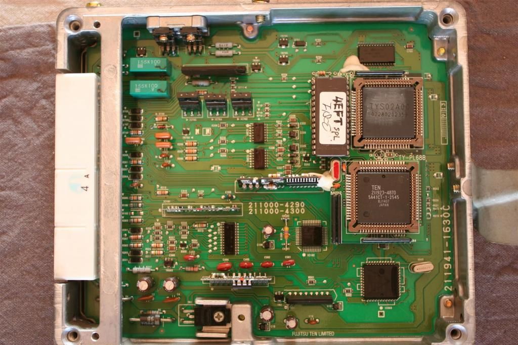

Yoshimitsu666 Posted September 5, 2014 Posted September 5, 2014 Bought a "Fisco plug and play ecu" from here. In terms of appearance, the box is completely identical to the standard ecu, except for a crude "Fisco" sticker that has been applied OVER the standard Toyota markings. I fitted it and have noticed that there is no increase in performance and the rev limiter is identical to the standard ecu. I'm guessing I have been ripped off? Quote

_shaun_ Posted September 5, 2014 Posted September 5, 2014 the easiest way todo it is take the cover off and look inside there should be a daughter board attached. best todo it in a dark place tho as some were fitted with uv sensative chips Quote
5e colin Posted September 5, 2014 Posted September 5, 2014 the limiter should be raised indeed for a p&p dont sound good to me and as shaun says they should have a 2nd board inside Quote

Yoshimitsu666 Posted September 5, 2014 Author Posted September 5, 2014 Sounds very fishy and yes this did come from Holland. I shall upload pics later after work. There's also no seals intact or anything of that nature. Quote
mikey4410 Posted September 5, 2014 Posted September 5, 2014 Hmm if the limiter is the same then straight away thats not how an aftermarket ecu works.we all know they rev to 8,000 and NOT the stock 7,200 Quote

Yoshimitsu666 Posted September 9, 2014 Author Posted September 9, 2014 Opened her up. It actually has a small sister board, but then how can the limiter be at the same level as my standard ECU? Could the sister board itself be faulty? Previous owner has now admitted to having had the unit open, which i'm led to believe can cause irreparable damage. Quote
richardc9052 Posted September 10, 2014 Posted September 10, 2014 It can if the uv resistant tape is removed from the chip and it's then exposed to sunlight. I've had a p+p open before to check chip for what it was mapped for/to with no I'll effects.. As have many others. It certainly hasnt stopped the daughter board from working as if it had the ecu wouldn't work at all. Is there any info on Fisco ecu's in general? Can you put some pictures up of yours with the cover off? (No flash) Quote

Yoshimitsu666 Posted September 20, 2014 Author Posted September 20, 2014 Thought id flop these up to show you guys eventually. Seems legit, just can't understand why the rev limiter isn't different. As someone said they're all different and perhaps this Fisco ecu doesn't effect the rev limiter. I'll try and get some dyno time and do some further testing. Quote
5e colin Posted September 20, 2014 Posted September 20, 2014 ya man thats very strange if the limiter is only at stock i doubt a bigger turbo can be used on this ecu Quote
Gainzy Posted September 20, 2014 Posted September 20, 2014 What does it boost like? Over 0.8? I would imagine if your running an unported stock manifold that would restrict revs abit? Quote
Glanza-Ben Posted September 20, 2014 Posted September 20, 2014 Turn the boost up to one bar amd test it, if it hits fuel cut then the ecu must be faulty Quote
richardc9052 Posted September 21, 2014 Posted September 21, 2014 It can't be faulty.. It wouldn't use the standard settings if something was up it just wouldn't run or would run shite Quote
daniel_g Posted September 21, 2014 Posted September 21, 2014 It was probably made / mapped to suit a fairly stock CT9 setup with a few bolt ons, and didnt need the rev limiter touched, as a CT9 wont make power near the redline its pointless to increase it Quote
