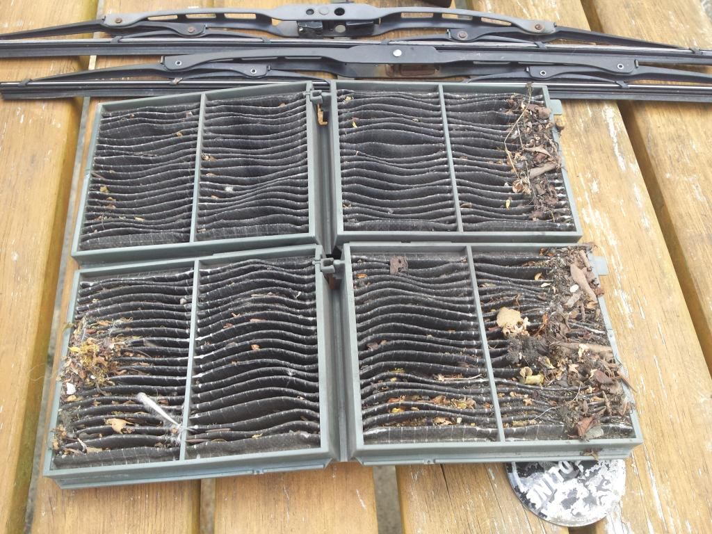

morgey Posted September 8, 2014 Share Posted September 8, 2014 Cabin filter fail! Quote Link to post Share on other sites
_shaun_ Posted September 8, 2014 Share Posted September 8, 2014 Ha looks lovely it much of a ball ache todo? Quote Link to post Share on other sites
morgey Posted September 8, 2014 Author Share Posted September 8, 2014 5 minute job. Head under the dash. 3 mushroom pins pop out from the bottom of the fan motor housing and the cap comes off. Slide both filters out.I've only smacked all the crap out of mine still need new ones but made a hugr difference. Quote Link to post Share on other sites

maddox710 Posted September 9, 2014 Share Posted September 9, 2014 Just changed the ones in my bmw they were about as bad as that, they stink Quote Link to post Share on other sites
daniel_g Posted September 9, 2014 Share Posted September 9, 2014 Found many interesting things in pollen filters, yours looks lovely. Quote Link to post Share on other sites
morgey Posted September 9, 2014 Author Share Posted September 9, 2014 Thats 7.5 years old since I've had the car. Not sure when or if they were changed before that but the fans never blown very stong before lol Quote Link to post Share on other sites

Rob H@RCH Engineering Posted September 10, 2014 Share Posted September 10, 2014 You can wash them out in the sink morgey I did mine some time ago! I did do a how to thread on it too. Quote Link to post Share on other sites
morgey Posted September 10, 2014 Author Share Posted September 10, 2014 Really, They seemed like they would just disintegrate being a kind of paper? Quote Link to post Share on other sites
Rob H@RCH Engineering Posted September 10, 2014 Share Posted September 10, 2014 there fine mate I gave mine a good wash out under the hot tap and there still going strong!! Quote Link to post Share on other sites
Rob H@RCH Engineering Posted September 10, 2014 Share Posted September 10, 2014 Its 3 years since I did mine lol they may be ready again now!! http://www.toyotagtturbo.com/forums/showthread.php?85009-Robs-tutorial-on-how-to-change-clean-pollen-filter&highlight= Quote Link to post Share on other sites
morgey Posted September 10, 2014 Author Share Posted September 10, 2014 Cleaned and scented mine. Who needs a £300+ air fantasy when you can change these in under 2 mins lolCheers for the heads up on cleaning them. Surprisingly durable! Quote Link to post Share on other sites
