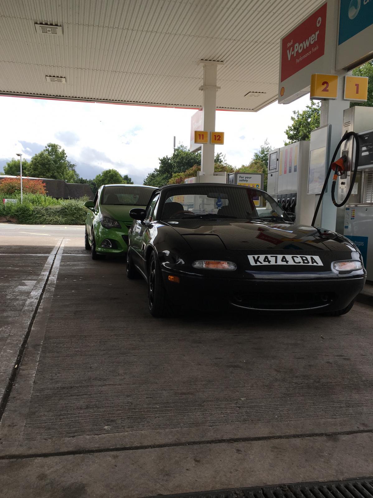

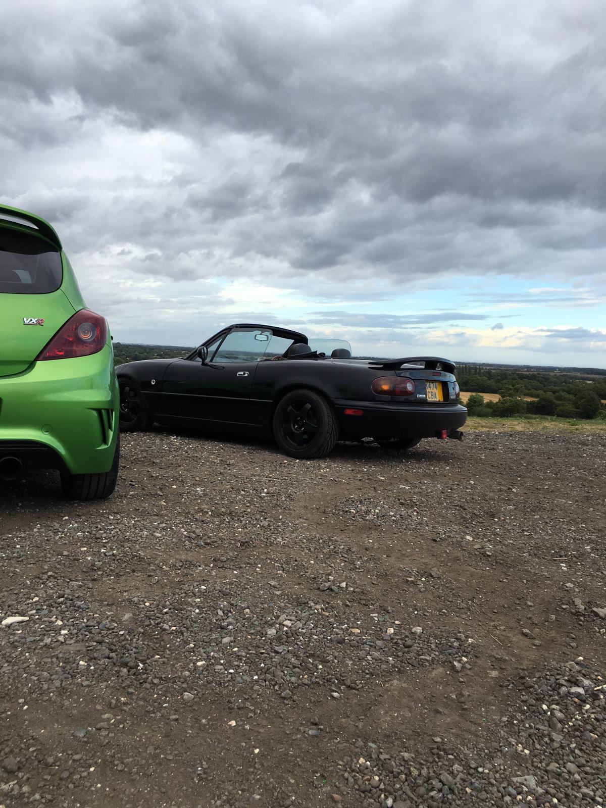

ReeceGolliker Posted August 20, 2016 Author Posted August 20, 2016 (edited) So as some of you may know I've been putting this back to stock, and the car is really starting to piss me off! (Not driven it in over 3 weeks and somehow have a 30cm crack in the windscreen!?) So I decided to get something little and fun around some back roads. The obvious choice with not wanting to spend too much as I'm going into my last year and uni and could do with the extra money, is an mx5. Very nice one popped up on here from RichGlanzaV and it's now in my possession ???????? really happy with it so far, obviously lots slower in a straight line than the glanza but that's not what this is about! The glanza is still with me, slowly putting it back to stock and then deciding what to do with it but I'll probably end up selling it with enjoying this so much Edited August 20, 2016 by ReeceGolliker Quote
