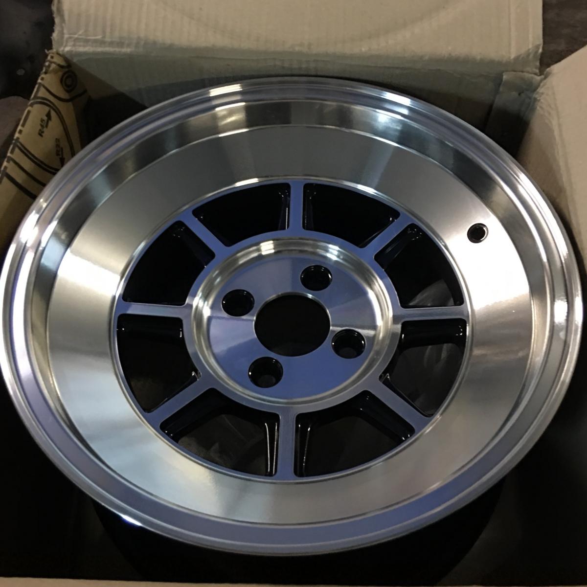

funny onion Posted December 4, 2015 Author Posted December 4, 2015 Yeah i wanted minilites, but they're mostly 13's and the 14's go for loads of money so i treated it to a brand new set of wheels, i'll order tyres next week probably and then once the axle is swapped etc the back end will be fully done and rolling! Quote

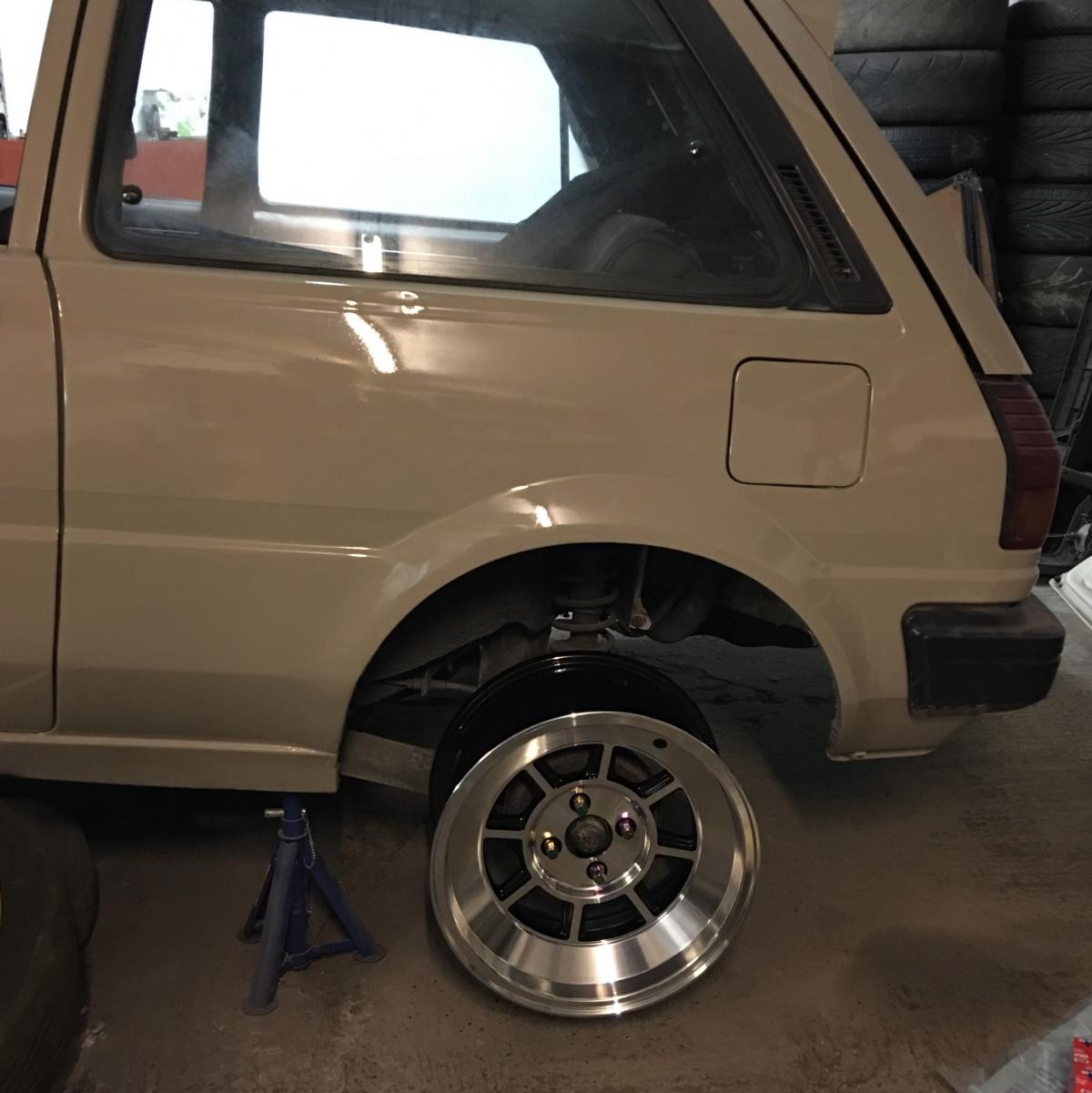

funny onion Posted December 4, 2015 Author Posted December 4, 2015 Rota BM8 15x8j et10. Haters gonna hate... Quote
Whitenoize Posted December 4, 2015 Posted December 4, 2015 They will really suit the car they have a kinda old school retro look good choice 👍 Quote
Stu Posted December 5, 2015 Posted December 5, 2015 Sweet wheels! Your going to have some epic poke going on, over fenders? Quote
mccartney11 Posted December 5, 2015 Posted December 5, 2015 Not a fan of the wheels tbh, there's a boxy over here with those wheels and the plastic over fenders and it's sitting like a tank Quote
turbo Grant Posted December 5, 2015 Posted December 5, 2015 Good progress! The stock ep70 clutch master will work fine. That's what I'm using. The rear axle from a gt/v won't fit. It's too long. So have to make wheel bearing spacer to fit discs on back. Or cut stub axles off lol I went for the last option haha wiring is easy. Cut up the loom and splice the efi wiring in. I'm using original fuel pump/cut relay inside the car. And put a new efi relay under the engine bay fuse box and utilised the efi furs in the fuse box. It just need the terminal fitted Quote

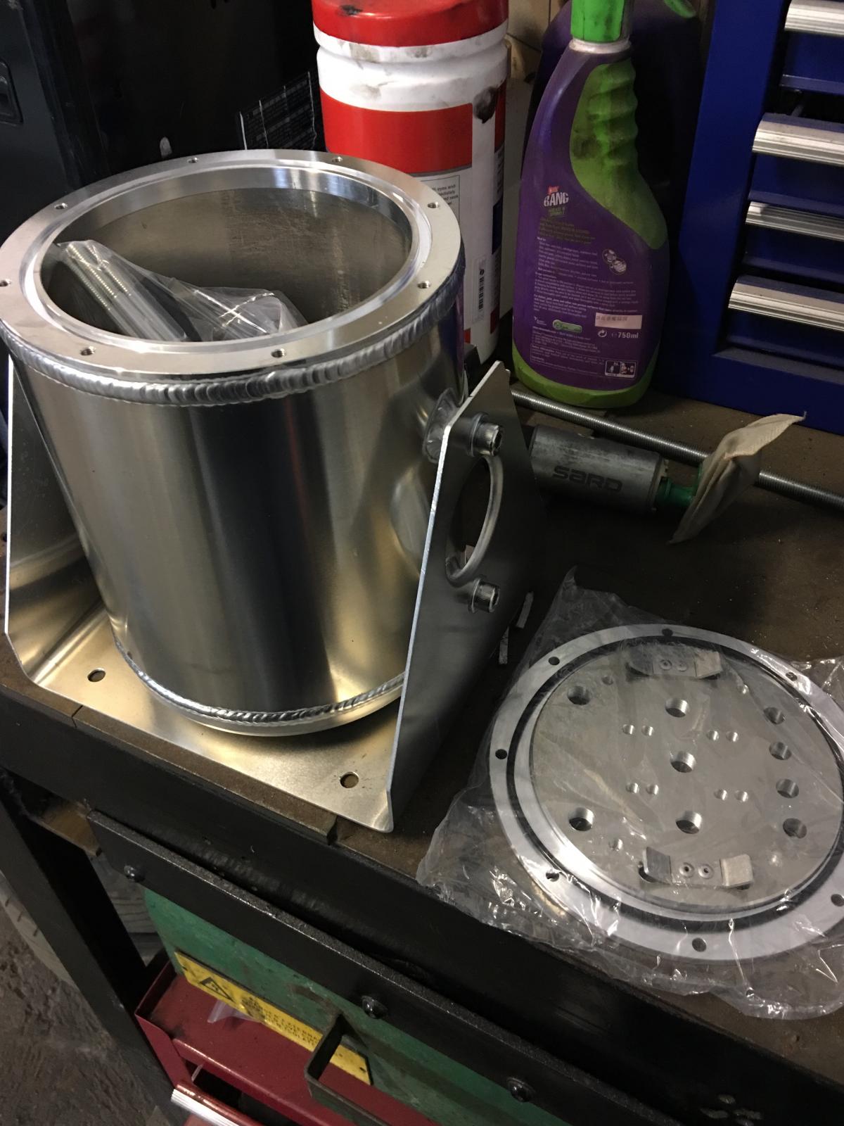

funny onion Posted December 5, 2015 Author Posted December 5, 2015 Thanks guys. I knew the wheels wouldn't be for everyone but I didn't want a coloured wheel if you know what I mean. I saw an amazing set of work equips on drift works that were in stock but £1400... Lol. I will keep my eye out for some jap rims but it's not a main priority just now. And yeah they will poke a bit but they're exactly the same fitment as the wheels on my advance but these are 7mm lower offset so with 195 tyres it should be fine... :/ haha. Cheers for that grant, saved me a day of swapping axles and finding out the hard way. I'll swap the stub axles over I think. I have a sard 5L swirl pot and 265 in tank pump on the way from Japan, and as for the wiring I'm not too bad with wiring (spent 4 years at uni wiring all sorts or stuff but that's the fatal last words hahaha) so I'll just see how it goes. I'm moving the fuse box behind the glove box and I'll mount the efi relay along with that. Quote

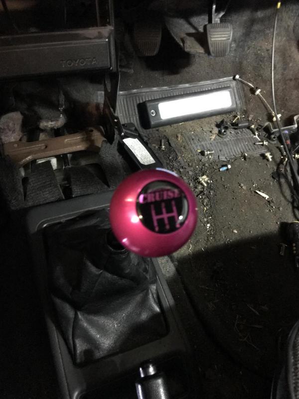

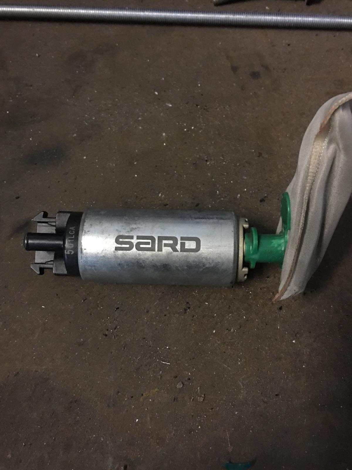

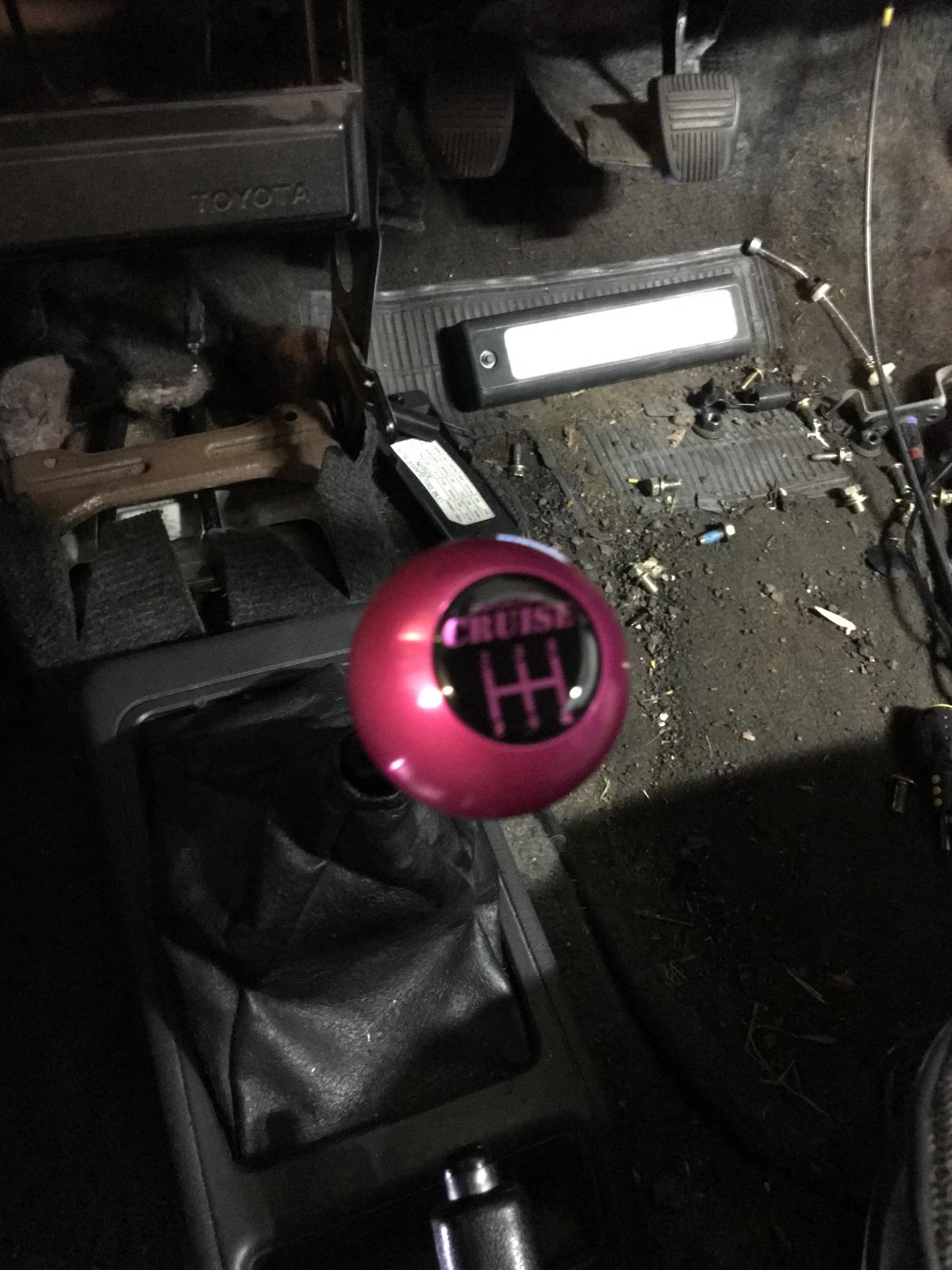

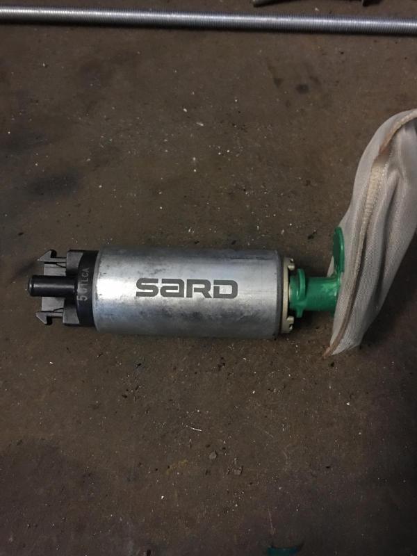

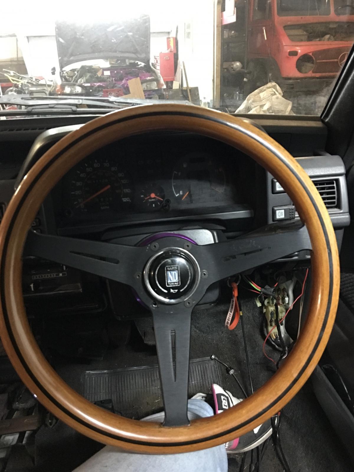

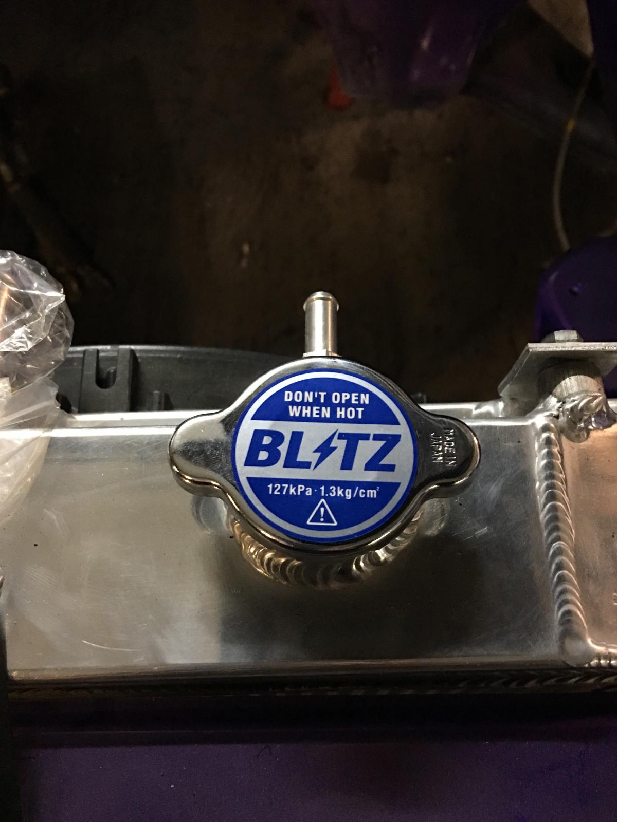

funny onion Posted December 13, 2015 Author Posted December 13, 2015 Few bits fitted and a few bits turned up fresh from Japan. Sard 5L swirl pot, sard 265 pump, cruise gear knob, blitz rad cap etc. Started putting some of the interior back together too. The rear axle along with the GT rear axle are both currently at work in the workshop. The welder a are going to chop the stub axles off the turbo one and weld them to the 70 axle. Also I have some uniroyal rain sport 3's in my store at work so hopefully will have those fitted by tyre bay this week fingers crossed. Work perks ftw! Quote
