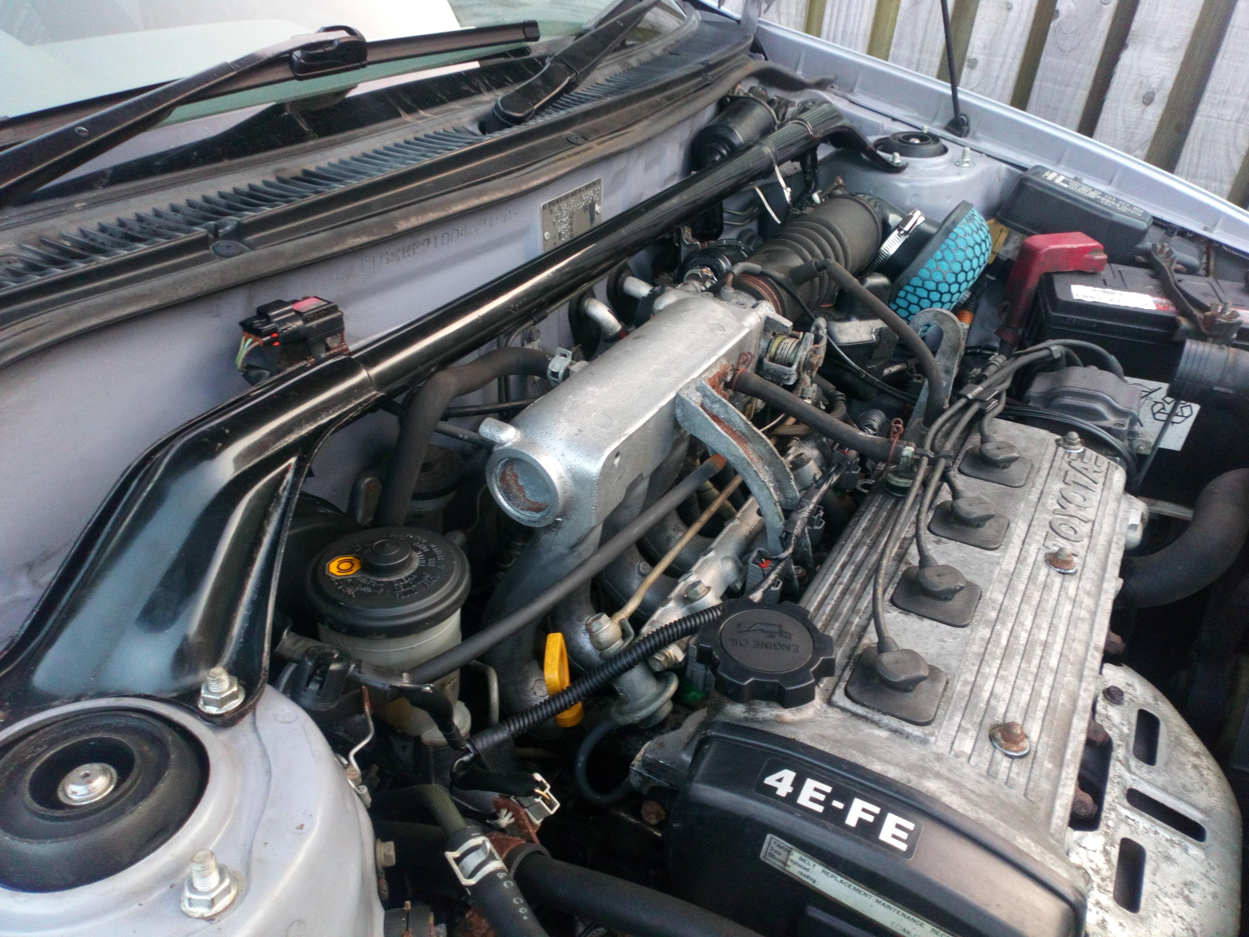

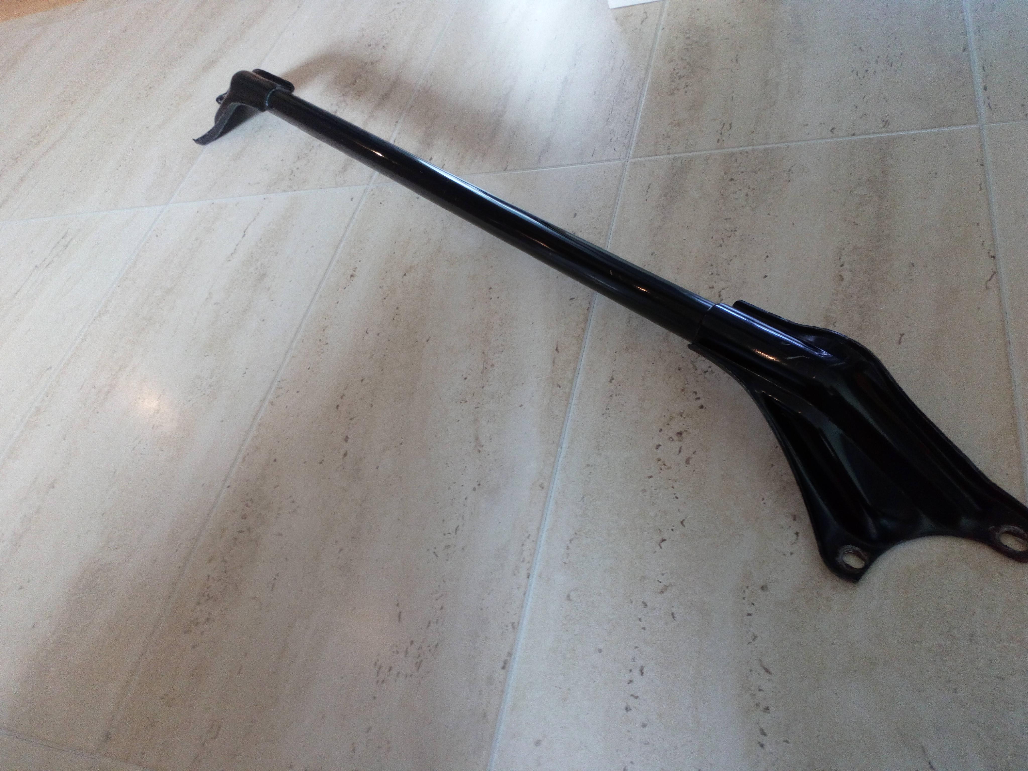

Steadily getting through jobs relocation of fuel filter and strut brace fitted had to move some wiring aswell getting ever closer to strip down underseal welding and respray few more suspension refresh bits to be completed yet

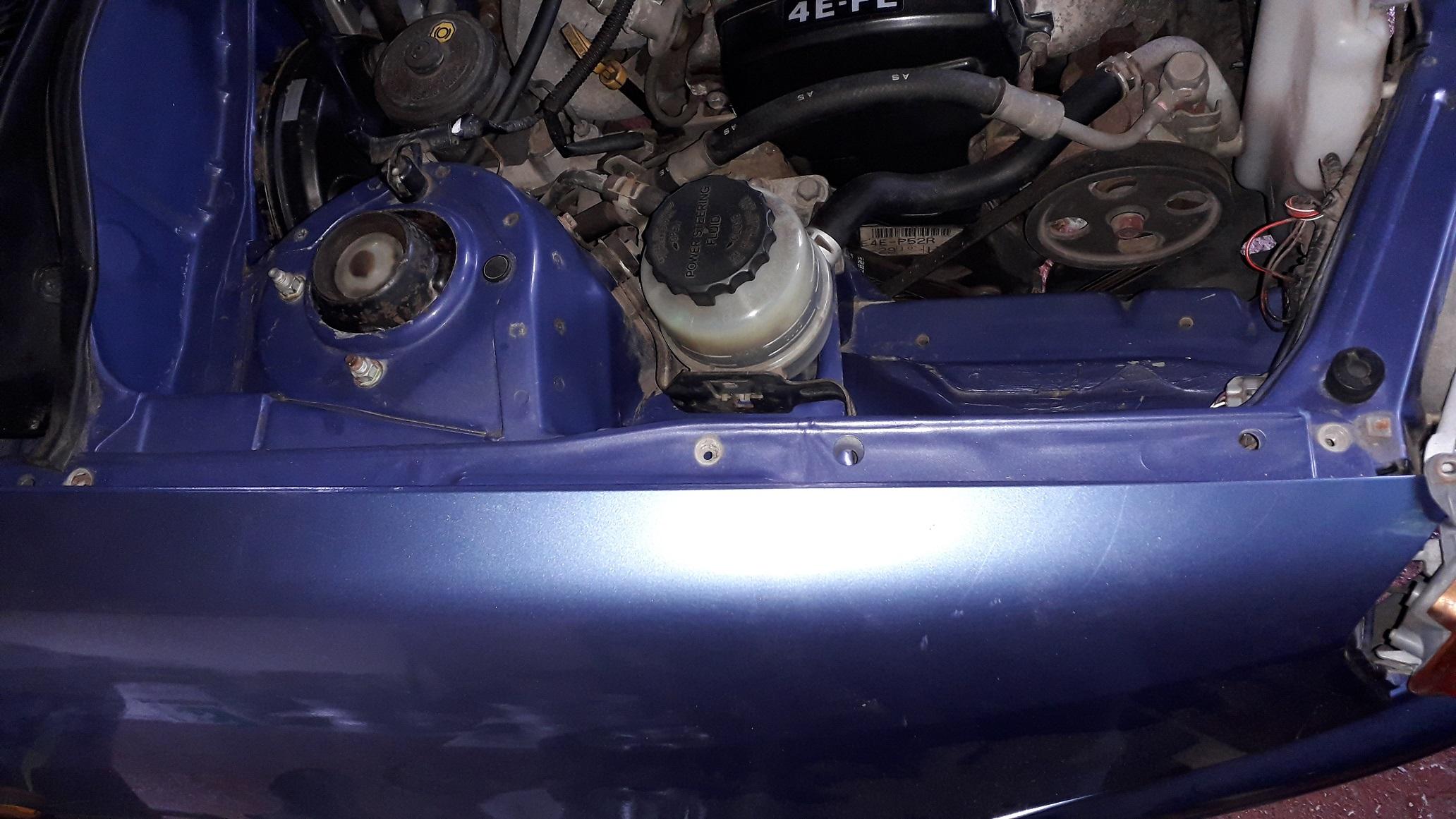

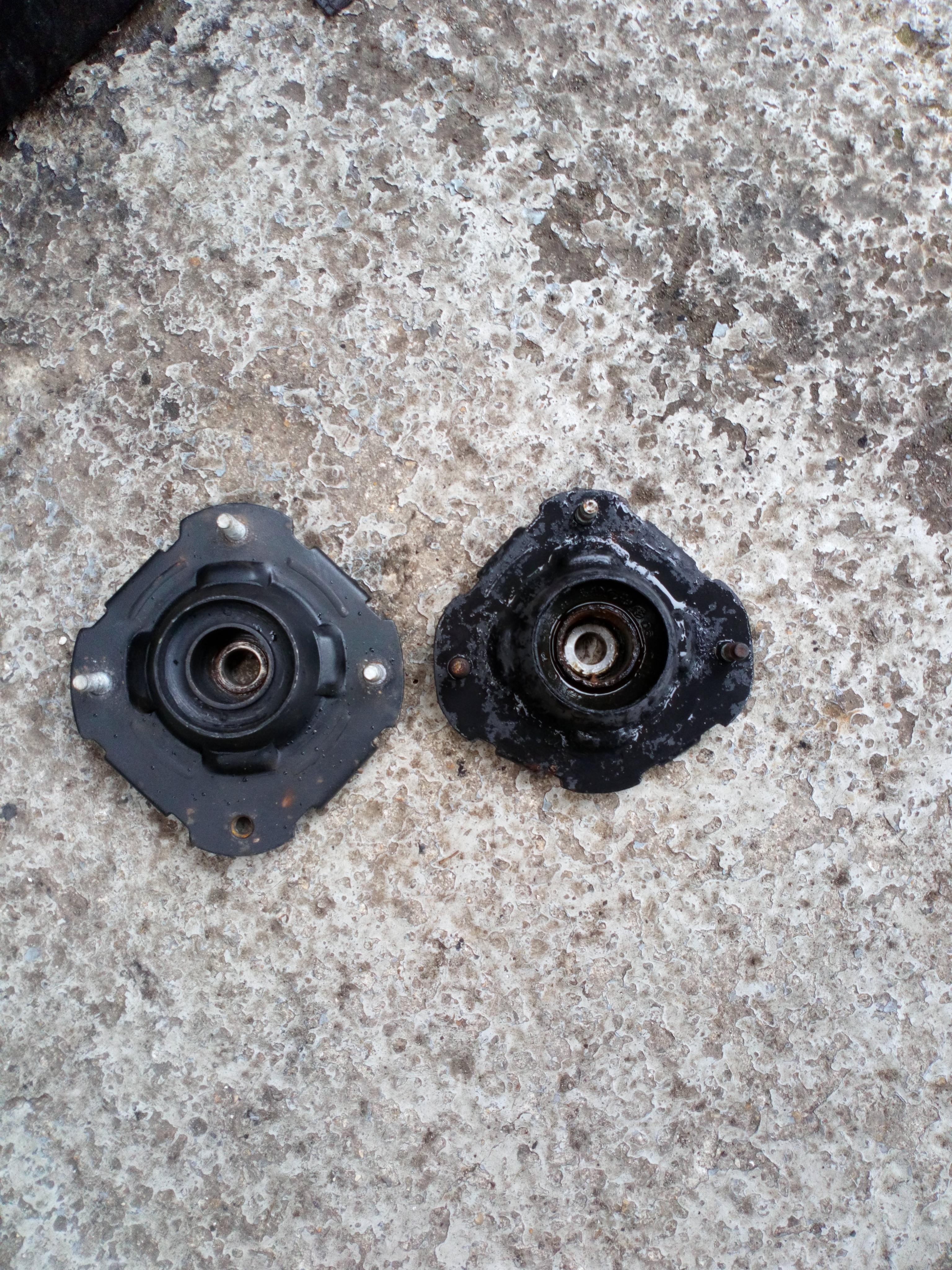

Just noticed that the top mounts are mounted to the strut towers 180 degrees out.
The screw with the arrow should be in the rear tower hole. This pushes the "hump" part of the mount to the back of the tower opening to have the correct caster geometry.
"hump" at back of tower opening.

1 hour ago, Claymore said:
Thanks never even noticed il get this sorted this morning  it was a long day I've not driven it yet and won't get to as I'm so busy at the minute I've been getting help with the starlet on the mechanical side of things aswell looks like both party's missed it so good shout

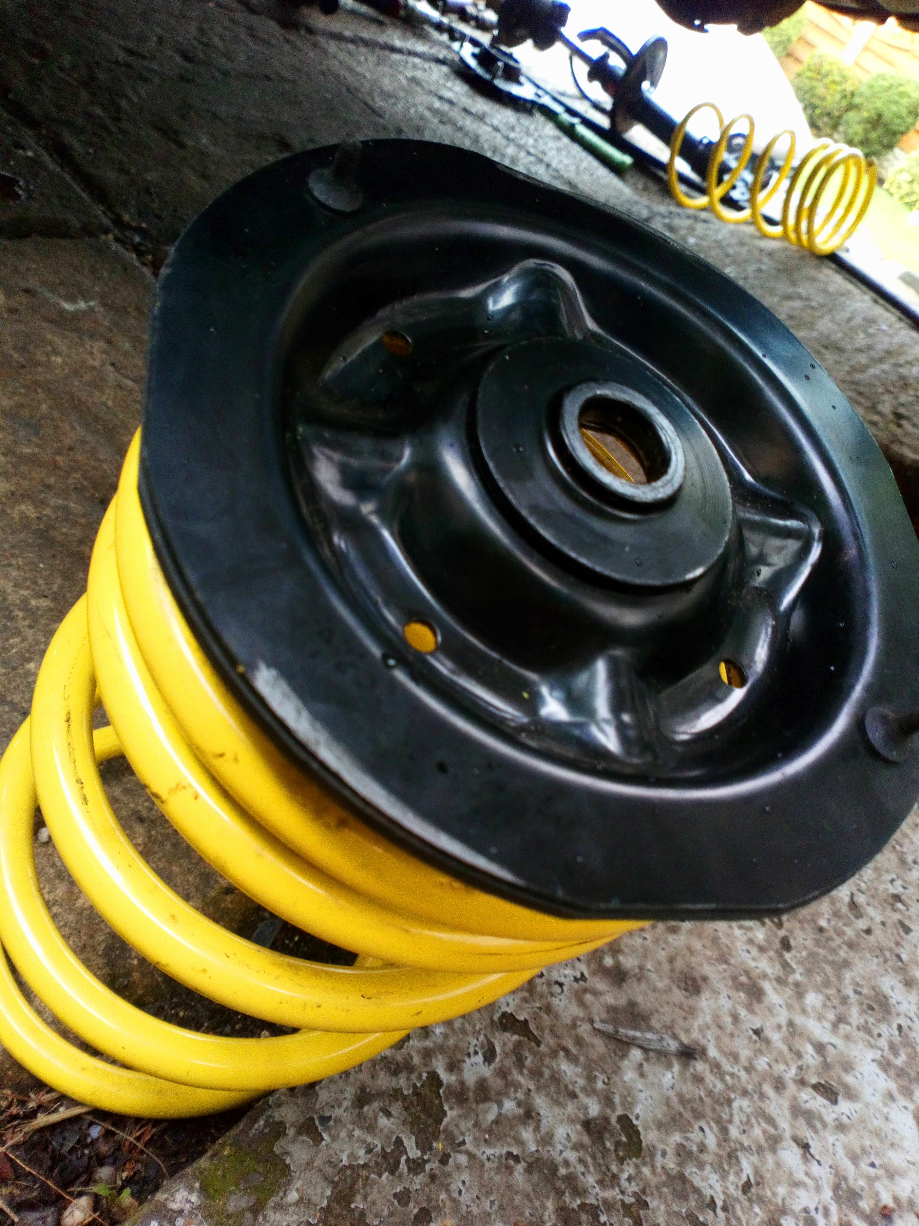

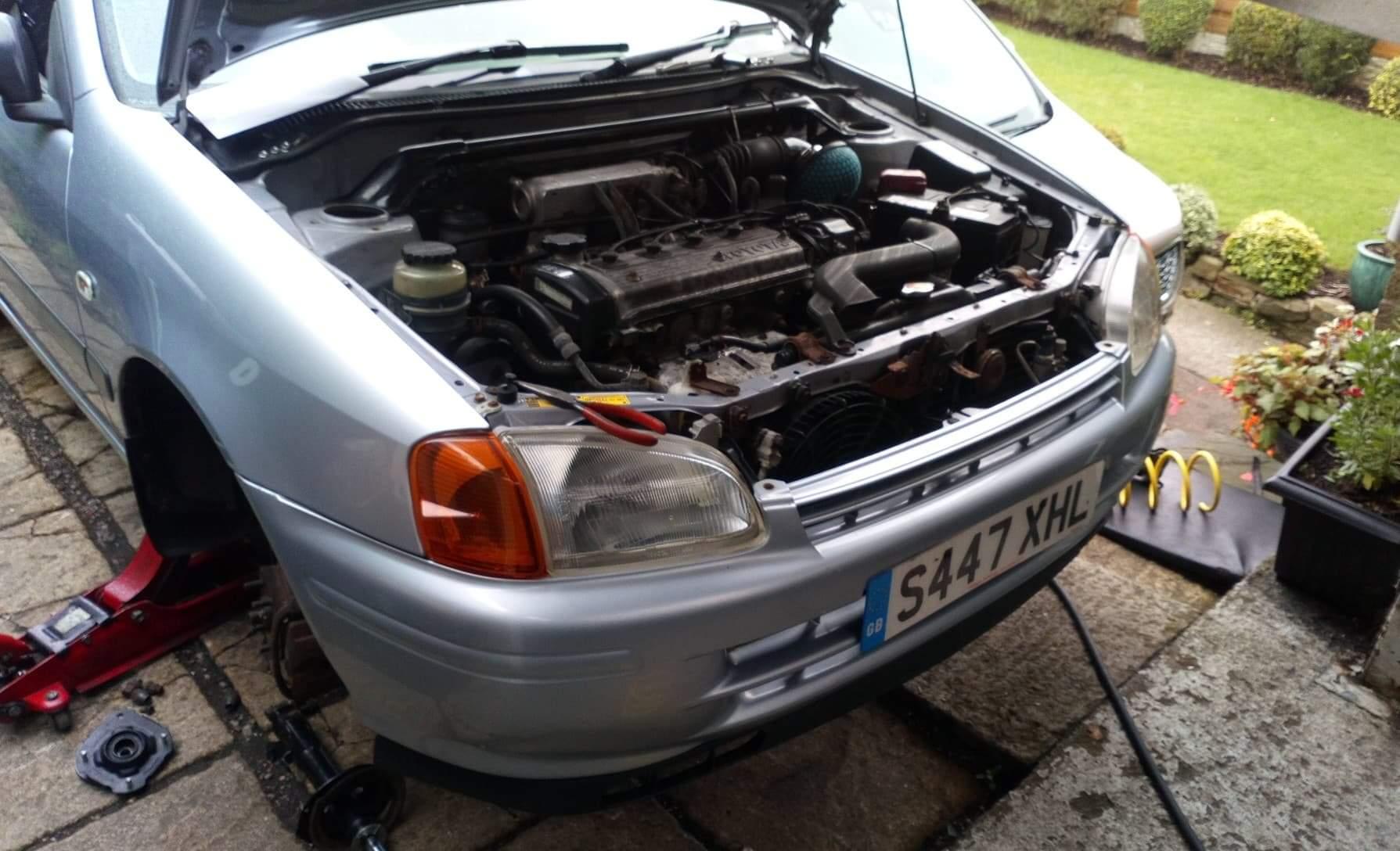

Right so I've had an annoying clunk on the suspension and it is indeed the kyb topmounts first off as Claymore said in a earlier post they are slack and secondly the 4th nut fouls the upper spring cup and you can clearly see where its been damaged fortunately I saved the old ones as Claymore gave me the heads up I'm posting this to save people the hassle maybe we got a duff batch who knows
