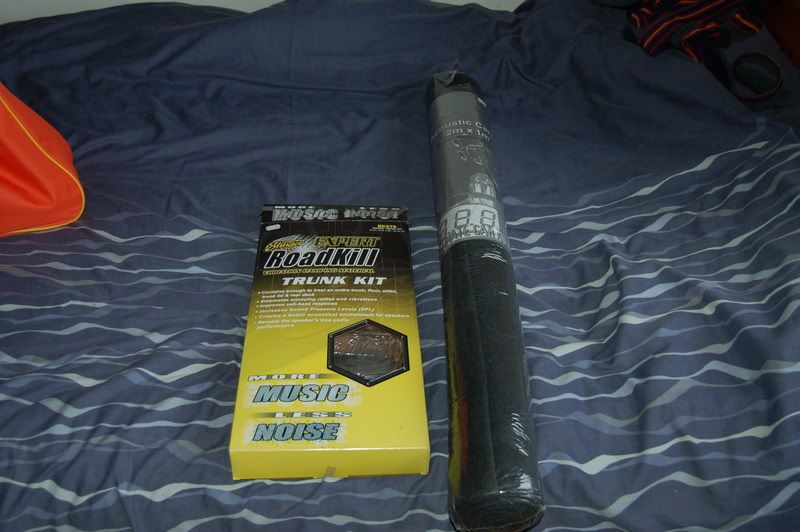

Nanglebadger Posted September 12, 2007 Author Posted September 12, 2007 payed a visit to the shop where i get some of my stuff from, the wheels have had some interest but no sale as yet! ;) :P i did however manage to spend over £100 when i really dont have that money to frickin spend!!! but it means me and mark can crack on with the boot when get some time.purchased £100 worth of sound proofing and a roll of nice black carpet tho i'll prob need more of this! got some discount for bein a reguar customer of course so wasnt as bad as it could have been! Phil. Quote

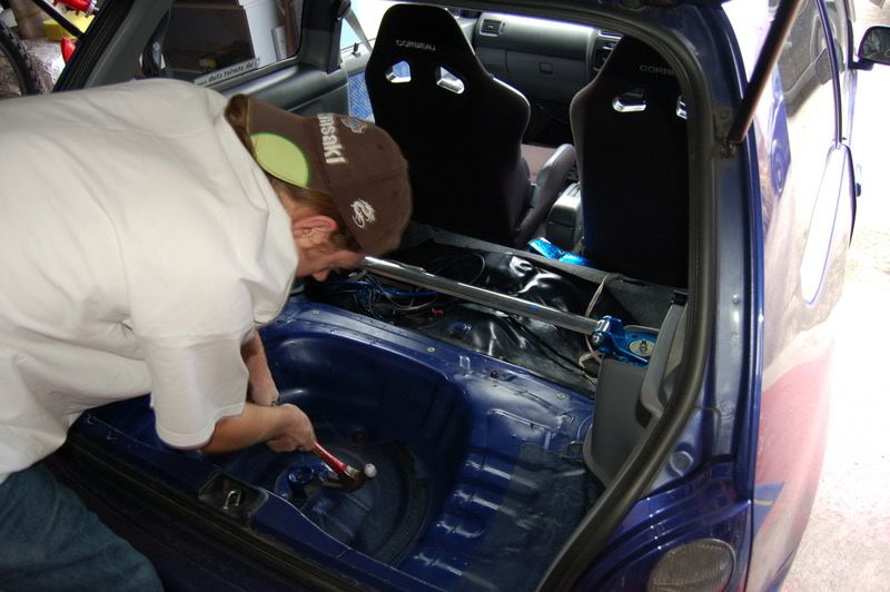

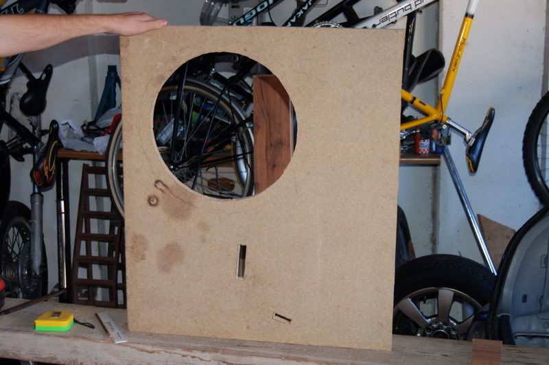

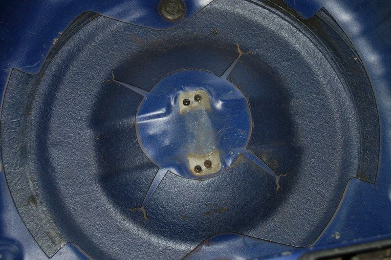

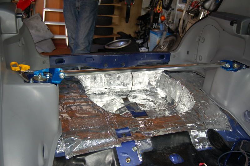

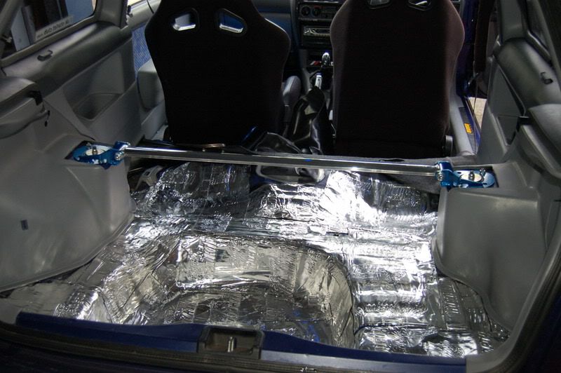

Nanglebadger Posted September 15, 2007 Author Posted September 15, 2007 cheers Bourkey man, really appreciate that!!! and i'll remember that advice man, good point!! thanks!! i'm usin sony xplod 6x9s (not sure where we're puttin them yet tho ;) and a 15" sony xplod sub w/ xplod 1600w digital amp (all FREE from my loving bro!!! :( )Thanks Rob man, just be patient man and do it one piece at a time, thats wot im doin!OK folks, we have started the boot:Project Boot - Stage 1 Step 1: remove sound equipment and spare wheel and carpet from boot.Step 2: remove spare wheel strut using hammer and brute force and ignorance!Step 3: Fill in rivets from strut w/ screw heads and silcon sealerStep 4: hoover out crap from years of father's abuse of the car!!! :P Step 5: Polish sexy cusco strut whilst silcon dries!Step 6: Fit Stinger Expert Roadkill Trunk Kit (remember to leave a suitable bolt exposed for amp earth connection!)Step 7: LUNCH w/ COFFEE!!!! :( Step 8: cut wood for sub and ampStep 9: cut round hole for subStep 10: cut holes for amp wiresStep 11: level it off using small pieces of wood on the underside of your new floorStep 12: add extra wood to edges to level entire boot areaStep 13: get your ass some glass fibre!End of Stage 1...To Be Continued...Phil. Quote

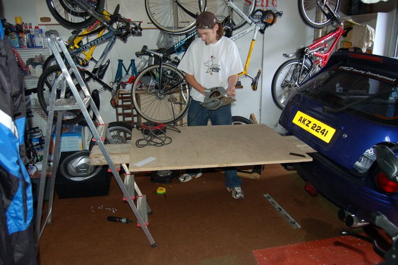

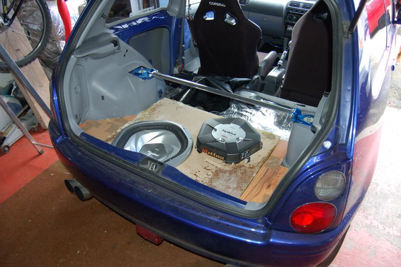

Nanglebadger Posted September 15, 2007 Author Posted September 15, 2007 cheers dude, appreciate that! we're gonna take a look at the glass fibre tonight when mark gets home from work, see where we are from there.98% of the credit goes to mark tho, the engineerin of the whole thing is his brain child, all i do is pay for parts and hold things whilst he cuts ;) Nath has told us off for not usin dust masks when cuttin MDF tho...sorry nath! :P :( Long ways to go yet, i at least want to have it makin noise before next fridays meet if not totally finished.Phil. Quote

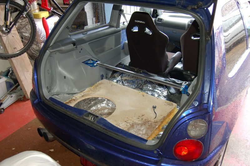

Nanglebadger Posted September 15, 2007 Author Posted September 15, 2007 Project Boot - Stage 2Step 14: ensure earth, phono and power wires are adequate lengths to manoeuver under floor. ATTENTION - power and earth cables are LIVE! either remove appropriate fuses or be very careful they dont touch anything metal! sparks fly!! they can make a mess of your panels and parts!Step 15: run earth, phono and power cables before securing new floorStep 16: apply glass fibre and leave to set (we're leaving it overnight). Phil. Quote

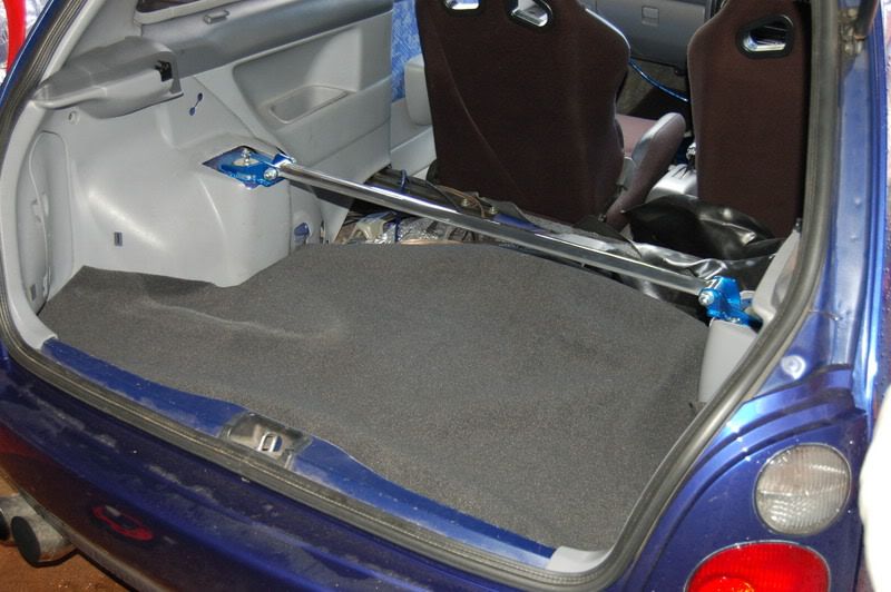

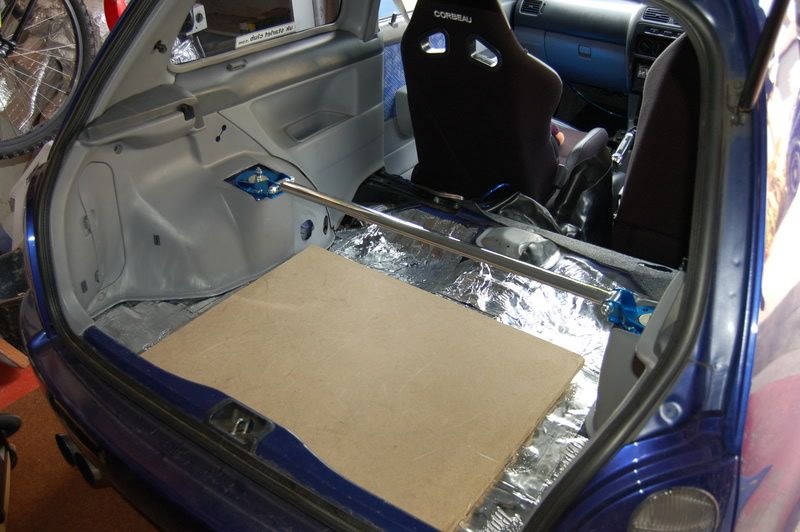

Nanglebadger Posted September 16, 2007 Author Posted September 16, 2007 Project Boot - Stage 3Step 17: sand down rough parts of glass fibreStep 18: stick down side pieces to fill boot w/ suitable adhesiveStep 19: using old boot carpet as a template cut new carpet to shape of boot space (remember to cut it slightly larger to allow for coverage of edges of floor). at present its still slightly too large but this will be adressed when the floor is completely finishedStep 20: mock up sub and amp and drill screw holescame to a bit of a stop due to lack of more fibre glass but that'll be sorted tomorrow, so work on the 6x9s was done instead to get them started. also, the carpet was MEANT to be black, turned out to be charcoal grey, i would have been annoyed but it actually matches the colour of the factory front carpet which means when its joined together it should look smart and tidy so that actually turned out better!Phil. Quote
