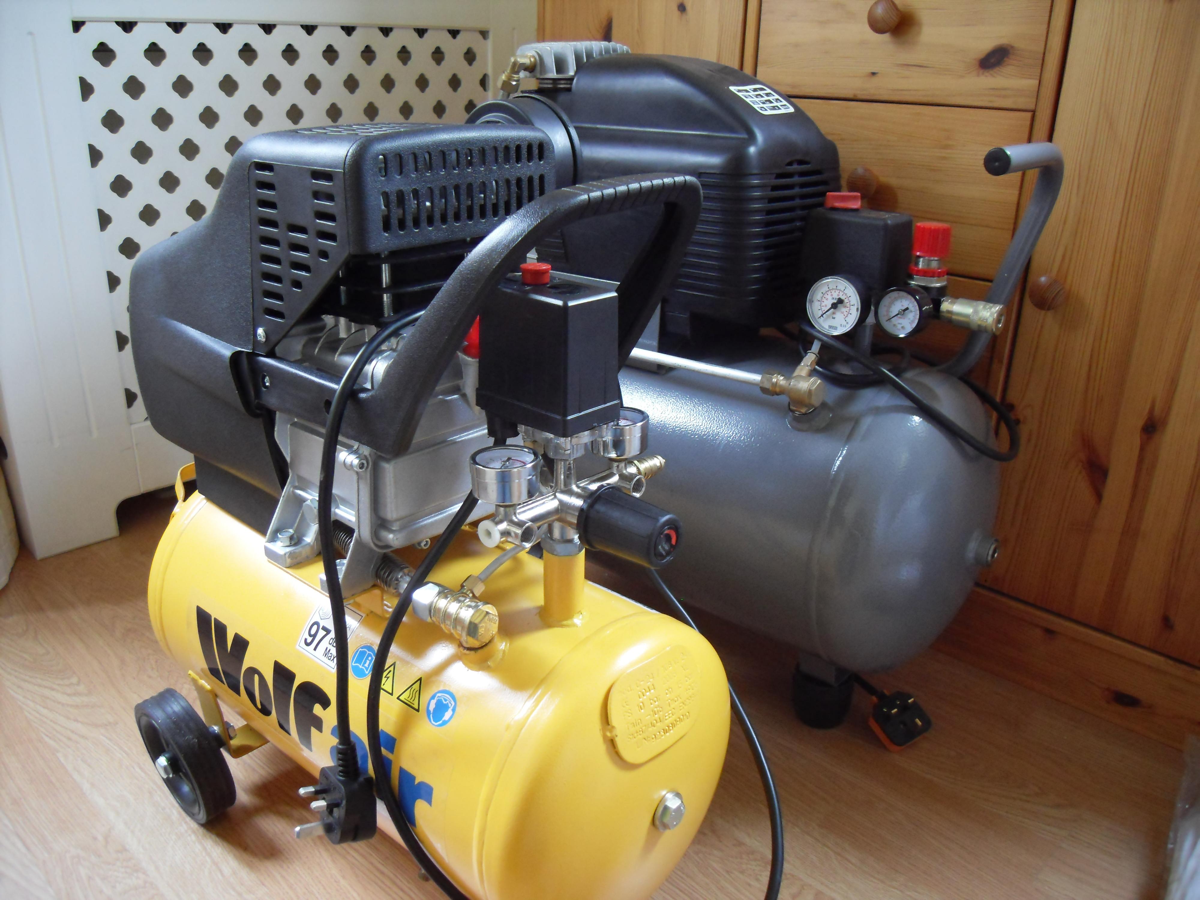

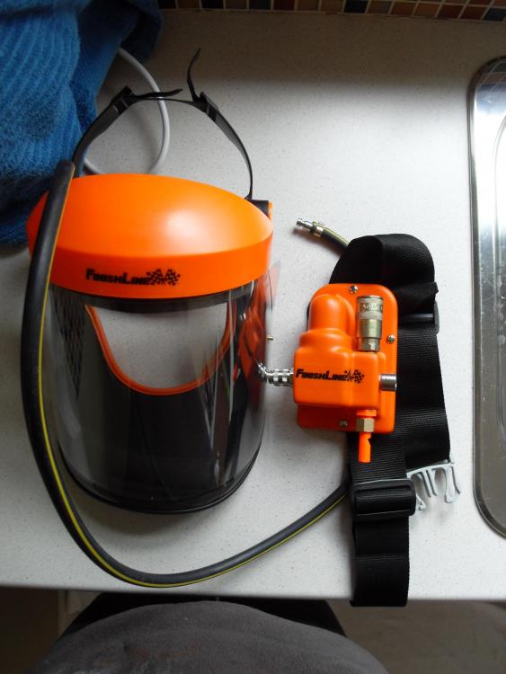

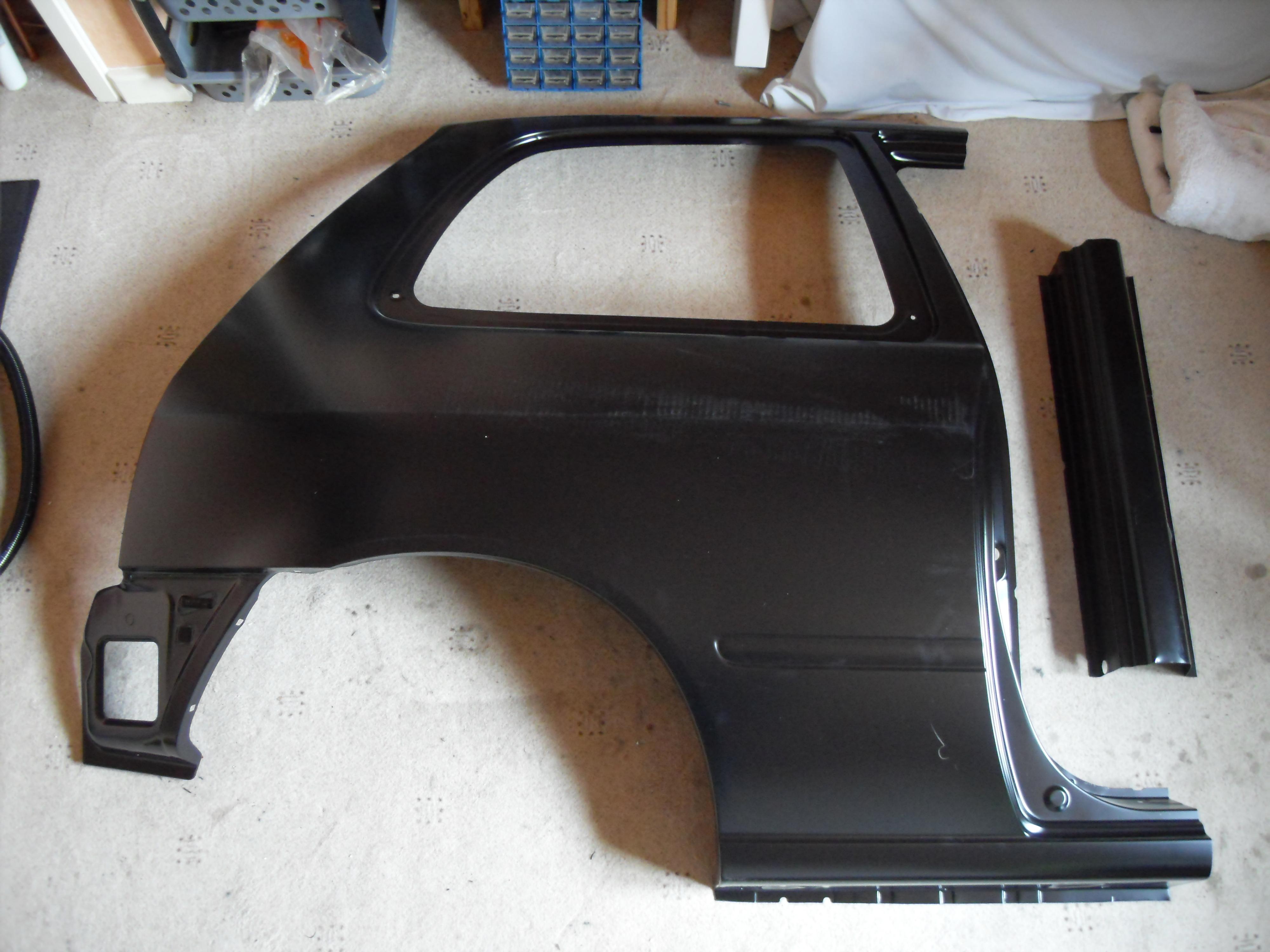

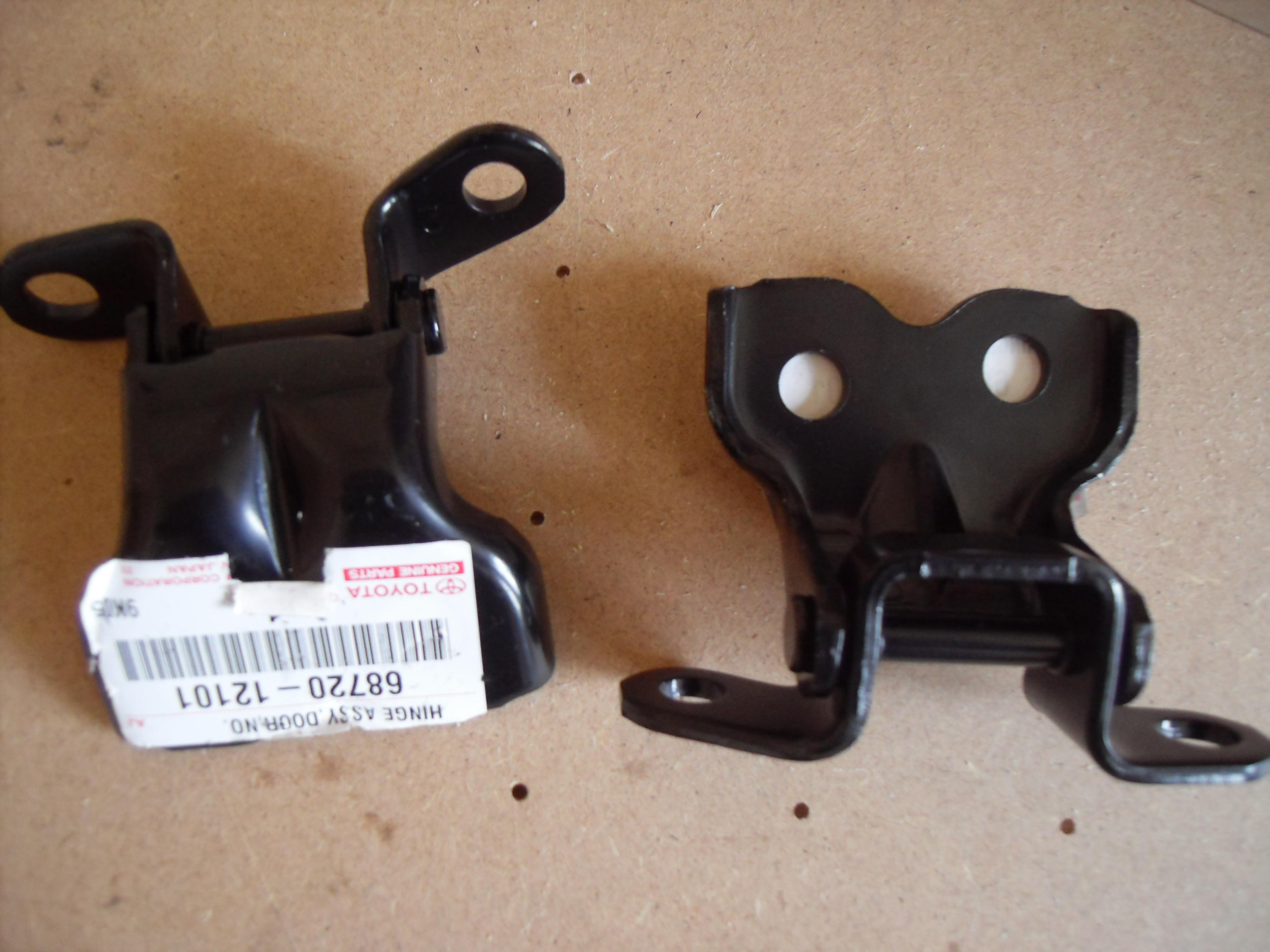

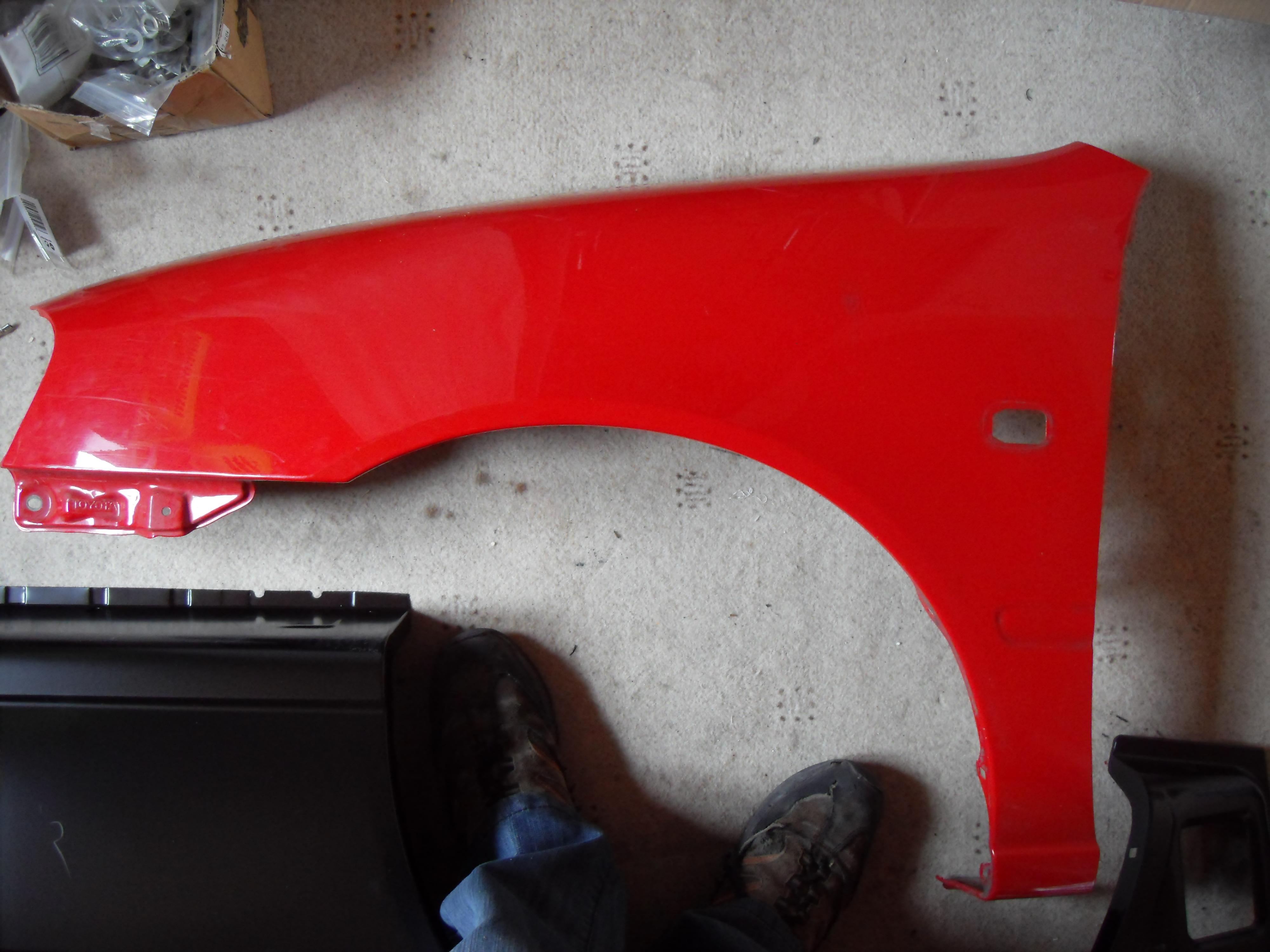

enzo_e492901 Posted March 17, 2010 Author Posted March 17, 2010 (edited) Cheers everone. A few more bits and parts have turned up today, some interesting some not so interesting. Just a few more bits to get and then I can start. New drivers side door hinges because the old ones have major play in them  Rear quarter panel and sill  Wing  Compressors new and old  Air fed mask  Gavin Edited September 29, 2020 by enzo_e492901 Quote

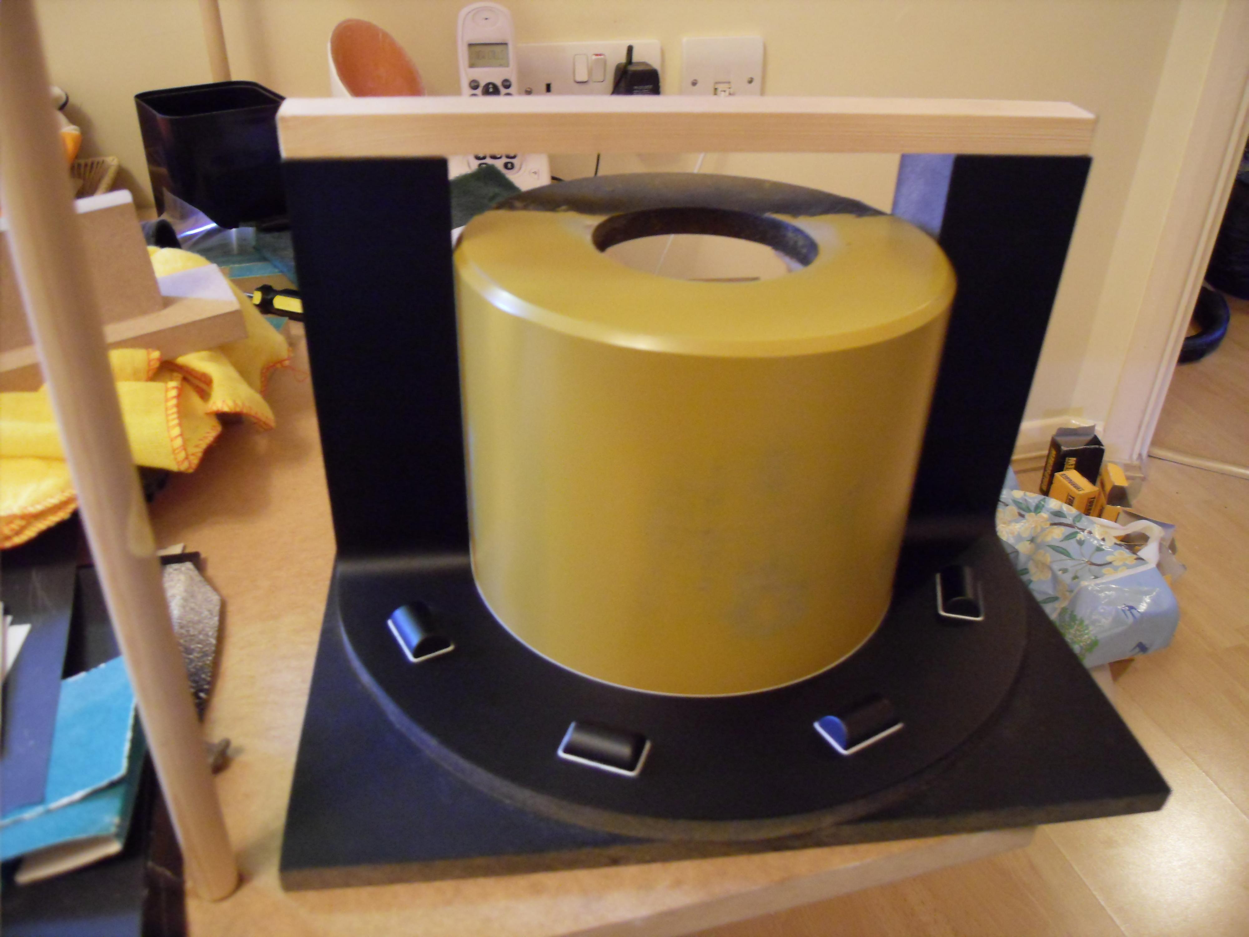

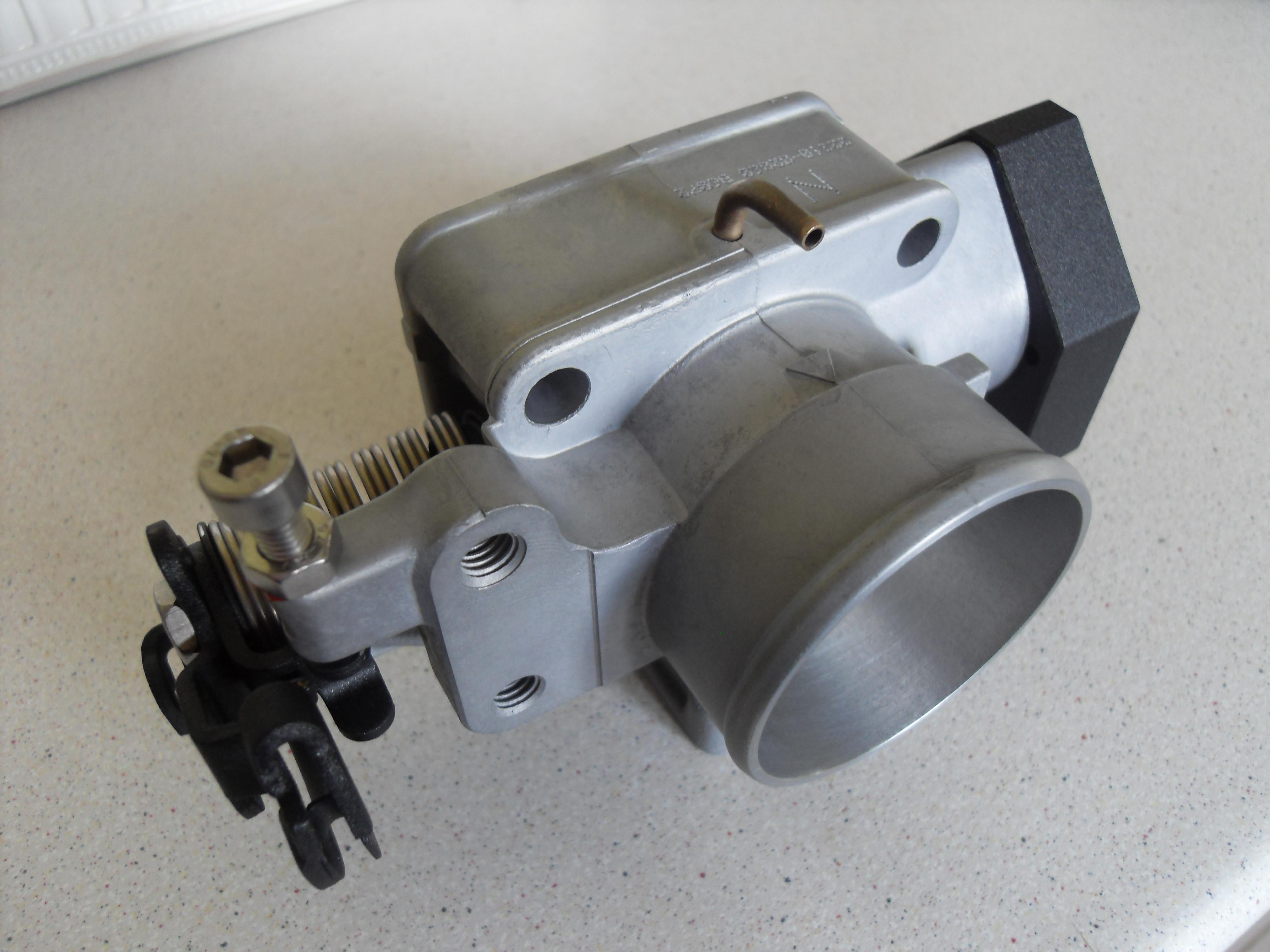

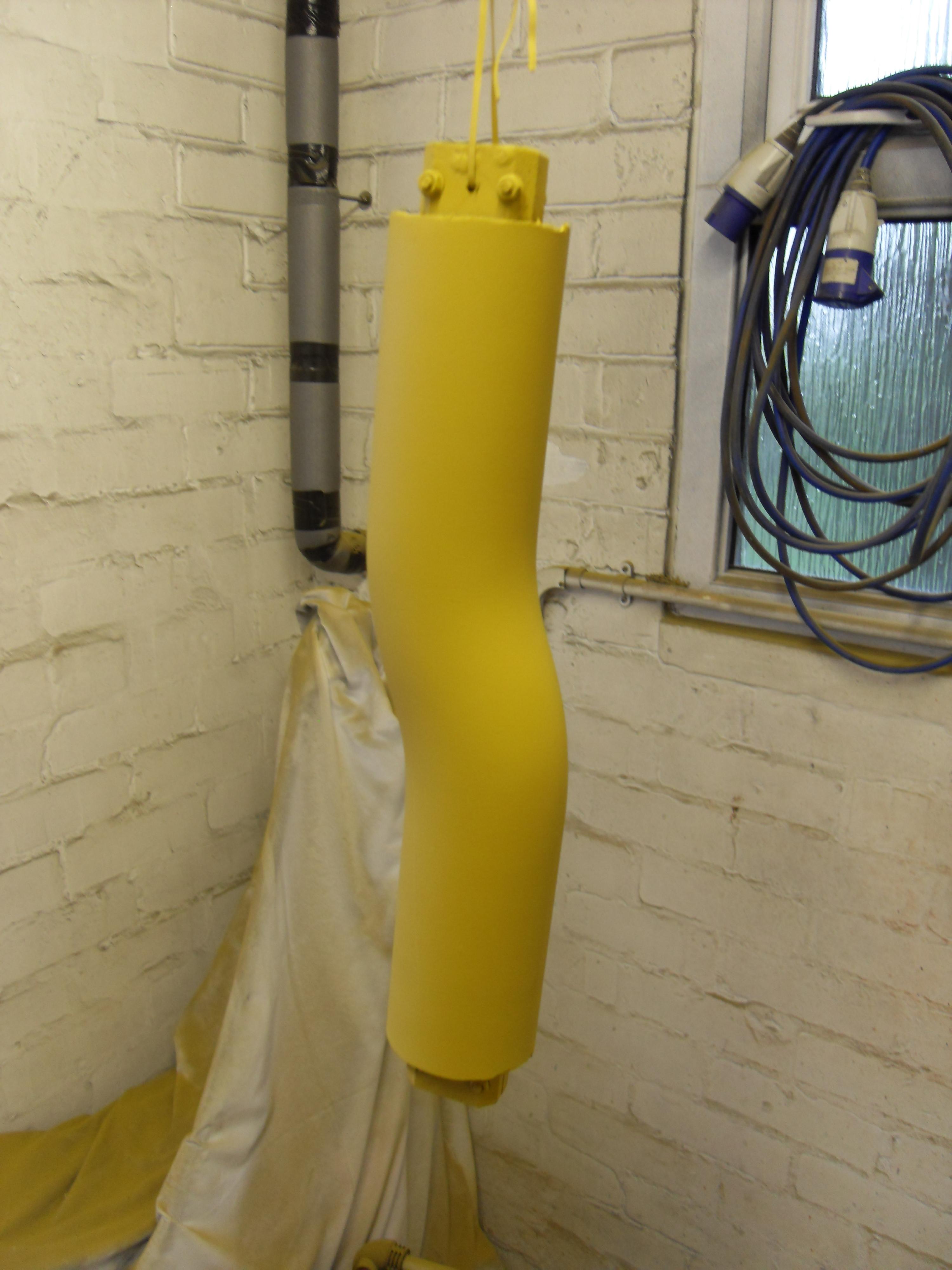

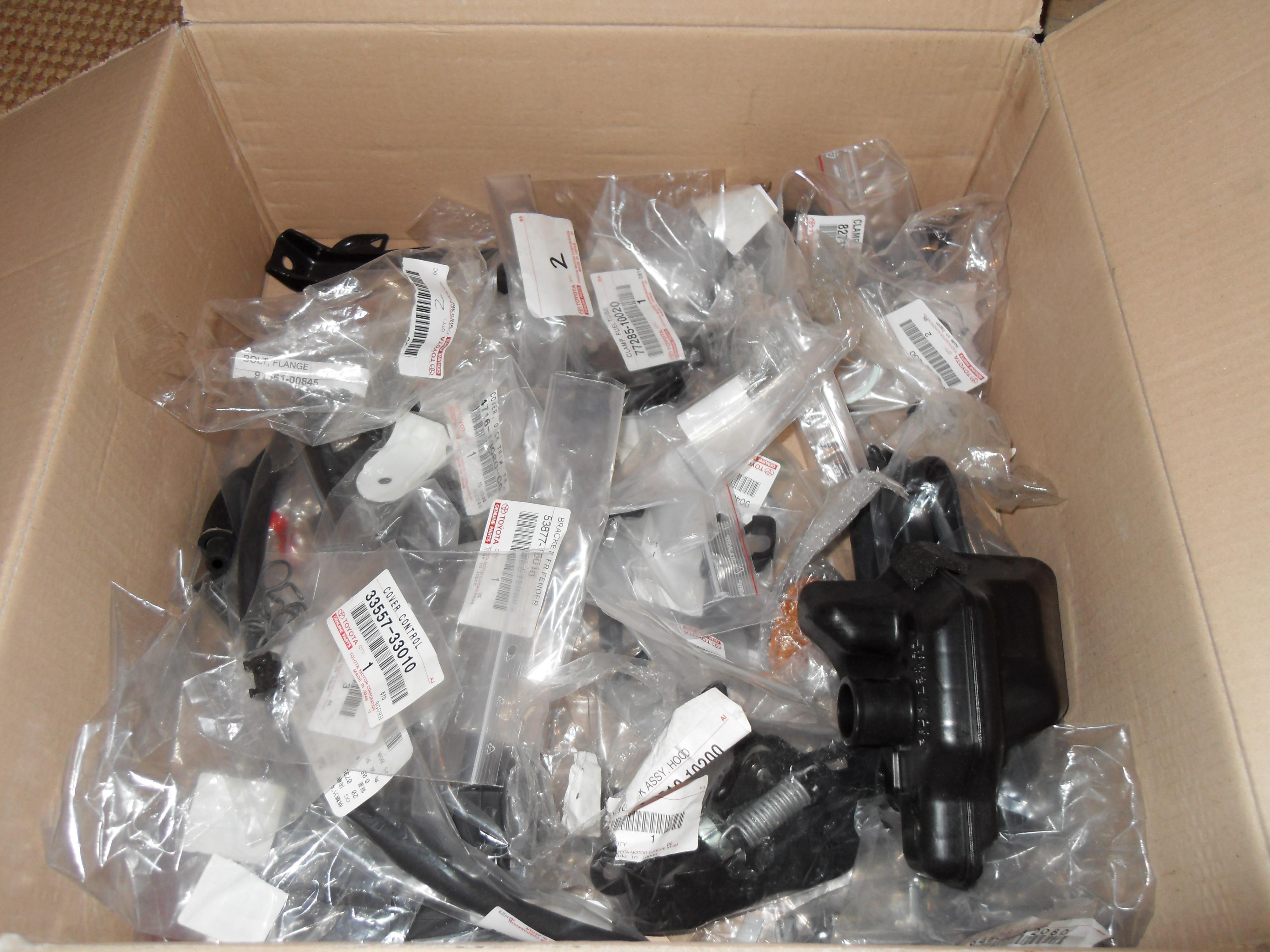

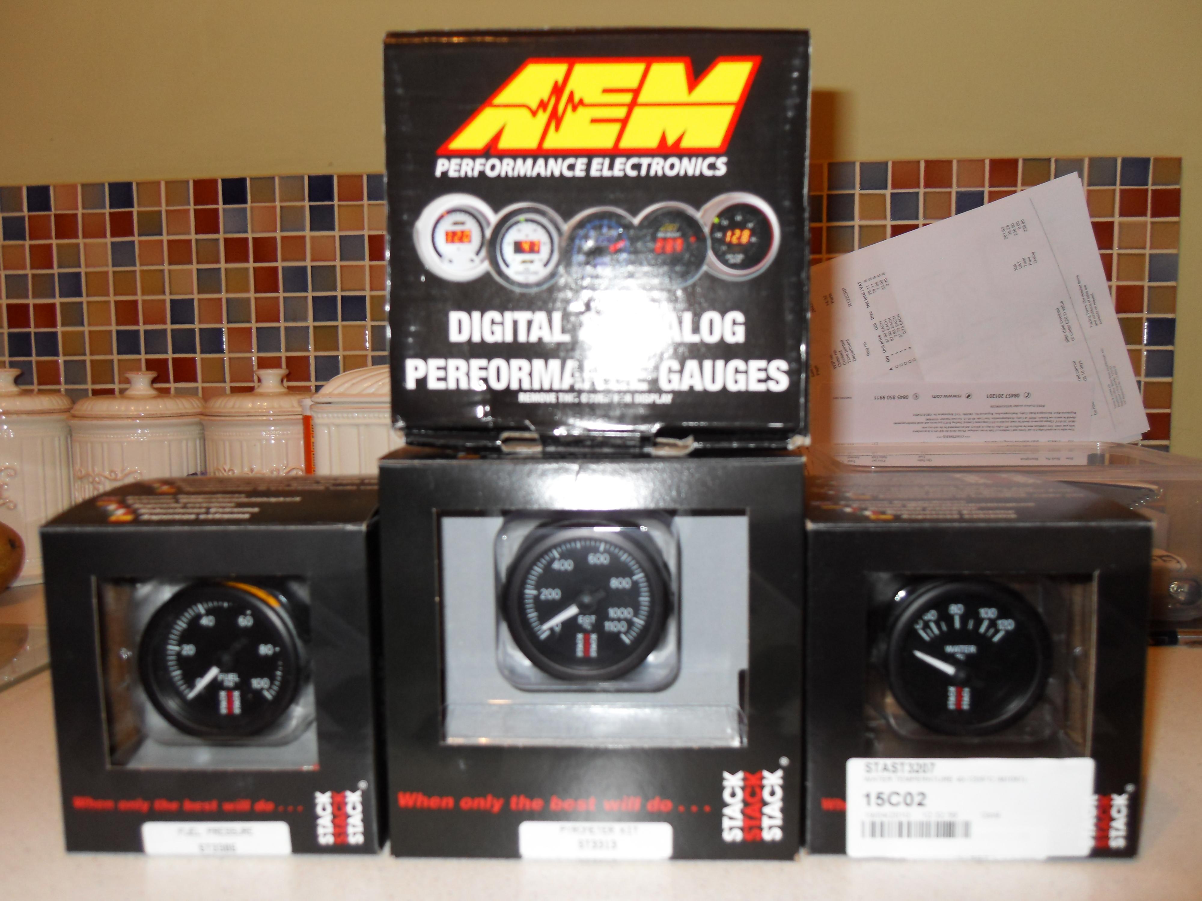

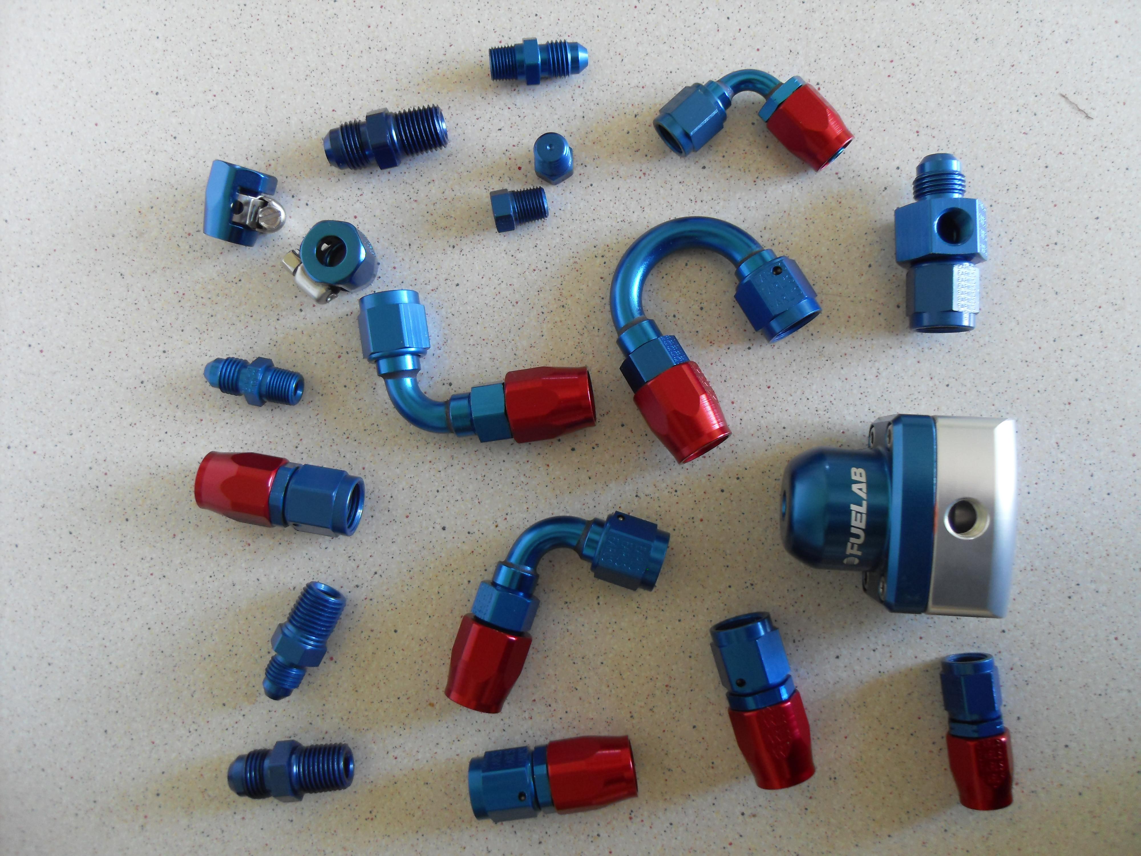

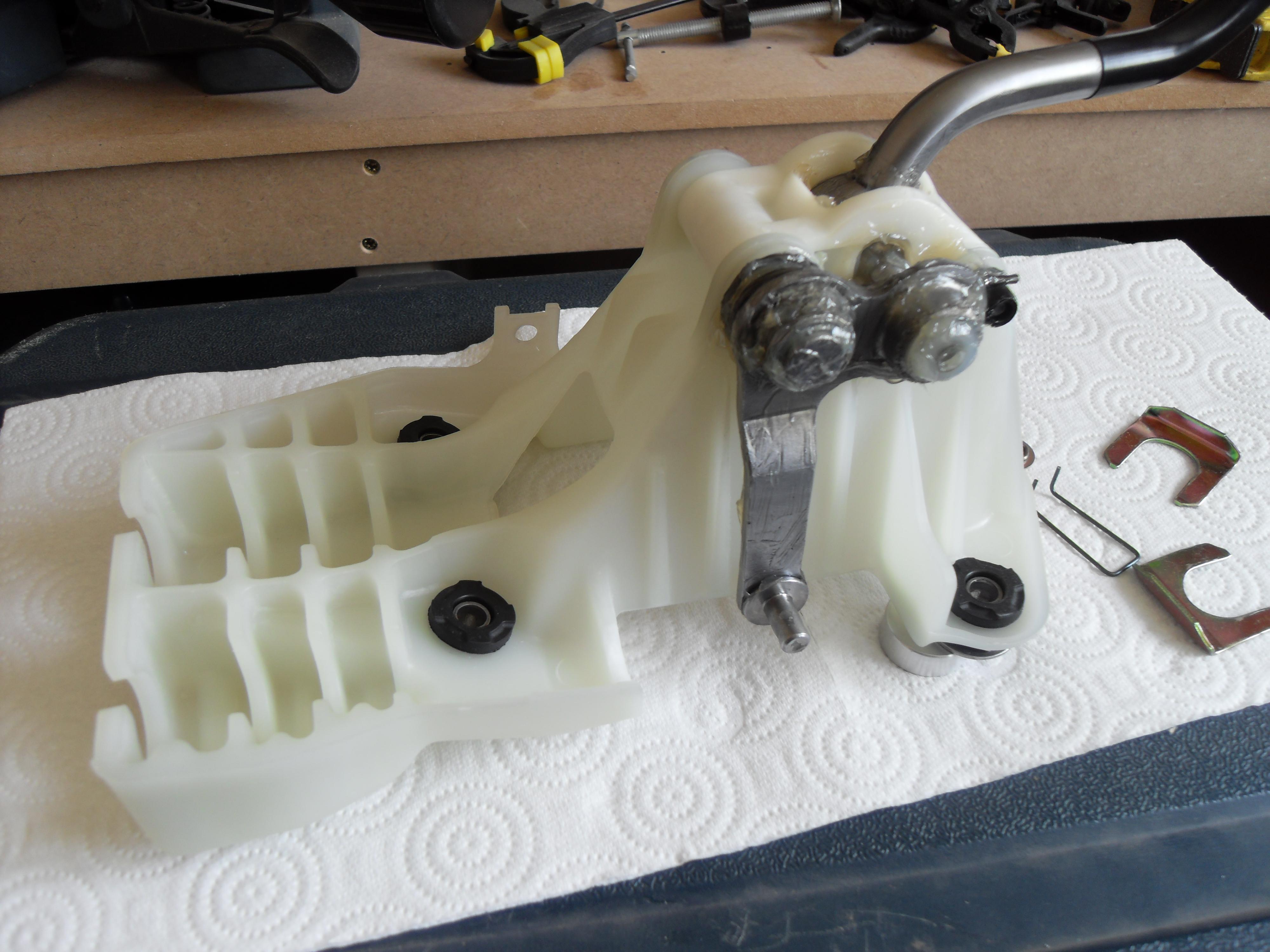

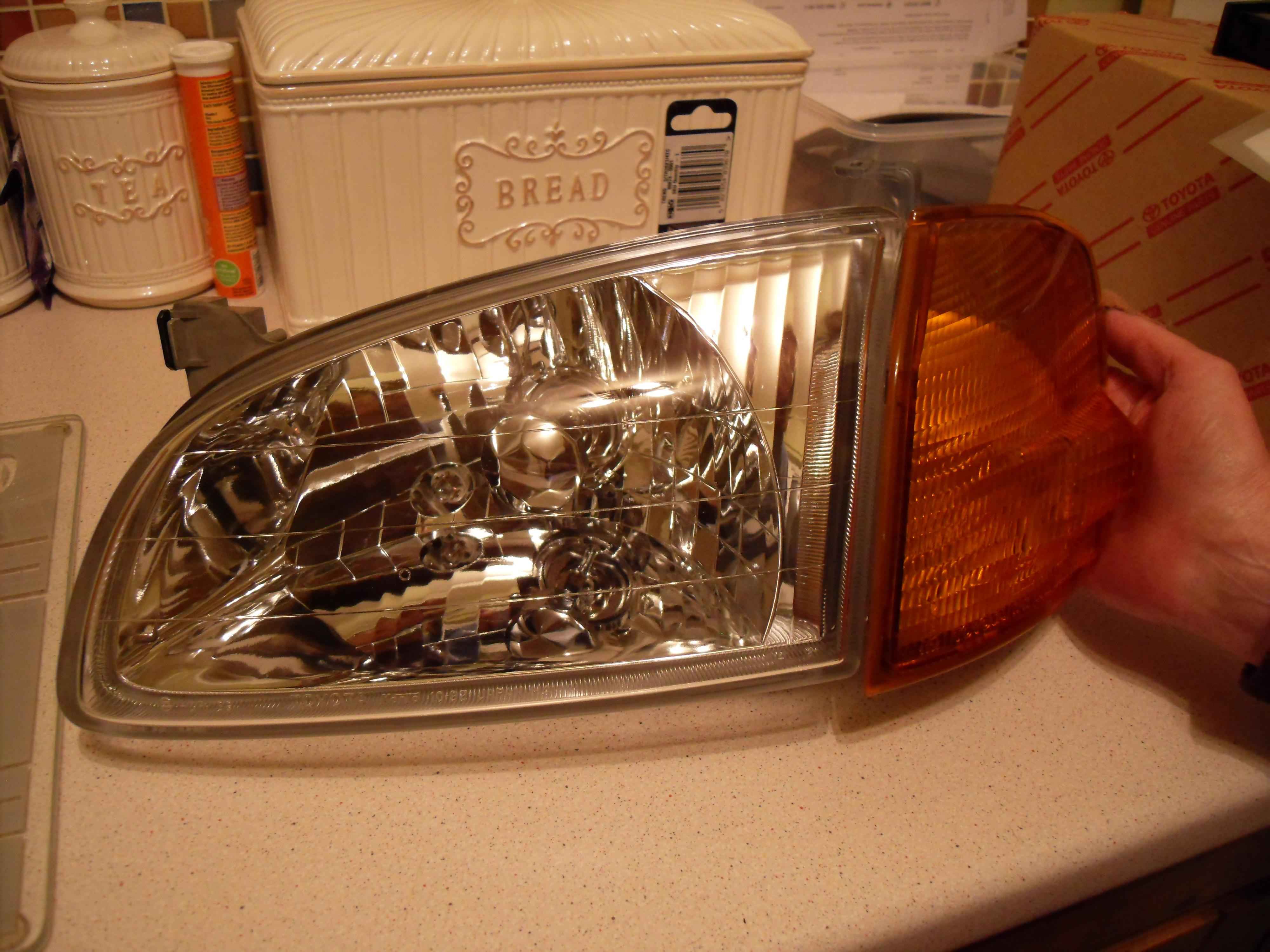

enzo_e492901 Posted March 3, 2011 Author Posted March 3, 2011 (edited) Cheers Sparky! Thinking about it she aint changed that much apart from replacing the drivers side sill and quarter panel. Oh, I changed the Corolla manifold back to the Gi one (basically an FTE one) I didn't like the Corolla one. I also made a custom short shifter from a standard shifter and fitted that. It's what's comming in time for the summer (might be the end of summer. lol) that gets me excited. lol The short shifter  What's waiting to be fitted... Modded Carina E 50mm throttle body  New Fuel system components  4 of 6 gauges. There will be in total when done Oil temp, Oil pressure, Water temp, Fuel pressure, ARF and EGT  A box full of Toyota parts  crystal clear headlights  Things I'm working on... Pattern (used to make mould) for custom fibreglass intake tube  Pattern and former (used to make mould) for custom fibreglass air filter heat shield.  Things I'm working on but don't have photos for... Custom cold air feed with fibreglass fitttings and aluminium tube. I have half the components for a dual cooler oil system. There will be an oil-to-air cooler and an oil-to-water cooler. The oil-air cooler is to cool the oil if needed. The oil-water cooler is for rapid oil warm up and to condition the oil should the oil-air cooler cool too much. (there is a thermostat as well) The oil-air cooler will also help take the load off the water cooling system. The system wll go: engine -> remote filter -> thermostat -> oil-air cooler -> thermostat -> oil-water cooler -> engine I also have a half size Civic rad and mounting kit from the group buy waiting to go on. At some point i'll sort an ECU, an exhaust and exhaust manifold as well. I'm also debating adding a water swirl pot and an oil accumulator. I can hear you all saying "That's a bit overkill". lol Well ya never can be to careful when you plan to run Nitrous Oxide. lol Gavin Edited September 29, 2020 by enzo_e492901 Quote
