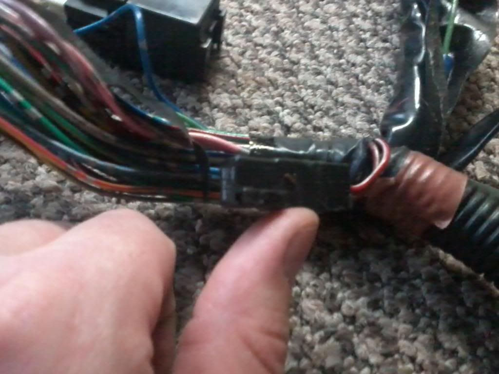

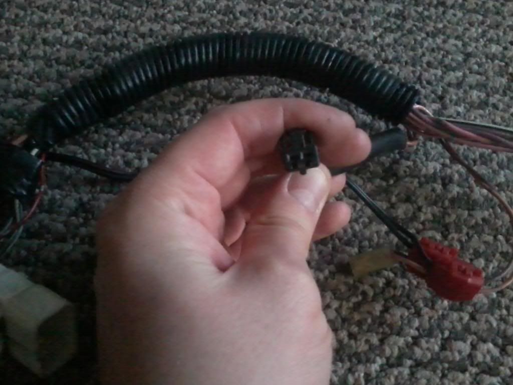

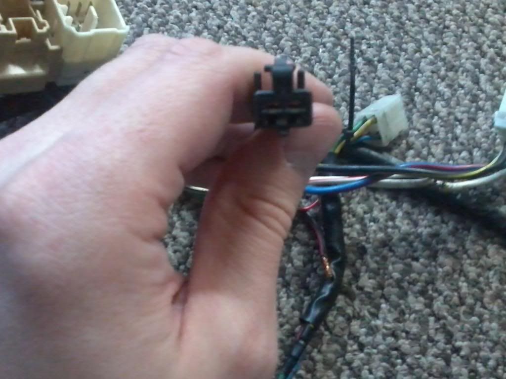

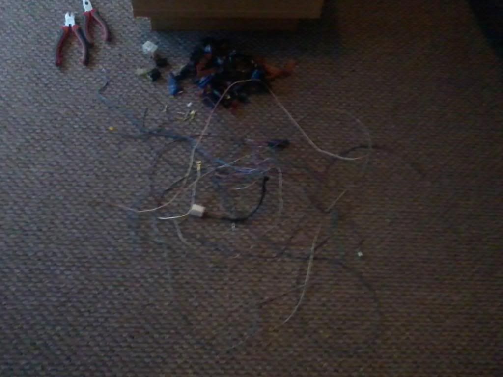

AdamB Posted September 30, 2013 Author Posted September 30, 2013 Rally drivers use shampoo on the windsceen when they remove heater matrix.Works a treat!! Herbal essences is what we use! That was unexpected lol. Removed the wiring for the heaters today, I assume I can leave out the connectors which clip onto the crash bar behind the dash on the passenger side? There's 3 of them one's the HVAC connector, dunno about the other two? Also got a few plugs I'm not sure of what their for or if they can be removed. Here's a plug on the passenger side which goes down to the door loom, colour of the two wires are pink and purple. Here's one on the drivers side which was taped up against the plastic wire cover, again down by the door loom, wire colours are red & white and red & green Last one is one under the fuse box which is on the same line as the ignition connectors, its a 2 pin with wire colours blue and black & white. Here's what I managed to remove for the heaters, bit blurry but quite a bit there. Quote

RobSR Posted October 1, 2013 Posted October 1, 2013 (edited) Its abit to late now no doubt, but when i wasnt sure if i could remove stuff or not, i just unplugged it and saw if it still ran fine, if it did, chop it off. May be abit difficult if youve got the loom out the car already tho. Edited October 1, 2013 by RobSR Quote
AdamB Posted October 1, 2013 Author Posted October 1, 2013 Its abit to late now no doubt, but when i wasnt sure if i could remove stuff or not, i just unplugged it and saw if it still ran fine, if it did, chop it off. May be abit difficult if youve got the loom out the car already tho. It's got no engine mate, so even harder still lol. Think I'll just leave it as it is for now, everything's been removed I can think of that won't stop the engine from firing. Just need to get it wrapped back up Quote

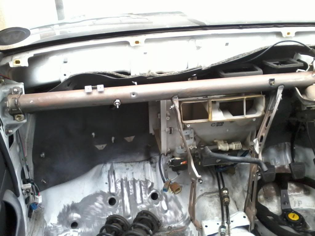

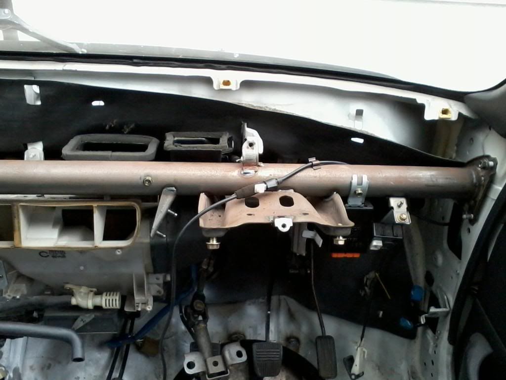

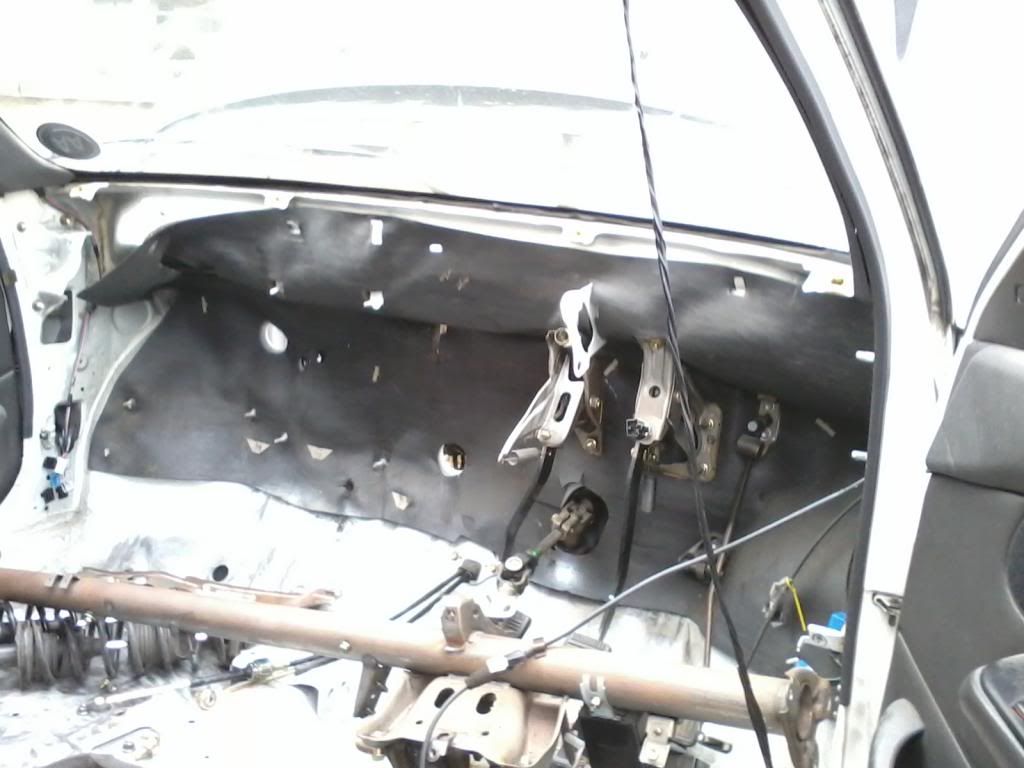

AdamB Posted October 2, 2013 Author Posted October 2, 2013 Well before I went to work earlier I did a little more work, finally finished off the wiring loom, just needs to be tidied up.Also removed the heater motor and matrix unit from the car. The motor unit was removed first Then I removed the crash bar and dropped the steering column to make it easier to get the matrix out. And finally with everything out Next up is the pedals, that'll be staying out Quote
