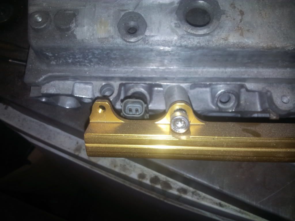

Lew91 Posted March 19, 2013 Author Posted March 19, 2013 That's the end of that then, I won't bother trying it on the other 2 engines. Makes you wonder why they've shut down all of a sudden!
Tara Posted March 19, 2013 Posted March 19, 2013 What do you mean shut? Just fitted another one up now will get some pictures up, we've had at least one customer who has confirmed they have fitted theirs and run the car with no issues, this is the only contact we've had with issues and are still awaiting the information to confirm if it is the spacer height that is causing the issue(as the height of the spacer will affect the angle the rail sits at which will affect how the mounting holes line up which can affect the way the injectors sit which will mean they don't seal correctly)
Lew91 Posted March 19, 2013 Author Posted March 19, 2013 Has he had the engine running with it in tho?

enzo_e492901 Posted March 19, 2013 Posted March 19, 2013 (edited) Something is not right. Spacer height will not alter an angle when the mounting holes/bolts and injectors sit parallel to each other. The fact the injectors and bolts should be parallel means the miss aligned mounting holes are making the injectors sit at an angle and leak. Trust me the mounting holes are about 7mm to far from the holes for the injectors. Gavin Edited March 19, 2013 by enzo_e492901
Lew91 Posted March 19, 2013 Author Posted March 19, 2013 Lol y green giants sweet corn?You got to double check lol. It was the first thing that came to mind for some reason. Cheers Tara. It's just we got ours to look fitted but on the first turn of the key the injectors just blew. Am I right in think CJ has all the correct liability insurances to? Just don't want to be seriously out of pocket if something major occurs. If any ones wondering yes I am being a jobs worth, after spending the last 2-3 nights after 13 hour shifts I think I'm a little entitled to a moan
enzo_e492901 Posted March 19, 2013 Posted March 19, 2013 (edited) There is no way the fuel rails will fit. The mounding holes are about 7mm out. Stock C J Performance What are you going to do about this james? The holes cant be elongated anymore than they have already because you will break into the fuel passage. Gavin Just to clear things up because a couple of people have pm'ed me. The ruler in the photos is not measuring the length! It's there to highlight the differance from the mounting holes to the injector holes. New photos Stock C J Performance Gavin Edited March 19, 2013 by enzo_e492901

Lew91 Posted March 19, 2013 Author Posted March 19, 2013 We've just had another attempt, ground down the spacers a tad and put more of an angle on them. They didn't pop out this time but pissed out fuel from the rail side instead, gave up with it in the end. Standard rail will be going back on tomorrow and staying on. I'll be on the look out for a hks one soon if any one knows where to get them.

Rob H@RCH Engineering Posted March 19, 2013 Posted March 19, 2013 I have not tried fitting mine yet but the first thing I did spot was all the swarf/drilling left overs in the fuel rail. Not very good for your injectors! and why had they been re-drilled after been anodized if there was no problem with them? Then the other thing I spotted was when I screwed the fitting in the end it does not sit level so would not tighten onto the seal properly.
