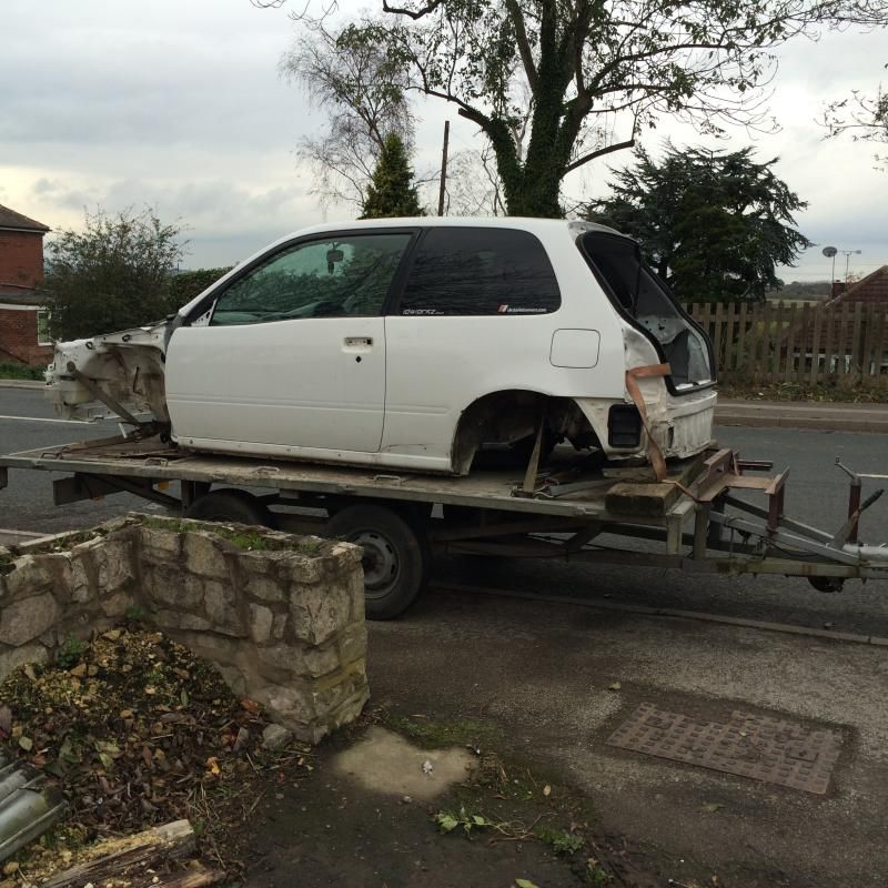

Well after much thinking about welding this rot box up I decided to get a Glanza shell ID-Workz were selling. I was going to cut up the Glanza to use the panels to weld up the sportif! But in the end I decided to turn the Glanza into a sportif lol!!! So here is where im at up to now! I picked up the car yesterday 24/10/14 and got it all set up in the garage!

First job was to turn it round so it was pointing the right way to go on the ramp! My dad came up with a cunning plan! stick a plank of wood under it and put it on top of a brake disc! EASY!!!
FF51412D-E7A8-4746-A1D1-024C0A6BB10A_zps
825AFEA8-7CE6-4C73-A890-7B30A7F9816A_zps

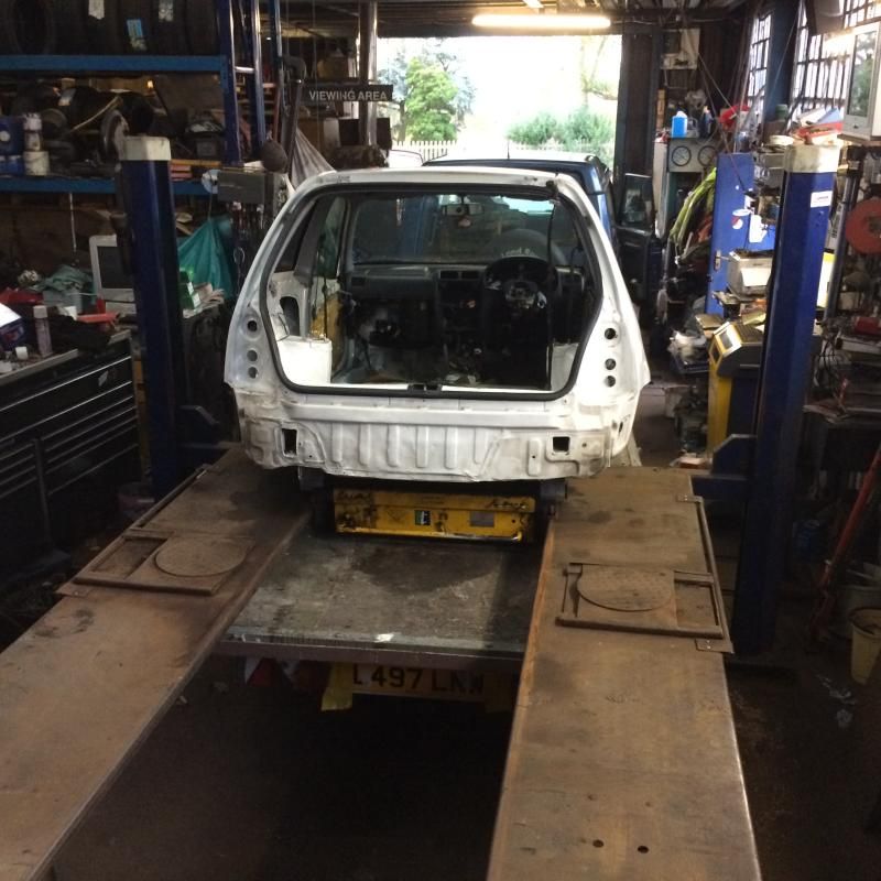

Then onto the ramp using lots more wood and jacks! and my dad reversing the trailer under the ramp! nice bit of driving I must say!
7BFD8880-3F2D-4D40-A5B8-0774D169D48E_zps
68B9D57A-AF23-4E46-BAB4-8F3ED571AAC4_zps
0EE3D7F6-190E-4CDF-943C-5993CC5CAF6E_zps
D21AB384-F34E-4DBB-9879-B1B9F82ED5F0_zps
Then the sportif in! and up in the air! who needs jacks lol

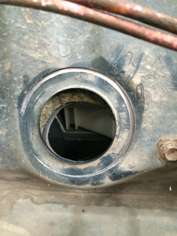

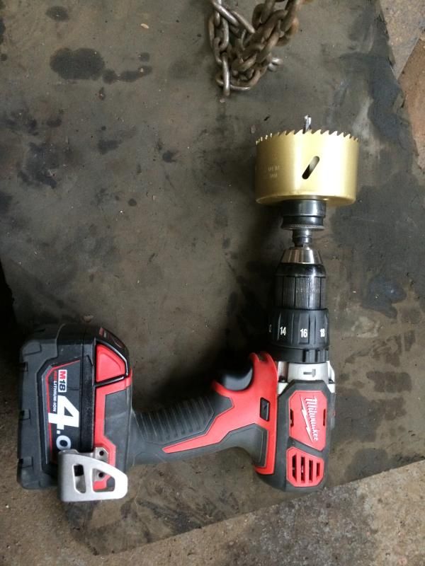

The glanza did not have the hole for the extra harness the sportif has so to get round that I did this!

Made a centring piece so I could drill out the hole!
05341B90-036C-4656-9682-D2400FF6AC97_zps
F42EDA63-3638-4FA2-A50E-D4E6F9E7A562_zps
8998522E-CA6B-41DE-BB21-04520147286F_zps
66A1BBB5-04AA-4E83-879D-F5474BF44E95_zps
0806524A-AFFA-4C14-9BAC-B13FE288B154_zps
Then drilled the hole in the glanza! And fit the flange!
5984F925-9320-4301-AA62-2FE3603A9496_zps
4D5C63FE-860B-4FBF-93C7-8F7D1D9DBCE6_zps
29F890BA-405D-4E27-9519-BBB834234F24_zps
